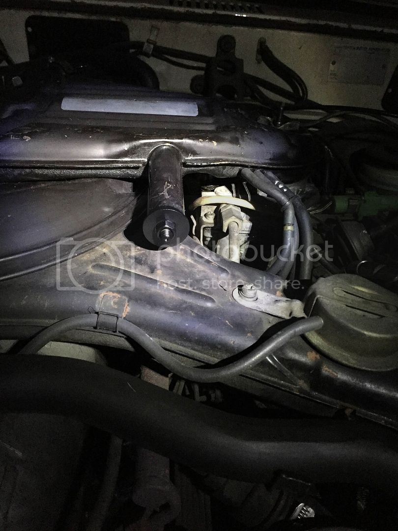

Leaking power steering pump- can I leave it empty?
Removed the belts, cleaned them and the pulleys and retensioned. All quiet on this front now. Thanks!

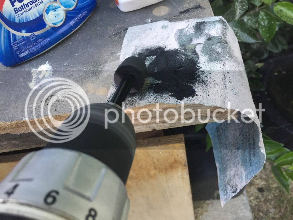

The larger one took some sanding to get it to fit into the air cleaner assembly but a drill and piece of sand paper made short work of it.

Call me crazy but gutting the smog pump seems to have almost entirely stopped the truck from dieseling after it's turned off, and also seems to have gotten rid of a flat spot in the power band around 2k RPM. I've been driving it everyday and those two issues are suddenly gone. They were not intermittent issues- the flat spot was always there and it nearly always dieseled. I already ordered a new Trollhole carb assuming that's what was needed but maybe not!
