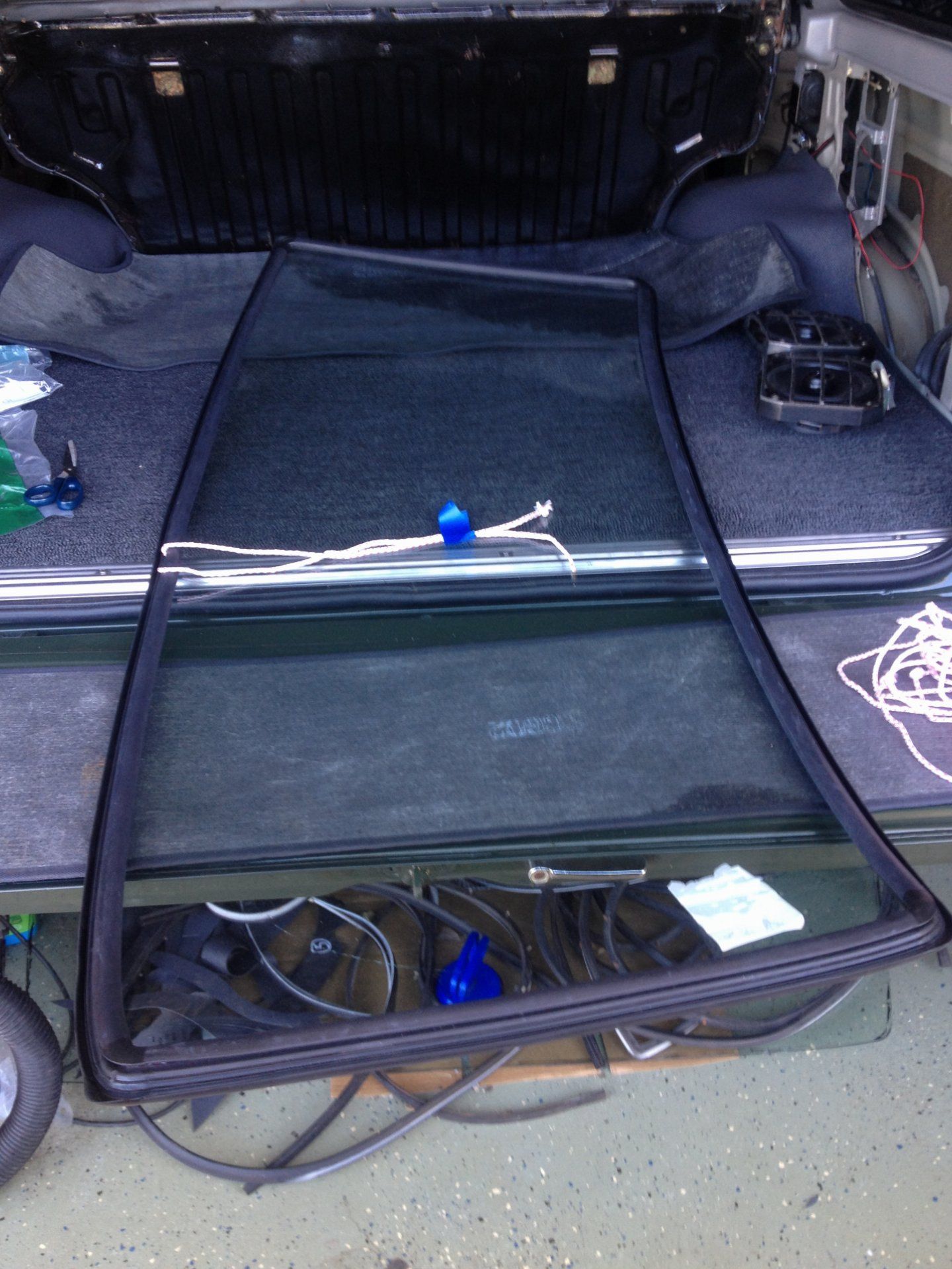

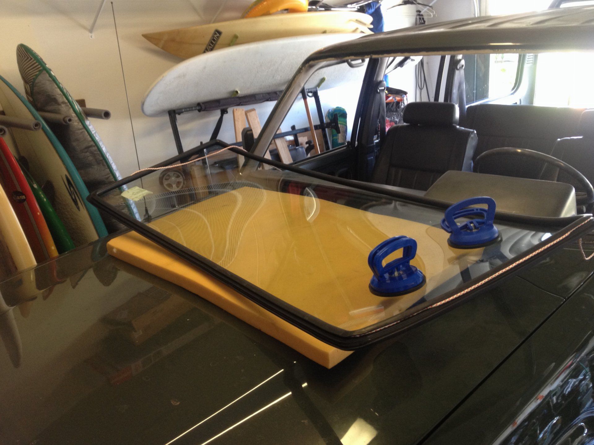

If you have another person to help, you can get the windshield installed in like 20-30 mins, even less if you have a third person. Then after the window is in, another 10 mins to put the adhesive on the gasket to the glass and gasket to the body. The most time consuming part is masking taping it off like the FSM says.
My husband and I are basically clueless, and we were able to do it just fine. Watched a couple YouTube videos on the string install method, and a couple of the window suction cups (but they really weren't needed). Seriously, I really feel anyone can do this. It looks intimidating, but definitely can be done.
