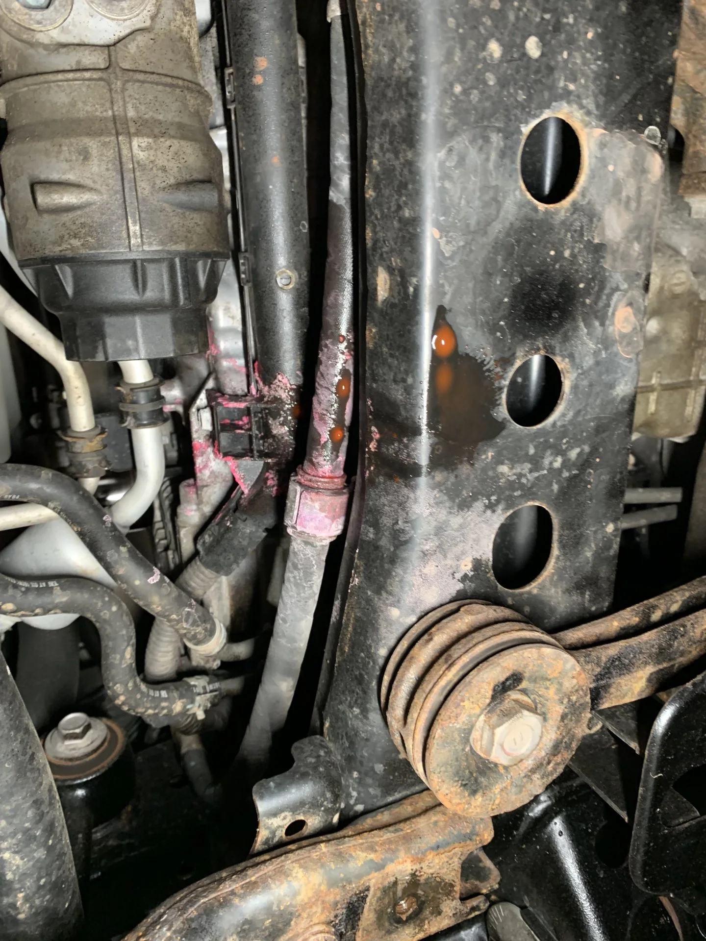

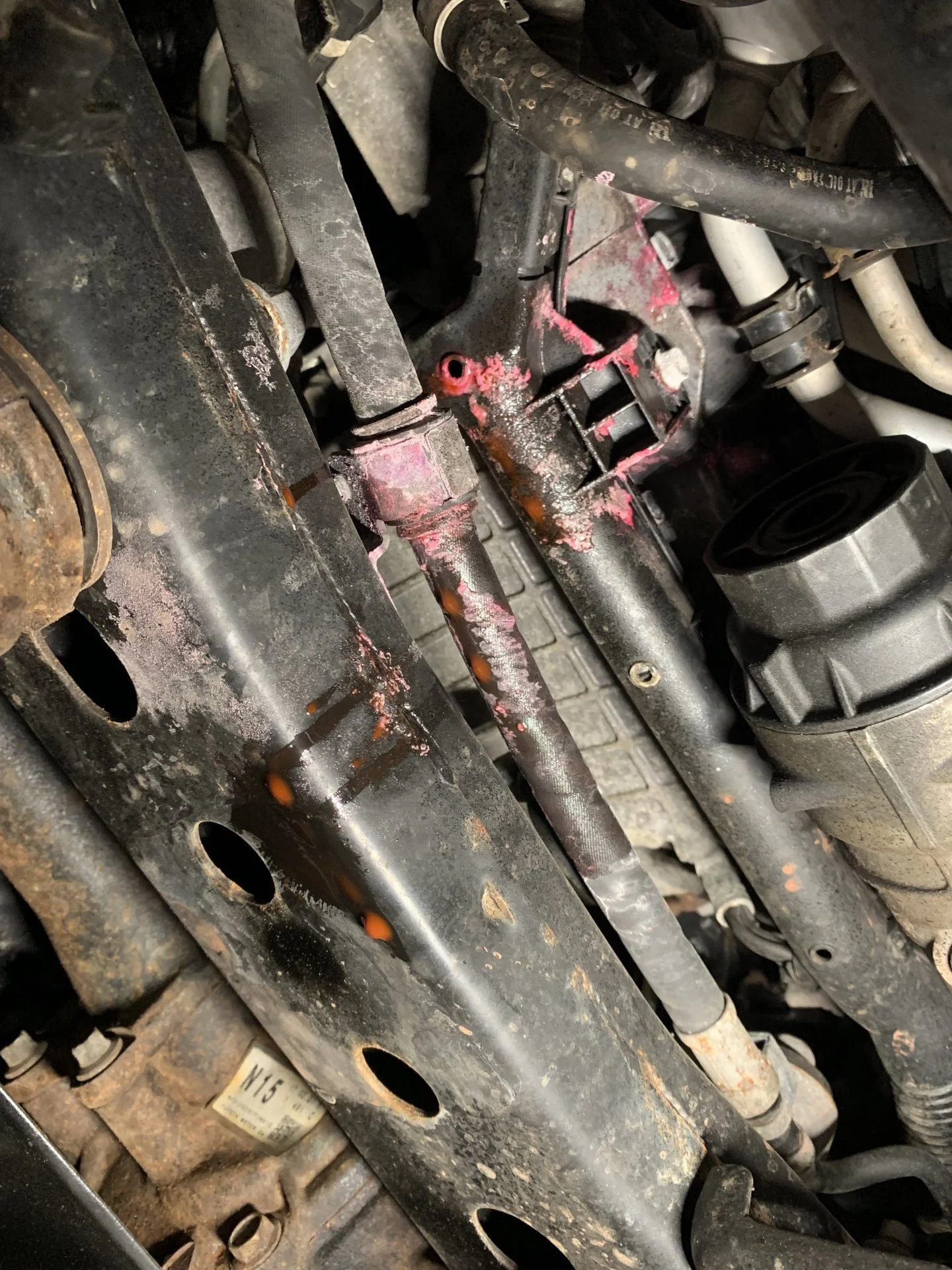

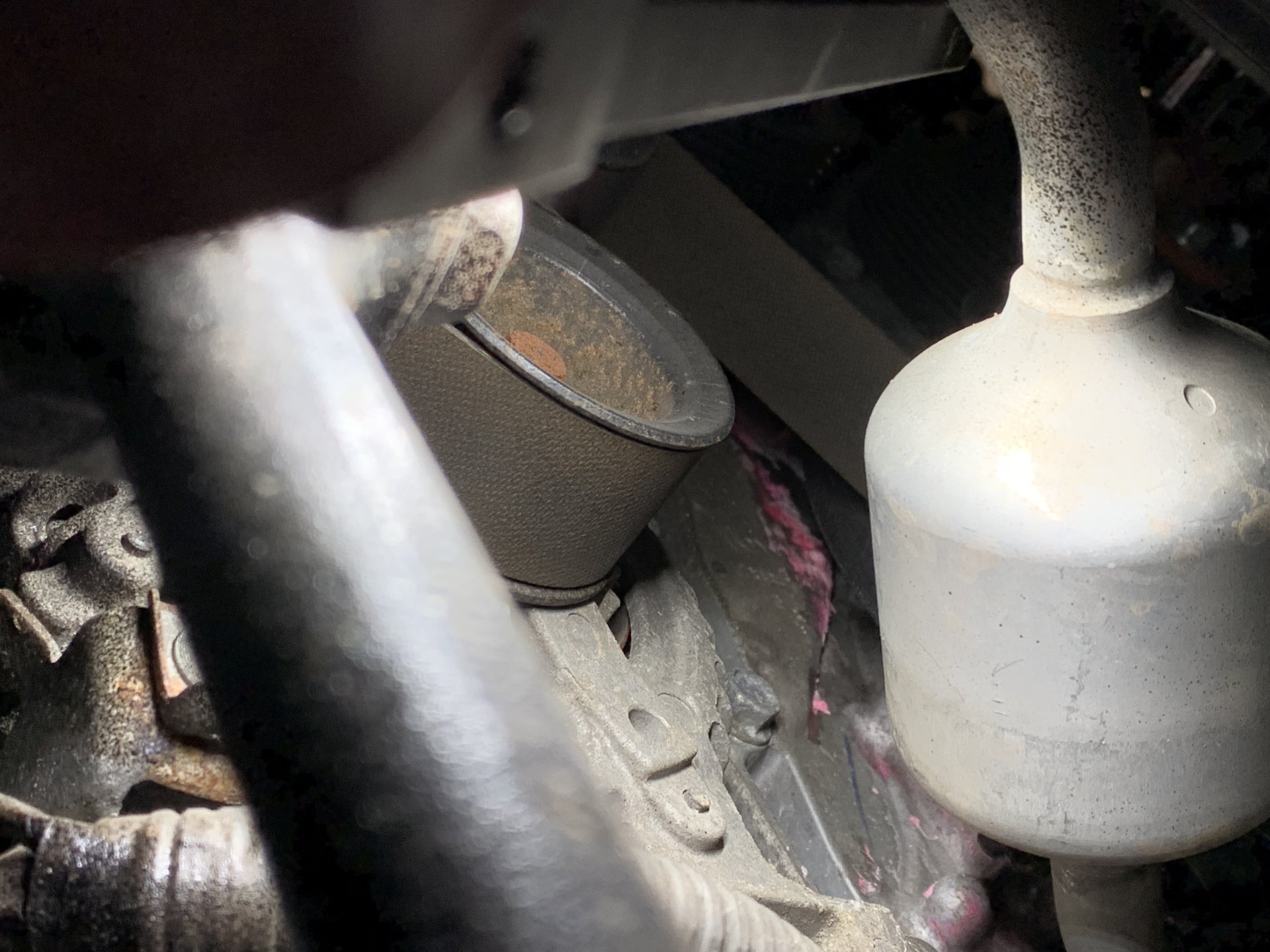

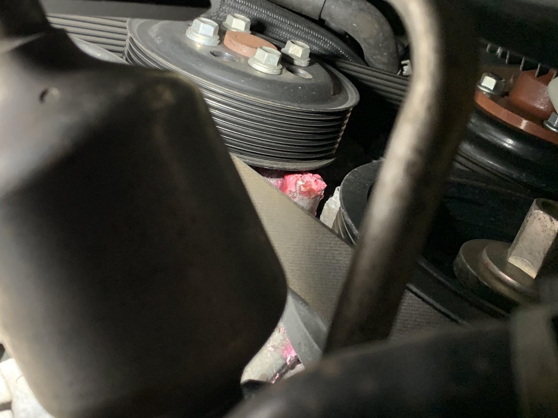

I am going through the steps of installing the CBI Covert Bumper (cut went well), but I see pink fluid leak after I took off the factory skid plate. I looked up and found the following. Still under CPO "warranty". Any guidance? Thanks!

If it's under CPO warranty, drop it off at the dealer and say the magic words......."Fix this leak, please." :D

I did what @Bang Bang recommended. I took it to dealership early this morning, they reported the water pump is leaking. They should be able to replace it by end of day. They provided loaner car for the day.

Follow up question -- it's great that I caught this and it's being taken care of while under warranty, but should I be concerned at all about the components that soaked in the coolant as seen in the photos in the original post? If the shop doesn't clean it up, should get under there and rinse it? Anything else? Thanks, again.
If Lexus is doing the repair, I'd expect them to clean up as well. Coolant isn't going to damage any components, but I'd want to get it cleaned up as it may mask other potential leaks down the road.
