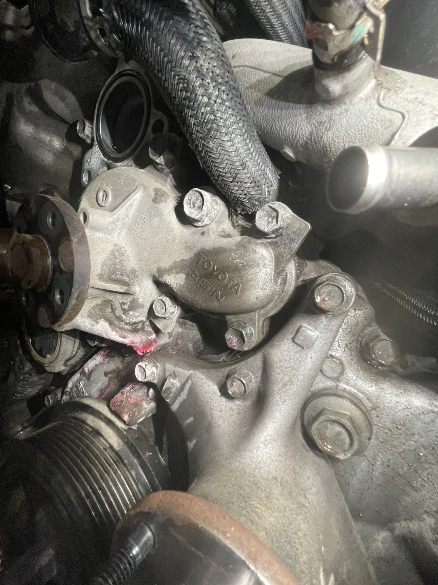

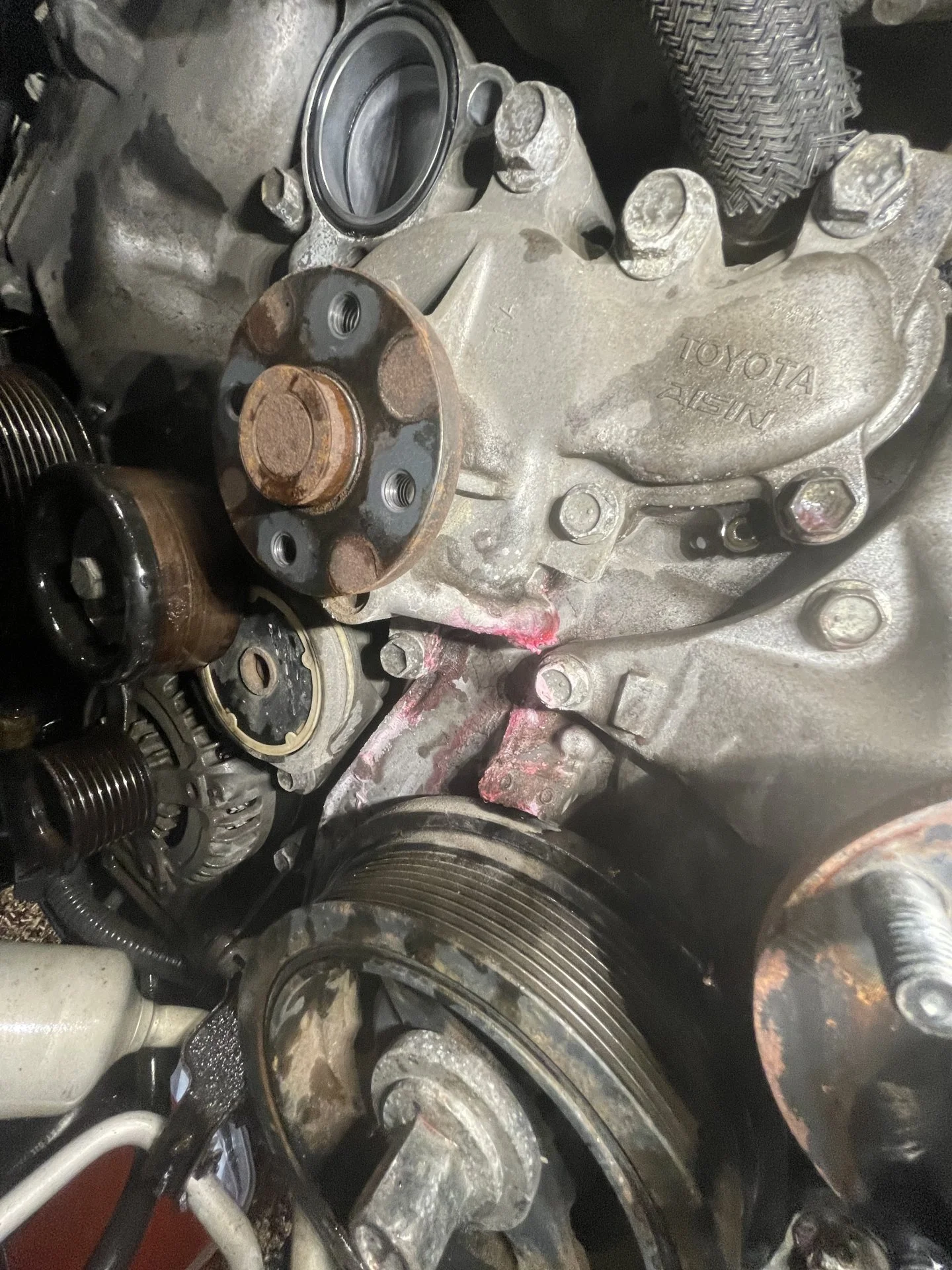

leak question - found under front factory skid plate
IMO: It seems like valley plate leak is almost always off the back onto bell housing on those I have observed. I don’t recall any recent ones where it came down the front like water pump. Those last pics of op show right at WP. If it is coming from valley plate easily seen with borescope on front area of valley plate.

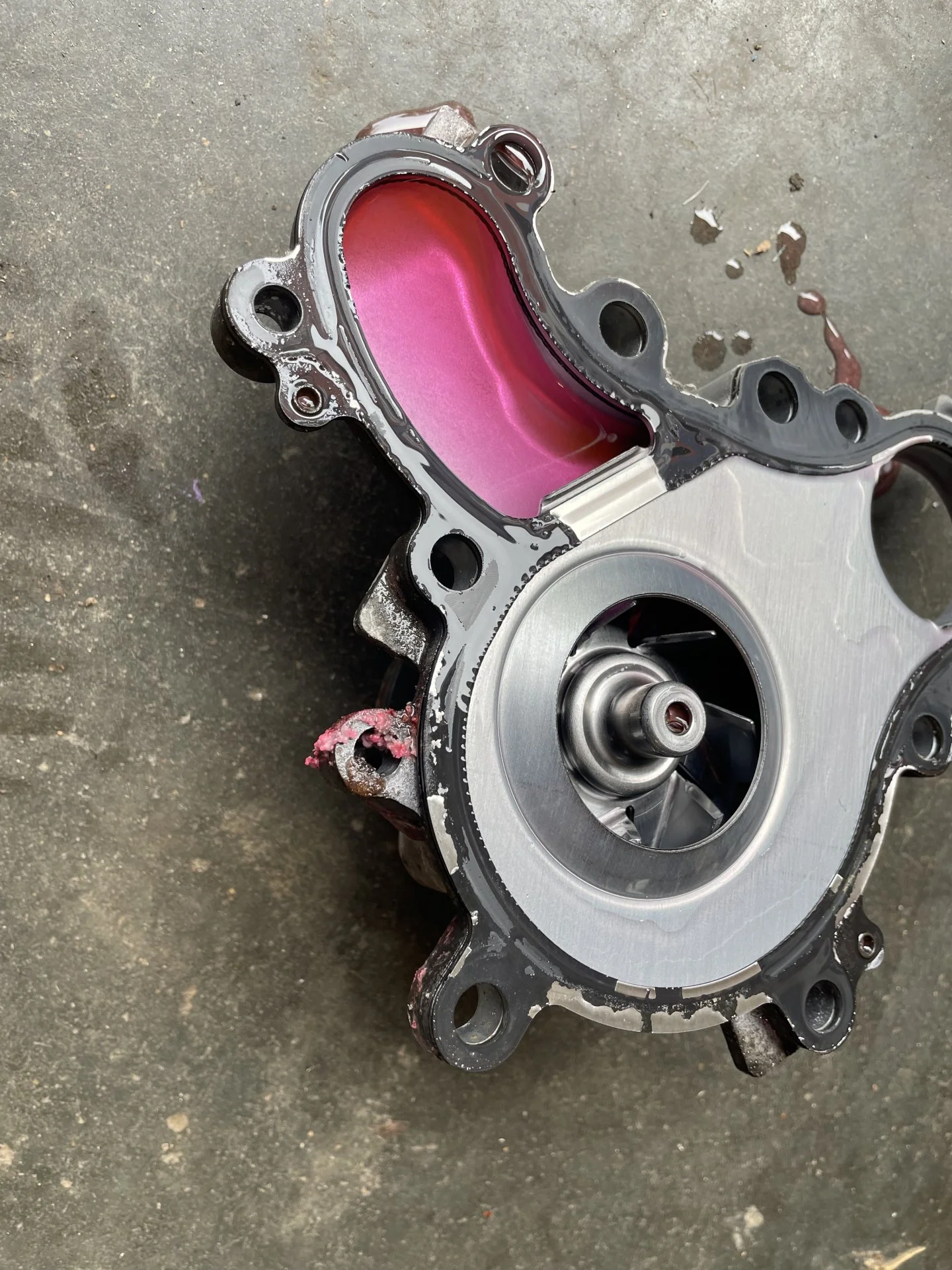

Got this done today took about four hours….
Clearly the leak was coming from under the water pump, and the reason was that bolt was finger tight!!!

Albeit, taking the water pump off is no small feat, but at least it was a simple problem and not something that needed a lot of chasing down and $$$$!
Honestly, it wasn’t that hard to do at all. I’m gonna say one and a half bananas.
