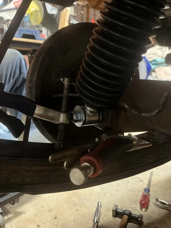

Just started to remove my rear leaf springs so to remove a leaf or two in order to help soften ride a bit. I was planning to remove the 3rd leaf down from top only but now that I have the lower leaf's removed, wondering if I should also remove the 5th leaf down (see photo below).
Additional info, Leaf springs are 4" lift HFS. Tires are 34 x 10.5, I have replaced the shocks with Bilstein 5125, not shown in photo, (per another members recommendation) and it did help the jarring effect but still a bit to bumpy for the wife. I have the soft top on most of the time so reduced weight in back (but also have a full roll bar cage installed). I do have the hard top and will keep the leaf(s) in case I need to reinstall. The front does not seem as bumpy so am not planning (at this time) to remove any leafs. It does have a sbc 350 (a bit lighter than the 6 cyl) but have a winch on front and 700r4 trans so I think the weight is helping lessen the bumping.
Anyone do a leaf removal on this set-up and if so what advice or opinion as to removing 1 or 2 leaf springs. Really do not want to change the ride height much since its level with the front now and my tire size. Really don't want to have to do this twice if possable.

It's really hard to see the leaf pack. Maybe use a flash or a light under the 40. My guess, I would remove the 5th one and call it a day. I think the shorter ones usually have more arch.

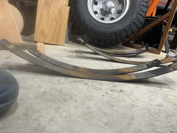

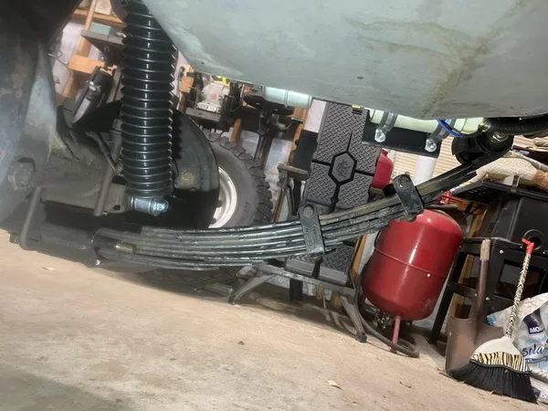

Here are 2 more photos, the passenger side that I have not started to remove but is a better view of the spring pack and the drivers side that I have disassembled showing the longer 3rd leaf down compared to the shorter 5th leaf down that does have more arch and feels stiffer when pushing down on it.

Nope, had not thought of that. Been doing some research on the internet and it appears that all say to remove the shorter leafs. Also, to add additional clamps to the forward portion of leaf pack to help support axle warp. Unless someone has more knowledge than me (that would be most), I am going to remove the 5th leaf down.
I've been running 4" bds springs for probably 20yrs or more. The springs had less leaves than yours. To gain more flexibility I removed the 3rd one from the bottom of a 7 leaf pack. It worked great. I got a lot softer ride and a lot more flexibility. I also removed the bolts going across the top of the clamps. Most folks I trail ride with remove the bolts too, it allows for better droop and flexibility when the leaves are unloaded. Like I said b4, I'd try the 5th one down and see how it works. It's a short wheel base vehicle, it's going to be a rougher ride.
