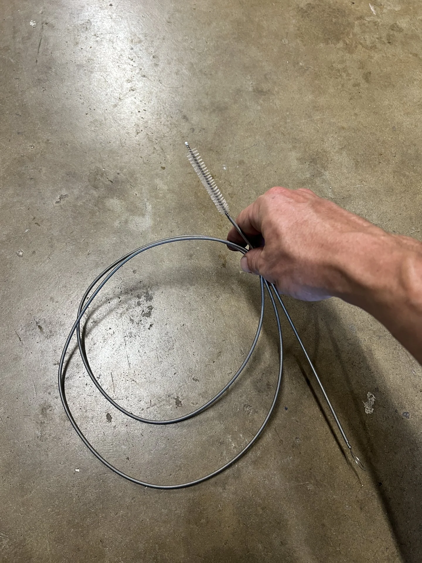

Definitely maintain your sunroof drains.. it happens on all rigs including the GXs. I also would be careful using compressed air or if clogged you might blow the hose connector off at the sunroof. I use weed eater line and then run windshield wiper fluid down the lines a couple times a year and mine is in a garage. If outside definitely keep them clean if you don’t normally park on flat ground. IE: Right front blocked but parked down at an angle… waterfall pillar syndrome on the ECUs below.
