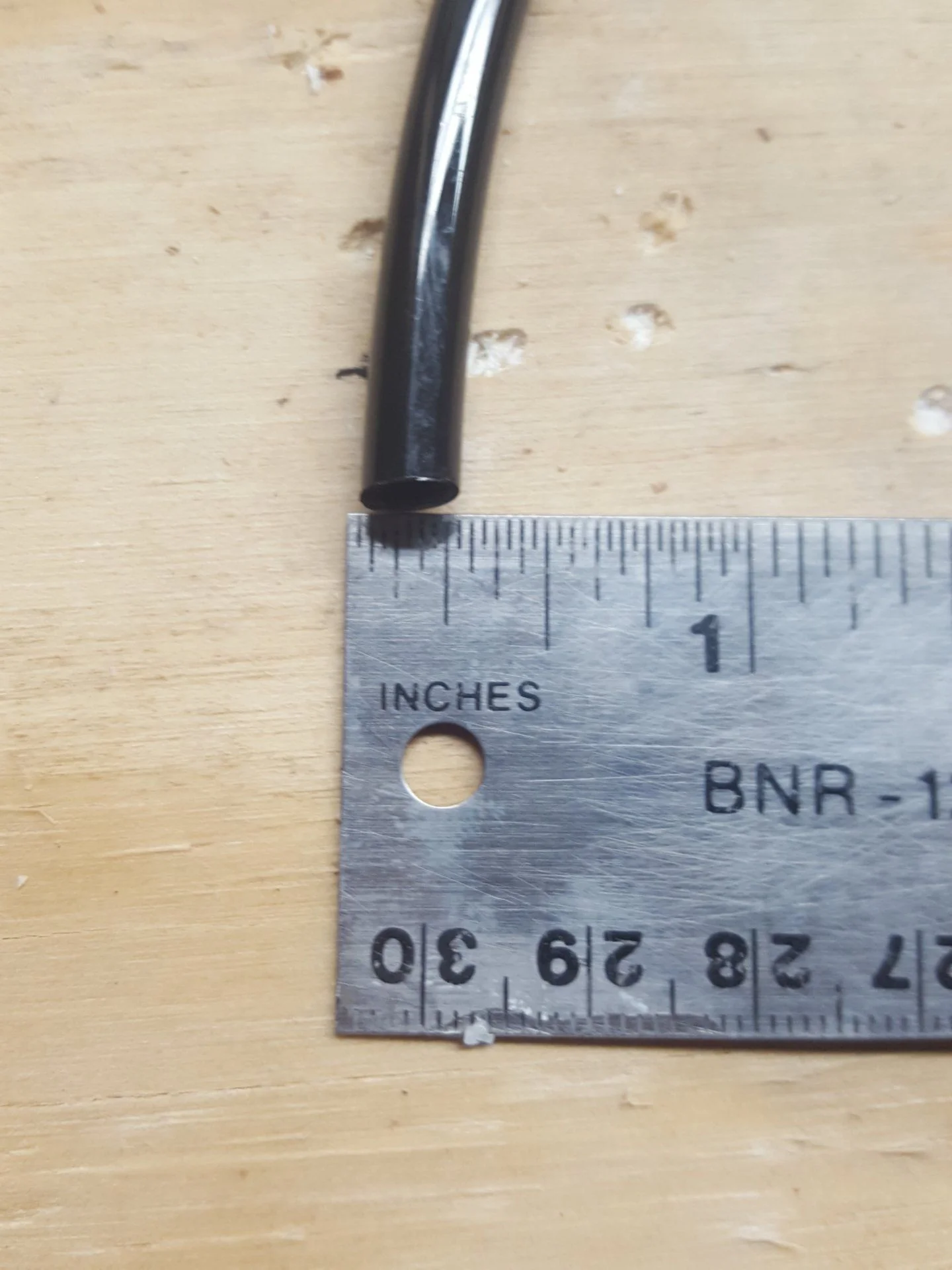

Tried to clean/clear sunroof drains of a friends 05LC today but was not able to find anything that go down in drain holes. Tried with cloth hanger wire, fuel line, some wires but couldn't get any of these down there because either not rigid enough or too rigid to go in. Those who successfully cleaned it, what did you use to clean or how did you clean it?
This tube seems to work but not long enough, not sure what it is and where to buy it.
It does not look like blocked or clogged there because I didn't find much stuff around the drain holes. But want to rule that out from the list of things to check on passenger side wet carpet issue.
Thanks in advance.
