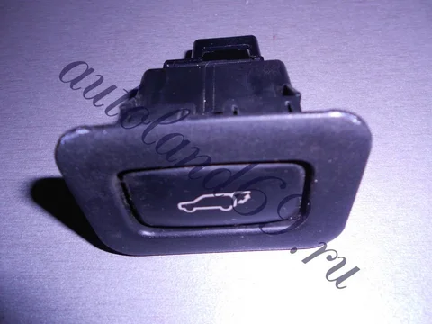

Nice write up, a mod I have been considering for some time. Even picked up a Toyota "glass" switch for the purpose.

Nice, I like that switch. Curious to see specifically where that is mounted. Guess if I wanted to be super-oem-anal, I could go with that switch.
The switch is part # 84930-28150 and it appears to be a good number in the US, but I have not tried ordering. The switch is large and I think it mounts right where Johnny placed his... my Huskies and kidnapping victims would have the potential to pop the hatch open pretty easily with it there... and I don't need that hassle. The rear glass switch from a Toyota Matrix is a regular sized unit, but needs to find a home somewhere in there.

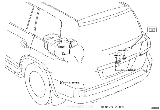

Factory diagram fwiw
