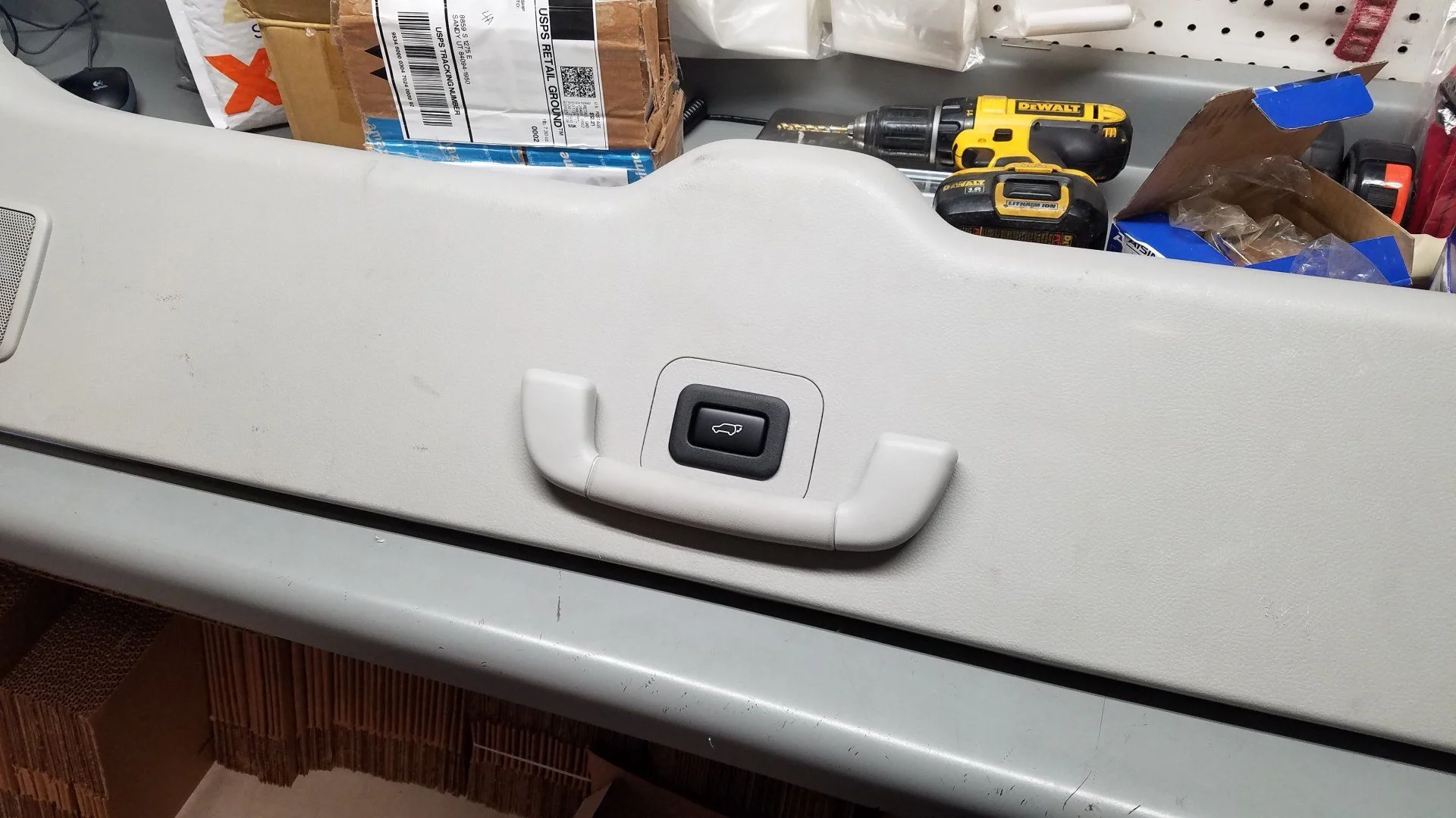

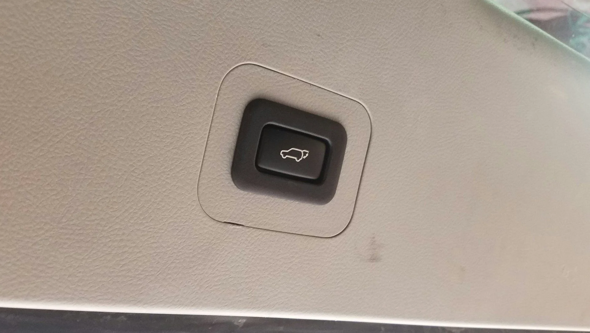

Finally getting around to mounting and wiring my switch. I mounted in the access panel which was the factory location on those equipped with the switch (parallel seat models and perhaps others). I found the OE part number for switch equipped panel but it looks to be NLA (Sunday here so I didn't give it a huge effort).
I had an OE Toyota plug connector and terminals here that fit too :cool:
I finished it off by adding a factory grab handle, the OE setup would have had a similar handle in this location.

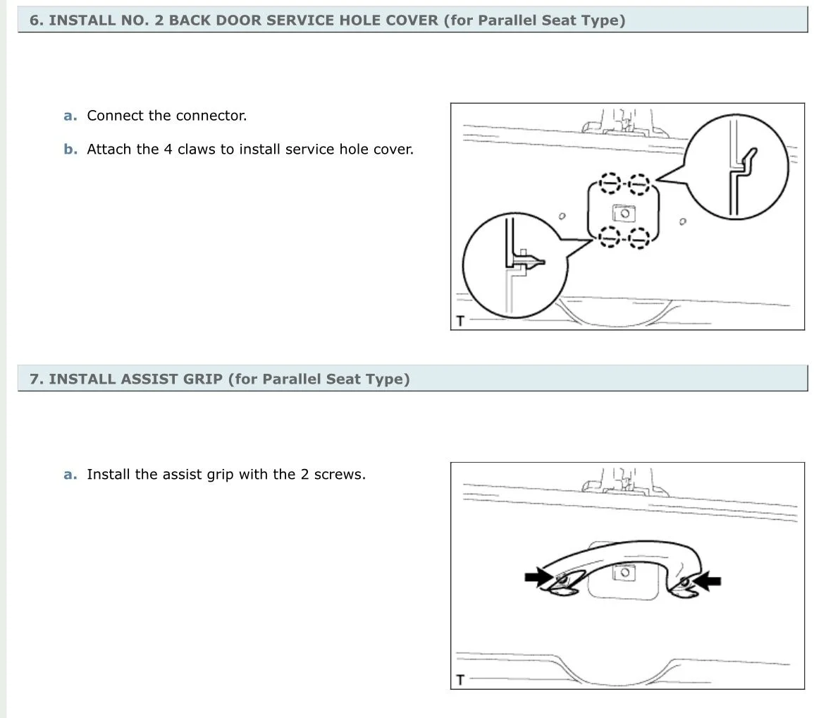

Factory diagram fwiw

Yup, 100% tested & functional. I got the switch from @beno and I had the connectors and terminals in stock. The grab handle is simply a factory 200 grab handle. I may assemble it as a little kit as I did grab more of the switches from Japan. If you're in a hurry, Beno had mine shipped in just a day or two.

I too am an avid platform sleeper (or on the rokfrack. The lack of rear exit and a handle to pull the rear shut has been extremely annoying. One added bonus of the handle is that it offers a bit of protection in the even something slides into the switch.
I'll give the kit a look tomorrow. I had to use some hardware and modify the grab handle (designed to clip into sheet metal) but it's easy stuff to include and a template could be included.
