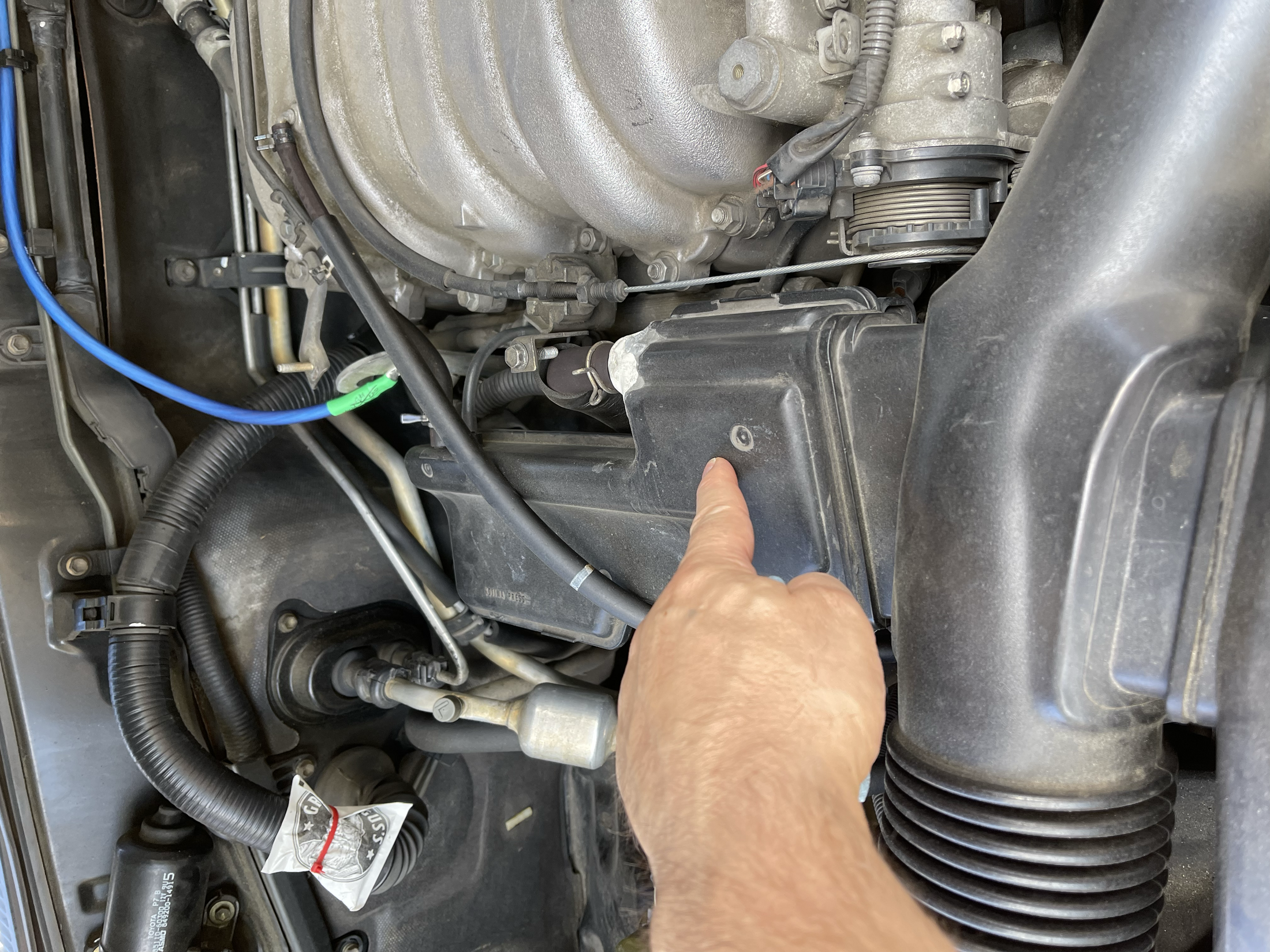

I really wish I could just buy this air box piece somewhere, the one I am pointing at in the attached pic. I almost considered a modification to the factory system, until I started reading here. I myself prefer things to be OEM as much as possible.
I've JB welded, glued, fixe and re-fixed this stupid little pipe I don't know how many times. This last fix seems to be working the best, but it's an eyesore. I've heard of and saw people do plastic welding, but that means to me I'm buying a tool I'm going to use one time.
hmm.. why not I just buy this piece I'm pointing at in the picture and call it a day. I almost found it used, but then the guy on the world market stopped talking to me. I'm still in search, oh yeah, and I don't want to pay 200 bucks for one on eBay or anywhere else. I'd be happy to pay 40 dollars for that piece.
If you want the piece you are pointing at, you have to source the entire factory intake tube, which is what you are pointing to, I suggest checking ebay (which is more than you would like to spend), various Facebook 100 Series Land Cruiser groups ("UZJ100" and "Land Cruiser Lexus LX470 100 series USA") and Facebook LC sales groups ("Toyota Land Cruiser Classifieds", "Land Cruiser 100/LX470 UZJ100for sale"), Facebook marketplace, and of course ih8mud Classifieds. Maybe a local pick and pull yard might have one (copart)?
Unfortunately, I don't think you will find one for as cheap as you would like.
I have not seen a Land Cruiser in a junk yard for a very long time. I do periodically check though. I'll be waiting this one out before I spend the honkin 200 or so. FB aka world market, I've been searching, and every time I get a bite, it's sorry Charlie. oh well. that's life. I'll keep searching.

Yep! The big baffle/air chamber cracked on my original 100 series intake pipe. I replaced it with a 4.7L Tundra/Sequoia intake pipe. I installed this over 4 years ago, but do remember needing to extend the fuel pressure regulator vacuum line and the power steering vacuum switch lines needed repositioned.
