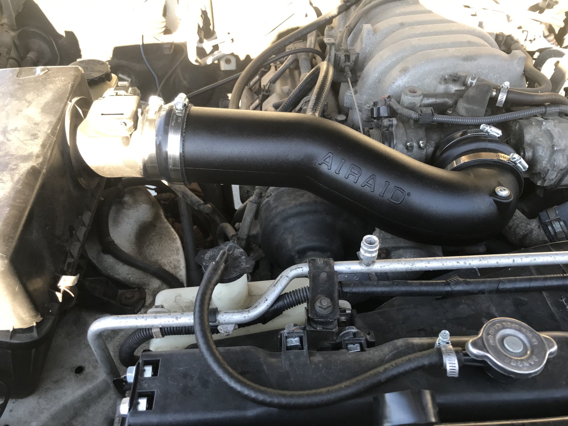

It fit my 98, made for tundra with 4.7L, very easy install. Slight pep in wxcelwration, I bought it to replace my old air intake that had mounting tabs busted and was falling apart.

will this fit a 2006 LX 470? Are all the PVC lines the same?
Yes. I install this on a 06' LX470. ~13 months and counting
What about the flexibility? I see no flex in this intake.
The intake tube itself is ridged. However the two couplers have enough flex for the application. I have noticed no issues and inspect it regularly.

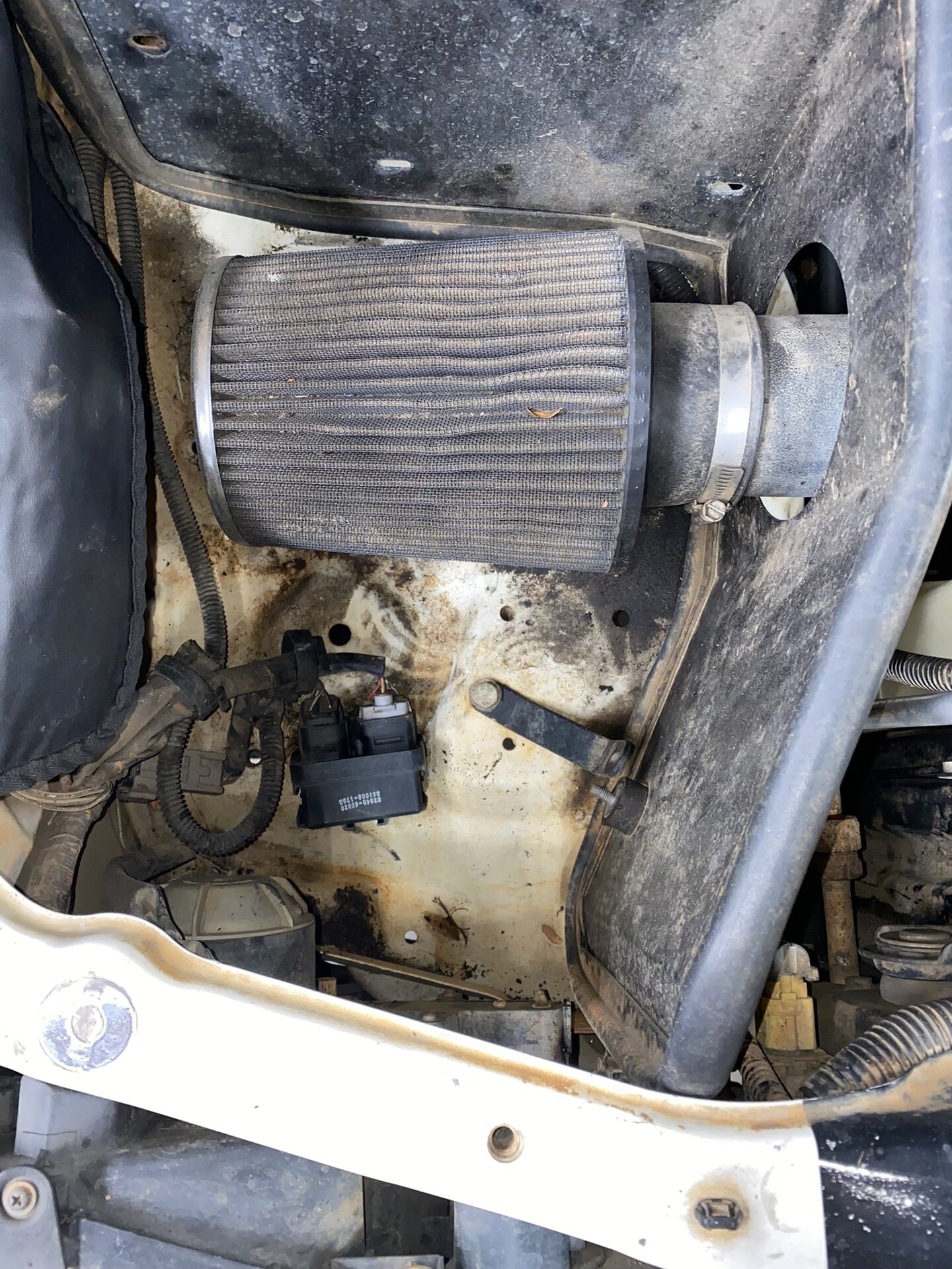

Personally, I do not like seeing any of these after-market cool air system on the 100 series 4.7L. For that matter, even the filters that claim additional HP gain. Which allow more air into intake manifold, at shake of filtration. Which is not good for health of cylinder walls and rings. OEM filter is best deal IMHO.
I've one in shop today. Fuel trims
will not come inline. Why? WTFK, as it's gone down this rabbit hole!
Another thing I see in some with some open air filter design. The filters get water-logged, starving intake of air in the rain.

I've one in shop today. Fuel trimsView attachment 3180964 will not come inline. Why? WTFK, as it's gone down this rabbit hole!
Psshhhttt, you posted the scariest one you could find on your phone. The airaid setup is nice if you use it just for the tube, and can retain stock filter. In my case the tabs on my stock intake tube were busted and this was avail even on Amazon at the time.

Actually, I just went in shop and took those pictures a few minutes ago. I've seen worst!
