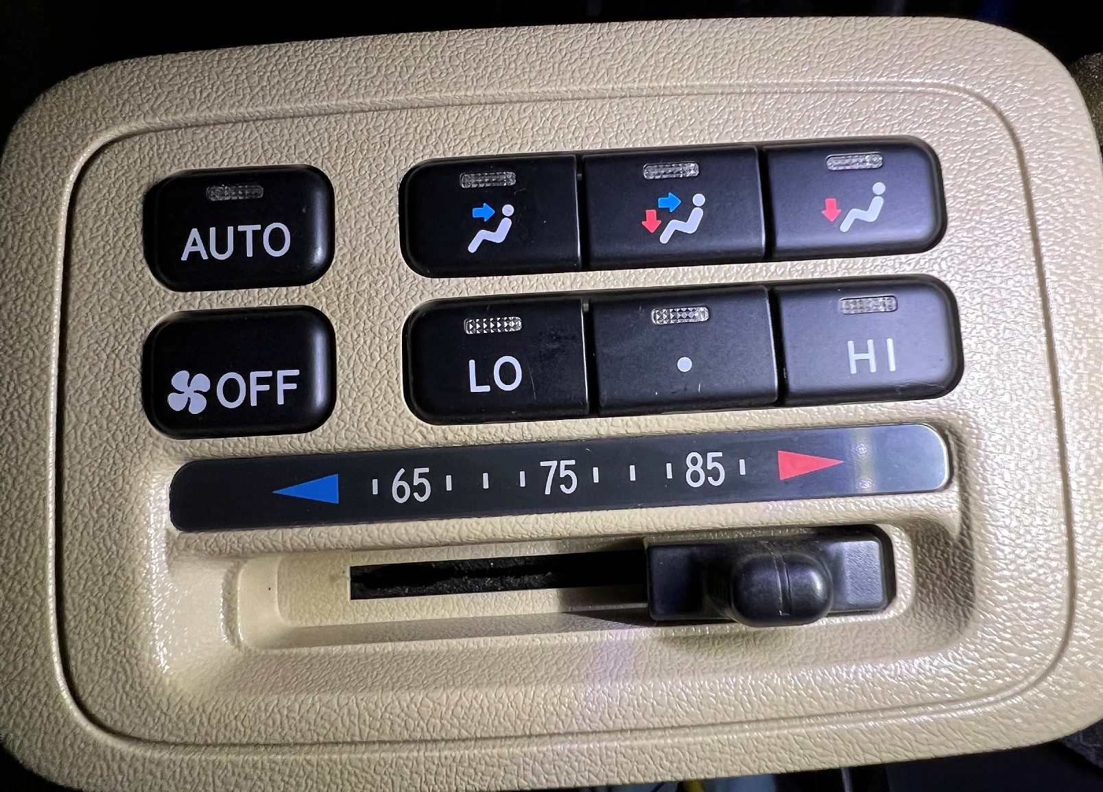

cannot say anything about European market, NA UZJ100L-GNAEKA does not have rear heater.
Here is the control (88610-60121-B1):
Note how it depicted on the buttons: hot air comes only to the feet, while AC only blows from the top.
You can switch rear control ON only from console, and it can be switched OFF either from console or from it's own button OFF.
Heat will control dampers to deliver hot air from the rear central console registers and will switch rear blower under the driver sit.
Cold will switch the rear AC on (rear right quarter panel, right after the wheel well), and it will blow cold air from the headliner registers.
@Christian @tucker74
Hi,
I believe that's how my LX is too... but I don't sit in the back. :rofl:
North european versions doesn’t have rear AC, but rear heater, just like the 40, 60 and 80 series did here, usually located under the pass. seat or centre console.
I thought the “REAR” switch was for that?
The biggest thing is my HVAC doesn’t blow down towards the feet.
