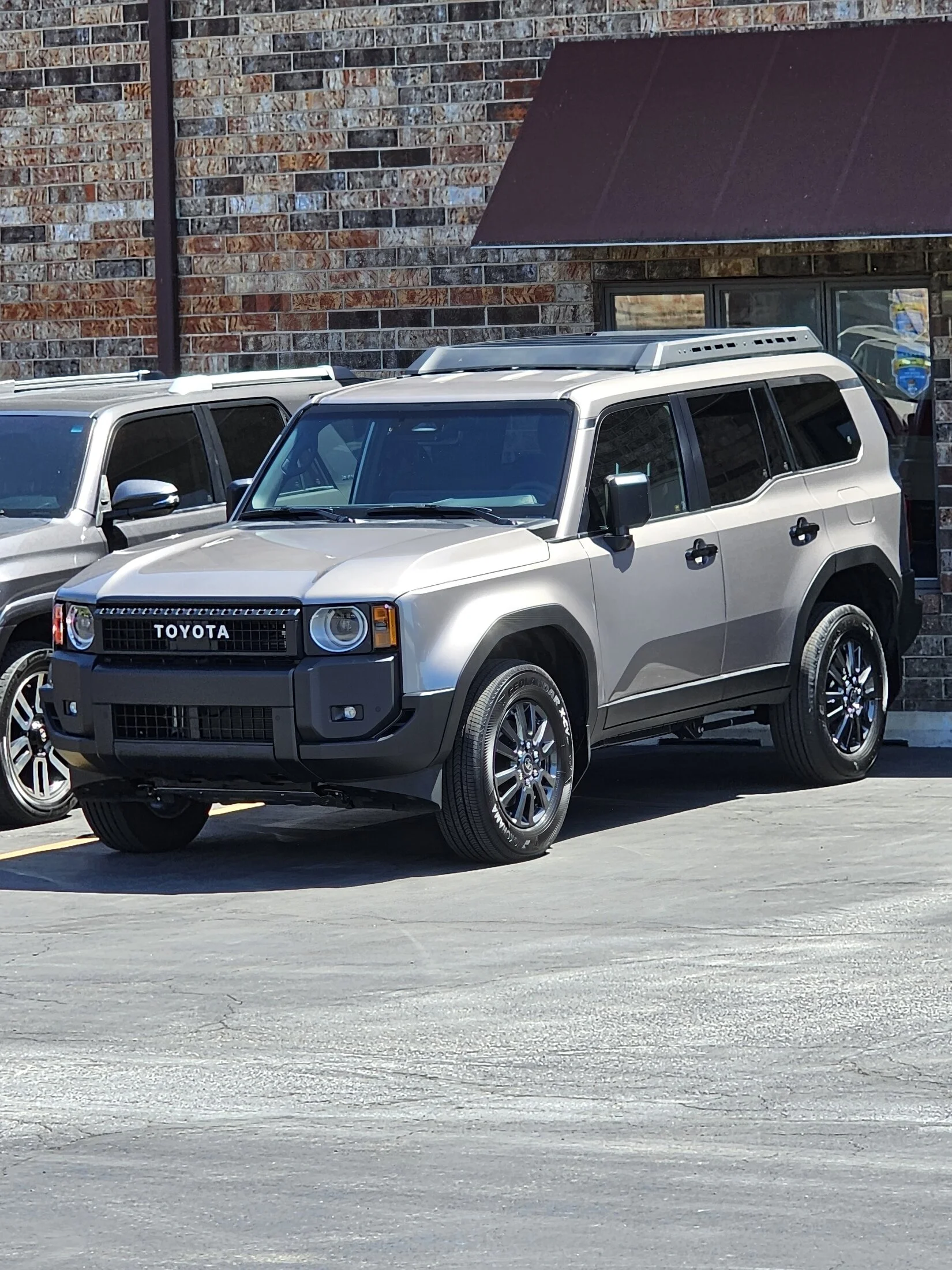

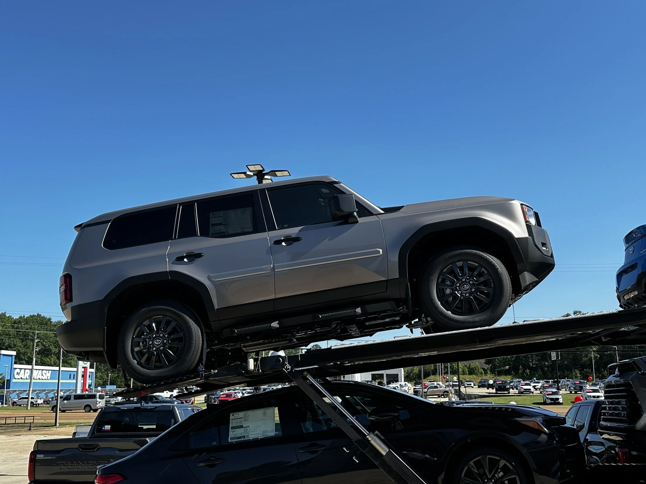

Mine just landed in Mississippi

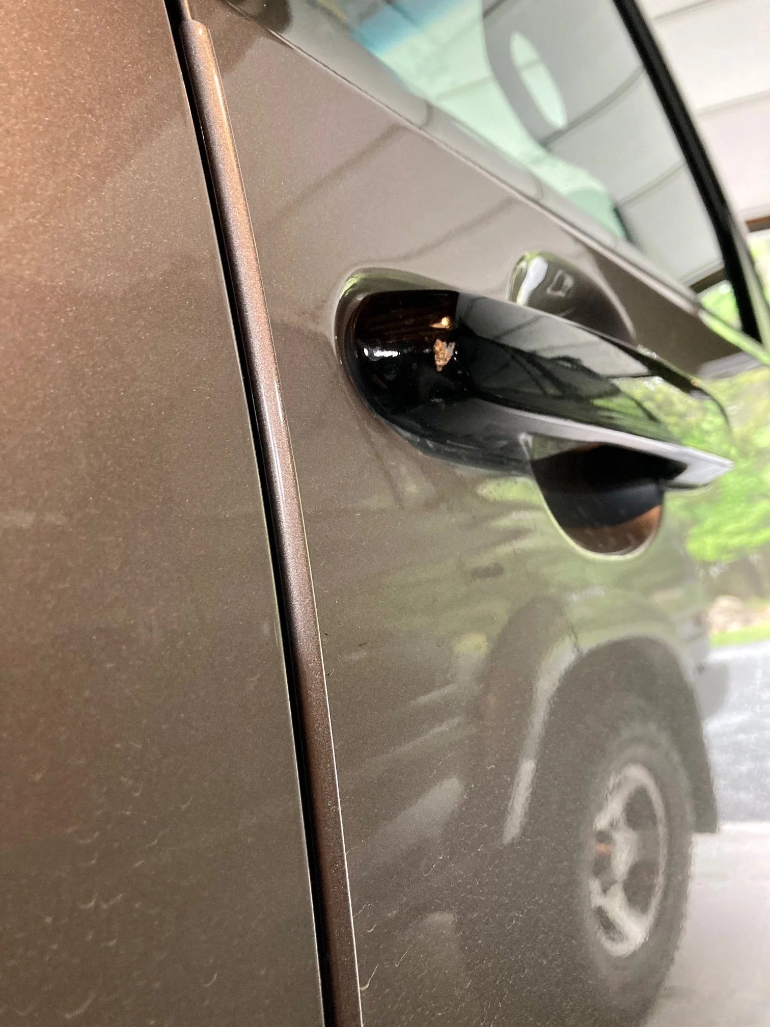

Is the door edge guard clear, like extra thick PPF? If so and it's anything like the ones on our Silverado horse hauler, they're actually the best thing I never wanted (until I had them).
Painted and thicker than PPF. Not really noticeable with the doors closed.

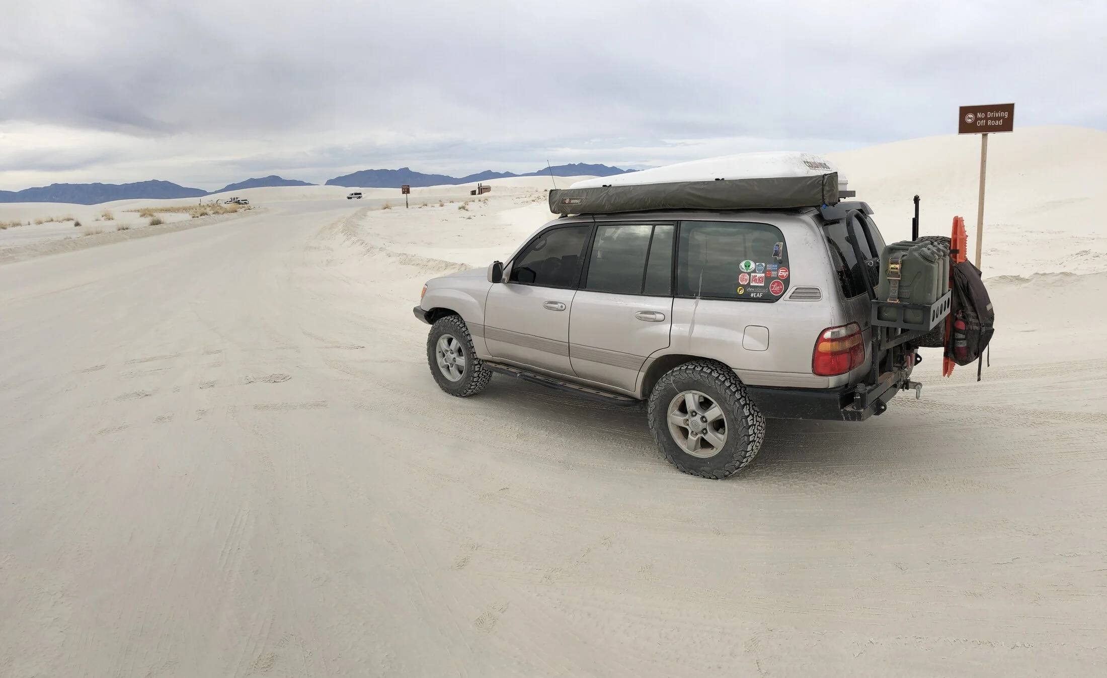

Leaning more towards a 285/75R18 right now. Not sure what will be “too much tire” for this power plant yet. On my 100 and 200, 34s were the max before it became unpleasant to drive without a re-gear.
Yeah I have 34s on my 200 and they are truly the perfect tire. As I said, since it’s going to be a DD for my 22 year old I just want it to look a bit cooler a not have to deal with cutting or spacers
For mine in particular, I'm not sure. It hasn't arrived yet. But I'm thinking they are the ones like @HeadacheManNYC posted.

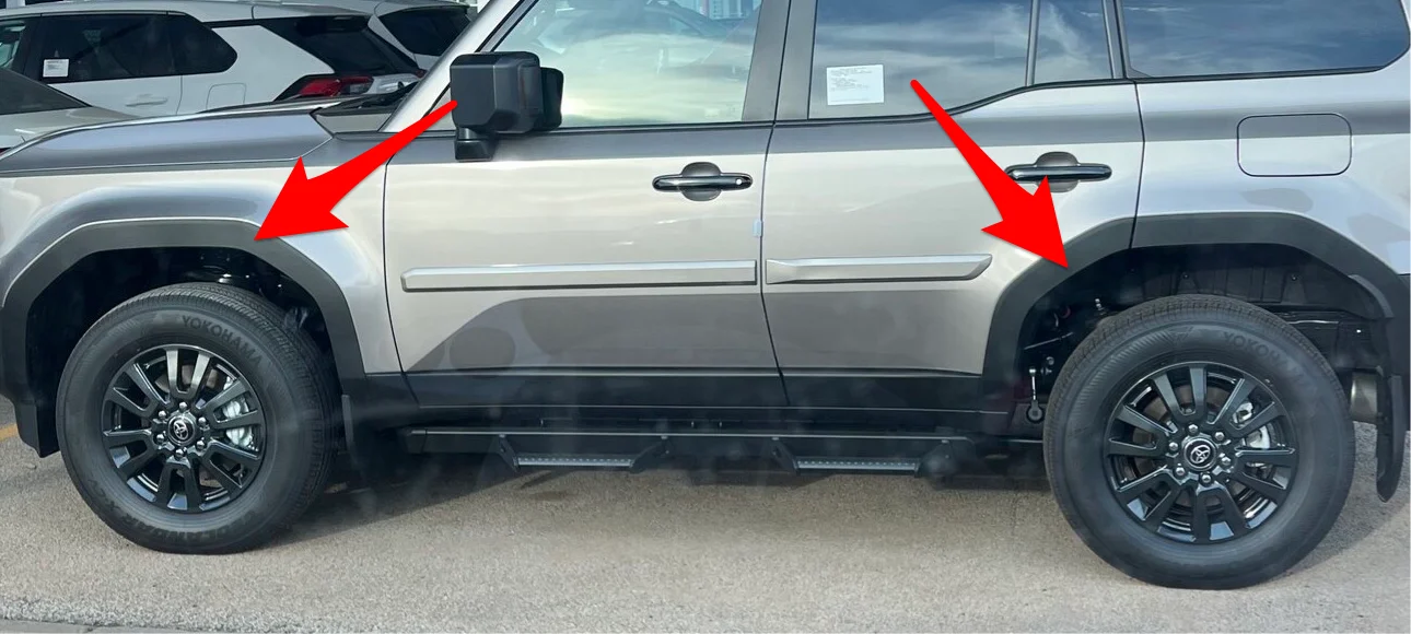

Wheel well moldings will prevent stone chips. That’s why they’re there.

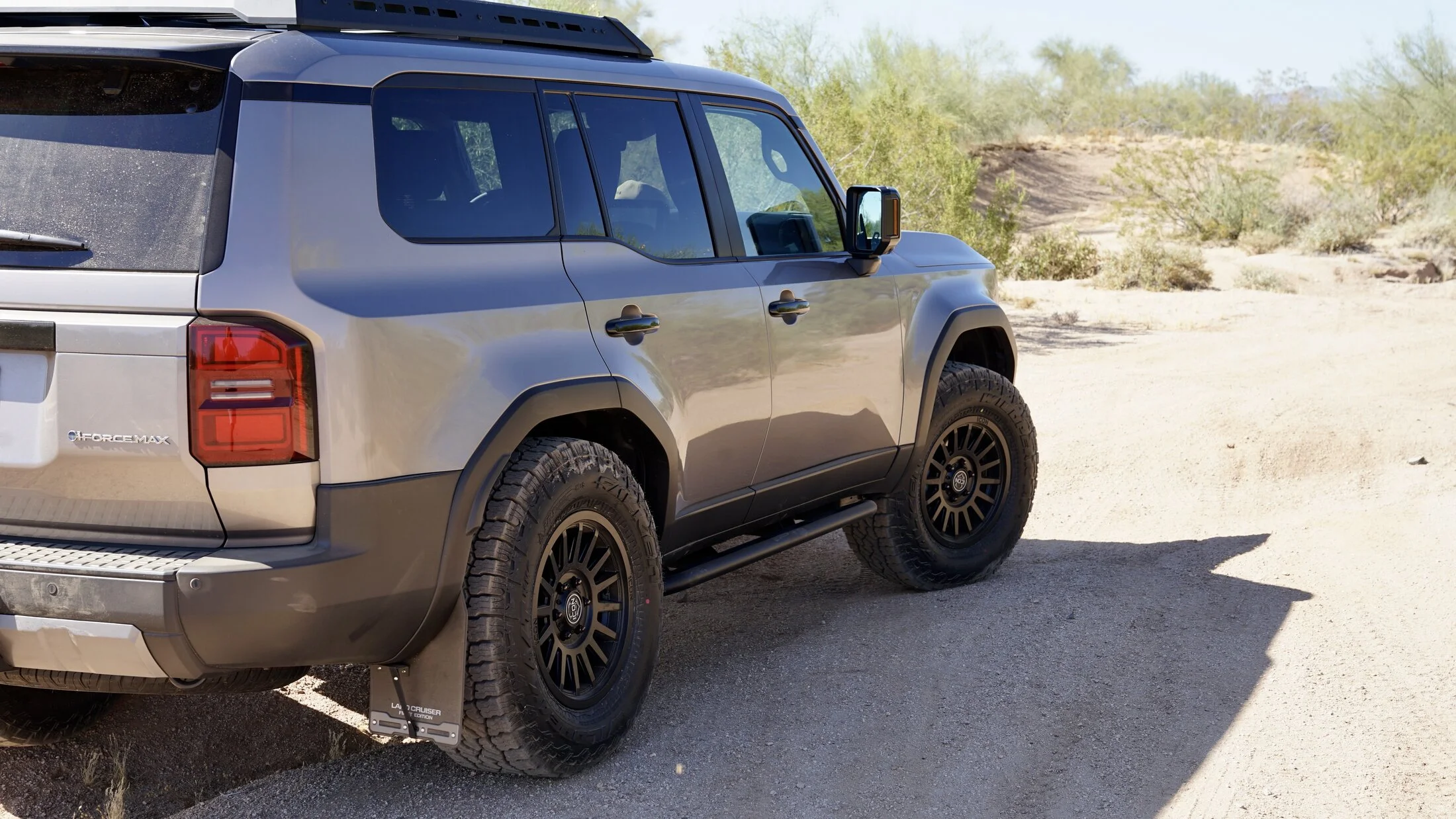

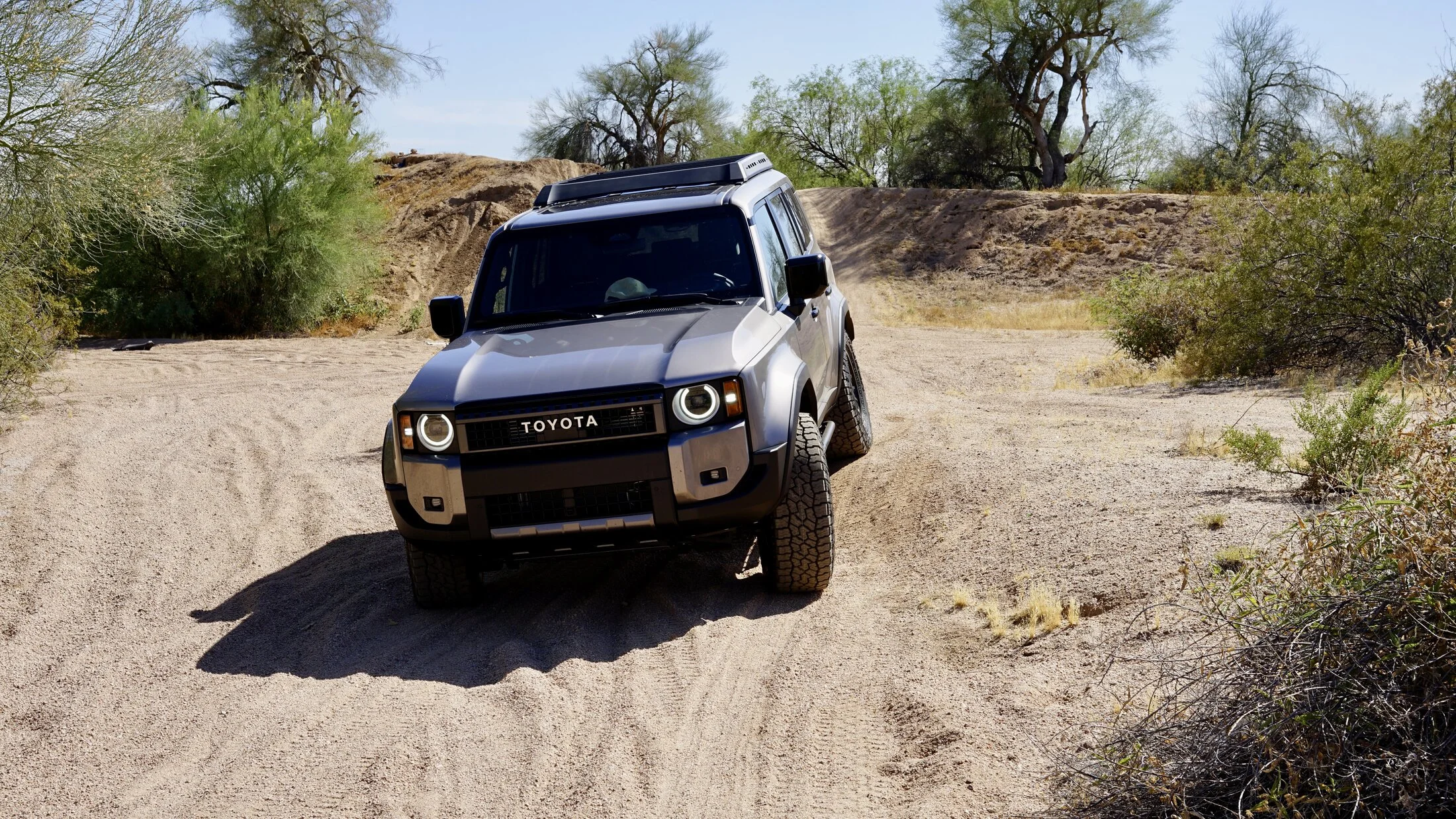

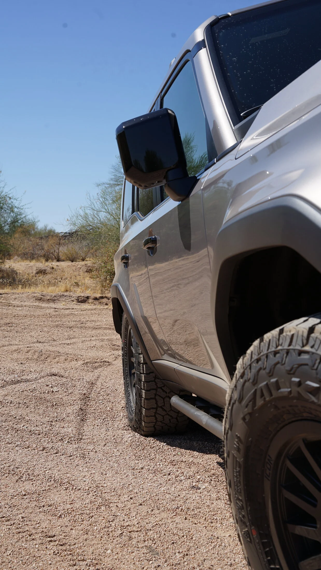

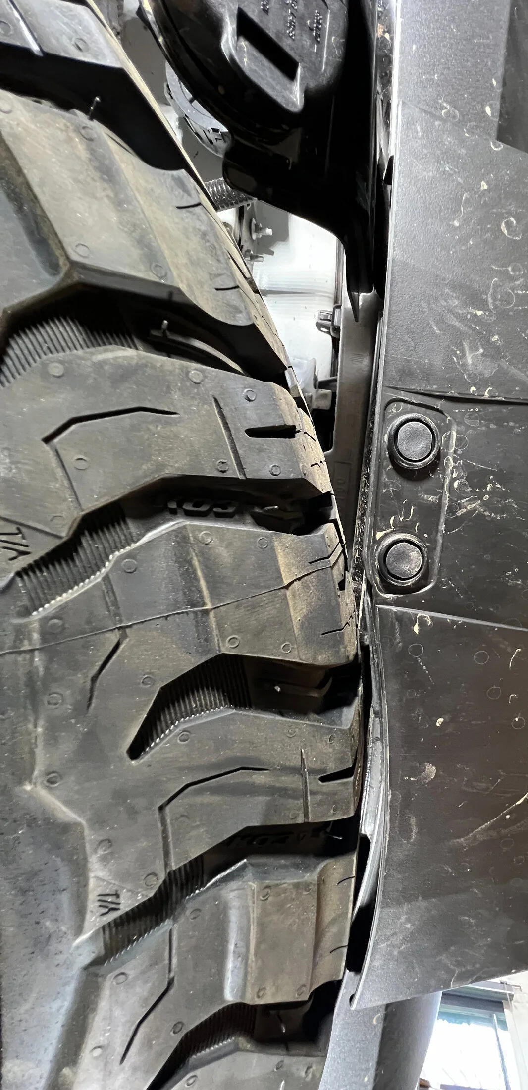

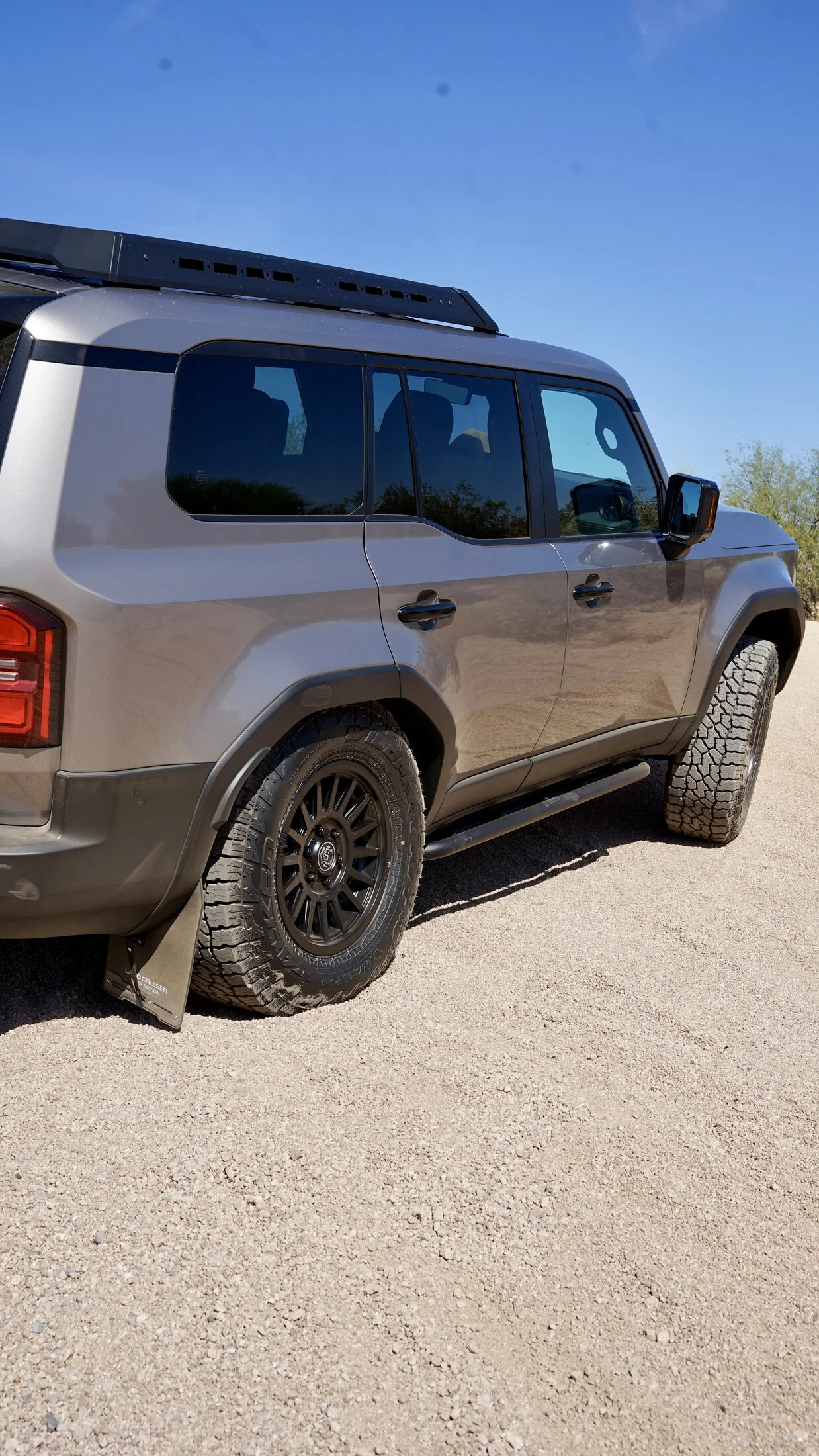

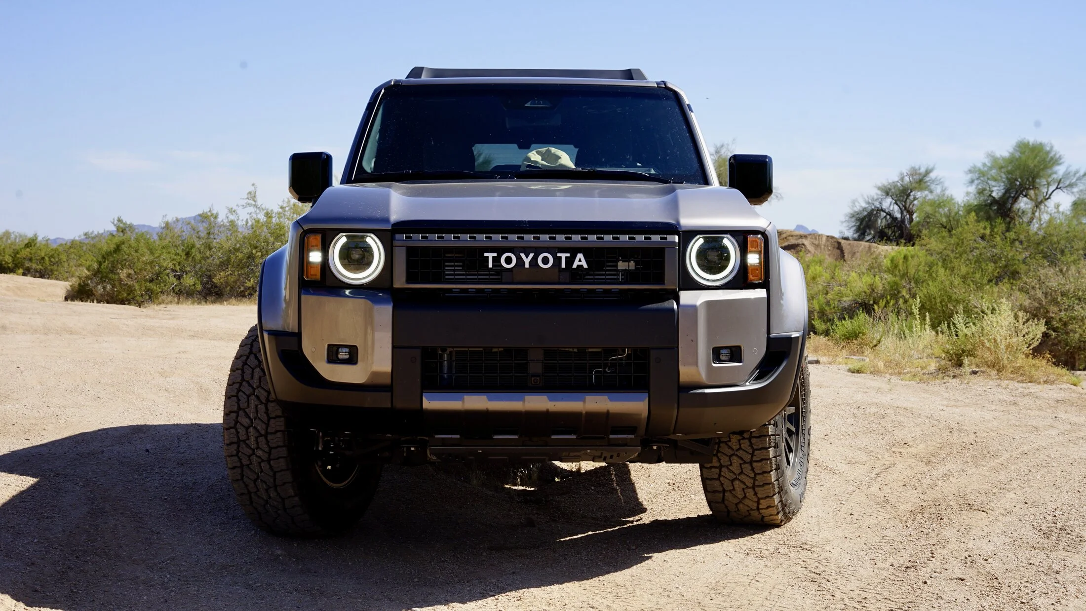

The start of my build. Coming from a 200 series. First step was wheels and tires. I removed the air dampers on the front fascia and the front mud flaps but not sure it was 100% necessary. No lift or any further modifications. After a 30 mile trip, no noticeable road noise and lost about 1.5mpg.
Icon Alloy Recon SLX 18x9 +40 offset
Falken Wildpeak AT4W: load range C, 285/70/r18 33.7 or Falken claims 34”
I took it over into the desert by my house and tried to get some rub but never felt or heard anything. Here are some quick photos I grabbed but I would say, success!
Did you get a matching spare? Can't quite tell.
