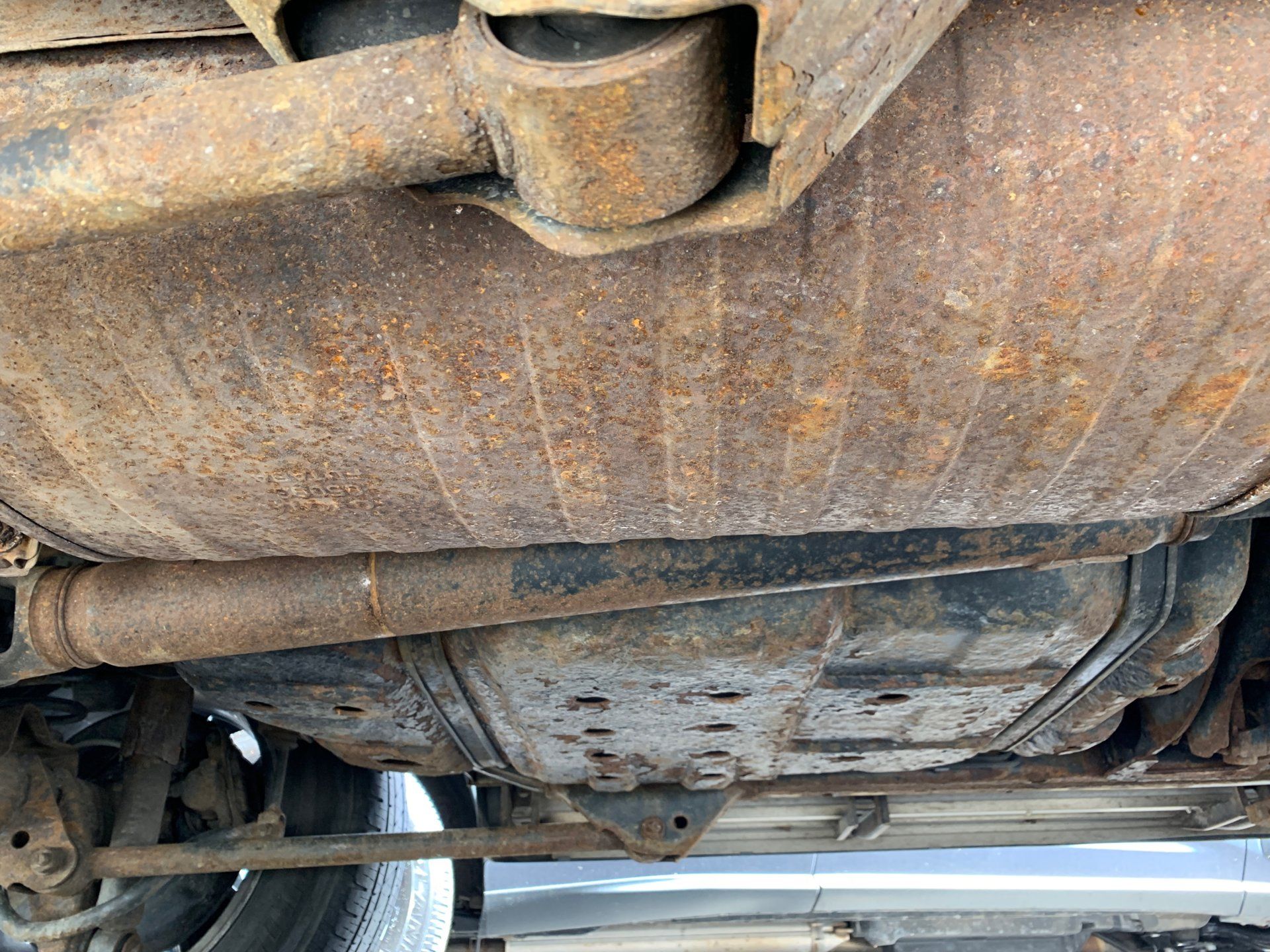

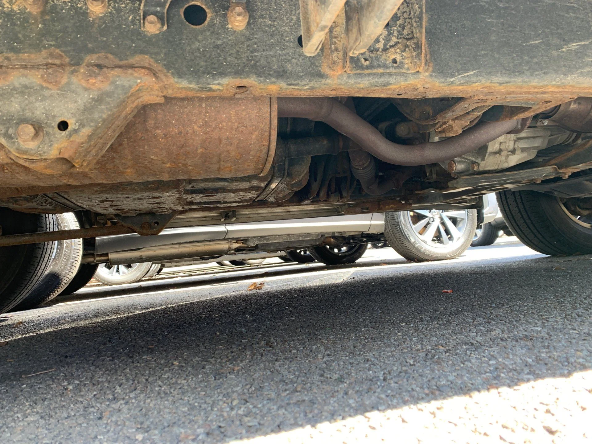

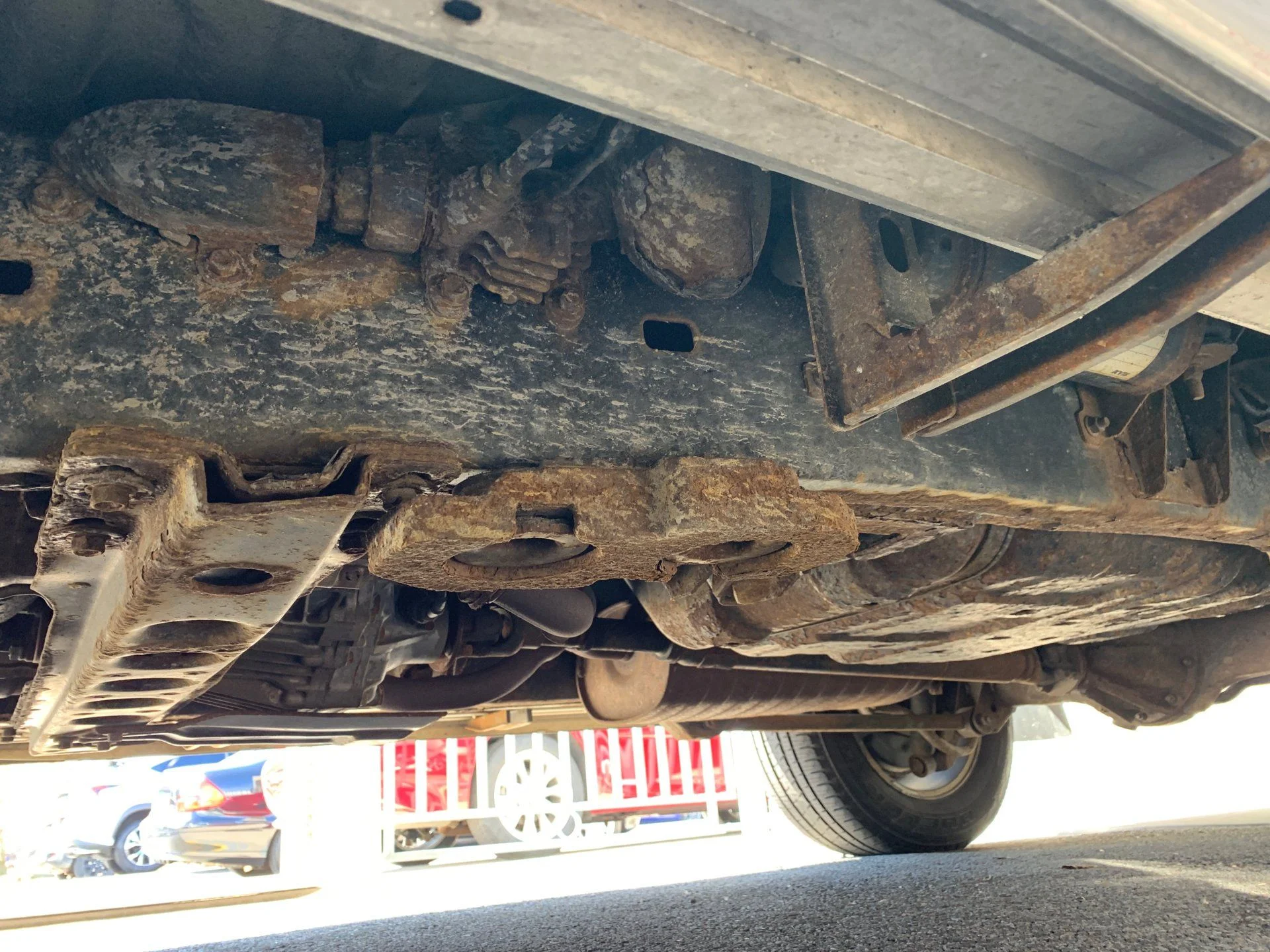

I’m looking to buy this LC 100. It’s one owner, no accident 150k miles, body is rust free but has this under body rust. Please help if I should buy this at 15k or not:
That transmission cross member and rear trailing arm looks like it's about to just fall apart. Also have never seen an accumulator rust to the point where you can see the inside. Pass on this one

I recommend trying your luck and buying a southern one sight unseen, even if issues come up (like accident evidence, poor body work, mechanical neglect, etc.), all that stuff can be fixed. Nothing really fixes the amount of rust that truck has that you posted. That ain't no surface rust lol.

Agreed, that ain't surface rust, stuff is flaking off and is potentially falling apart. Imagine what the inside of the frame looks like if this is what's on the outside. That's the thing with boxed frames, the little holes allow salt and chemical to splash in there and it just sits and rot away from the inside. My Tundra has an open C frame and i can rinse off the salt a lot easier.
It is pretty crusty. I am not scared of a little frame rust but that one looks to be pretty crusty. That rust is really hard on the air ride systems. 15k for any 150k miles LC with that kind of rust seems high. If your plan is to just drive as stock then it may very well give you trouble free miles. If you plan to abuse it on trails and add lots of overland part mods then pass.

Youd be better of with a 200k clean dry climate truck. No amount of POR15 can revive or mitigate that crust- as FX said this is what you can see, theres more that you cannot.
You will spend a lot more $$ over time simply replacing rusted components,
drilling and tapping broken frozen bolts. Because of this, the cost of labor for replacement components will increase significantly compared to a rust free truck.
Have patientce and find a cleaner example. This is a below average example not worth putting 10k into let alone 15k+ all the thinngs it will need.
That rust isn't the worst I've seen, but should definitely be accounted for in the price. $15k is too much for any 100 with that much rust, there are virtual rust free ones for around that.
