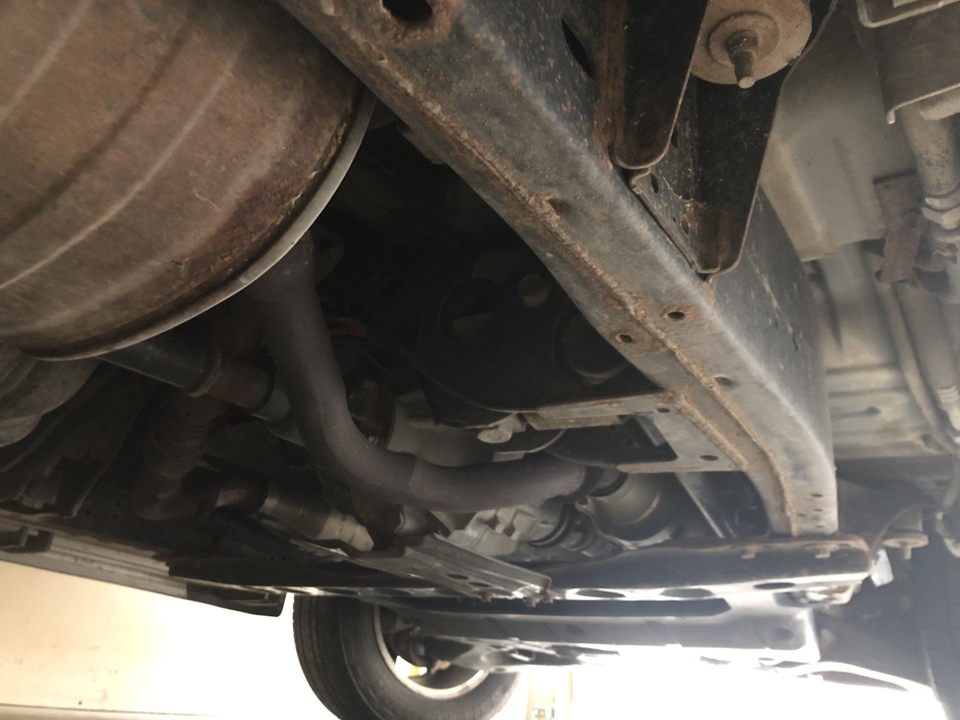

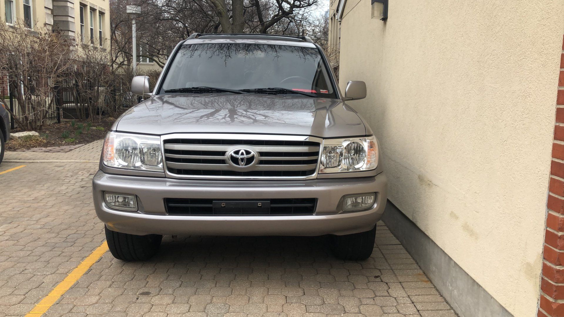

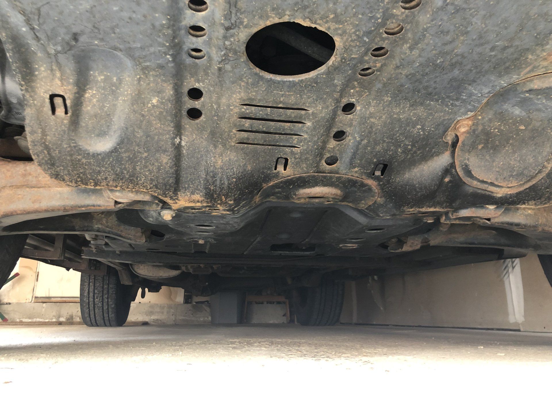

After a lot of research I got this 06 195K miles, 3 owners, w/o factory AHC, clean Carfax, no service history. I got it from dealer in a small town in Missouri, and the car is mechanically brand new. Minimal surface rust in the rear, but clean from the front. Probably the mechanic who worked on this car, never entered the services in the Carfax report. Driver side fender is replaced, probably for cosmetics. Paid 10.5K
Week1 update - drove it into a car wash and broke the oem antenna
Took it to my mechanic, and all he said was front bearing hub needs tiny bit of work, timing belt was recently done and after market shocks were put in about 50k miles ago. So thumbs up from him.
Much better! Congrats. Great truck.
Much better deal, that's a great price for the year and mileage. You should do some preventive trust treatment to this if you want to keep it for a long time. For starter, take a grinder and hit the weld spots on the frame until bare metal then clean it up and apply POR15 onto it. Then after everything is dry, spray fluid film inside the frame where there's an access hole, that way it'll slow down the rust.
I’m surprised it still has that much rust underneath being in Missouri. I know they salt too but they get nowhere near the snow and salt we get here in N. Illinois. Congrats on the truck man!
