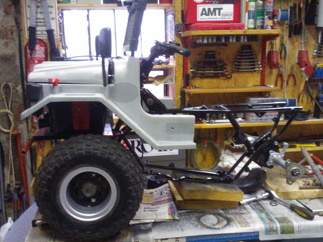

Suzuki LT50 kids quad for 50€ from ebay + a spare frame.
Quick put on each other just to get a picture.
Electrics.....need indicators, light, horn, cigarette lighter.......

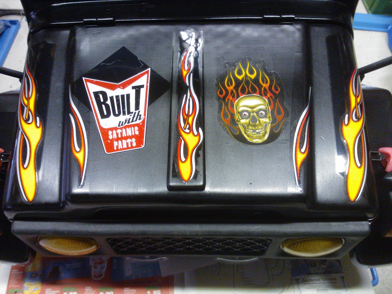

Stickers......there is some cool stuff out there.
