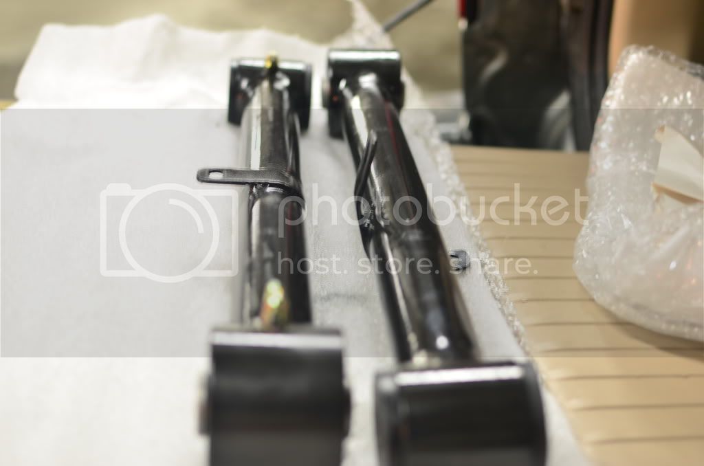

Did you get the fixed length or adjustable lower control arms?
On the adjustable ones, any idea what the adjustability range is: i.e.,
Is the shortest length less than or equal to the stock length?
How any cm/inches can they be extended?
How many cm/inches can they be extended?

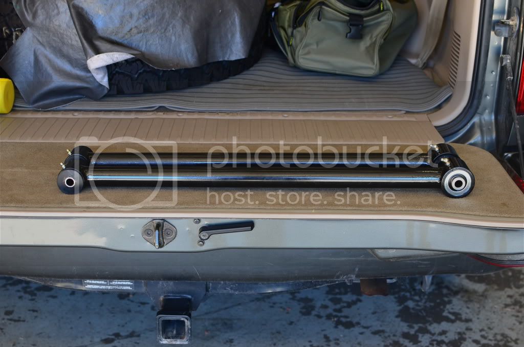

Fixed length. I measured my stock ones center to center and he made them exact same length.
As to how far they can adjust, i am not sure. I will shoot him a PM to jump in here and answer that.
I'll have some pictures of them up after i get the uppers installed as well.
I think fixed length is the way to go unless you really know what your doing, know someone who does or are prepared to make some additional modifications due to adjustment. I've been there and it was a huge pain in the azz.

It would change the pinion angle in the rear. Which could cause excessive u-joint where and vibrations. There is a fine balance from what I know.

The lowers that Layton installed are fixed length. I am also making him a set of fixed length uppers. Both to match stock length.
Both uppers and lowers are also available in an adjustable variety as well.
I generally build the adjustable links 1/4" shorter than stock when adjusted fully in.
The useable adjustment range is about an inch.
Stan
Just to see the difference..I removed one of my LCAs and laid it next to my FJC/4runner aftermarket All Pro LCAs. The stock Land Cruiser LCAs were about a half inch or so longer.
It should be a no brainer to buy the adjustable ones and match them to the OEM length and then mount them. Am I missing something? Layton, just curious why you chose fixed vs. adjustable, was it strength?
The fixed length set sells for $285.00, the adjustable varient is $360.00 for the pair. Some people feel they require adjustable, others do not. Just a matter of preference.
Cheaper for one, and i don't have much of a need for them being adjustable. I'd rather just direct replacements.

I didn't get longer rear lower links. I got fixed length, same length as OEM, just beefier and with a johnny joint on one end for easier axle articulation. Making them longer or shorter will change the position of the wheel in the wheel well as well as change the pinion angle. I have heard some folks contacting their slee rear bumpers with 35s on compression. So shortening the rear link might help reduce that problem.
A inch of adjustment isn't going to lead to a lot more articulation. Longer links do allow for more suspension droop, but you'd need to redesign the link mounts and have significantly longer links, no 1 inch longer to actually gain anything.
But yes, you can gain more travel out of the rear by using the OME Ls. I just don't like OME shocks after running them on two separate vehicles.

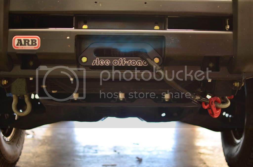

Got winch installed. Custom made a bracket to hold it on one of the lower light tabs on the ARB. Also relocated my light bar to the upper light tabs but hanging down, so its still under the upper bar.

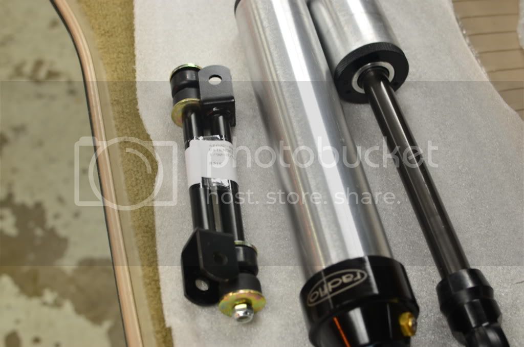

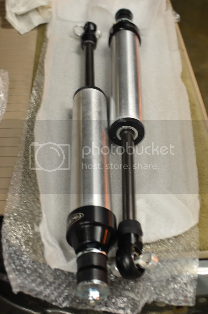

Also got Hardline fabrication services links and Radflo 2.5" rears, and MAF longer sway bar links installed.

I would be interested to get your opinon on the alu hawse you have and how it works for you as I have the same bumper on order and have been told that if you are winching at extreme angles the rope could touch the bumper so you need to space out the hawse.
Yours does not seem to be spaced out to the point a std roller and cable would be to clear the bumper.
Does your front number plate just clip on and off?
