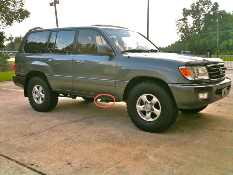

You plan to remove this? :D
Seriously. Looks good. I'm under 6/32 of the tire tread. I might go for BFG.
Have people noticed a difference after removing it? I can only assume some engineers spent a LOTTTTT of time putting that there. Though, a simple test of running with and without should suffice.
