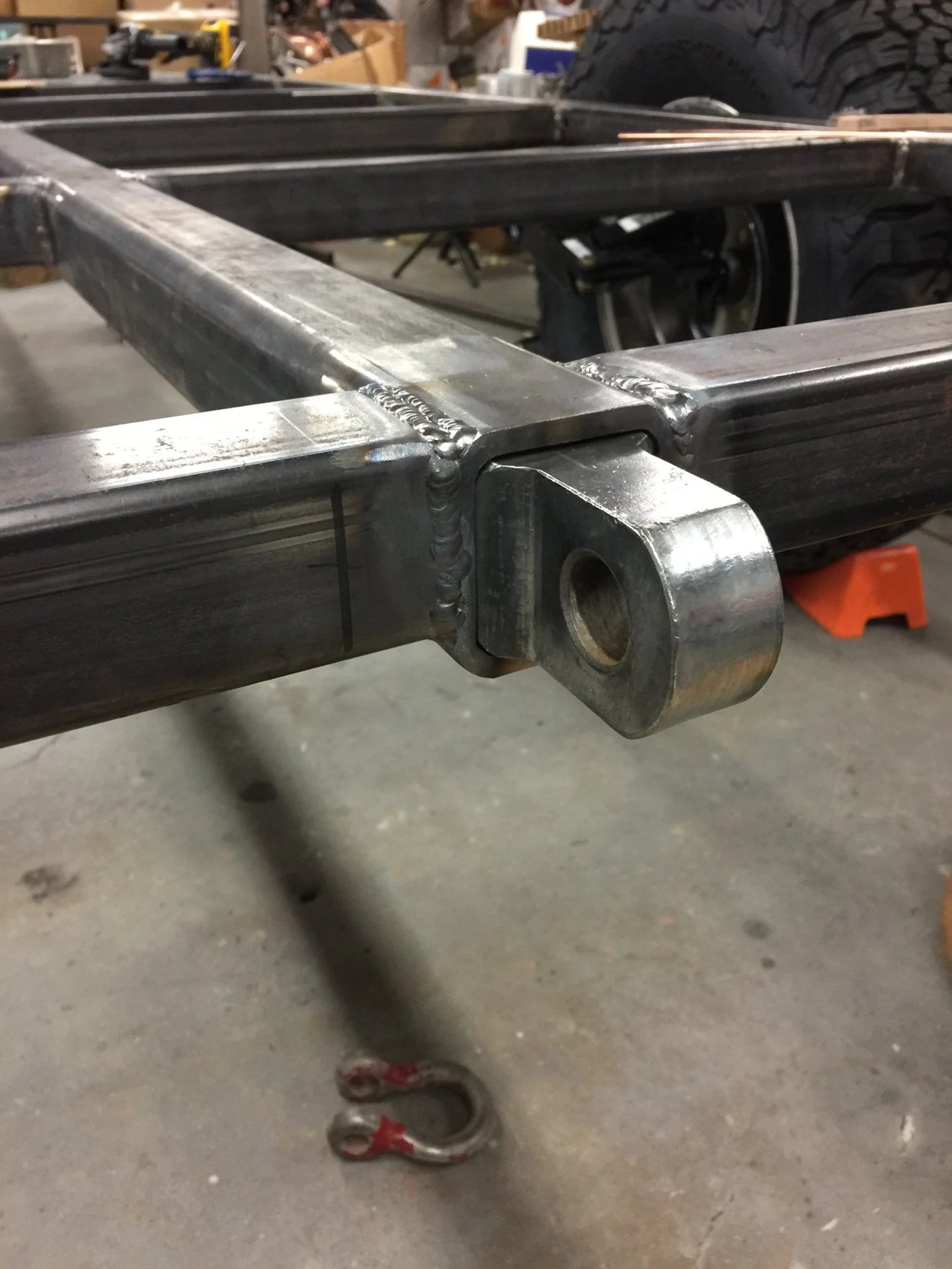

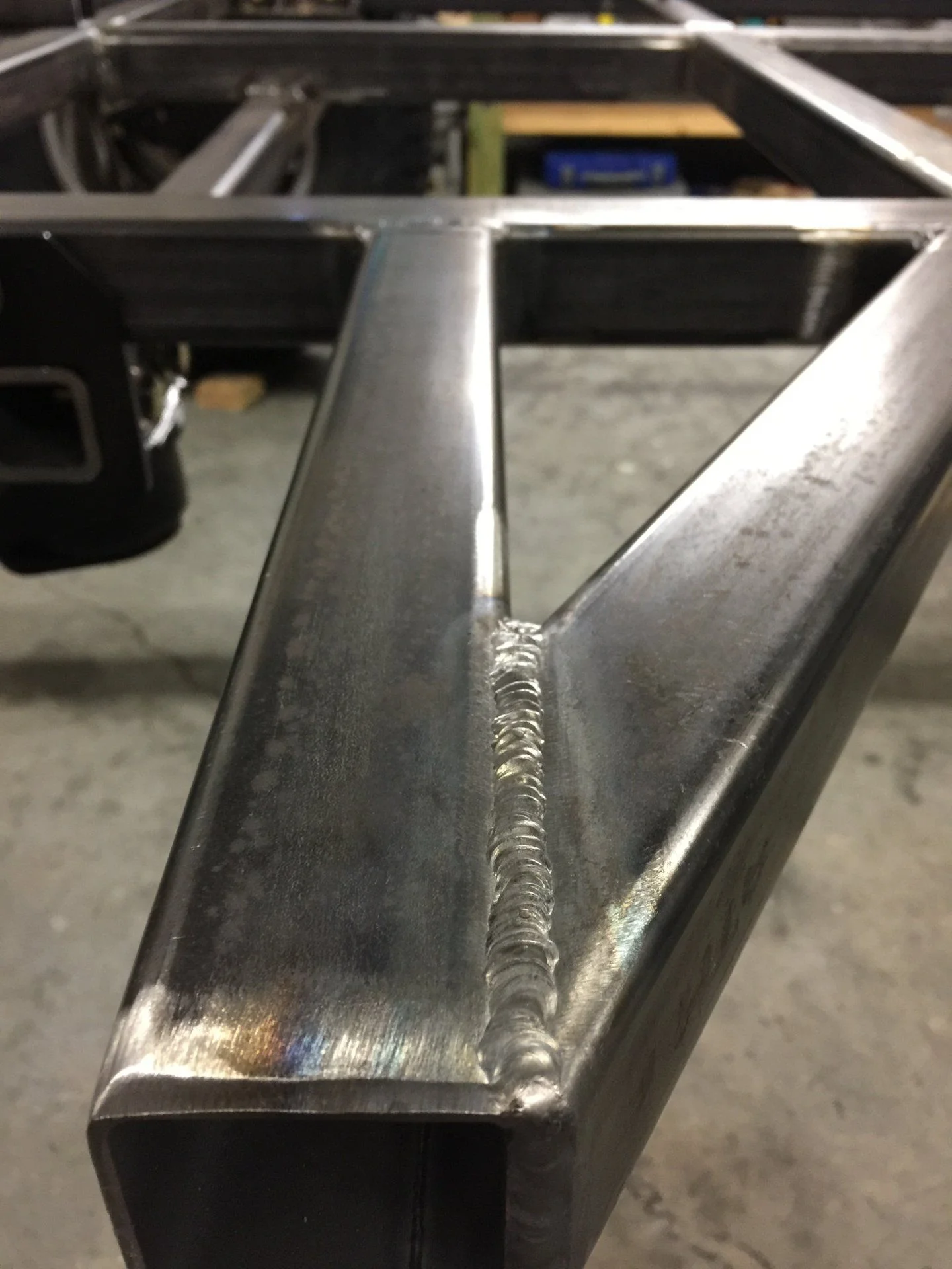

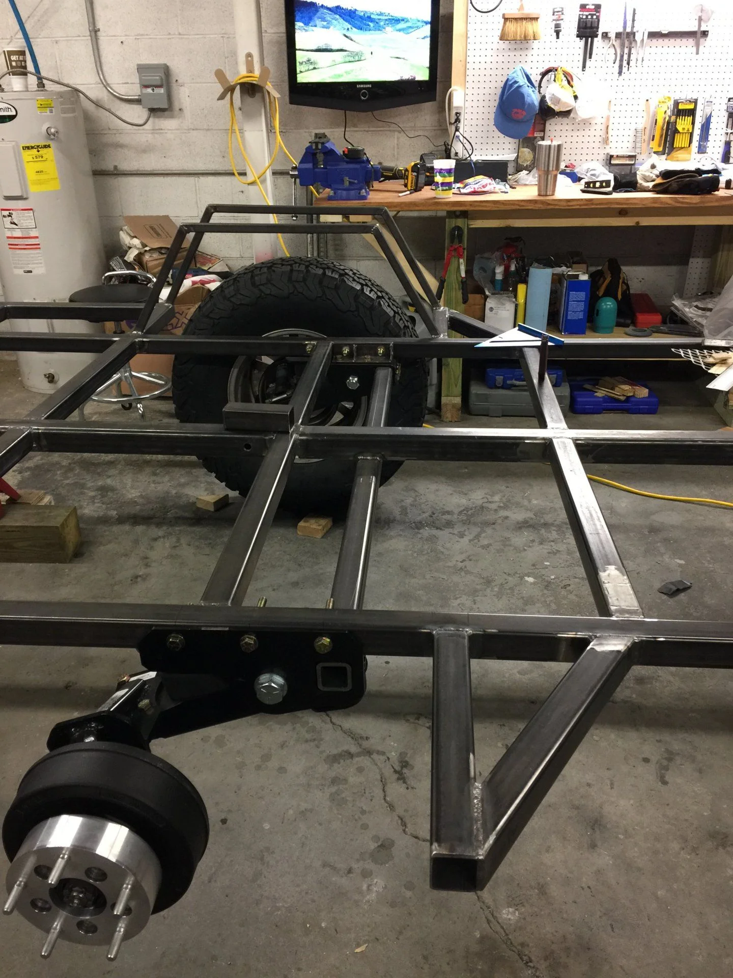

I ended up running the main hitch tube back from the front of the trailer to the rear with a 4 ft section as to have a hitch receiver in the rear. Excuse my poor, beginner TIG welds haha. They get better, I promise.

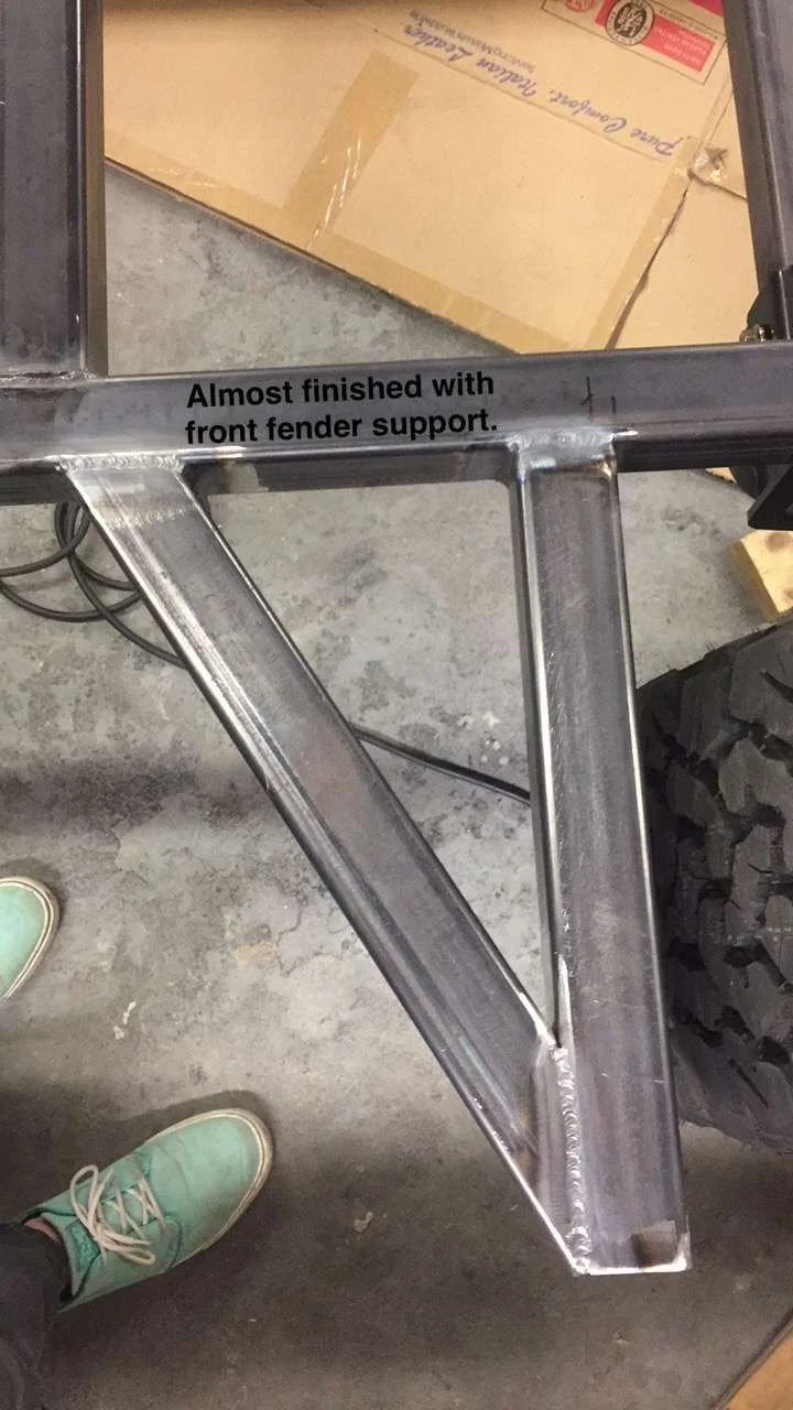

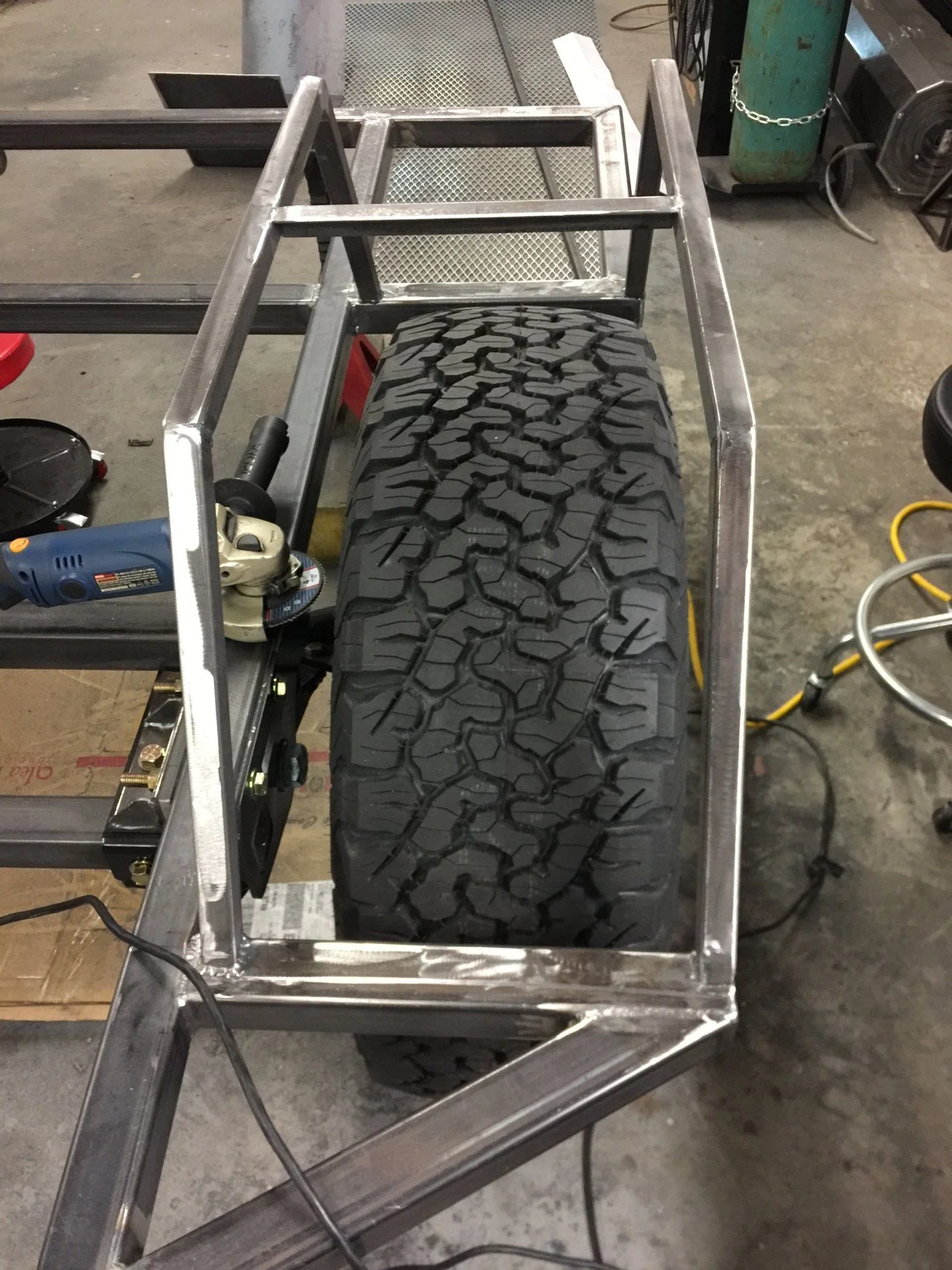

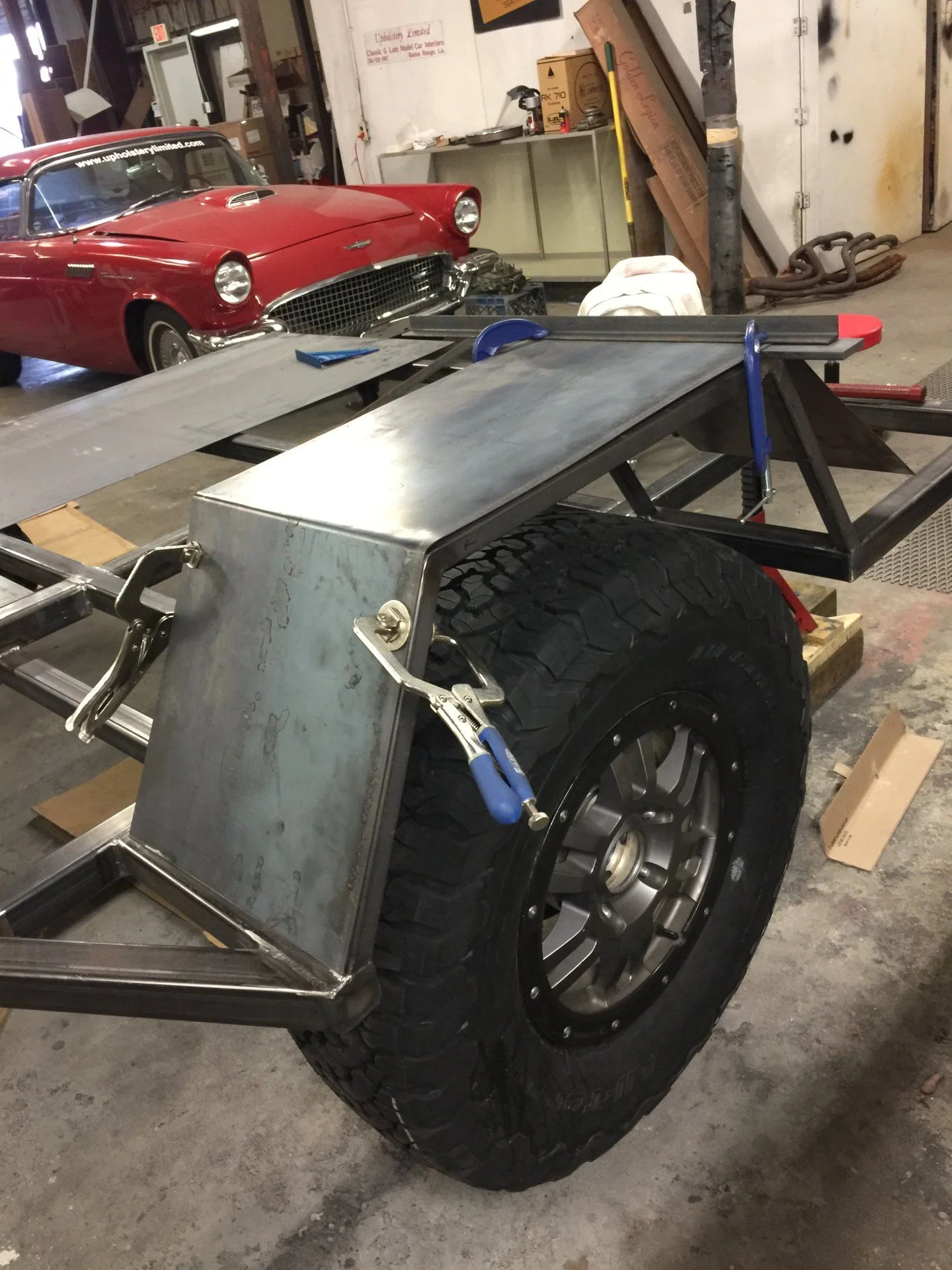

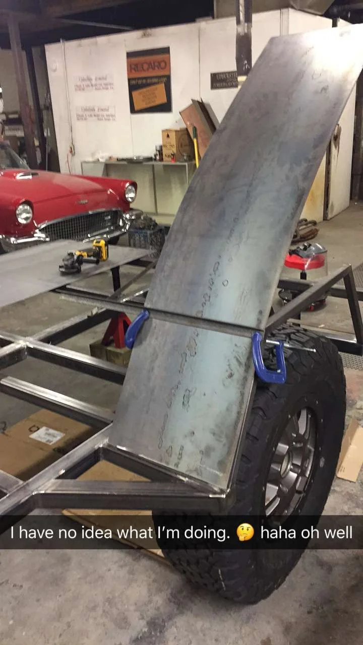

Starting to fit the front section of the fender.
This will hopefully help push the trailer around trees if needed. On the downside I need to mount a marker light here. I might make some guards for the little marker lights.
I tried to TIG weld this very acute angle. Wasn’t possible. I even switch from my gas lens to the standard gas nossle as it is skinnier, still not happening. I had to use the MIG welding and run about a 1” stick out. I upped the voltage and use a bar of a aluminum below the weld to help aid in gas coverage. It came out pretty well.

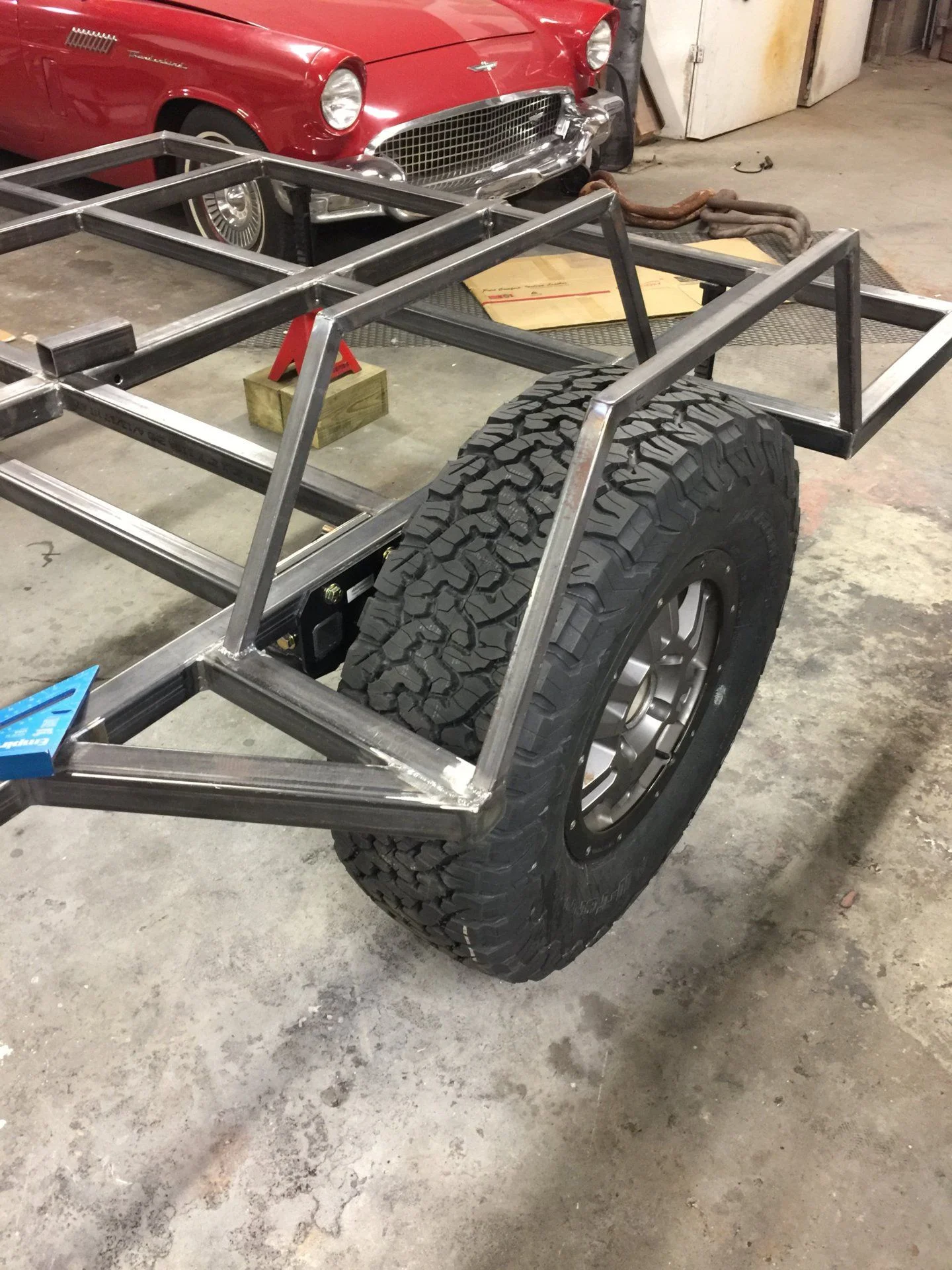

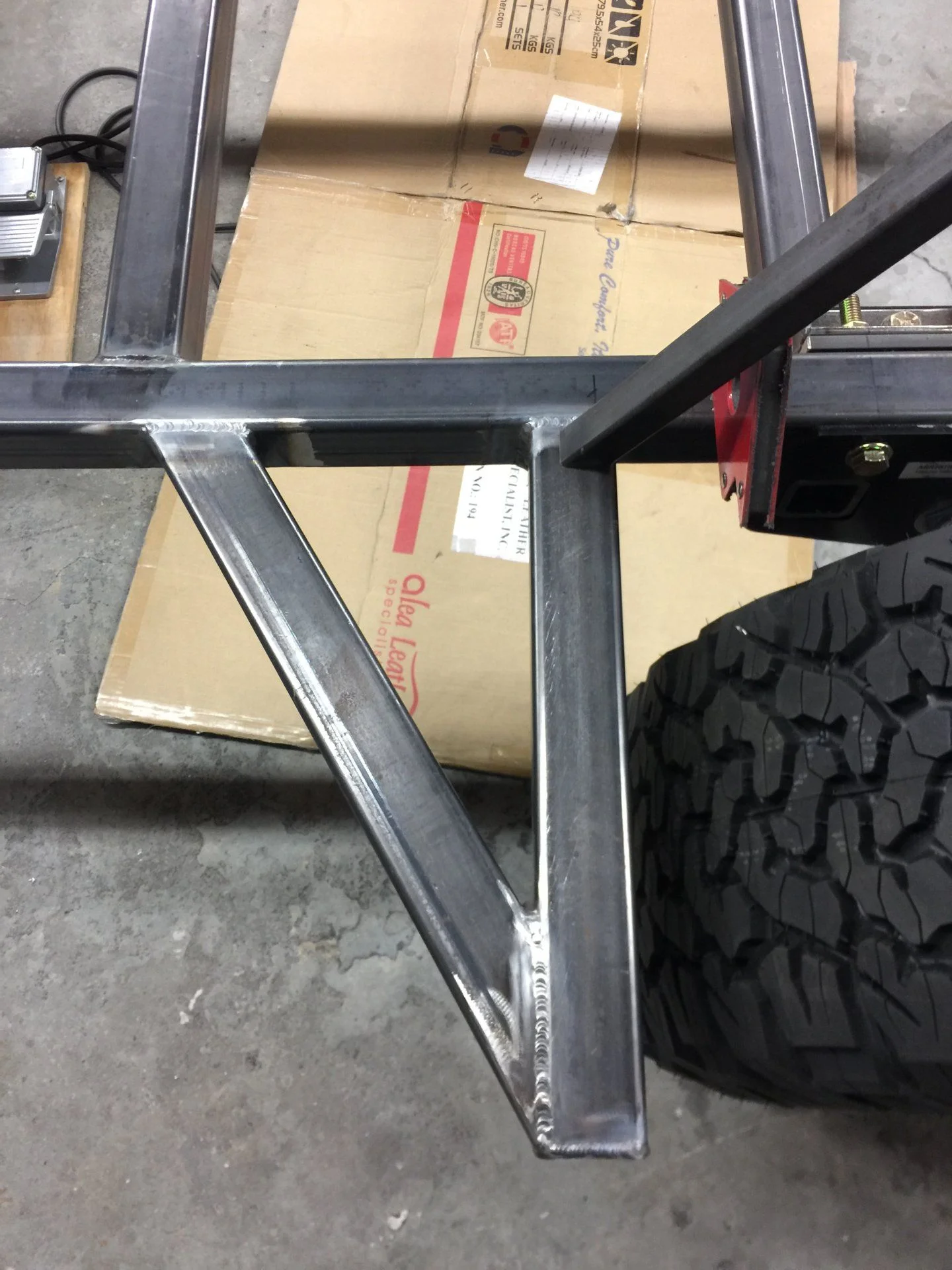

Started the frame for the fender. These are built out of 1” square 16 gauge hot rolled. I added a piece of 1” angle steel in the center as a support and brace for the top of the fender so that I could use it as a step to access the roof of the trailer.

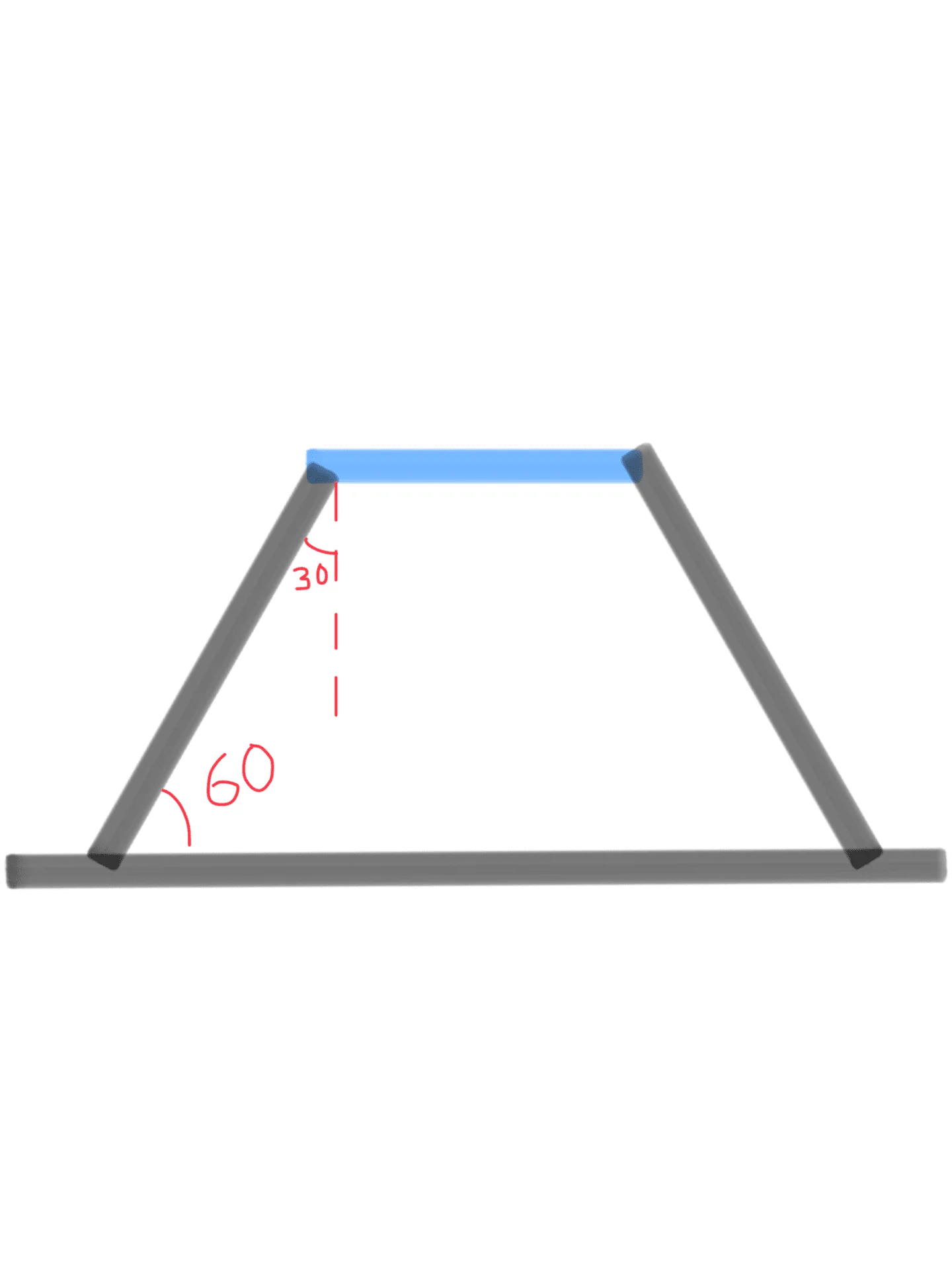

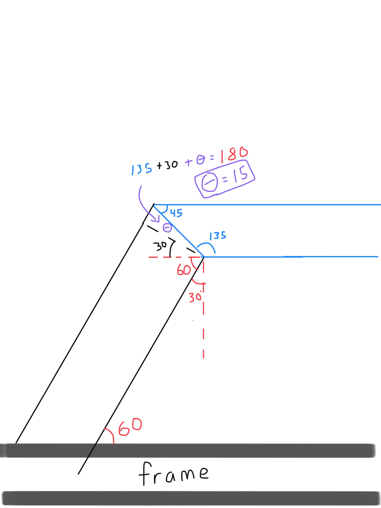

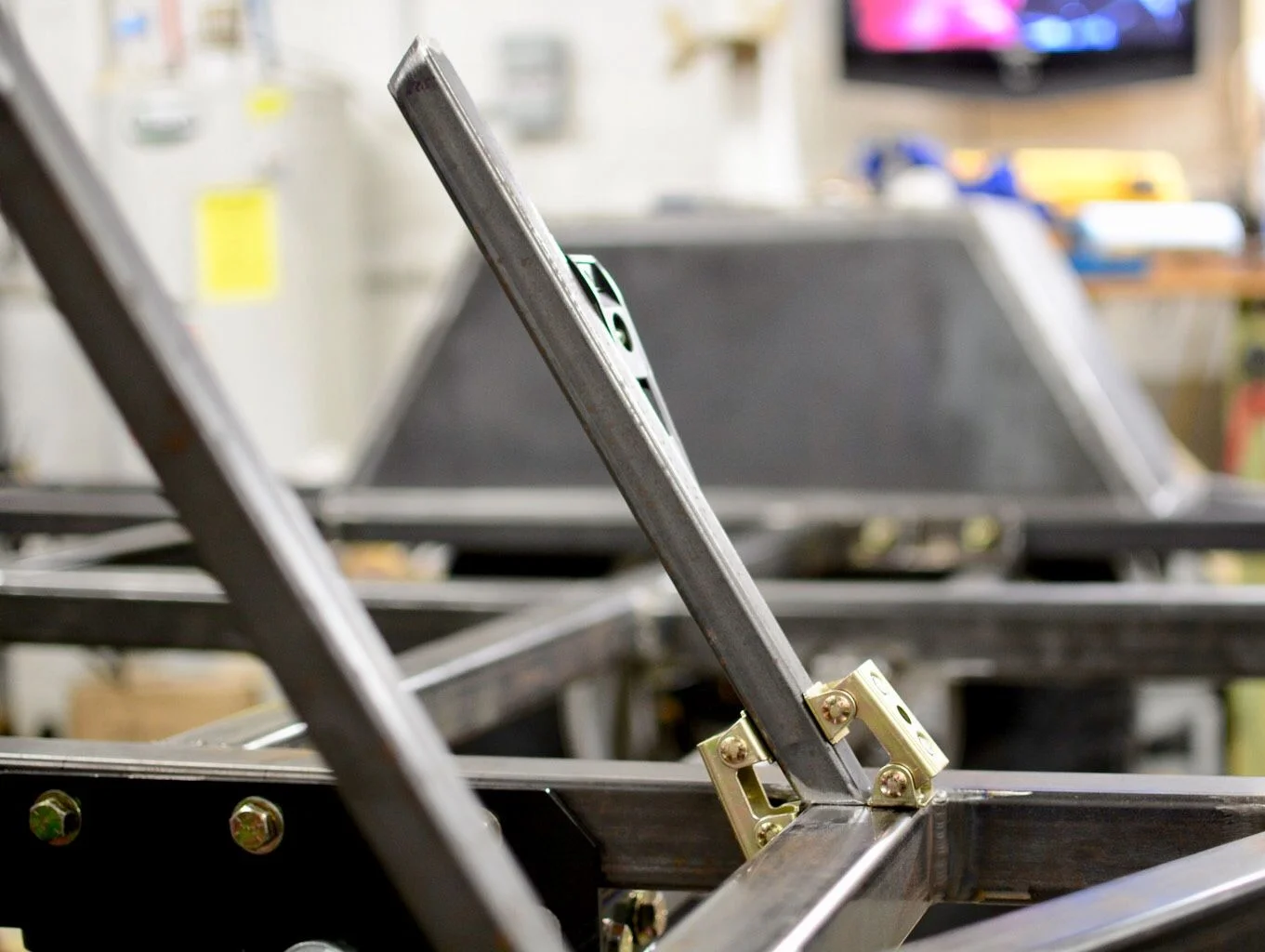

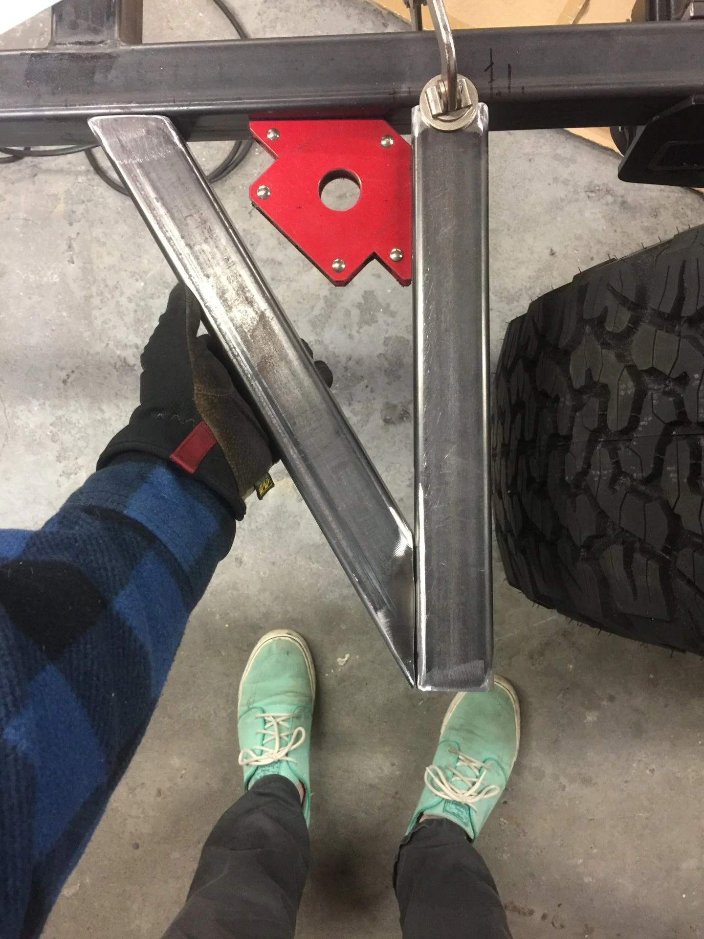

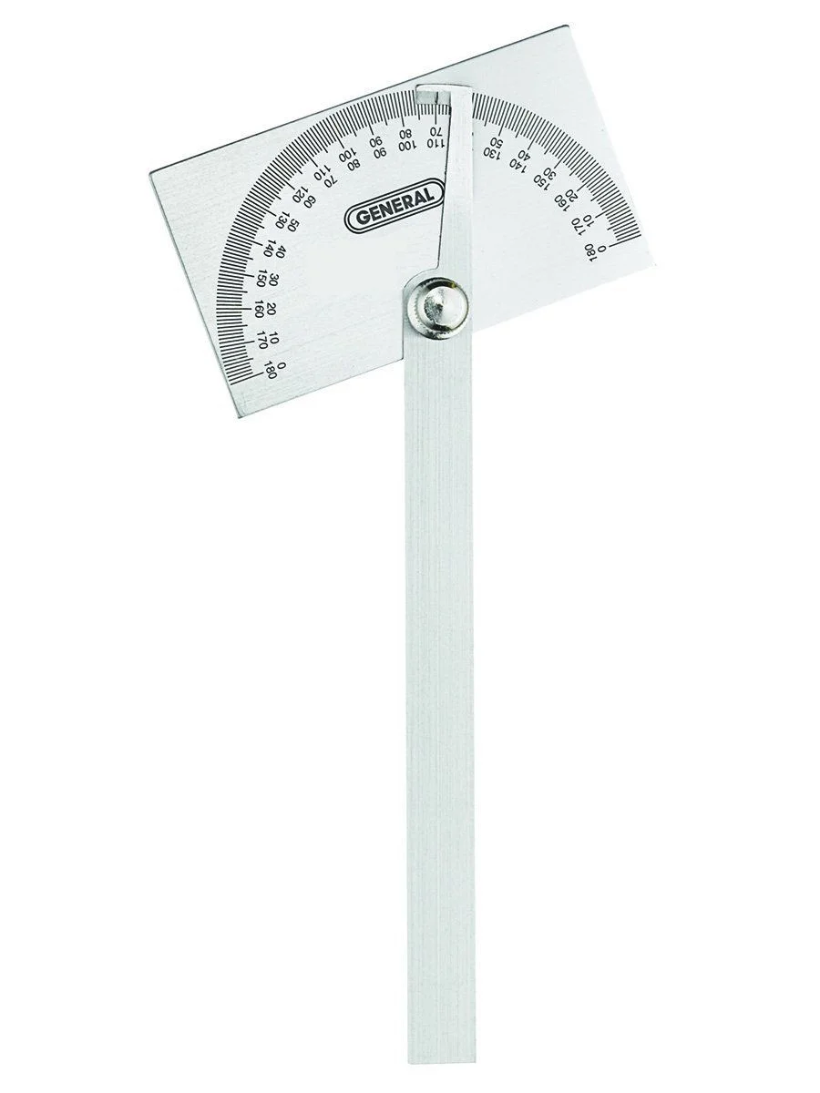

For building the fenders, the maths got a little harder. I needed to break out some pen and paper to figure out the right cutting angle. I wanted the upright to be at 60* (45* would have to make the fenders a lot wider to clear a 35).

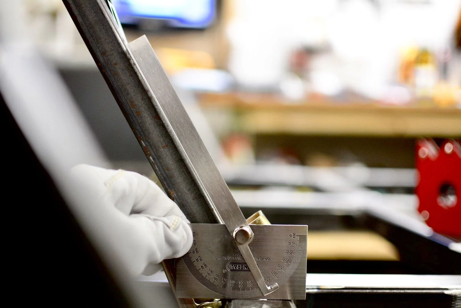

I tried to recreate what I drew with some sketches on the phone. However, if you do make a mistake, using a metal angle finder and the grinder can make things work, as well as a little filler weld haha.
I highly recommend one of these if you are doing some metal fab. At lowes for about $9
Fender cover coming up...

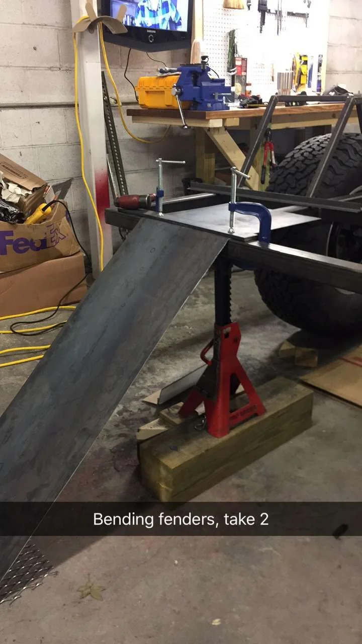

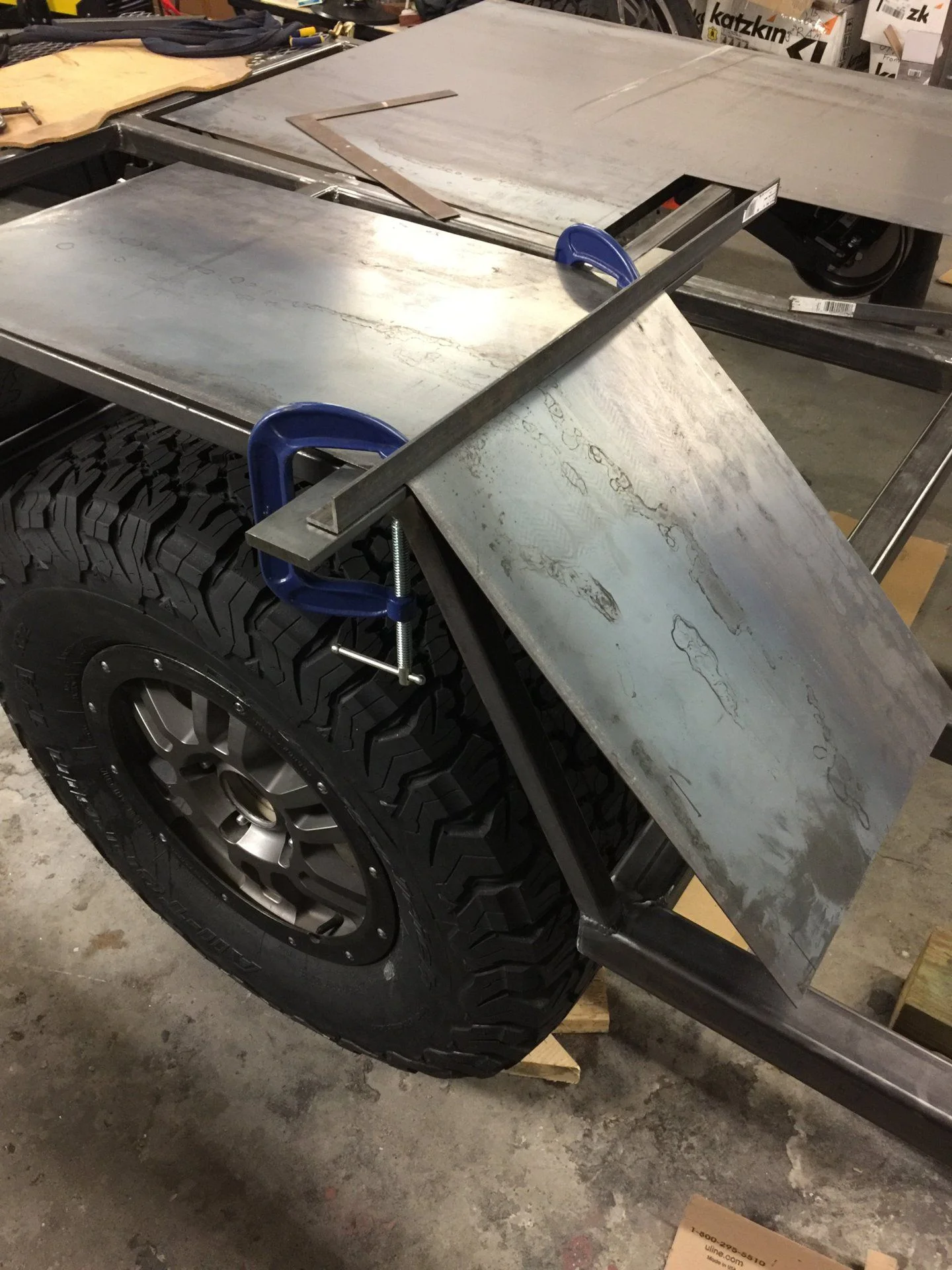

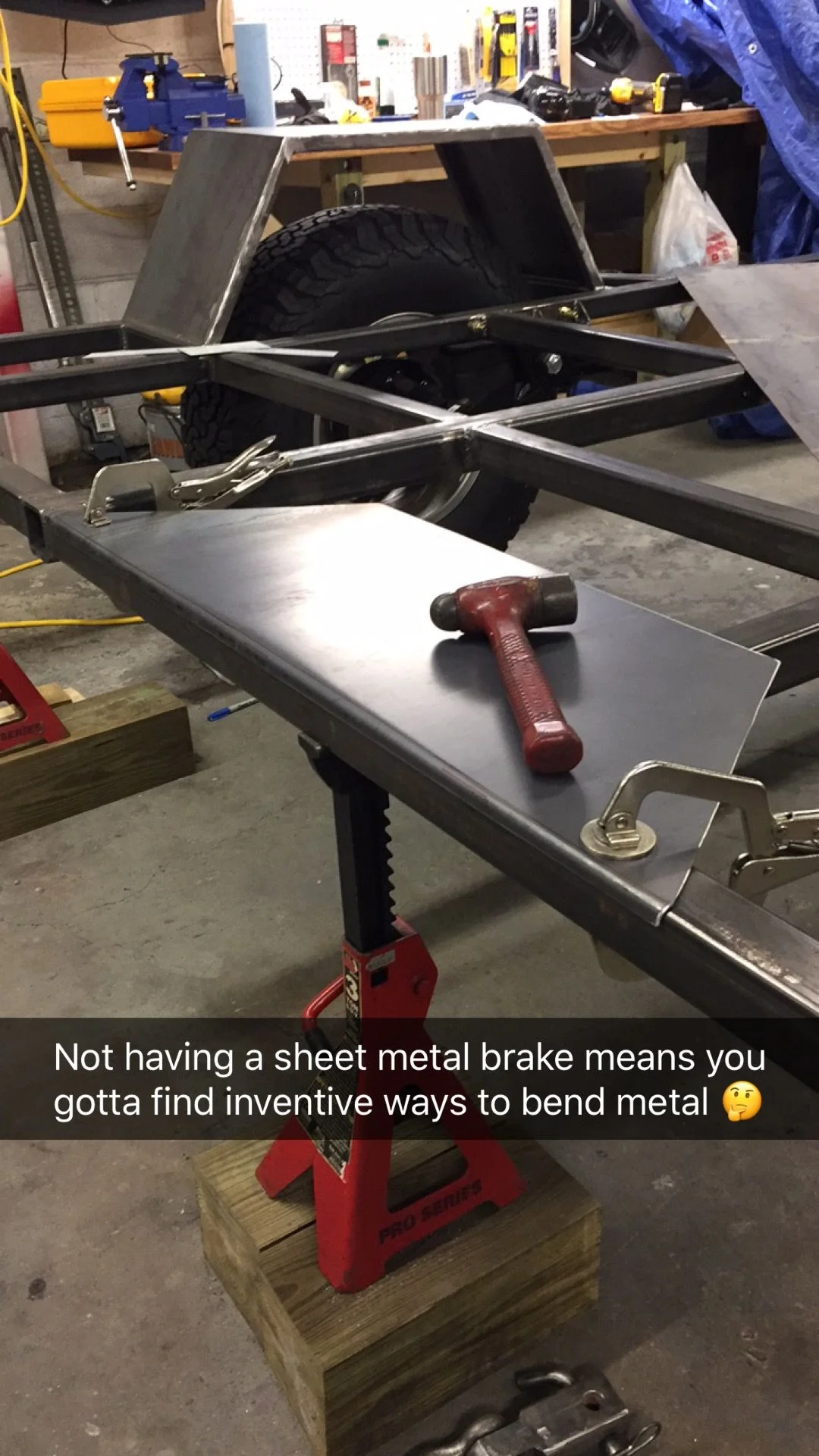

I bought a 4x8 sheet of 16gauge steel (~$50) for making the fender skin. I used some cardboard to get the sizing right. Traced on the sheet, and then used a jigsaw with a metal cutting blade.
A sheet metal brake would have been perfect here. I thought about building one, but I don’t have a large need for it outside of making these fenders.
I tried bending the fender skin like this, but didn’t realize I needed a heavy flat stock behind the sheet as well.
I switched to using the frame as basically an anvil and then pushed and used a hammer to get the bend I needed.
For the second bend, I placed a 3/8 flat stock under the angle iron and clamped it down, then bent and used a hammer to get it shape. Once in position, I used the angle grinder to remove the overhang on the side and end.

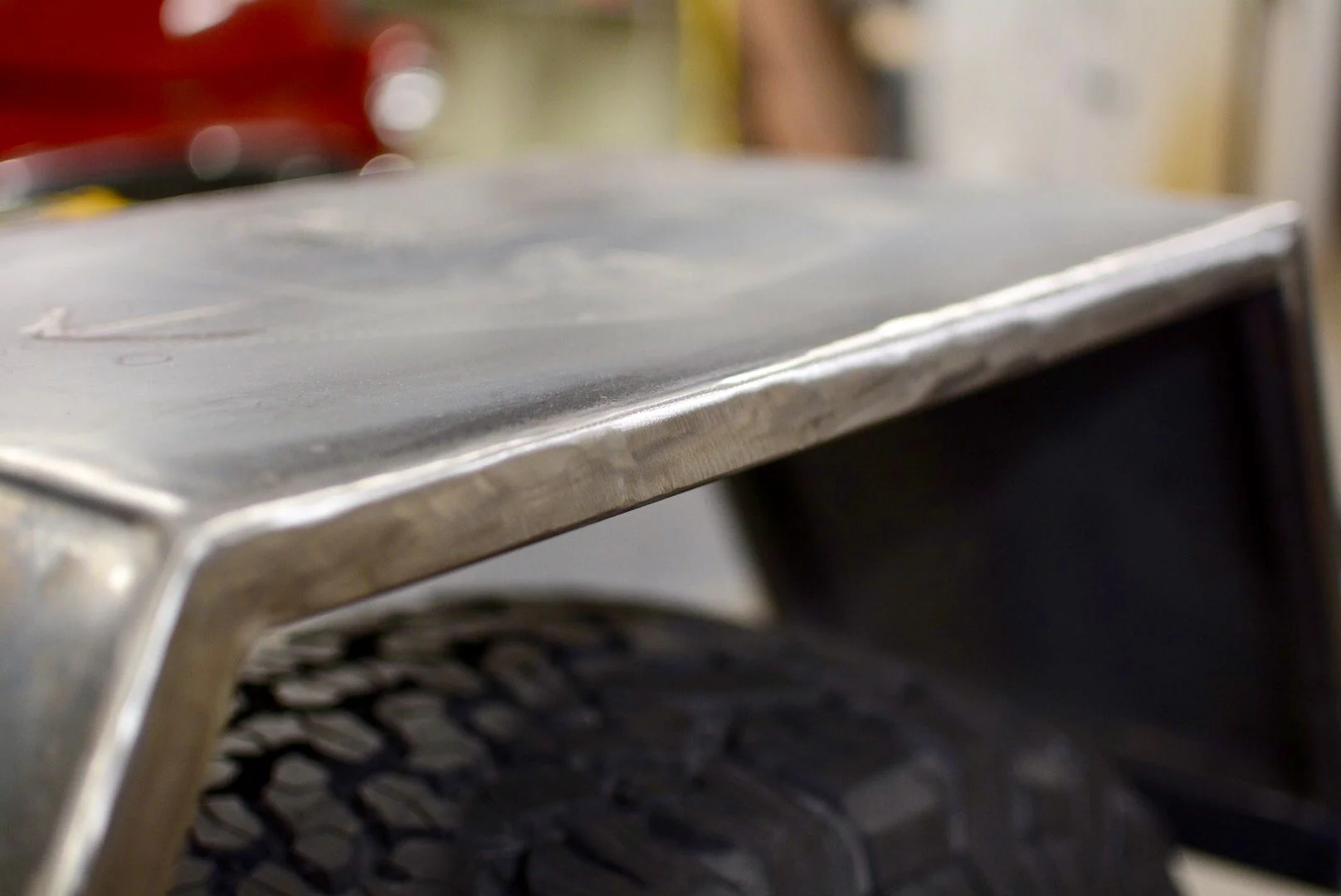

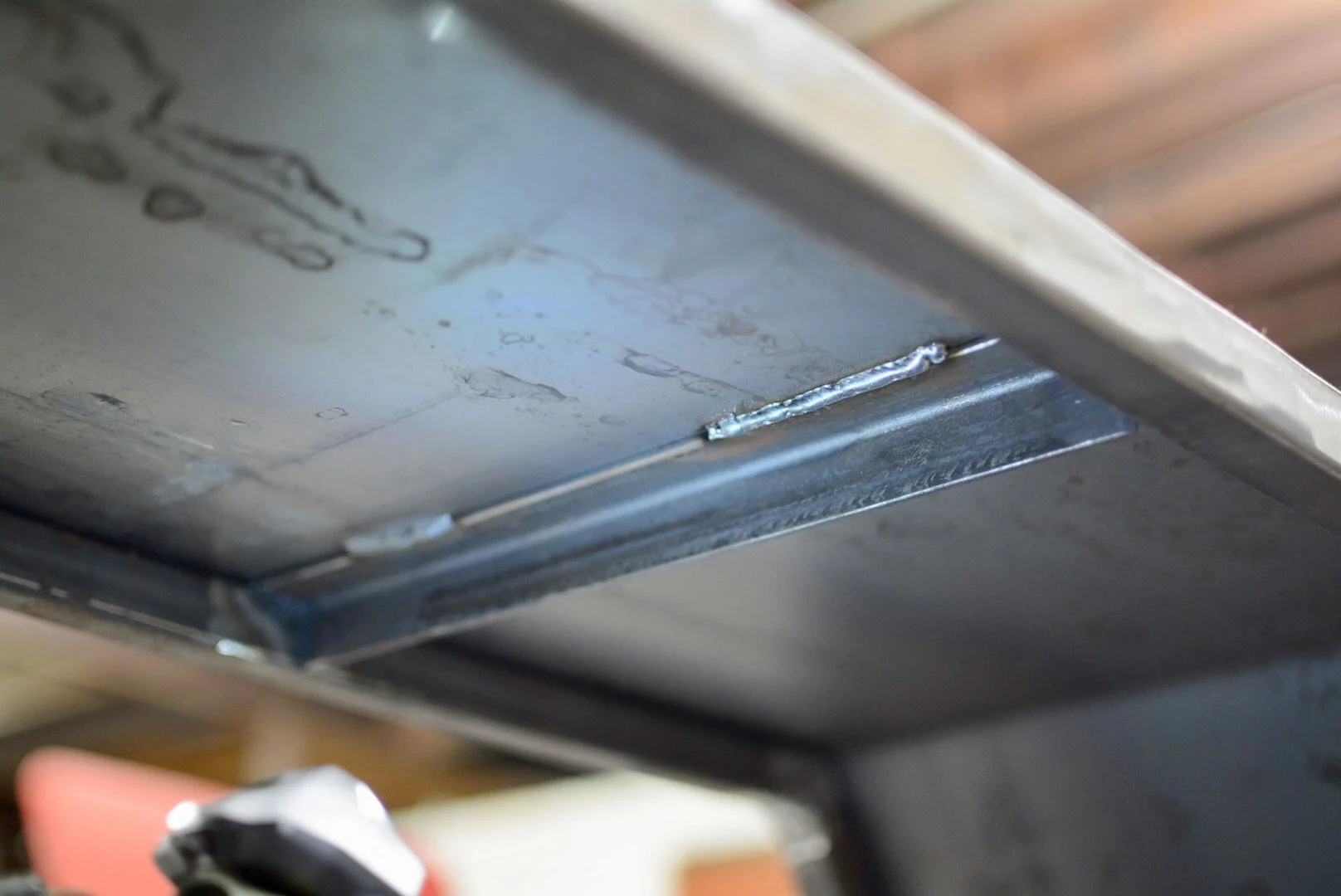

I then tacked the fender in place. I tried TIG welding the fender to the 2x2”, but i just don’t have the skill. I couldn’t get a steady position and kept melting too much of the skin. Plus, it would have taken a 4-6 Times as long to TIG the the whole skin vs MIG.
The welds along the outer edge I ground down to have a smooth surface finish.

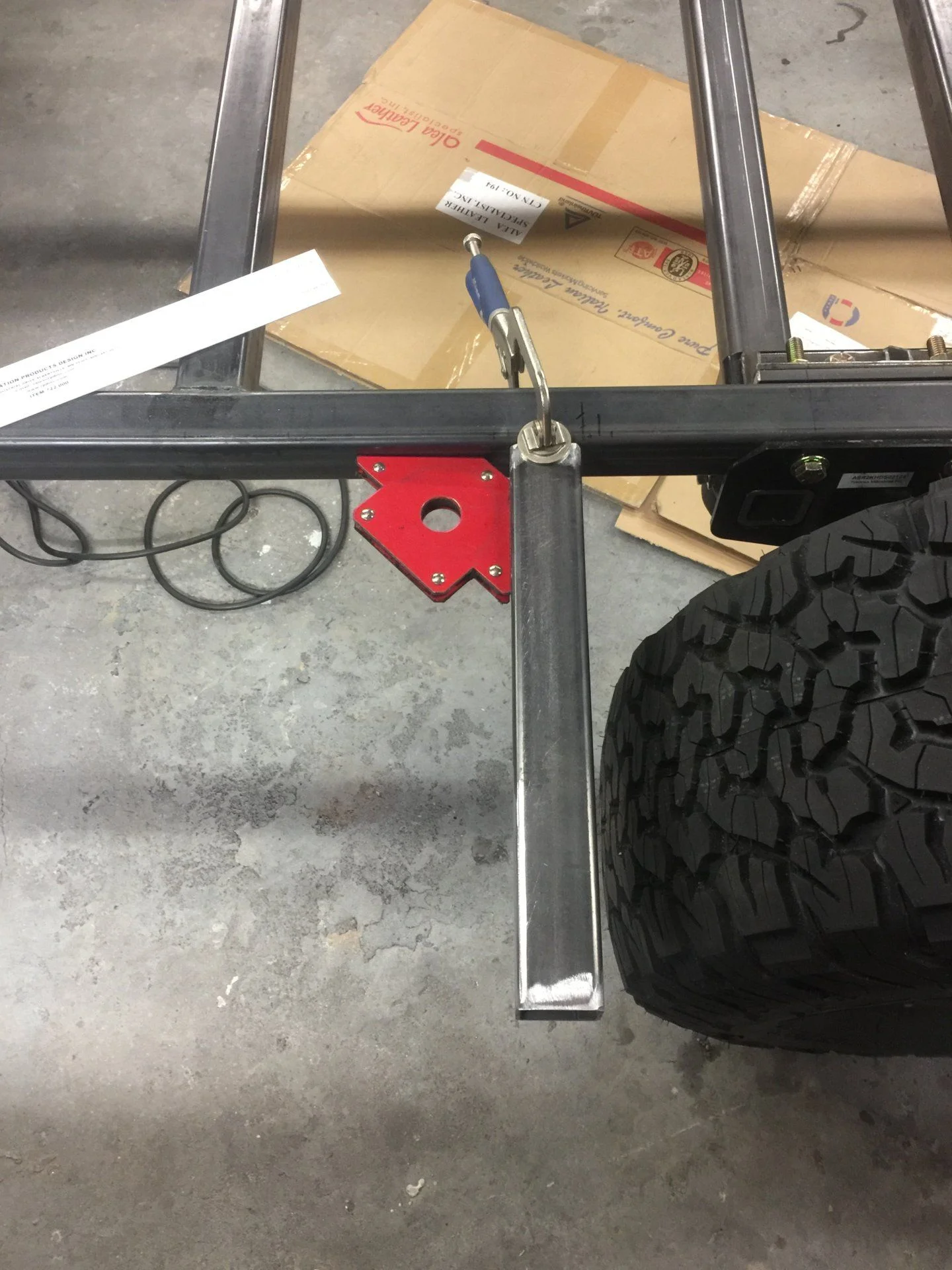

For the second fender, I decided to order these strong hand magnets. They made setting the angle for the fender frames a million times easier. Highly recommend for metal fab.
