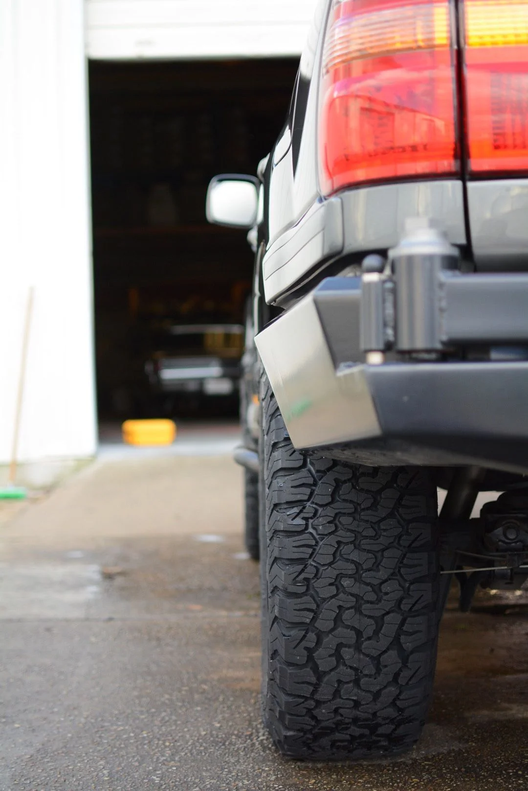

Thanks for the comparison, I'm currently leaning towards a Dissent rear bumper...
The Slee doesn't require to cut the rear crossmember?
One of the many things I like about the Dissent rear bumper is the swingout latching system- simple, clean and low profile. The departure angles of the back edge and the sides is more than adequate, and actually really nice looking. I like my BIOR, but the Dissent is in another category.
Yup. Did a lot of research on different designs. Found what I liked and didn't liked and added it all up to make something my own. All for about 1/4 of what I would have paid to have it made. Gorgeous dog btw.

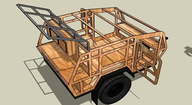

What are you skinning it with? And what do you have planned for the interior buildout? Is the back 2' storage/kitchen etc? And thanks, he's a rascal!
Very interested in your trailer build- that is a project that's been on my radar. Looking forward to following your build.
The Slee is built well but has some drawback. A big one being, you HAVE to use two hand to open each arm. One to pull the pin at the spindle, and then one to open it while holding up the pin. So if you have something in your hand, you have to set it down.

The outer wall will be aluminum sheet. It will either go over a thin layer of plywood, or be the only piece to make up the outer wall. I haven't researched enough to make a decision.
I was thinking more like the back 1.5' would be storage for the rear, and a rear vertical opening door. I'm 6'1" and sleeping slightly cramped (length wise) drives me nuts.
No concrete plans yet for the rear storage. Probably shelves and sliding cabinet doors.

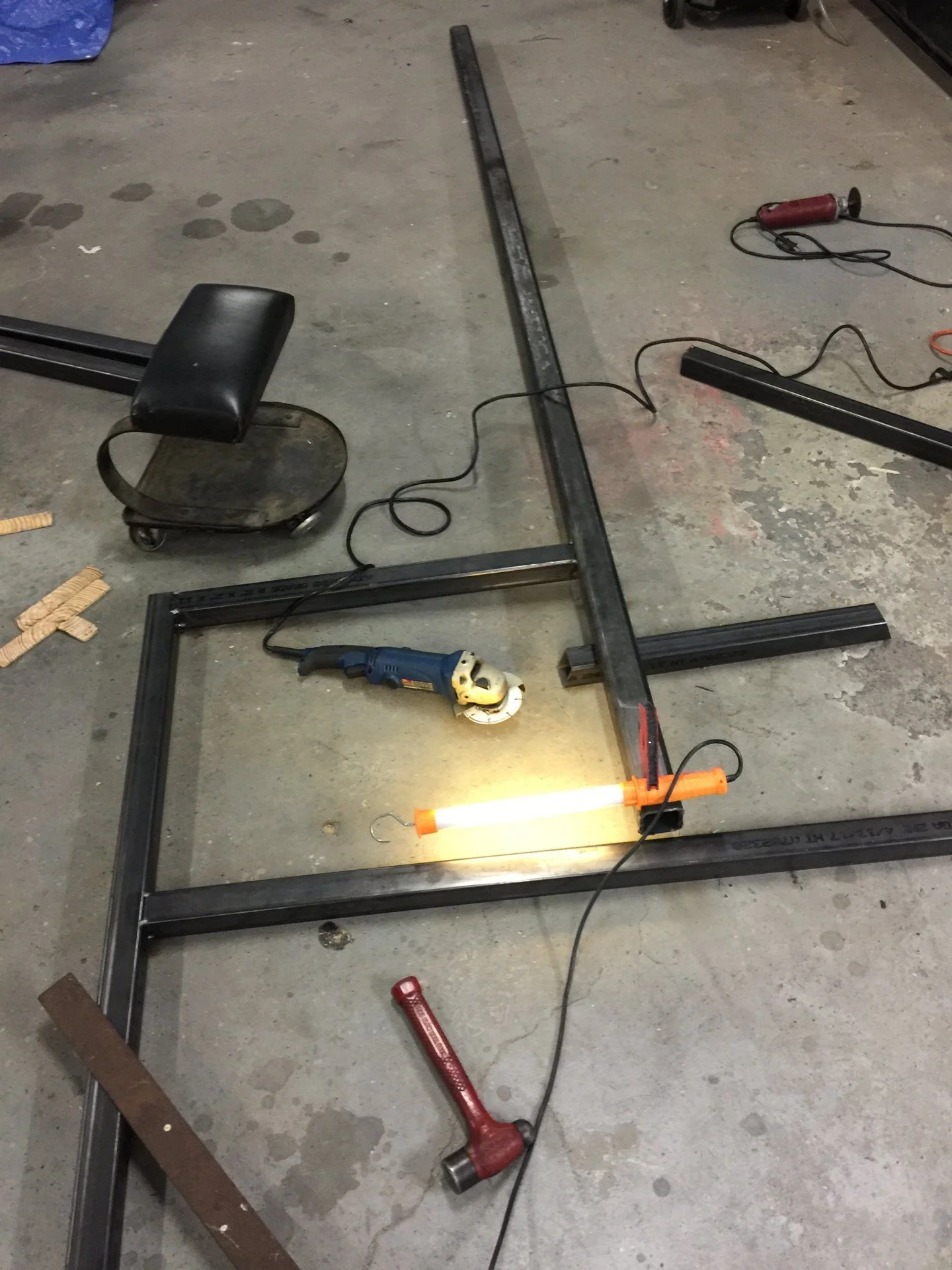

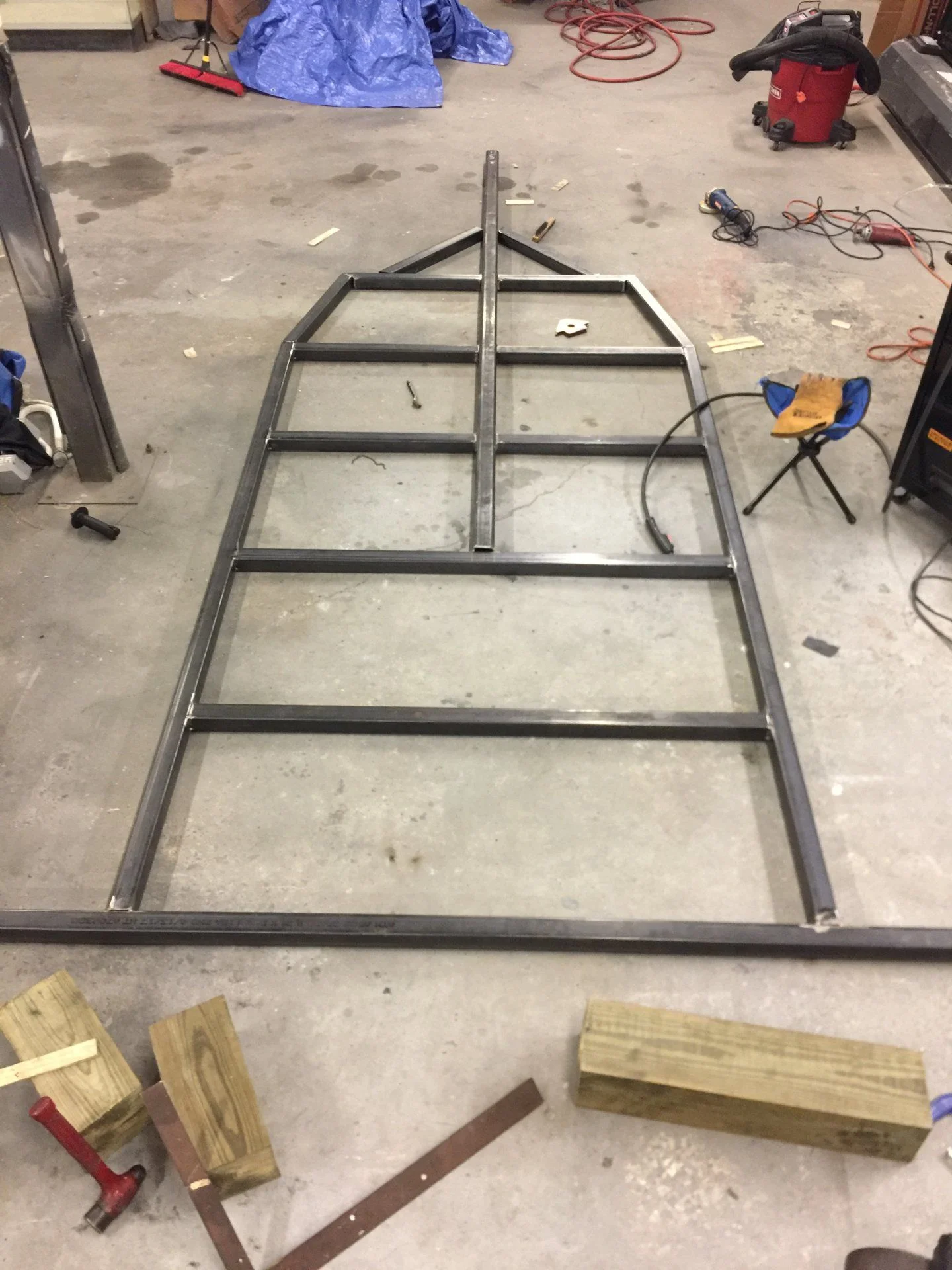

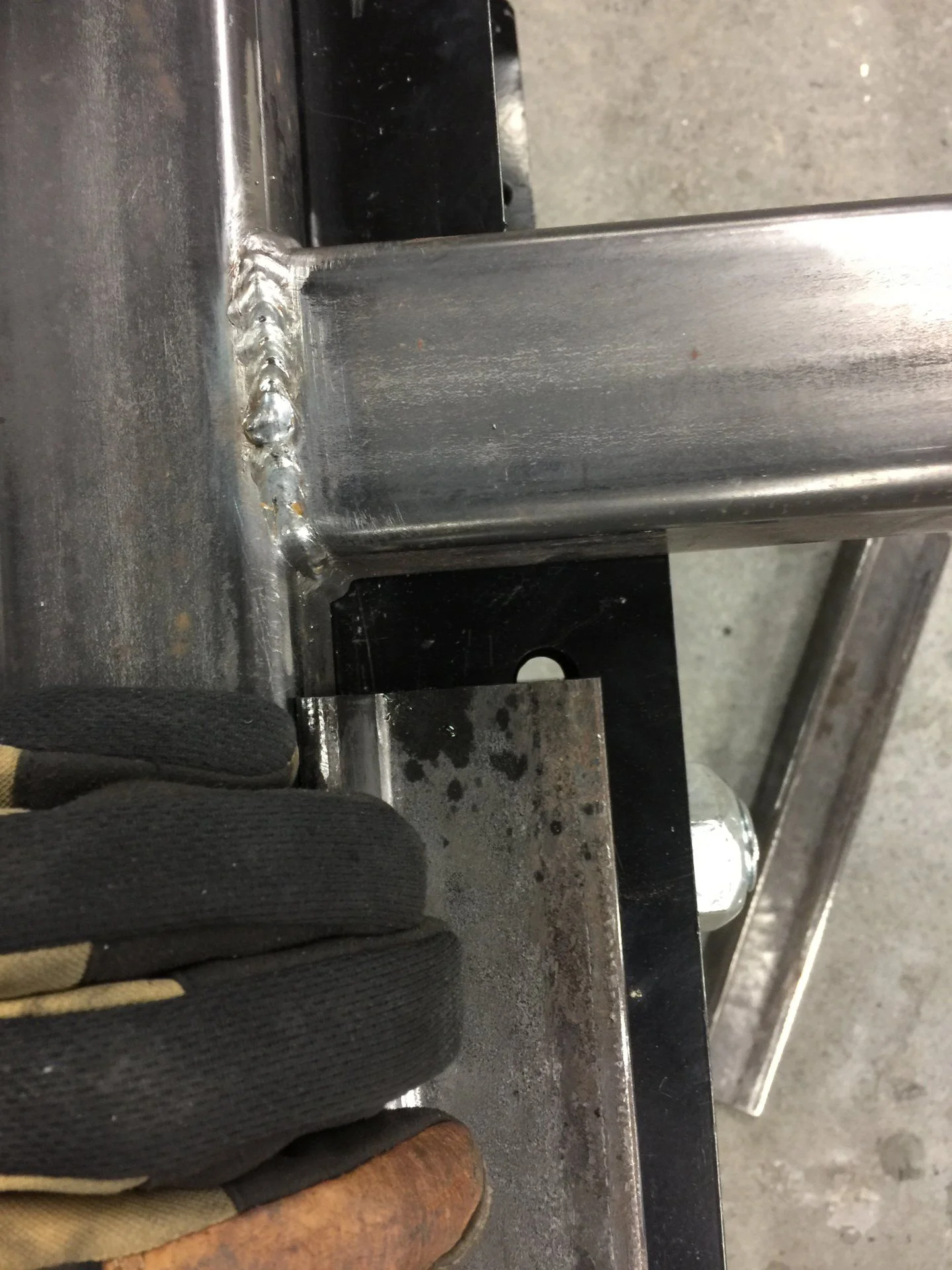

I do have some bad news. My cross members I've cut are too long. :(
The outer edge of the main frame rails needs to be 5ft/60". In my infinite wisdom, I thought "oh, well the frame rails are 2" wide, so I need to cut the cross members to 58"'. Problem being that I need to take into account 2" on BOTH sides haha. The crossmembers need to be 56". Doh. I realized that today when I was showing a friend the progress I had made. I wanted to leave work right then and go fix the mistake.
Thankfully, 2 cross members are not tacked in place, and the rest have 4 tacks each. So I will be spending some quality time with the cutoff wheel and angle grinder. Grrrr.

Do you insulate inside the aluminum or plywood?

I'll be insulating the wall in the sections where I skeletonize the 3/4" ply. The middle section of the wall will look like this with foam insulation in the sections where the wood is cut out.

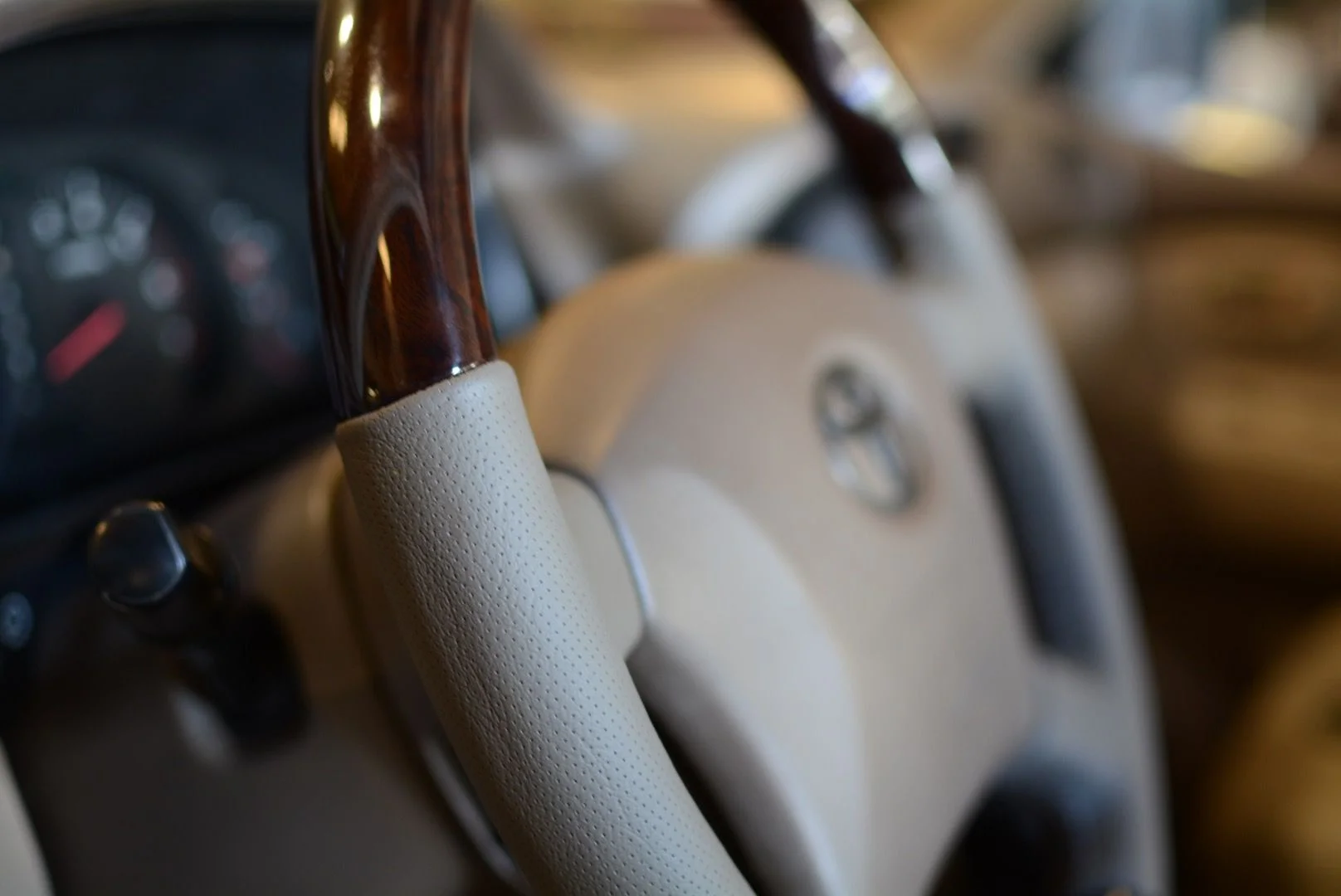

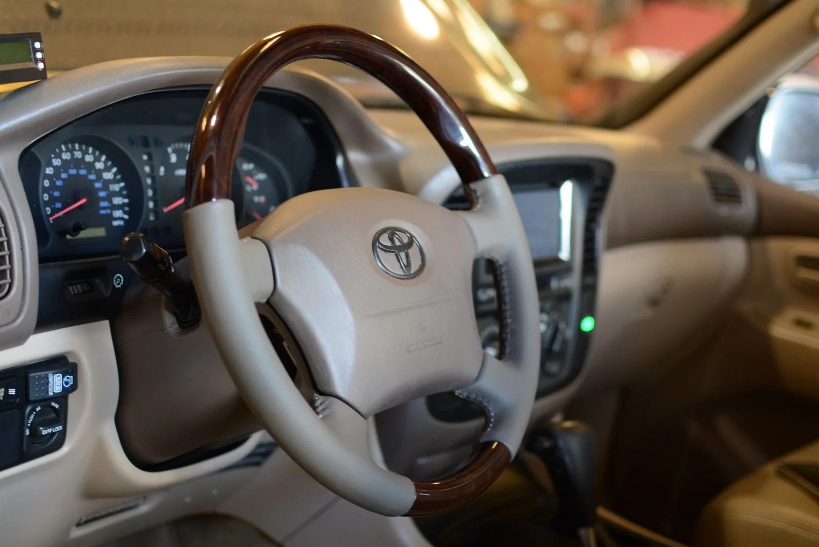

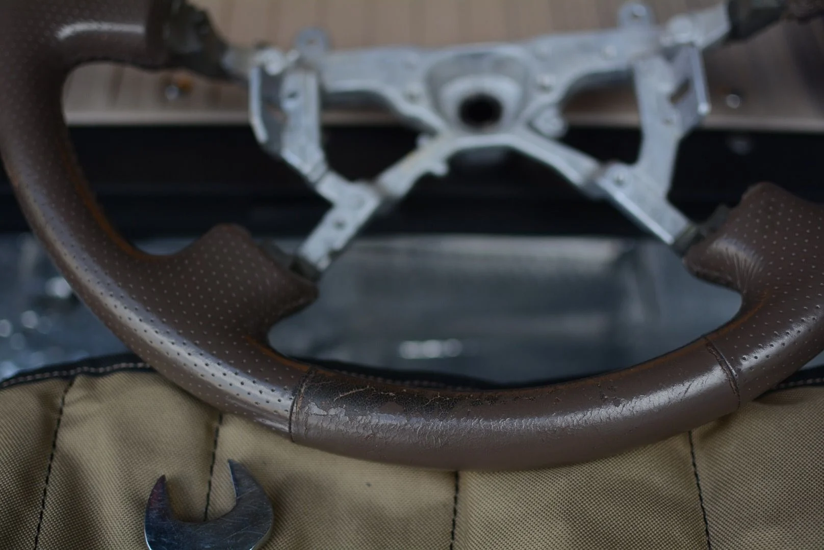

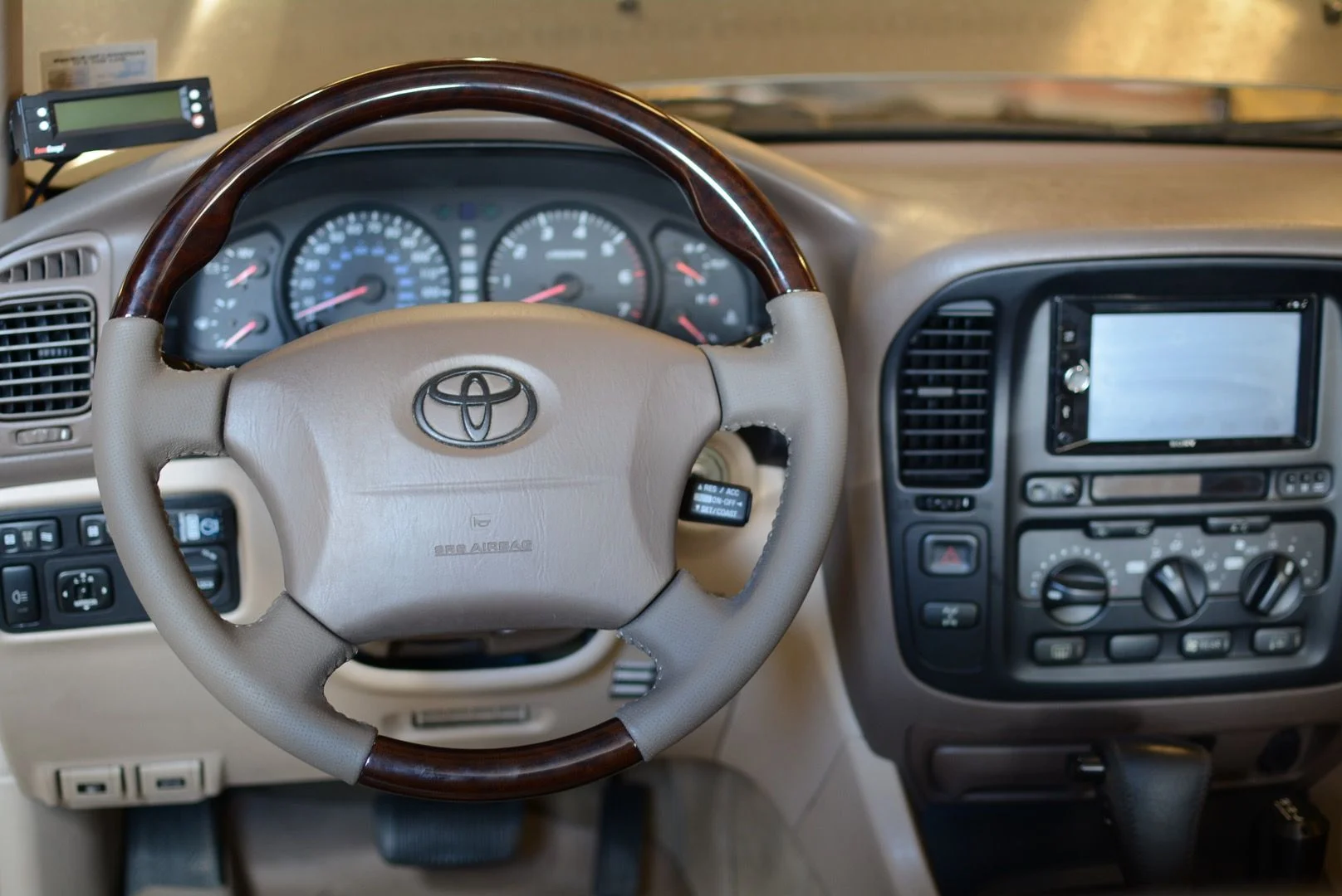

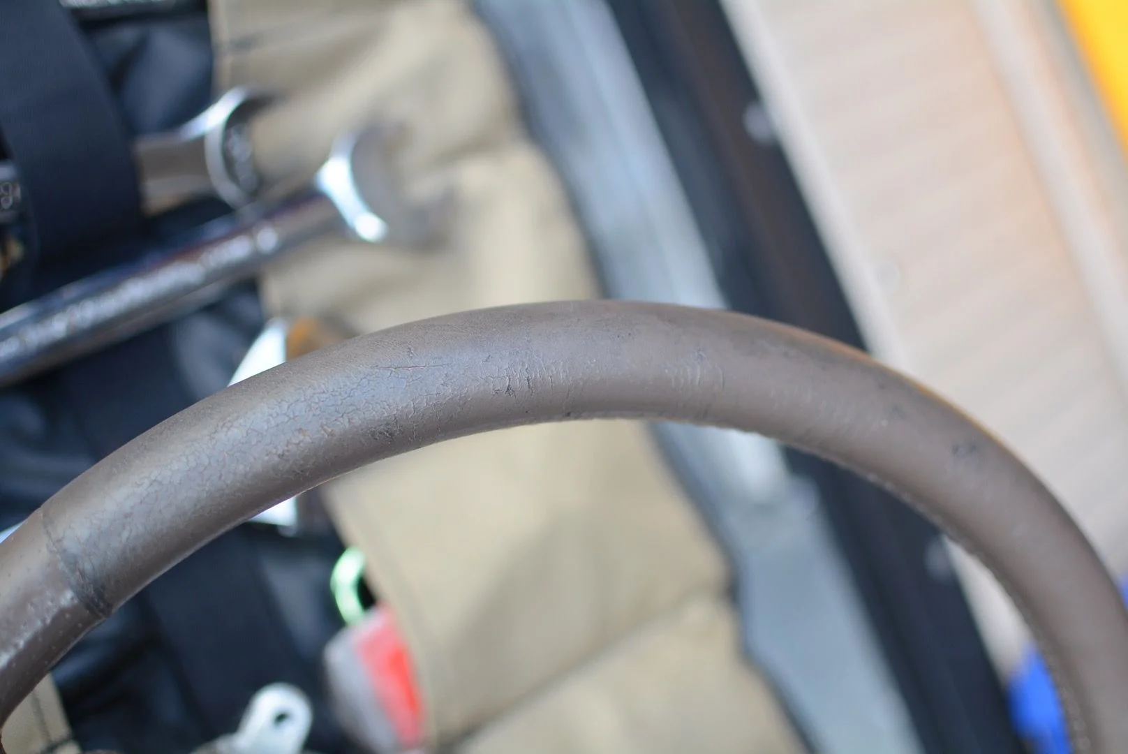

My original wheel has started to recently fall apart. It wasn't in horrible shape but could have used a recovering. Looked at a couple of the eBay ones and was pretty impressed. I didn't know how I would like the wood but I'm pretty impressed. I'd highly recommend this wheel if yours needs a refresh.
I wish I would have done this mod sooner. I paid $220 shipped for it. Oh and you can also see the new Sony head unit.

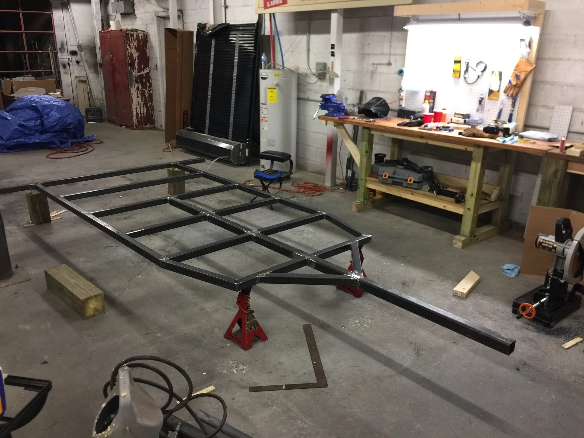

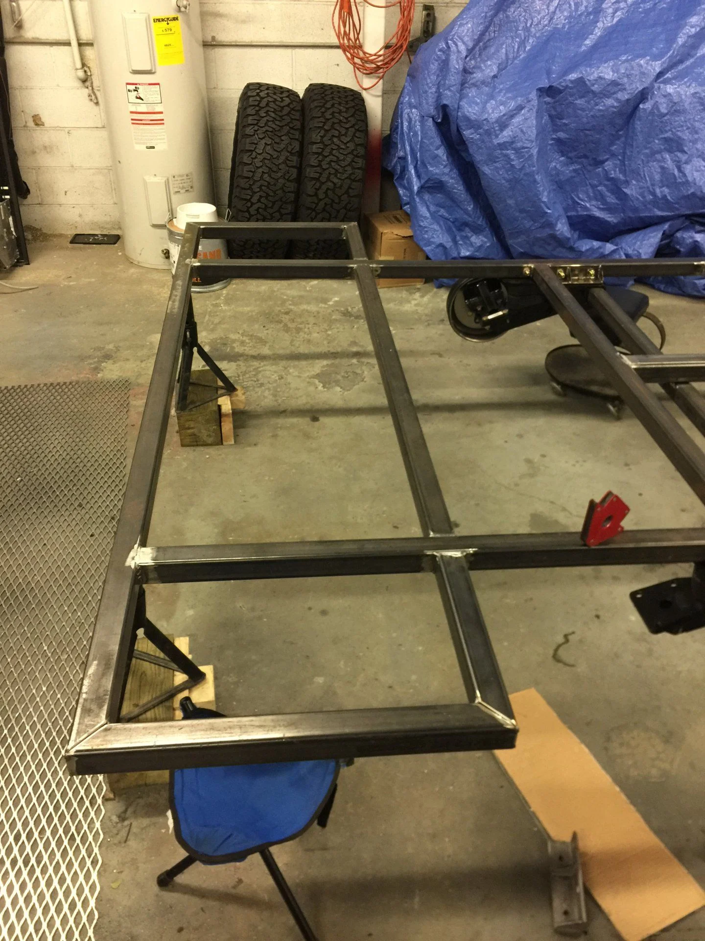

After changing out the steering wheel, I got started on cutting tack welds so that I could narrow the frame rails by 2 inches. I also moved the main hitch tube back to the next crossmember. I think that makes it connect to the 4th crossmember?
I still need to order my Timbren suspension. I just have a few more measurements to figure out. I'm fairly positive I'll need to run hub adapters in order to run the TRD RW wheels with 35s. I don't plan to build the outer section of the frame (where the fenders will attach) until I get everything mounted up.
I was going to start tack welding everything back together tonight but it got late, exgf showed up with her golden retriever so we were letting them play for a while.
Tomorrow morning I'll double measurements and squareness, then tack, check again, then start fully welding.

steering wheel looks insane, where did you buy it?
*Replacement Steering Wheel Dark Wood Grain Leather Grip For Toyota Land Cruiser
It feels really good in the hand. The wood is pretty dark so it doesn't stand out too much. I have always been impressed with any item I have gotten that was made in Taiwan.

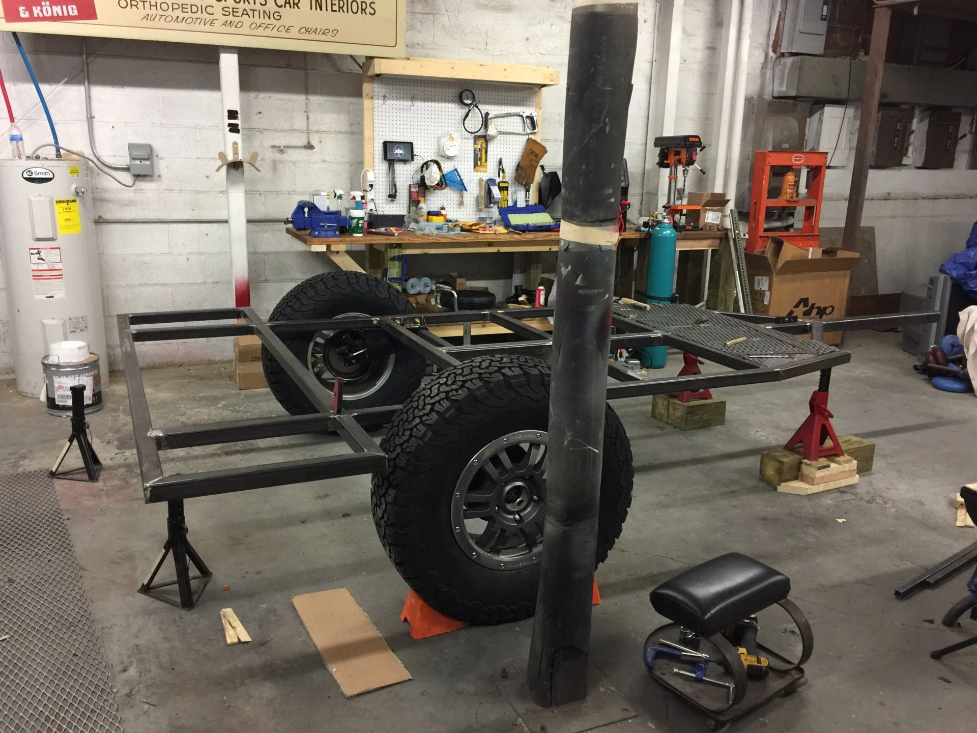

Made some more progress on the trailer.
Everything is tack welded. I started burning in a few of the welds on the hitch tube but ran out of time.
I moved the main hitch tube back one more cross member and have in place the front triangulation I'm going to add, haven't cut it yet but will this Friday.

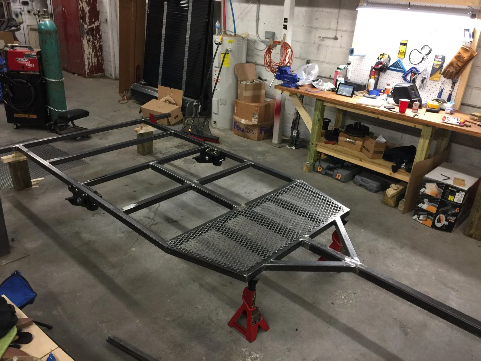

Got all of the welding done on the main part of the frame.
I think I am going to add two supports beam in the front basket area (where the frame narrows, plan to have expanded steel mesh in this area for cooler and other storage).

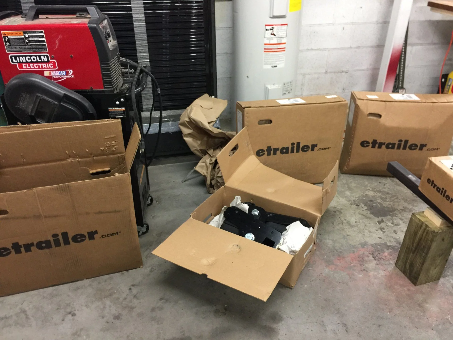

Suspension and hubs came in.
I ordered the Timbren 2000 HD suspension (comes with 3500lb spindles) with 4" lift spindles, for wide/off-road tires. I also got it with 10" electric brakes. Probably not necessary on a 1500-1800lbs (when loaded down with gear) but it wasn't much more expensive compared to nice idler hubs. ($80 vs $140)

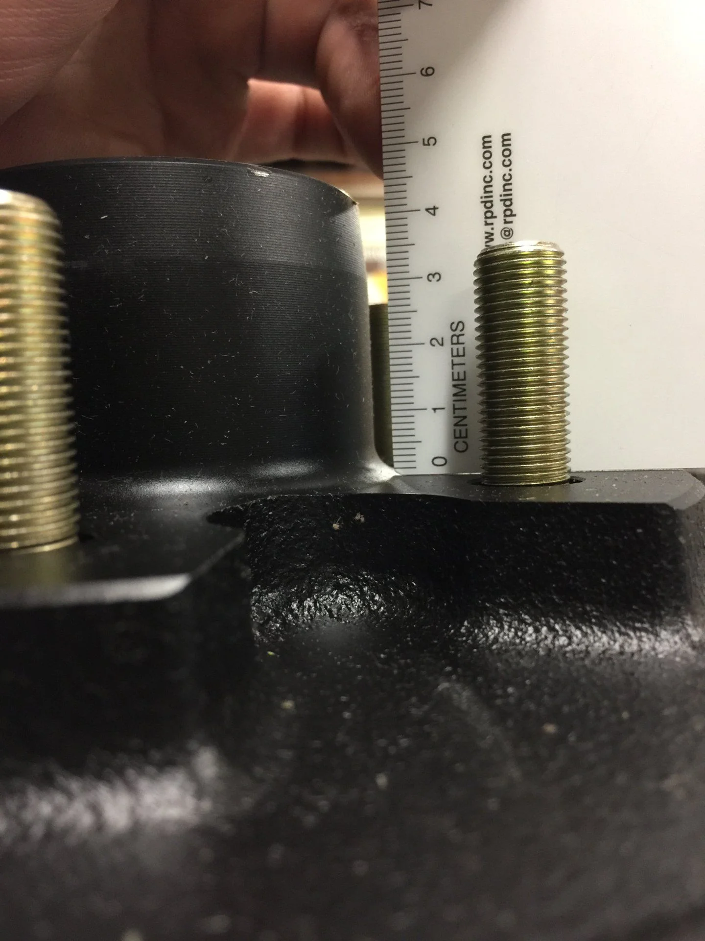

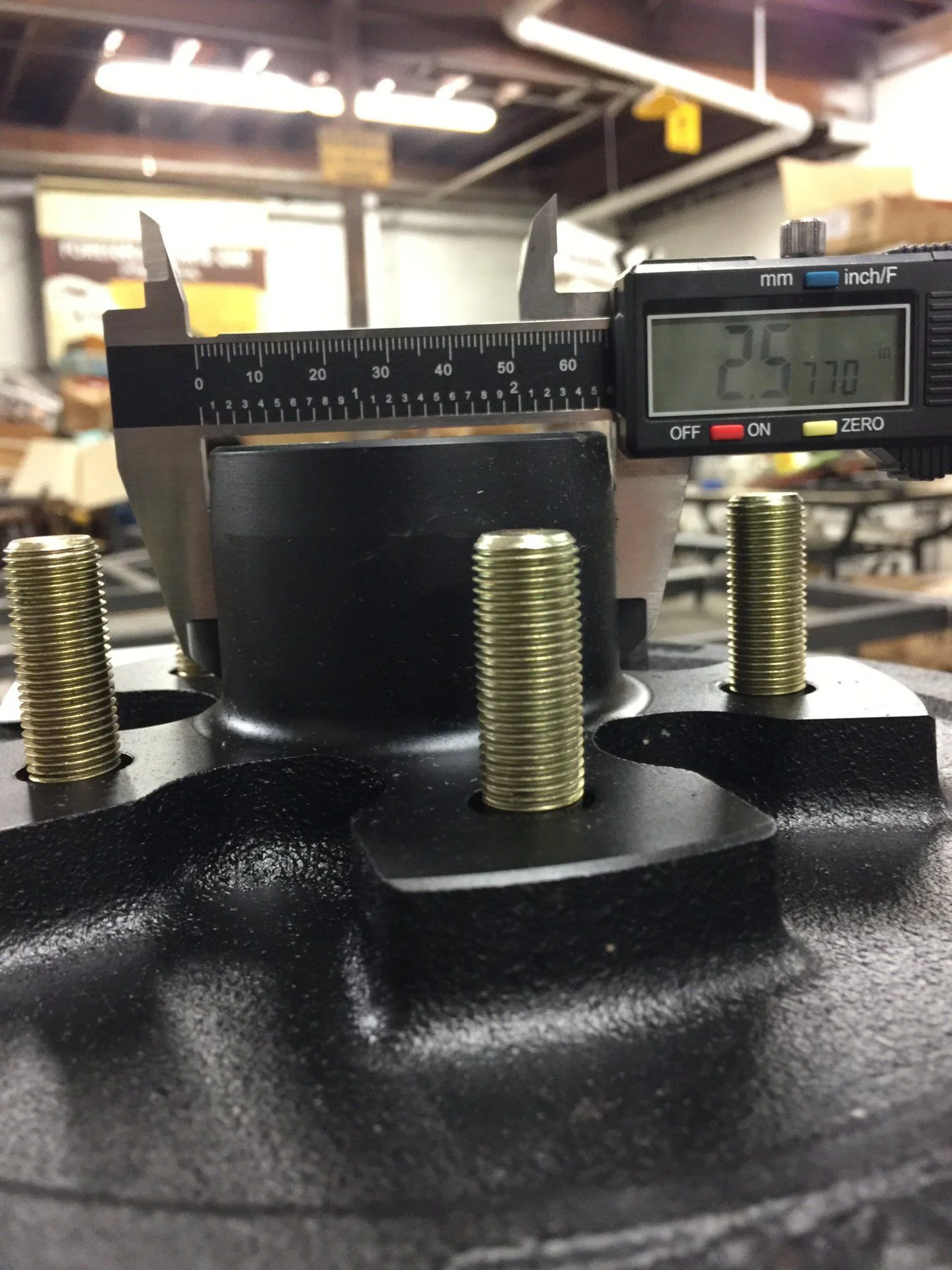

In order to run the same wheels as the 100 (TRD rock warriors), I have to run a hub adapter. With the wide spindles, the hub surface to frame distance is 8.5". The backspacing on the TRD wheels is ~6.5", and they are 8" wide. With a 35x12.50, the tire extends about 2" beyond the edge of the wheel, meaning the tire will be about 8.5" from the mounting surface of the wheel.
So, running the hub adapters, or at least a spacer would be needed anyways. The only 5x4.5" to 5x150mm adapters I could find (by a reputable company) were 1". I called and got them to custom make me some that were 1.75" thick, to give the tires a little more room between them and the frame.
The hub also has a bit of a radius on the bottom, so I had to get them to make them a little larger than the hub itself.
I was also running into an issue that all of the hubs I was looking at had longer than 1.75" studs. So I was going to have to remove or cut down all of the studs. These studs with the electric brakes are right under 1.75" long, so no need to cut them down.

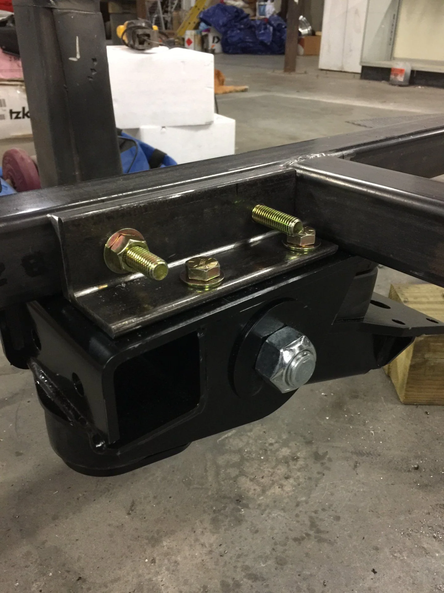

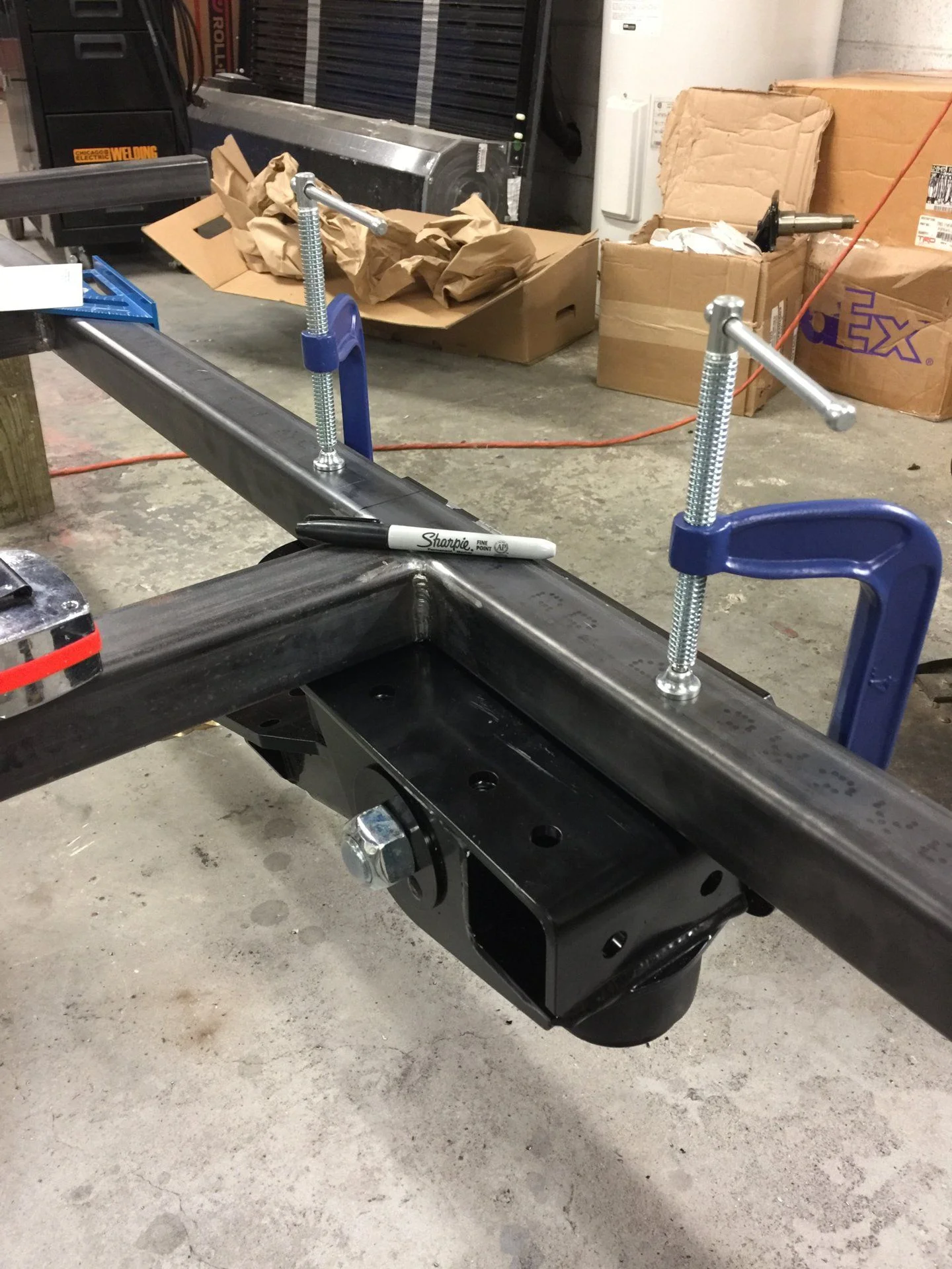

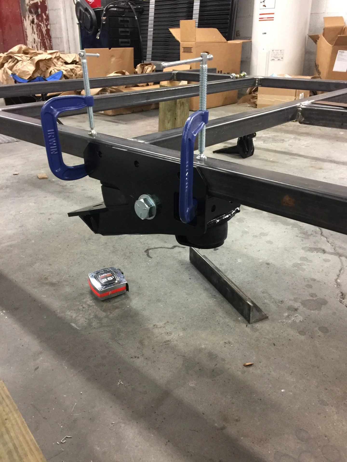

Started working on installing the suspension.

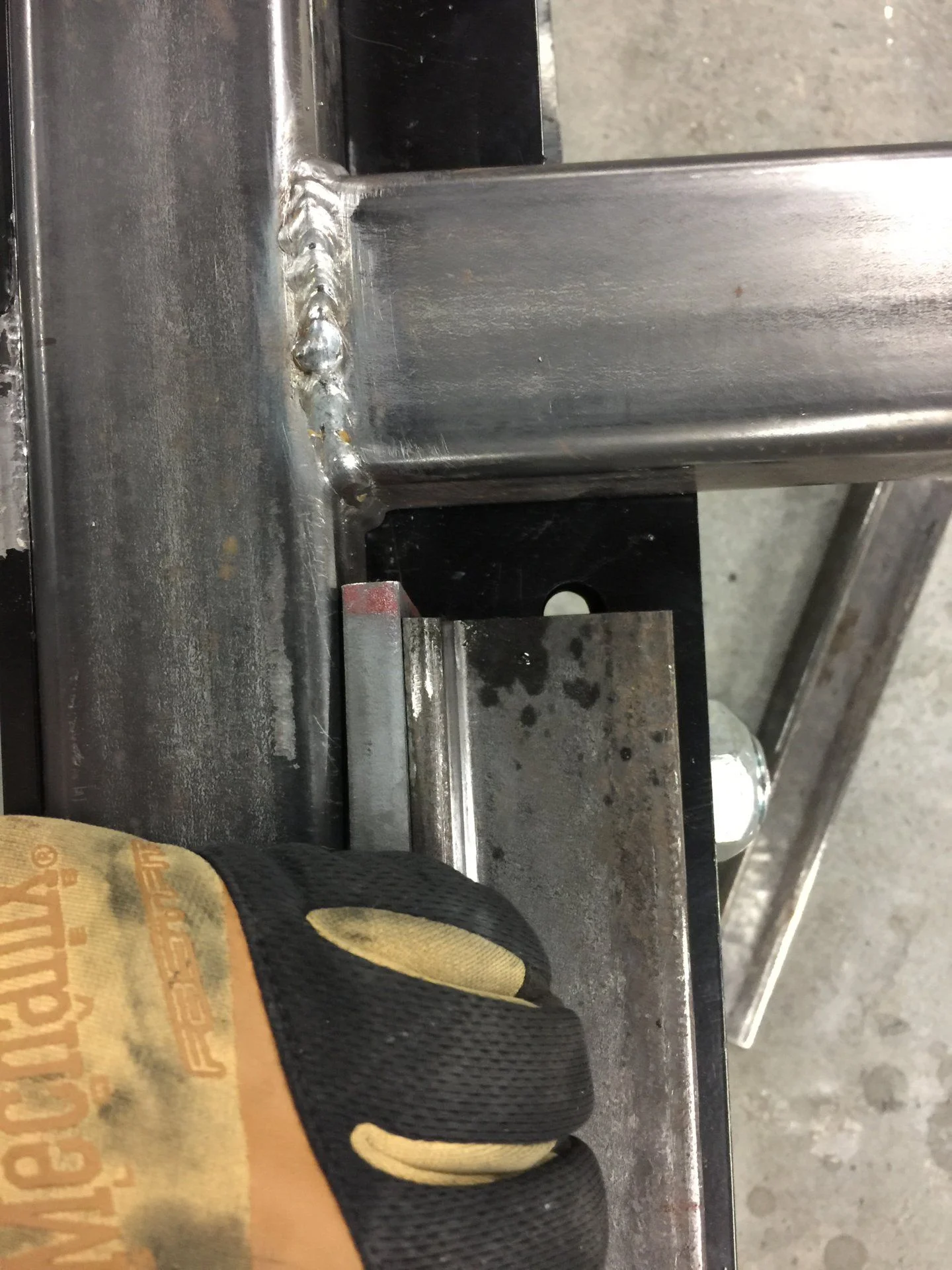

Timbren suggest that you fabricate a plate to bolt the suspension to on the inner side of the frame. They really should offer this plate as an option, I would have paid for it. I also added some triangles to the angle iron for strength.
With some 2" 1/4" wall angle wasn't wide enough to leave enough material for a 1/2" hole. I went by Home Depot and grabbed some 3/8" bar stock to push the angle iron out enough to give enough material for the holes.
Now to just repeat everything for he passenger side

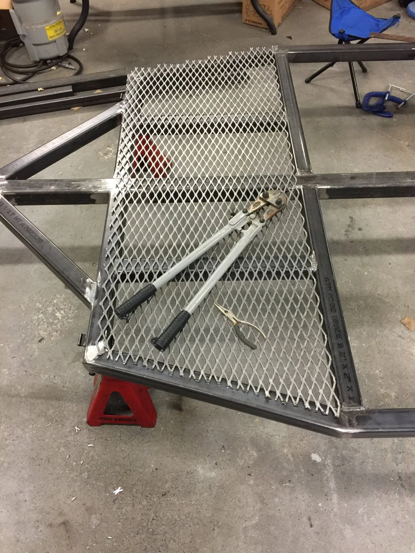

I also bought some expanded steel mesh to make the front rack as well as the rear behind the fender sections. I started off by cutting this stuff with the angle grinder and a steel cut off wheel. Then I remembered we had some bolt cutters laying around somewhere. Bolt cutters were by far the better method. I plan to go back with the grinder/flap disk and remove any sharp corners/edges. I still need to finish trimming up the other side of the mesh but I ran out of time.

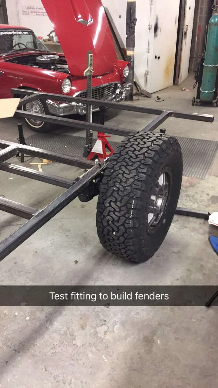

Got my tires in and mounted up to the TRD wheels. Overall diameter is barely over 33”. Forgot how much BFG lies about their tire sizes haha. The 315 MTRs are a good bit bigger.
Trailer hasn’t progressed all that much as I’ve been busy with work. I’ve also been waiting on my hub adapters to be able to build the fenders. The adapters should be in soon.

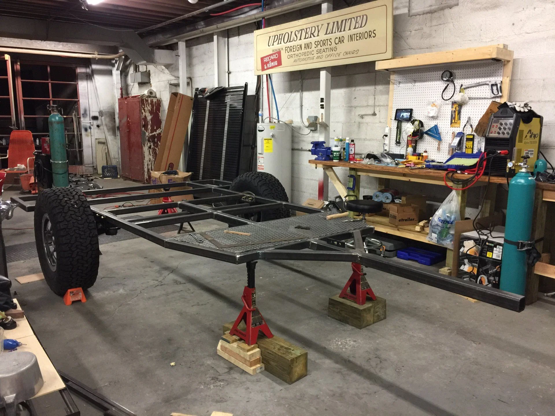

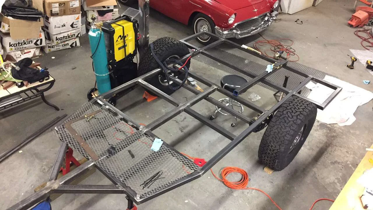

Got the AHP alpha TIG 200 welder in. Spent a lot of nights watching how to videos on YouTube about TIG welding. Then I spent a weekend or so just practicing with it. MIG welding is far easier to learn than TIG.
I started building the rear section behind the fenders/tires. I plan to build some type of propane holder and a CO2 tank mount, probably fire extinguisher as well on either side. Also, the expanded steel will cover the opening at the rear.
