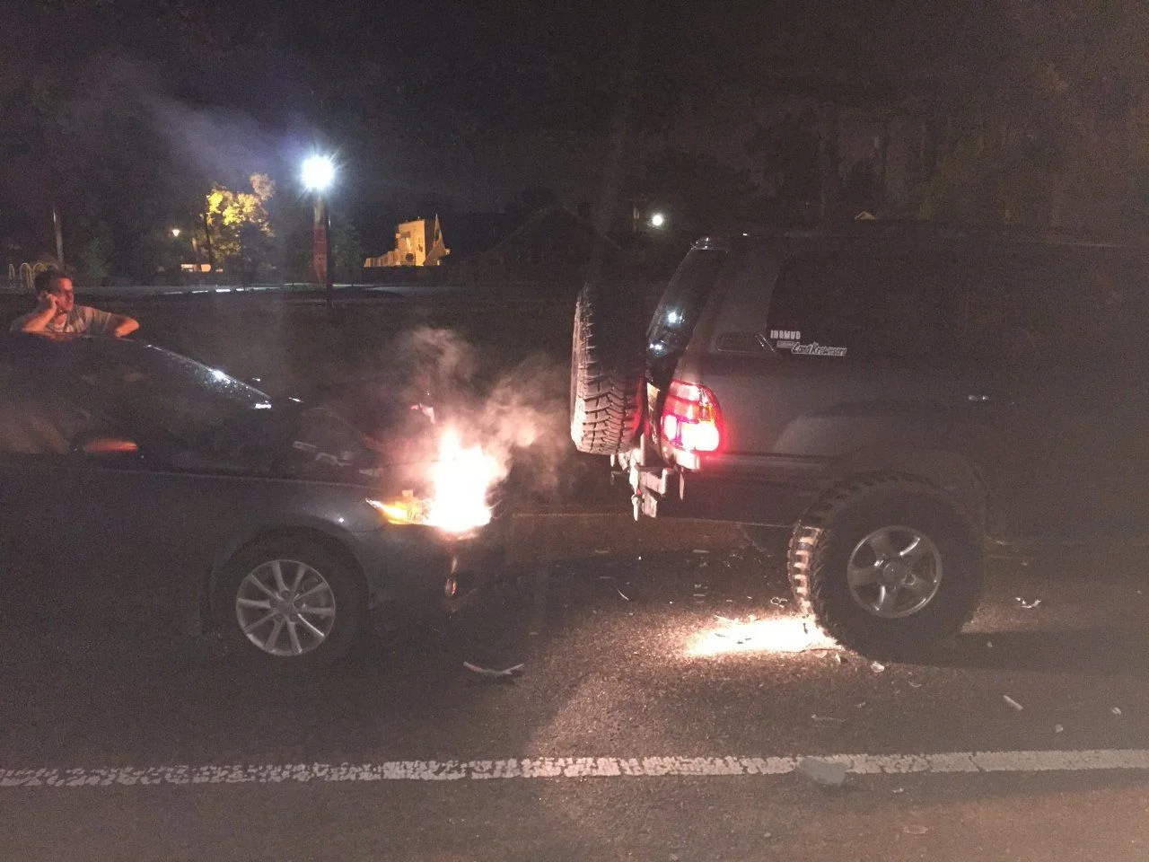

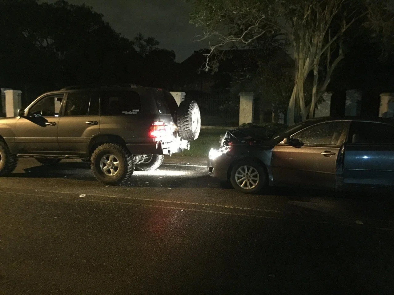

Someone decided they wanted to test the strength of their camry with the strength of my bump it offroad rear bumper last night by running into me at about 20-25mph while i was at a stop light. Some people, sheesh.
Its been a while since I've seen you on here. Hope the truck came out OK. Had something similar happen a few years ago and literally not a scratch on the truck.

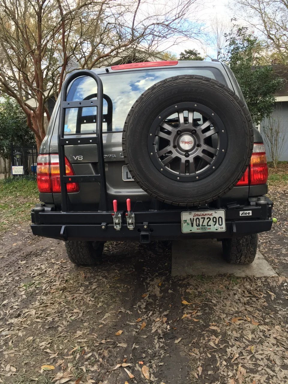

New Slee
BIOR right before i took it off.

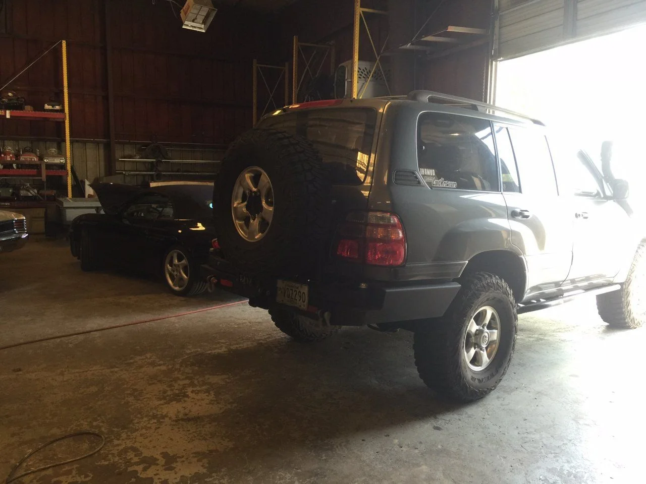

So after 4 months of waiting due to the body shop being a little lazy, i got my Slee rear bumper in and the truck tailgate repaired. So the Bump it offroad rear is for sale. The BIOR has some minor damage, i have clear pictures of the damage that itll be up later. I'll have more photos up later and a for sale thread.
What happened? How did the tailgate get dented?
Sent from my iPhone
Cars bumper/hood hit the tire carrier and caused it to bend forward and contact the tailgate.

I got rear ended. Called up mike at BIOR and he told me he was about 3-4 months away from being able to get a bumper built for me due to his back log of orders.
I called up Slee and spoke to Ben and he told me he had one sitting right in from of him ready to go out the door.
The Slee is nicer than the BIOR, but both are very good. I can't honestly say it is worth the extra cost though from my experience. Mike (BIOR) is also more willing to do or add whatever you want to the bumper and customize it for you.
Since you have had both bumpers. What's your opinion?
First off, having a swing out is a PITA for getting into the rear of the vehicle. I had a 4x4 labs on my 80 before. You will find yourself using the tailgate a lot less.
These are my opinion:
Slee:
Pros: build quality (welds, steel used, design, spindle caps), smooth powdercoat, no cutting of rear crossmember, swing outs lock open.
Cons: more expensive, opening the swing outs is a two hand job, less customization (have to have ladder on left), rear tire "jiggles" more
BIOR:
Pros: less expensive, more open to customizing, can open the swing outs with one hand.
Cons: the pins that "lock" the swing arms need a lot of maintenance (will rust), requires cutting of rear crossmember.
There may be some other things I'm missing, that's just the main things I can think of off the top of my head. If I were spending my money, I'd probably go with the BIOR and use the nearly 1000$ to spend on other mods. Which is what I did the first time and I added one of BIOR's skid plates to the order haha.

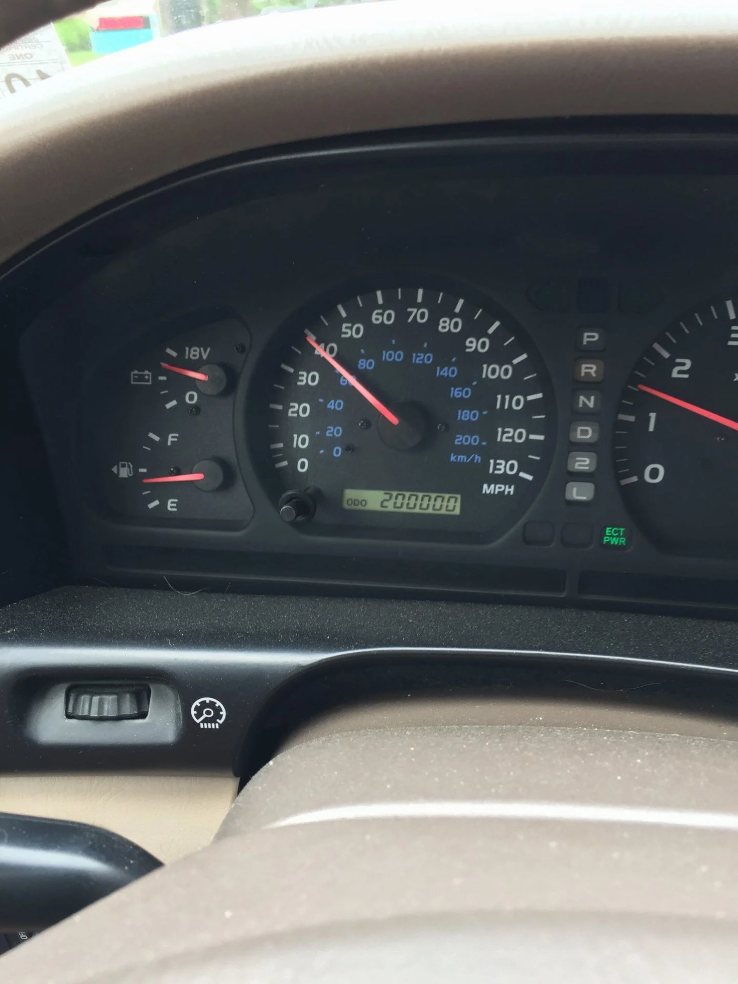

Truck just passed 200,000 miles. I finally had a little break from work so decided to tackle a few maintenance items:
Timing belt, water pump, pulleys, o-rings and gaskets and seals, starter contacts and plunger, instake plenum gaskets, fuel injector o-rings, front upper and lower radiator hoses, all rear hoses and both T's, valve cover gaskets, PCV grommet, PCV valve, fuel filter, spark plug tube seals, all sway bar bushings and links, and a worn DS lower ball joint.
Think that's most of what I installed haha.
