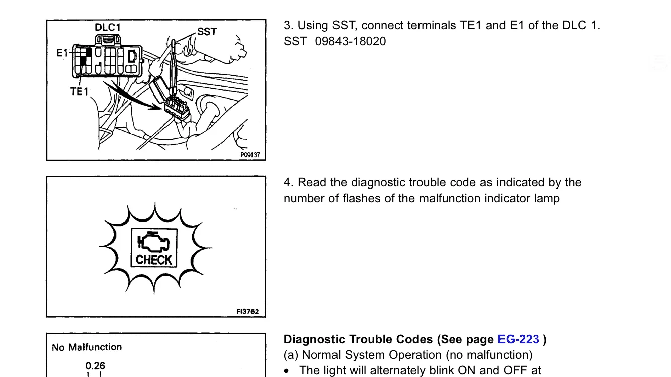

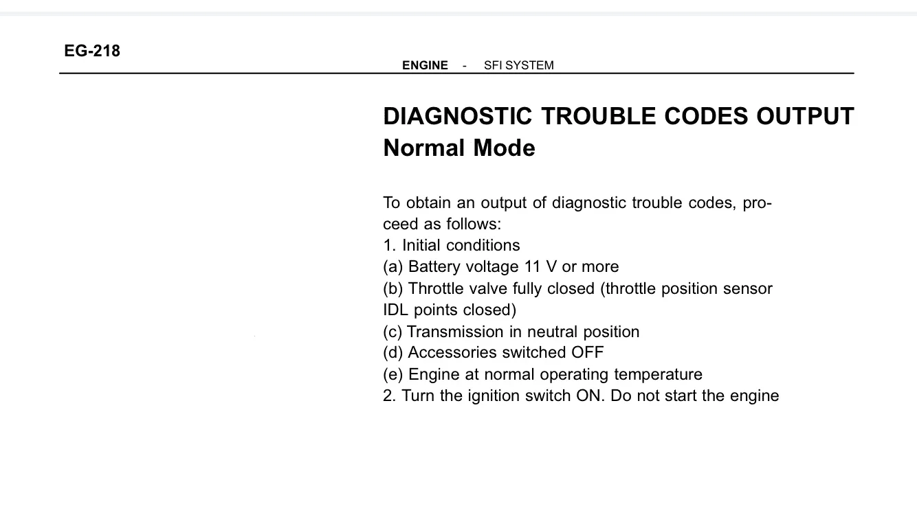

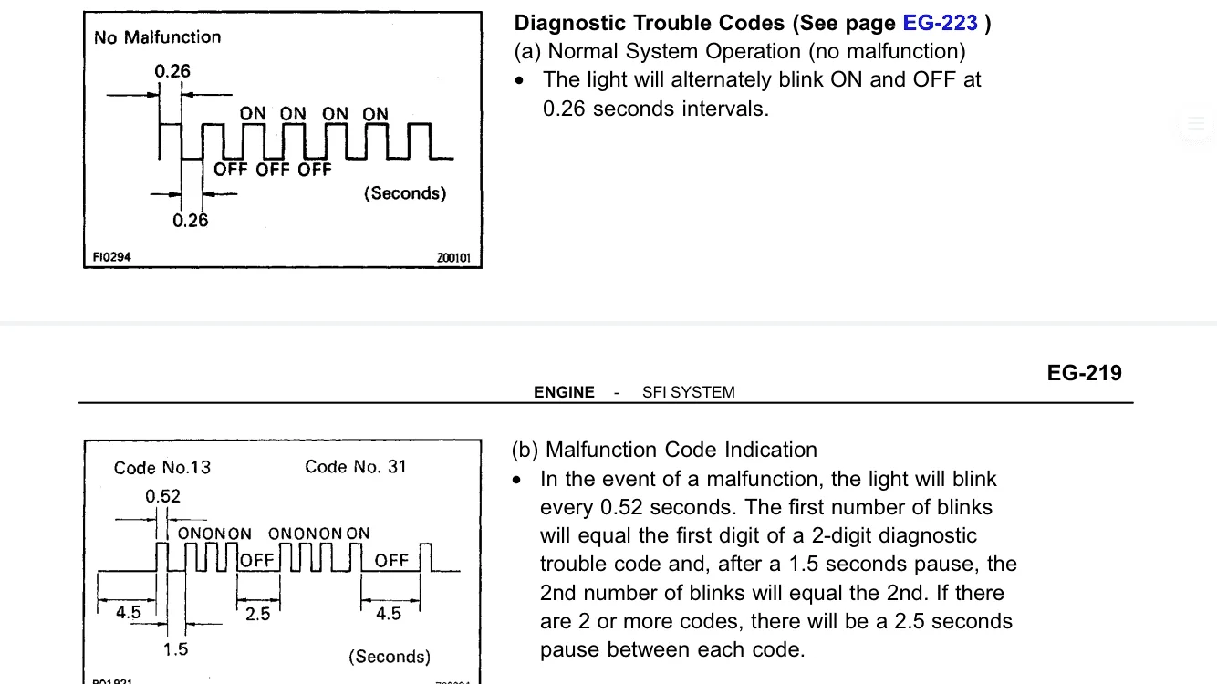

Im posting this from memory, so feel free to shoot me, but the procedure for 94's is different than from 95-97 as our trucks are OBD-I. AS I RECALL, in the service manual, our check engine light comes on when the ignition key is turned, then goes off while actually cranking. I'm opening the service manual as we speak to confirm. In any case, the fusible links will cause the condition you are describing.
Have you already checked for stored codes? regardless of the CEL the codes stay stored in memory (since youve replaced the battery at least...)
it wont do you any good if the bulb is burned out obviously, but here is the process.
