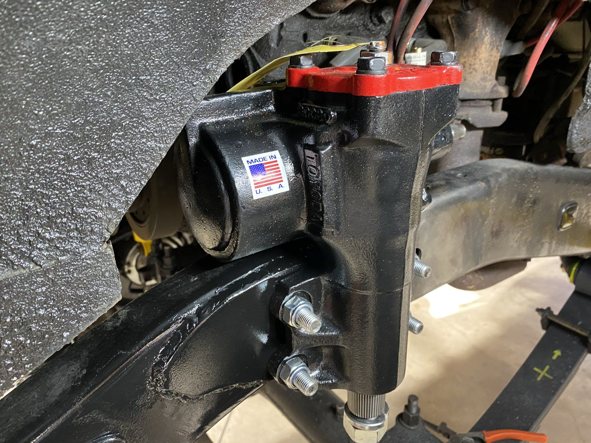

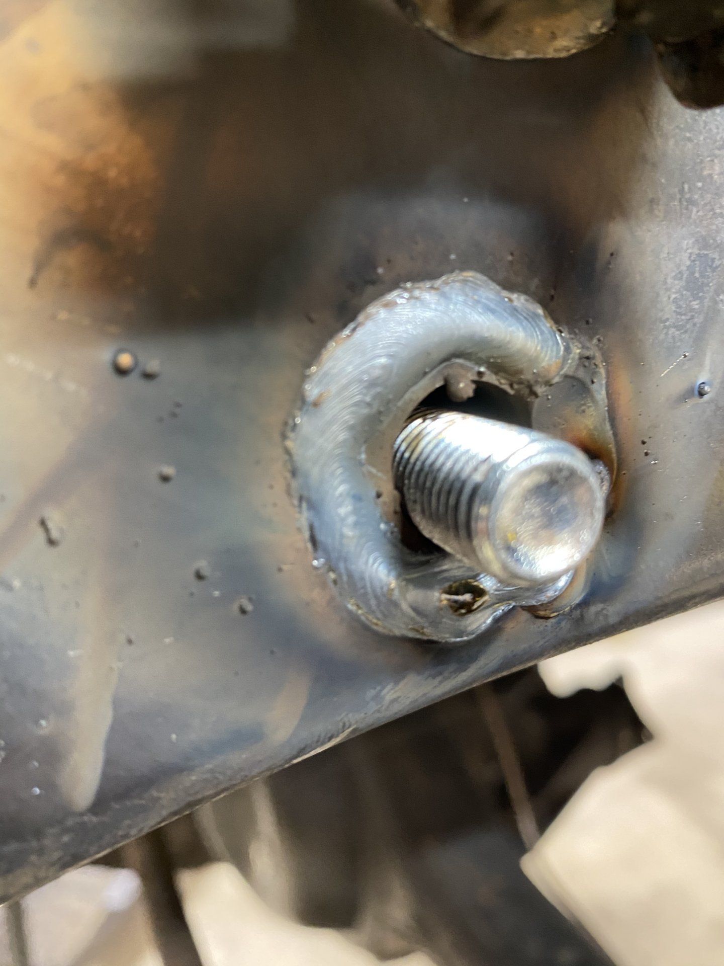

Well Mike got a LOT of money back in his pocket since I did all the head scratching on this job on my nickel and not his.
Drilling the big holes for the frame sleeves is by far the worst part.

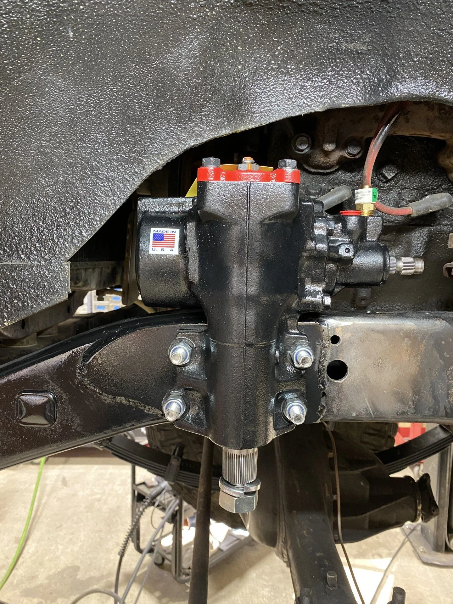

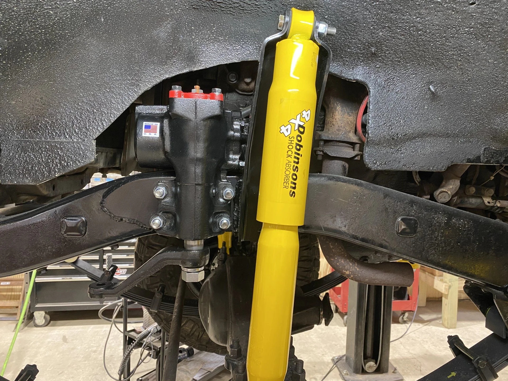

Can I ask what pitman arm that is? Not stock 80 and not a 60 arm.
I got it from Luke at 4x4 labs. Same drop as my FJ60 arm but takes the 80 series rod end without a spacer.
It was labeled IFS arm .....

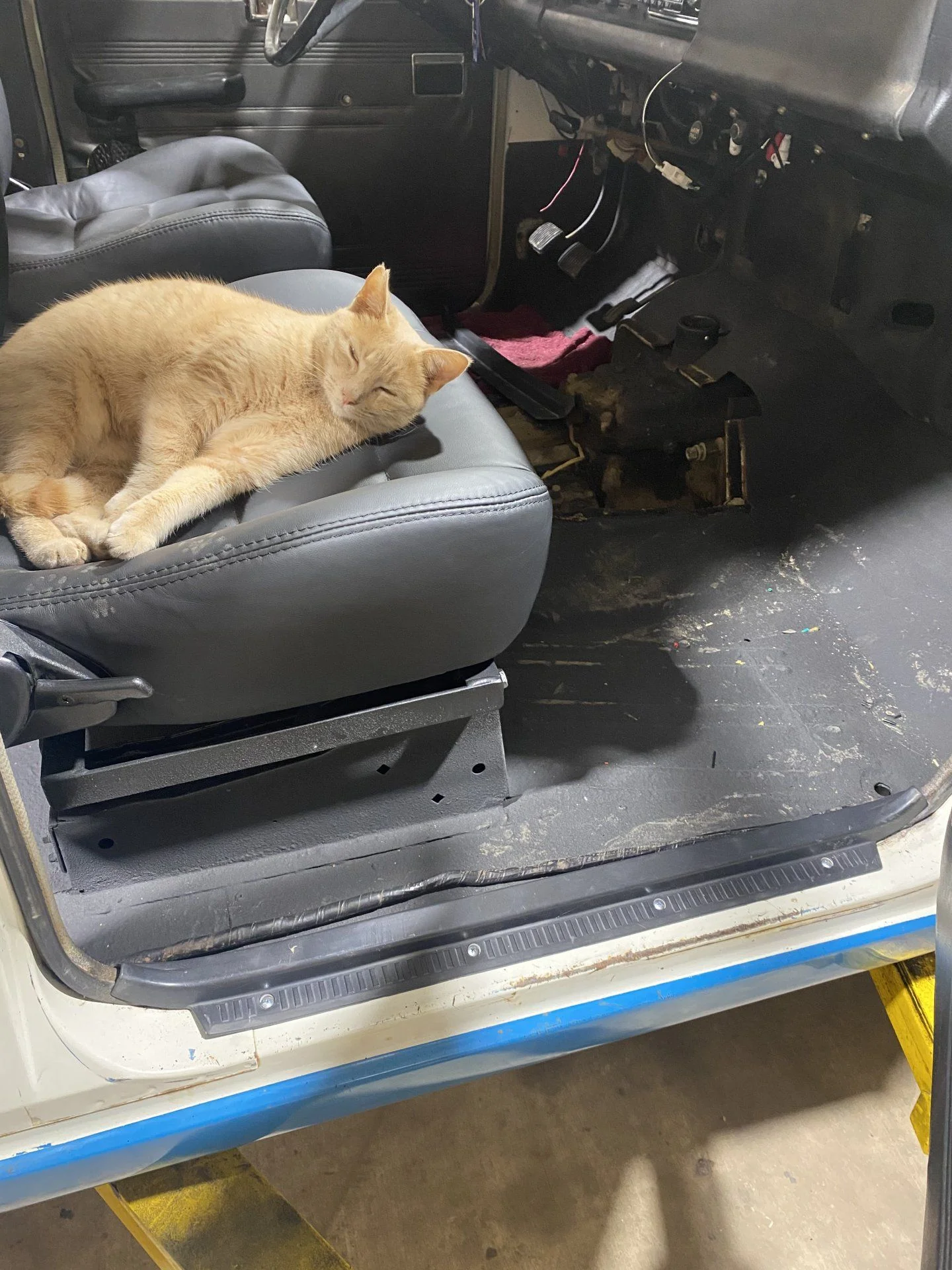

Pulled pork he hump and shifter and remembered the FJ60 door sills I got from @Ratboy at Classic Cruisers. Cowboy amd I got them installed

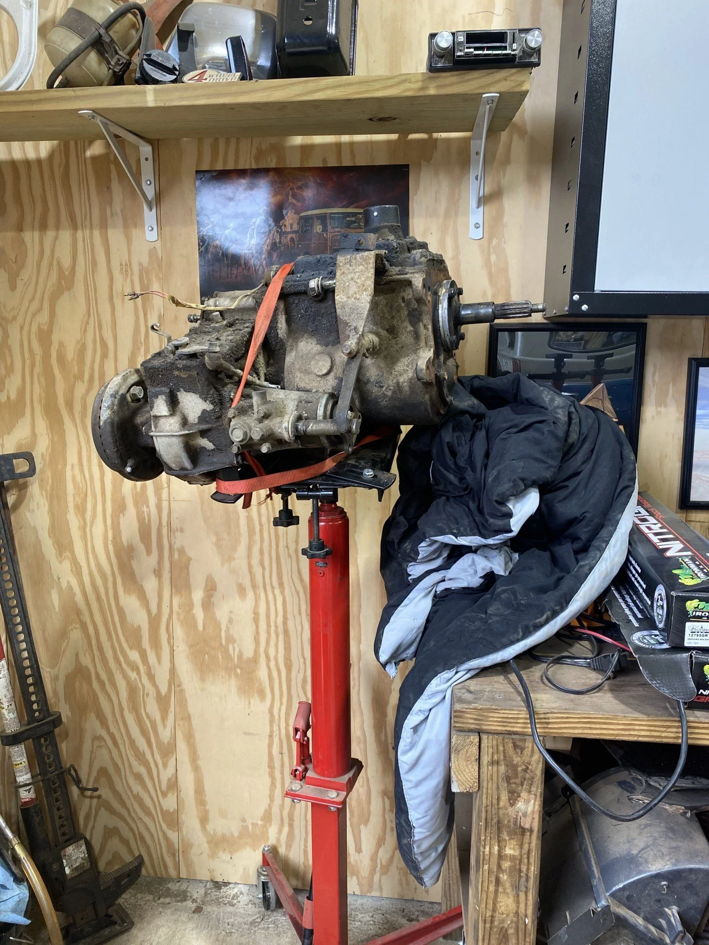

Then I moved under the truck and pulled the rest of the things connecting the drivetrain to the Pig then yanked the Trans and case out
Then I tried to move the Pig back far enough to get the cherry picker in front but had to get tires out of the way so I just went ahead and tossed them on the trailer and hauled off this weeks Limo boxes.
Got it all ready to pull but have to to run an errand. Back to finish soon

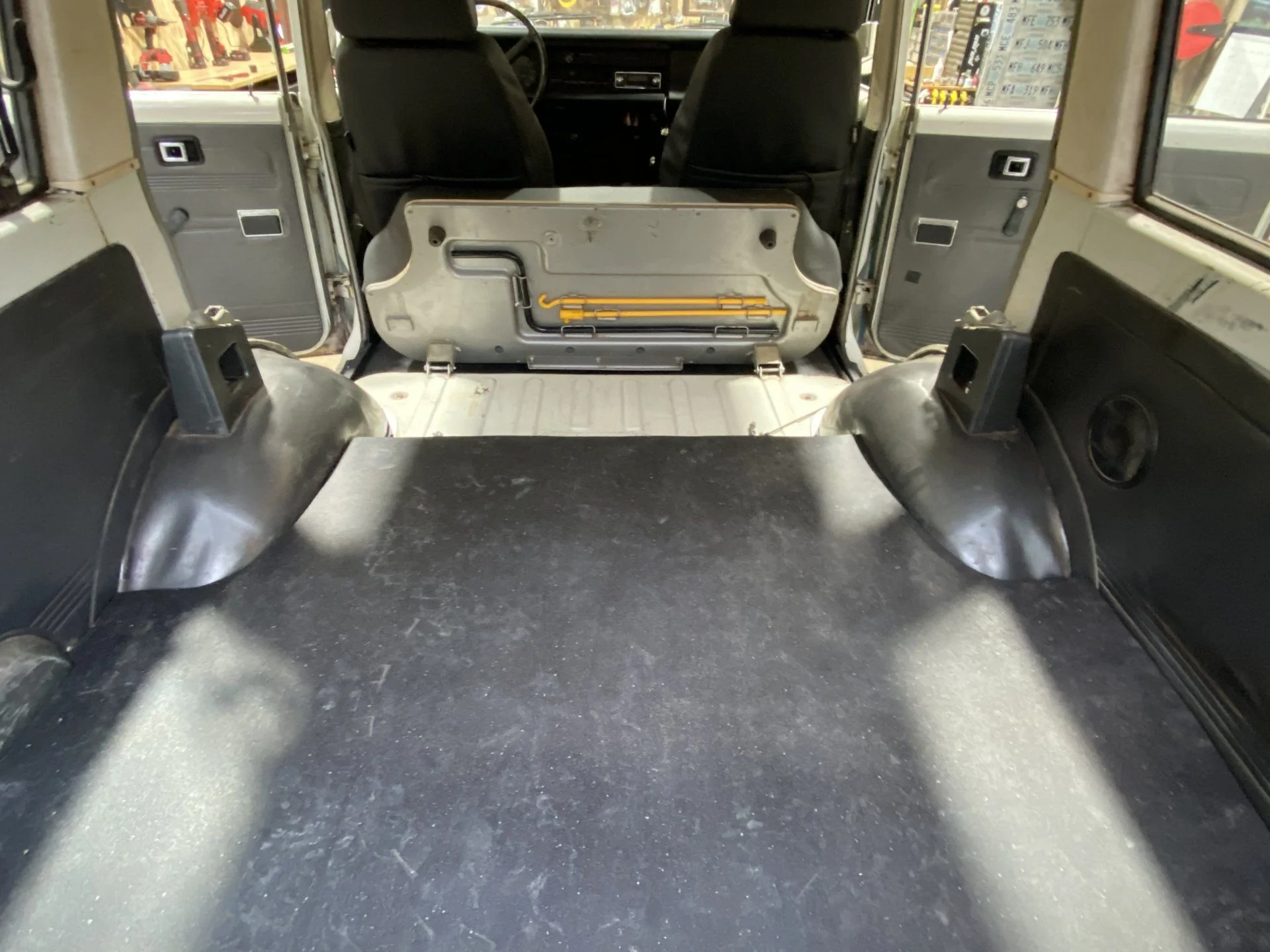

This is the Specter kit. New covers. Foam. Again. Very nice. Money well spent having them put them on. Very nice job.
Also get to show off the nice horse mat cargo mat that Mike and his son made last trip over as well as the beautiful tools from @Pigeaten

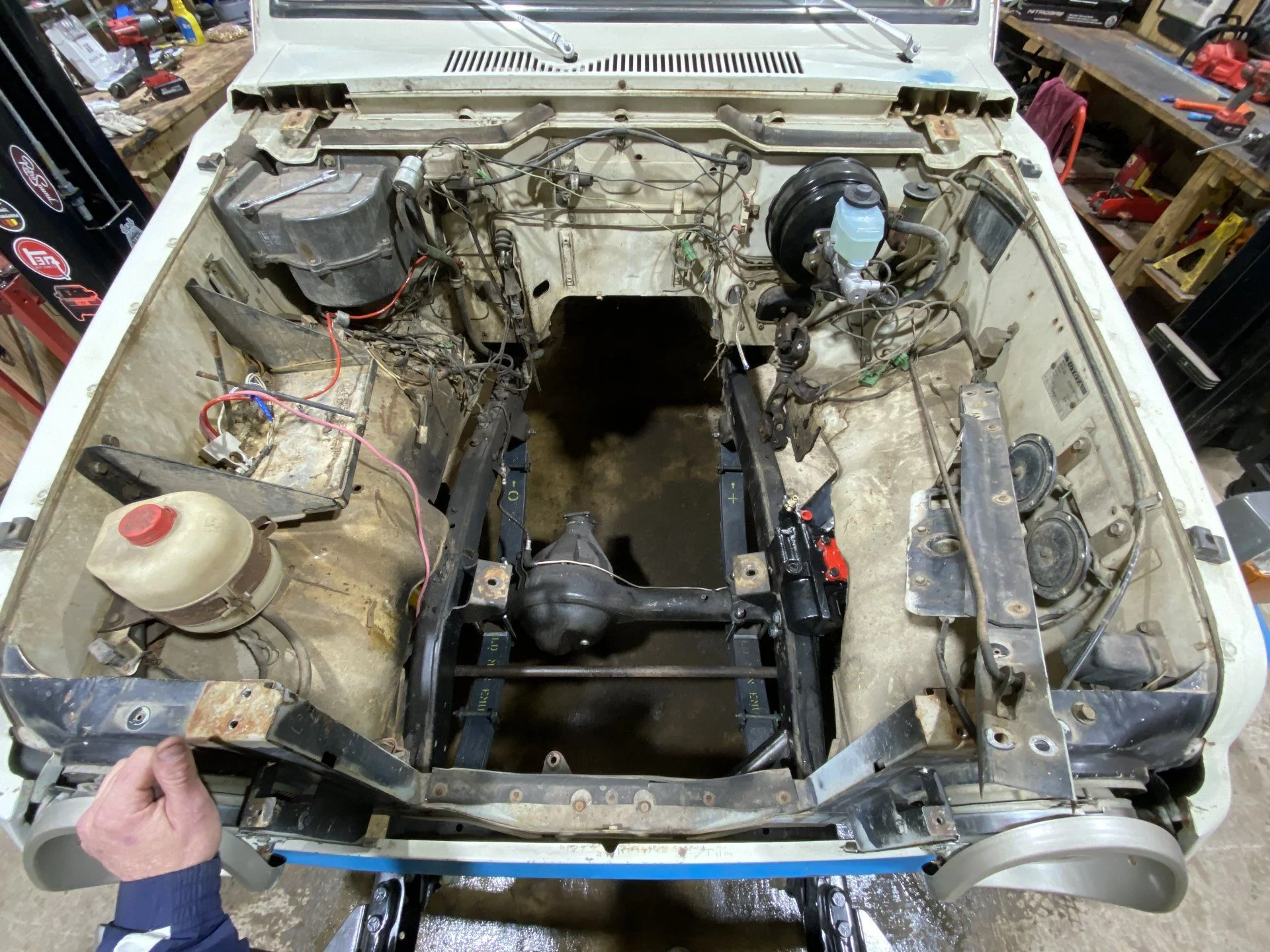

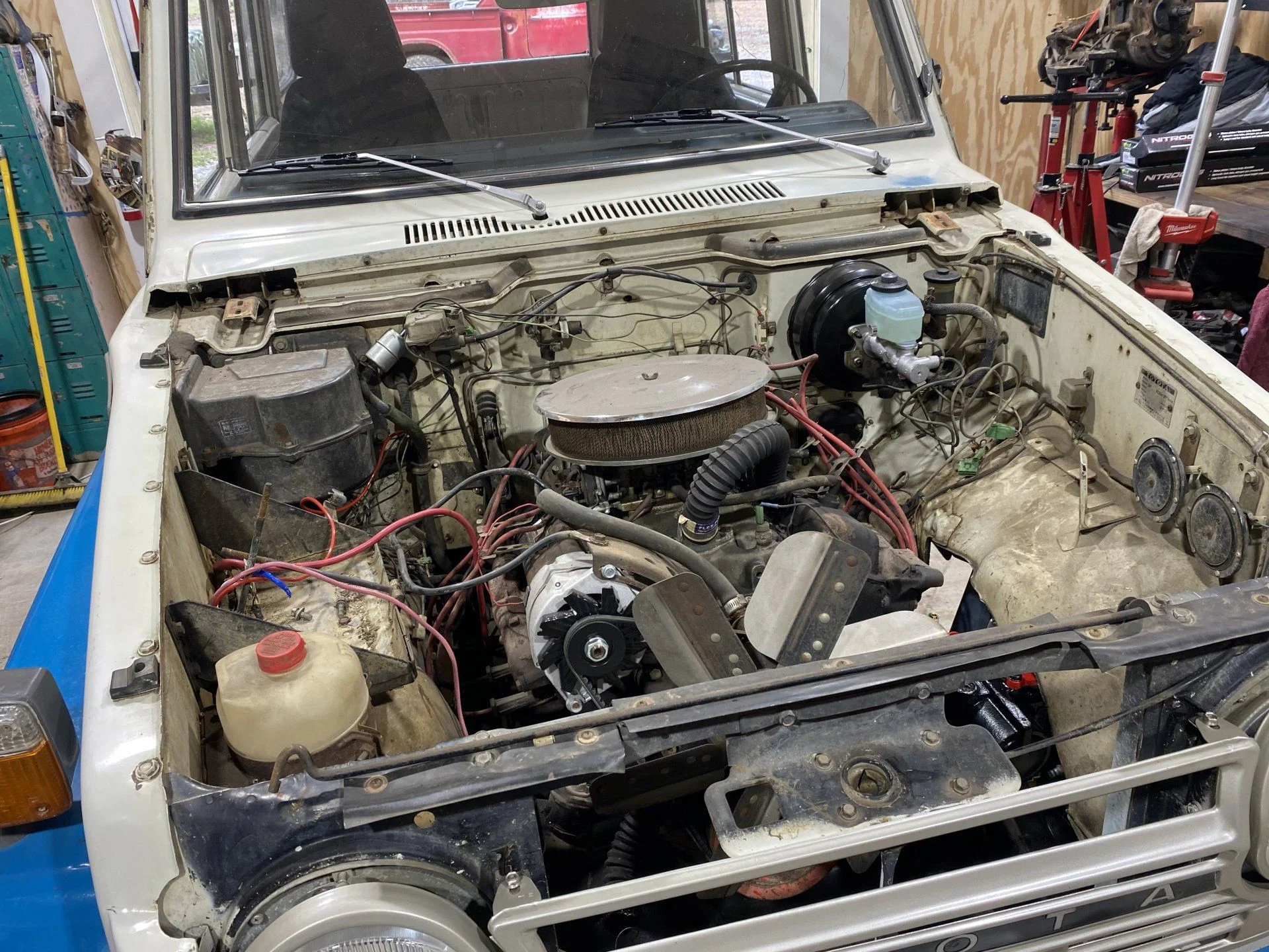

Then I jumped on my main project of the day. I would not have been happy if I did not get this done

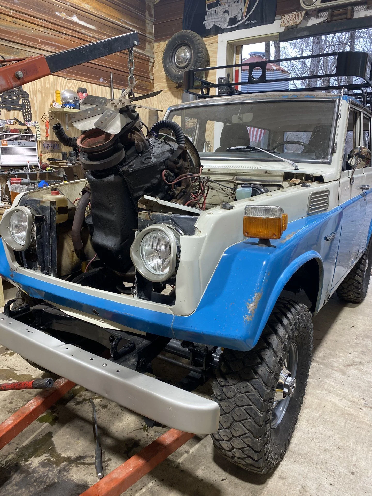

Up and out with the engine hoist. I decided this would be easier engine only being solo. That’s why I separated the tranny/transfer. Lift makes that pretty easy
Then I had to drag the Pig out of the way. Tie rod but no drag link so that was fun
Put a pallet on the forks and lowered it on. @nvrlose54 is a 350 man so he’s going to take this 💩 off the property for me
Now I clean.......
