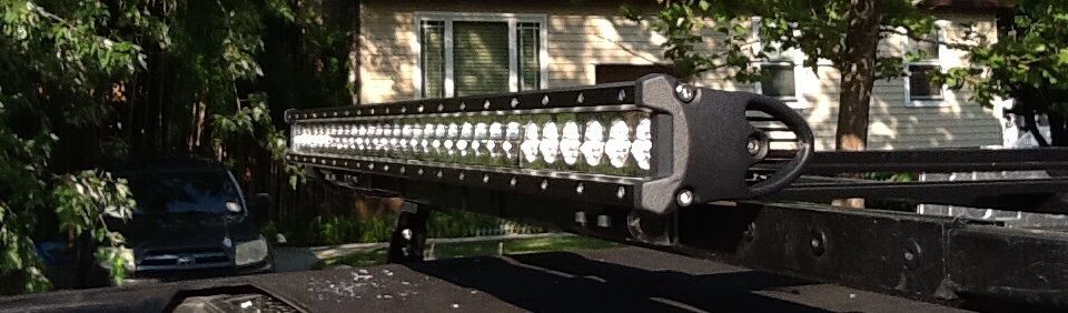

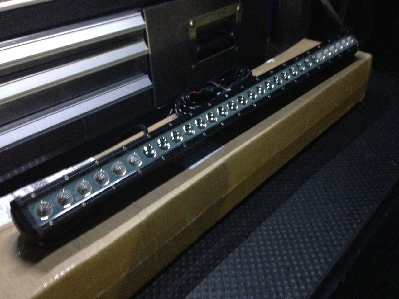

Very easy install. Just mounted it today and gonna wire it to one of the Toyota OEM fog switches when I have a full day.

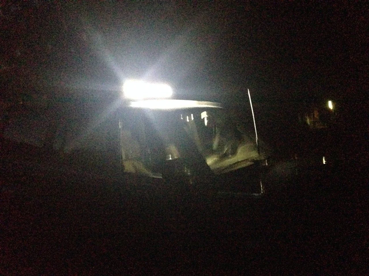

Yeh this thing is killer bright...wow!! The sunroof sunshield was open and it lit the inside up too. :smokin:

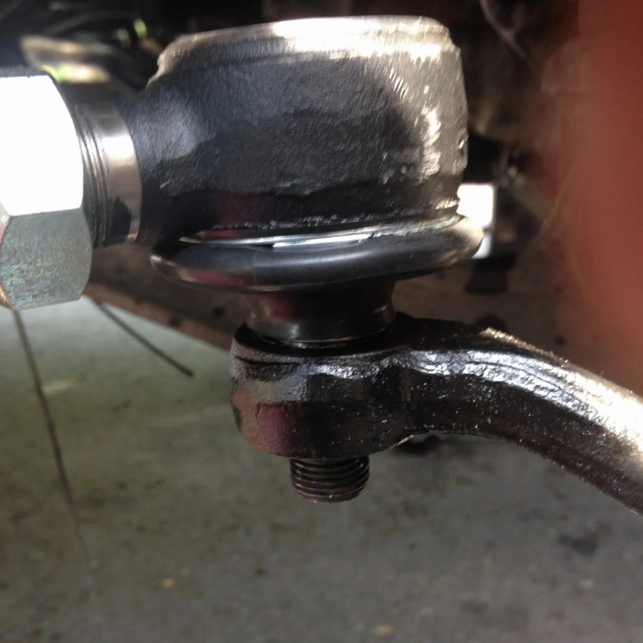

Installed Ruffstuff 1 ton tie rod ends welded to some thicker than stock DOM tubing, the DOM they sent in the kit would of hit the bottom of the pinion output oil shield. So I had to get a thinner wall DOM. Now to try and figure out how to center my steering wheel...ugghh
Had to drill out the knuckle to fit these monster TRE's, 7/8" drill but and that was it.

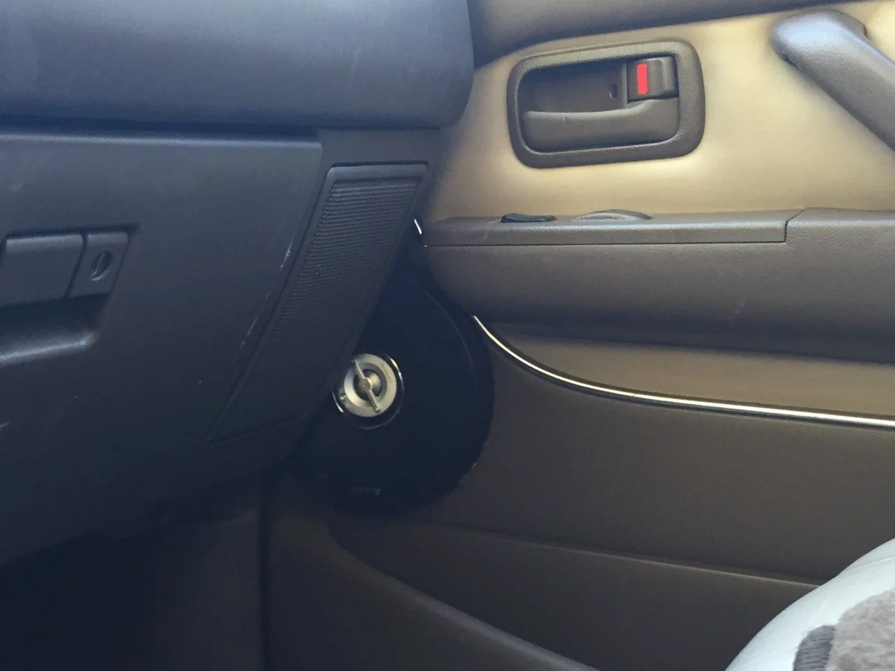

After a week of using it the front speakers just couldn't take it so I picked up a set of Infinity 6502ix Reference Series with adjadjustableeeter. So I can turn the tweeter away from the side of the dash towards the passenger and driver. Works amazingly well. Install was a breeze, and someone I know didn't want the DynaMat he had so I used that and there was just enough to do both front doors.

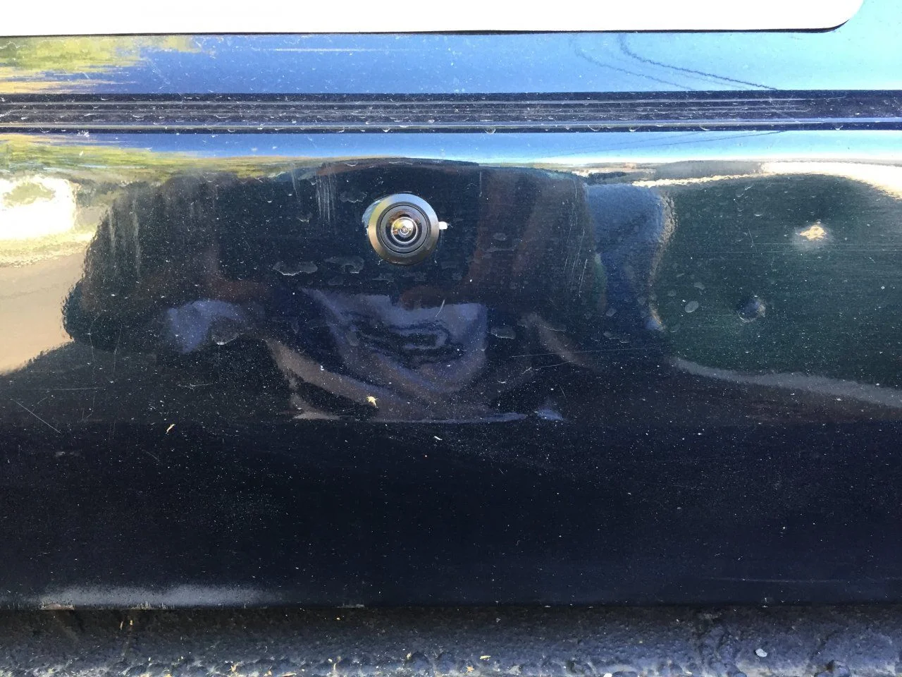

Rear camera mounted under the license plate for when i use my dirt bike carrier i can still see when backing up with the view from under the dirt bike motor. Came out good.
