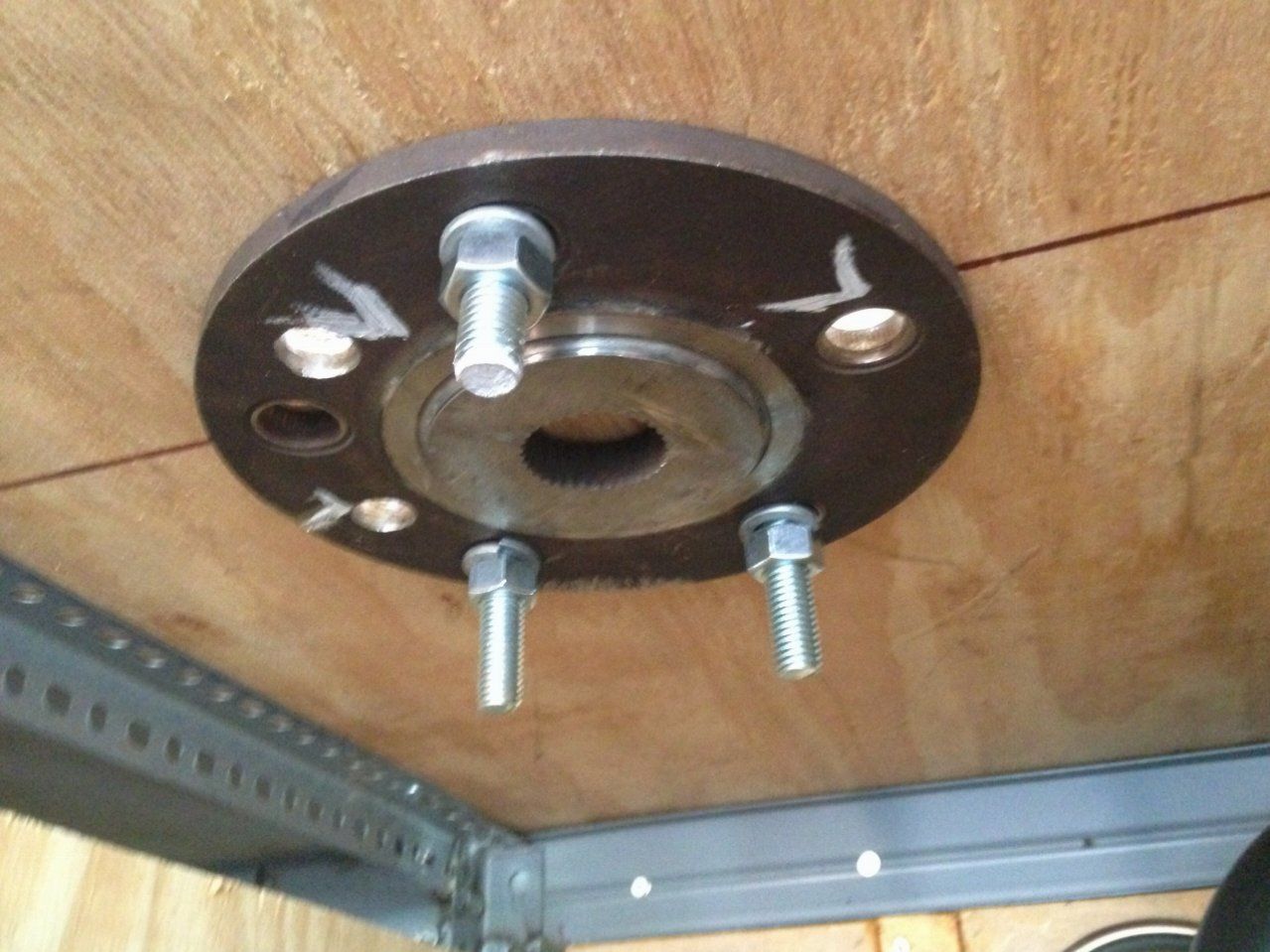

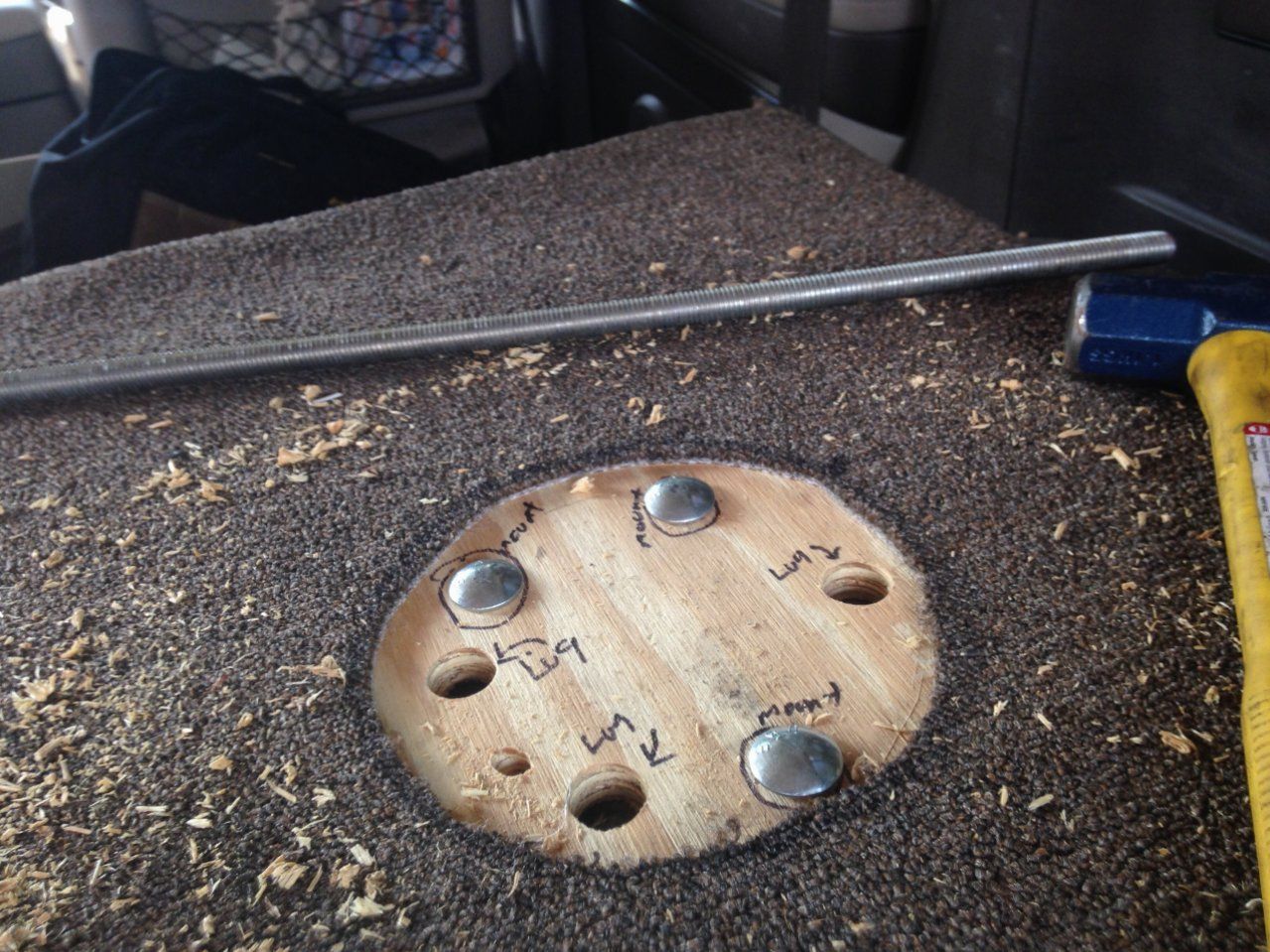

Been wanting to mount my spare to the top of my drawer system and I used an old hub and had work weld nuts to the bottom of it and mounted it to the underside of the deck. So now if I remove the tire I still have the whole deck if I need space to carry something.
