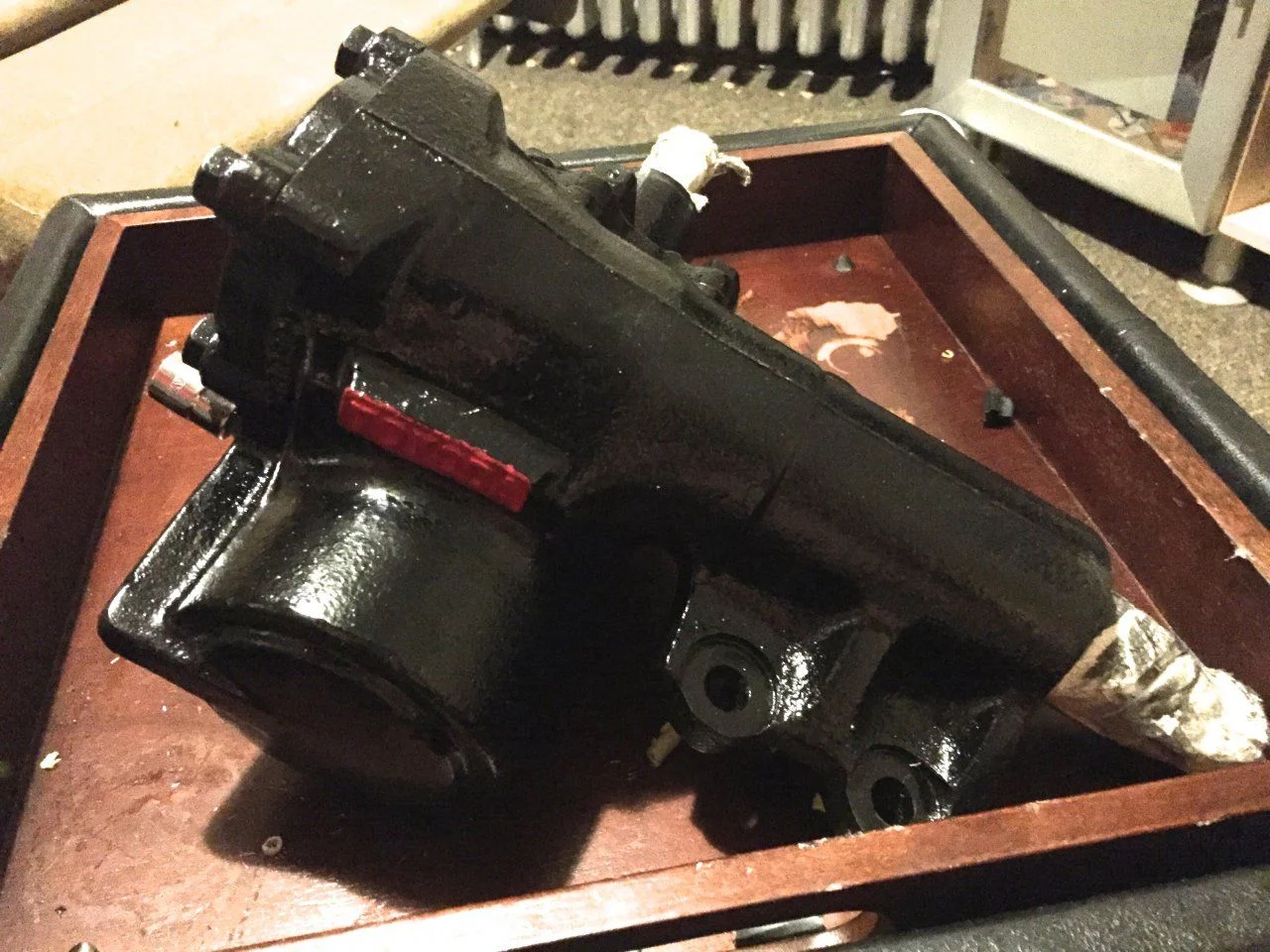

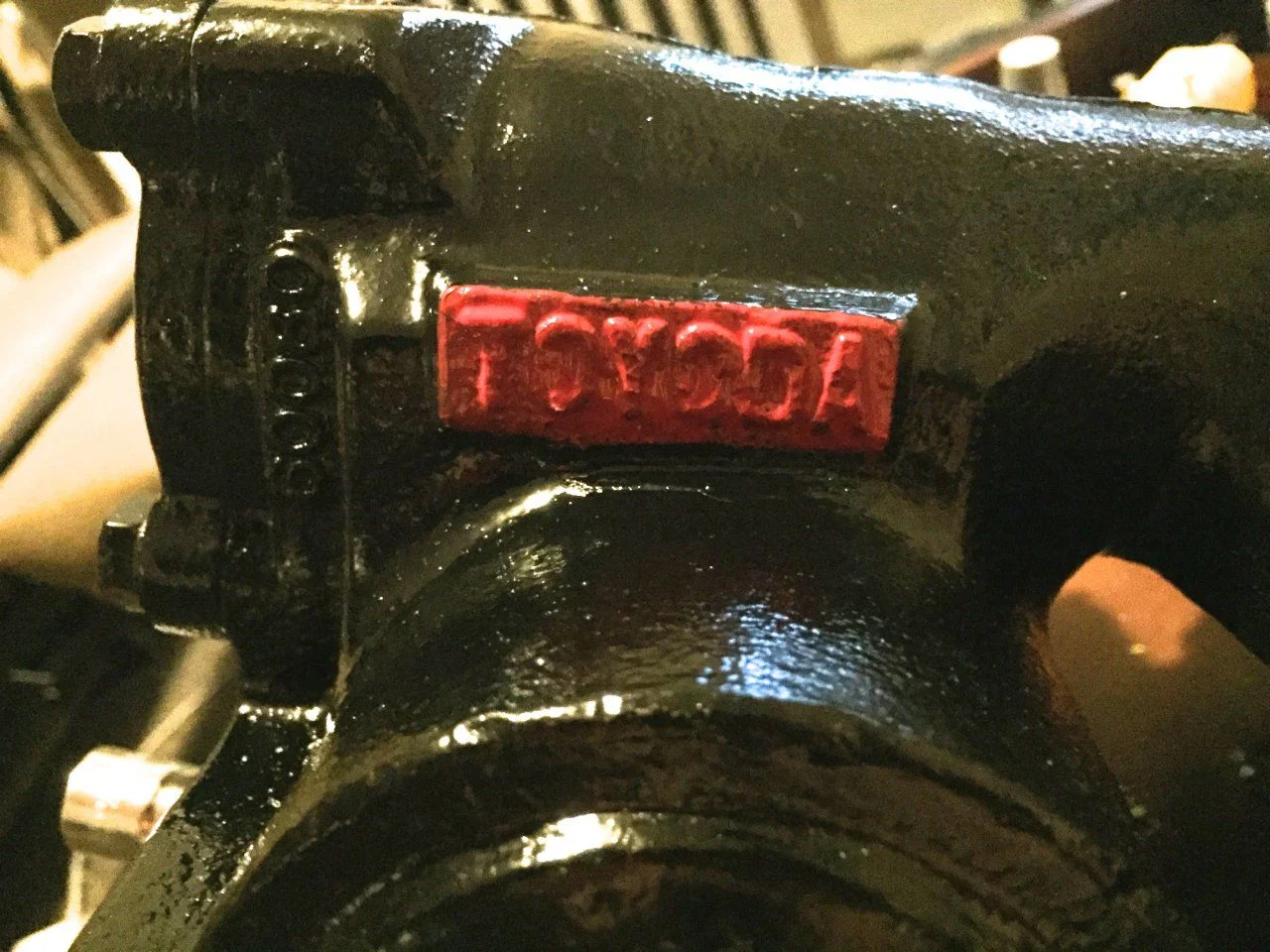

So I finally rebuilt my steering box...will install tomorrow. Going to use the Mobile Hydraulic oil. I painted the box and just highlited the TOYODA and TEQ .. yep I was bored

Steering box rebuilt and finally installed today!! Whew

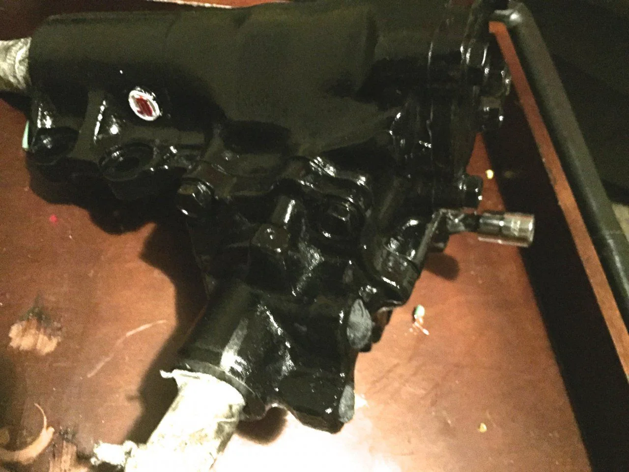

Some pics of the rebuild. I really don't want to do this again

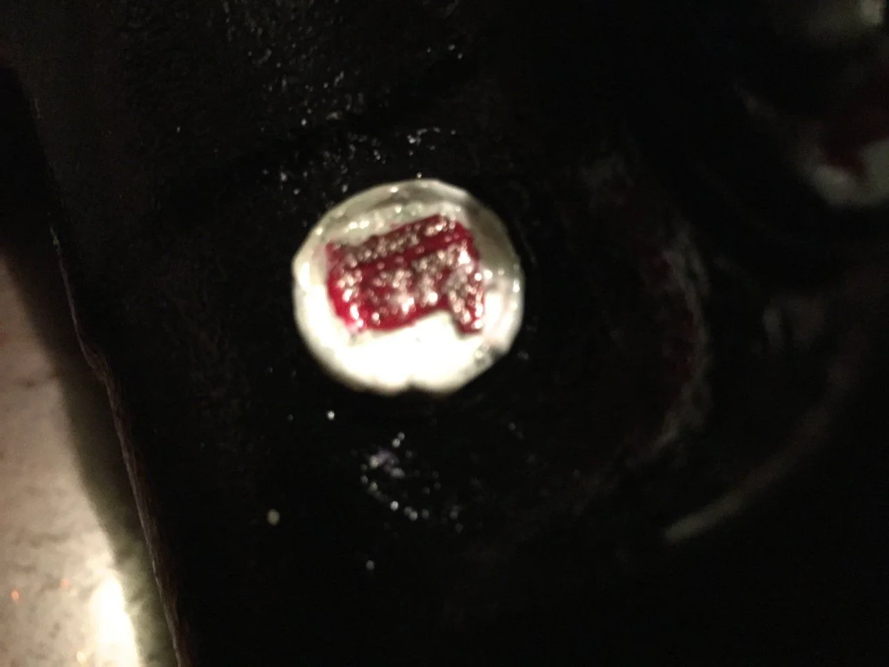

Used a 10mm Hex key and it stripped on the first turn so I got to officially use my new to me welder and welded it to the plug. It's still on there just in case.

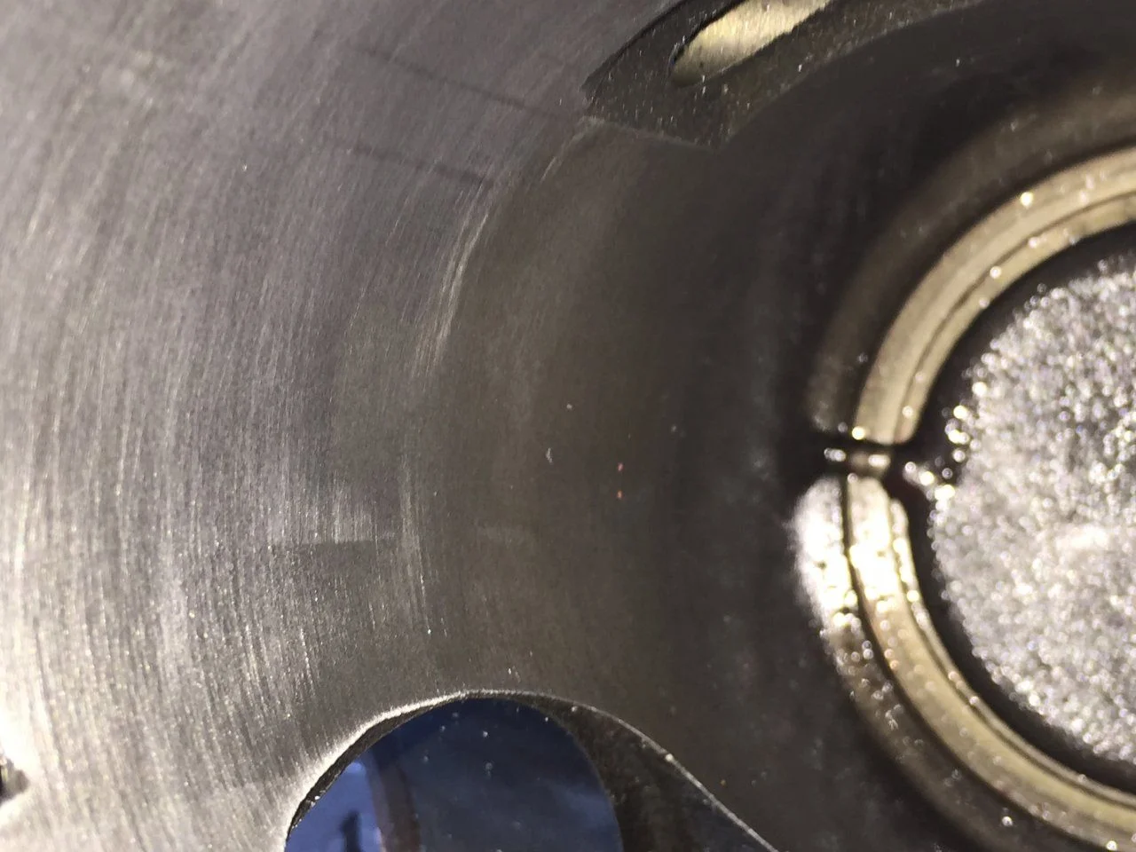

I gently used emery cloth to take off the burnt on sludge on the Power Piston walls.
Output shaft bearing and seal channel. This was a major time killer putting in the o-ring gasket, snap-
ring and shaft seal...ugghhh

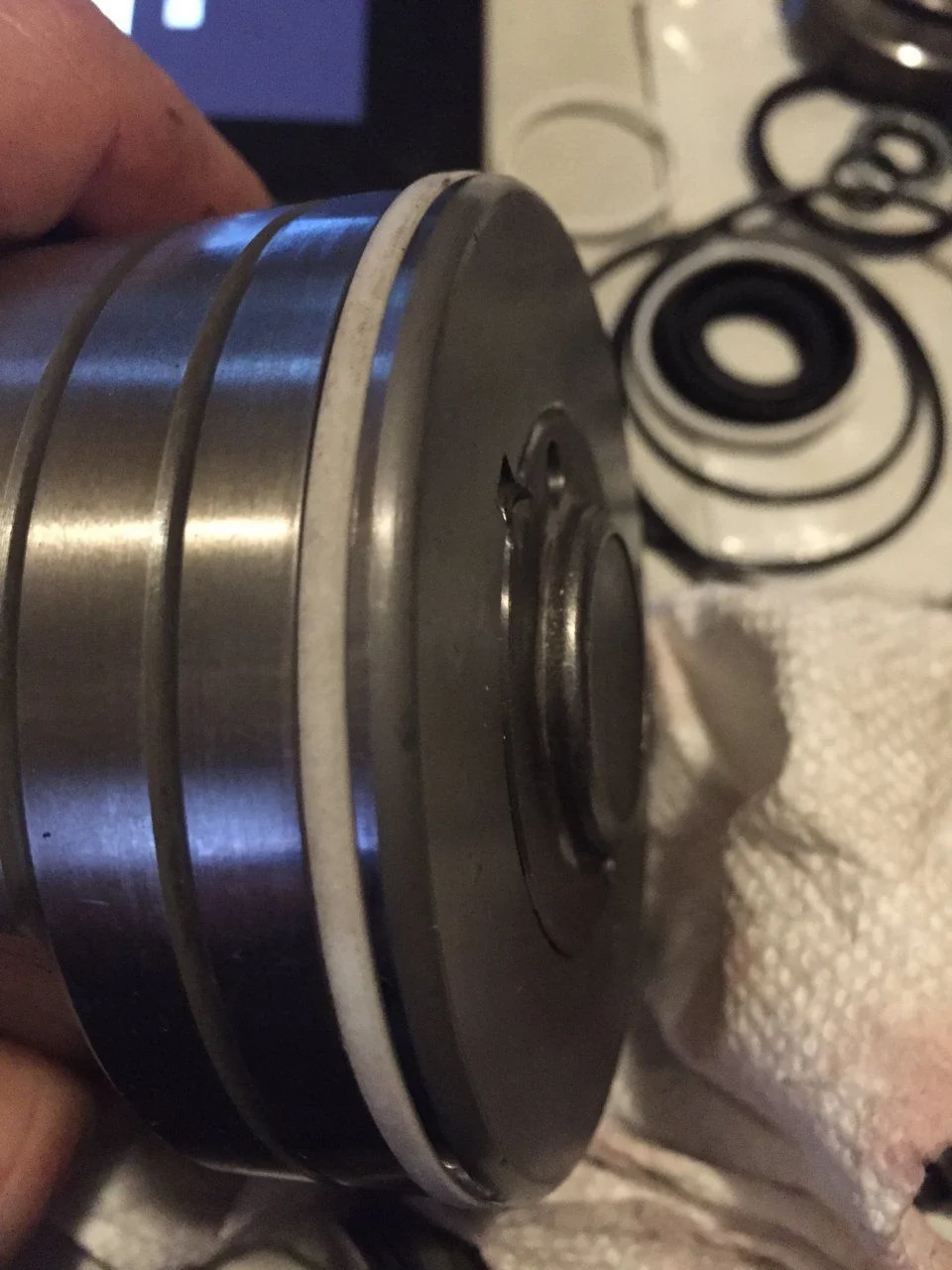

The new power piston teflon ring which got cut trying to put it in the piston cylinder, the o-ring is new so I put on the old teflon ring which fits tighter now with the ne o-ring.
Lots of other pics but they are boring so this is the meat of what I did. If I have time and good weather conditions it would not of taken 4 days to do.
I also used Mobile DTE 24 hydraulic oil.

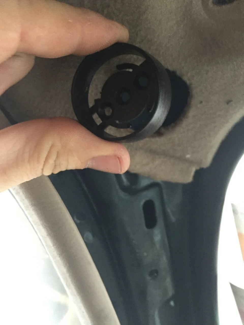

So the next thing to do is determine where to install them. I didn't want them install them in the door card and I tried to put them in the triangular cover for the side mirror bolts but mounting them would of been tough and the angle would be hard to achieve. So I looked for another spot and decided on the headliner where the roof and A pillar meet near the visor screw mount and above the A pillar garnish. I used the speaker wire that was connected to the knee mounted speakers on the bottom of the dask. They are awful and I disconnected them for good. These little speakers brought my new system to another level of greater sound. I suggest installing them with the stock system as well. They have changed my listening experience! Anywho Here's the install pics. They are tiny but pack a punch!
Location and hole. I put it in the divot in the A pillar to not squash anything. I used the mounting bezel as a templet and used a utility knife.
Test mounting of the Tweeter with bezel
Drilled small 1/8 holes for the screws to mount the bezel
Test fitting the bezel
Testing for any pinching of the tweeter wire, The bezel doesn't need to be screwed on tight

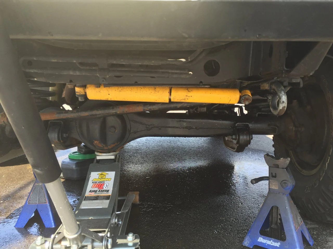

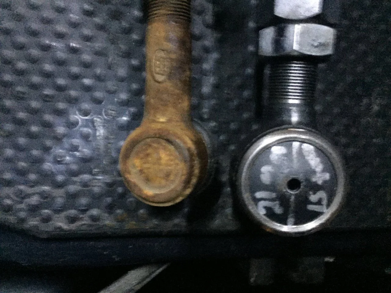

So I finally got around to installing my relay rod. The weather has been awful here and I took advantage of any day I could. So I have to take a pic of the final setup but I posted the differences between stock and the Ruff Stuff Specialties parts. The steering feels tighter and more responsive. I always was bending that and the tie rod bar so this should hold up very well.
Stock setup
Comparison
Huge difference
Comparison
Just finished today so I'll post a final pic...

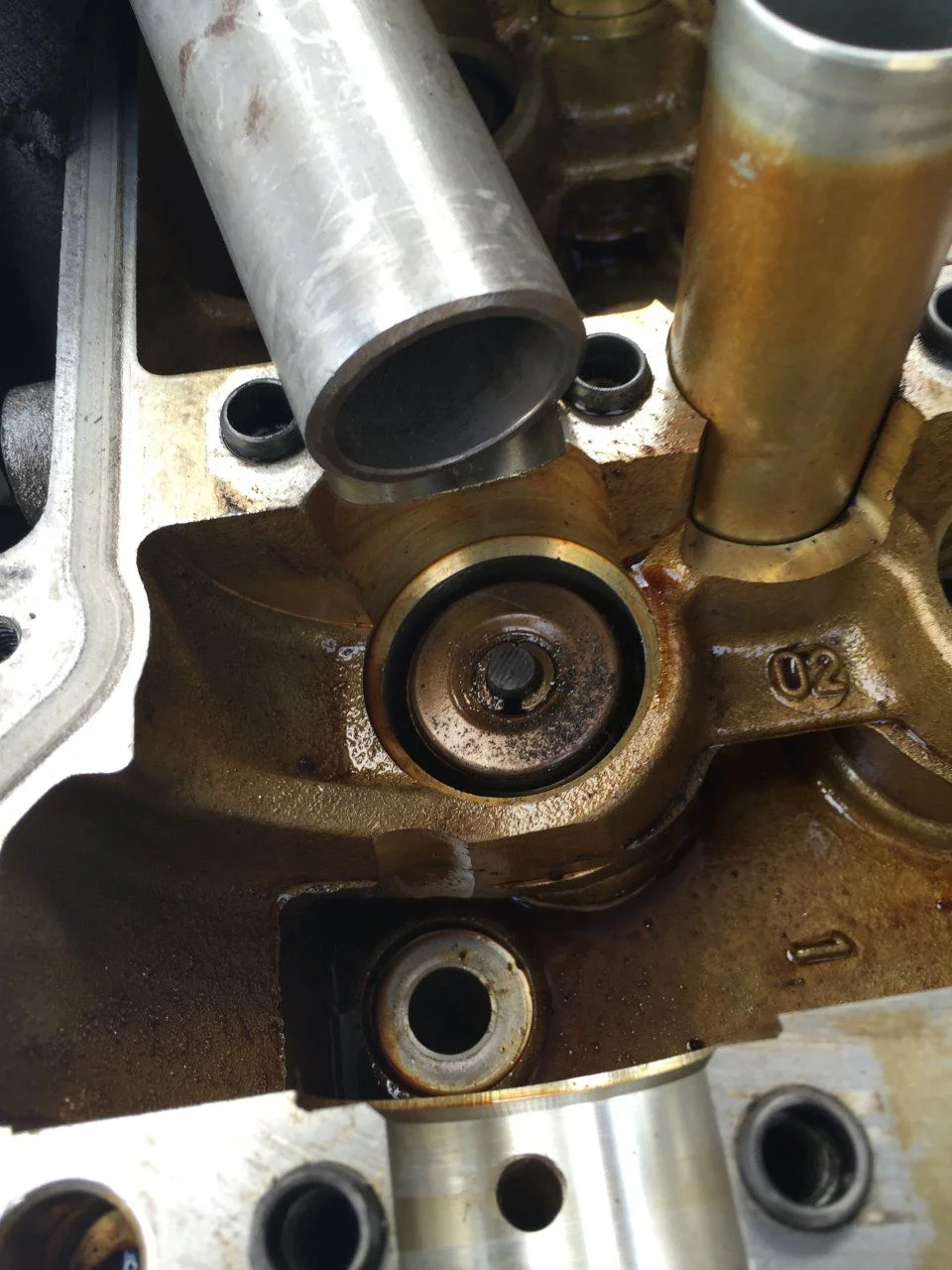

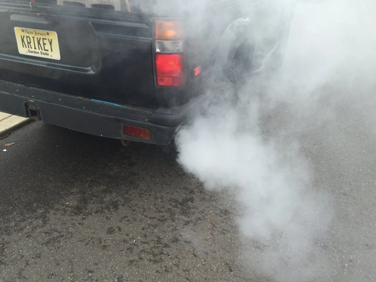

So 256k miles and was just about to head out for a 3 hour drive for a trail cleanup and wheel and just before I get on the highway, KABOOM! Head gasket. Blah. So after inspecting the cylinders with the plugs out #1 had some nice coolant in there. So between work and the weather I finally got to removing the valve springs and valves. I didn't want to waste money on a valve spring compressor so I looked around and found a nice small piece of DOM tube that was the perfect size so I experimented and it worked! I used a 2" Scotchbrite cleanin pad for an angle grinder and it fit perfect just below the valve and was in the valve cavity beween the head and a piece of NO 2 pine 1x10. I made a video, It took a couple tries but it works and didn't scratch the lifter wall so all is well. Some came out in one shot and had to lean on it to get it compressed. Check it out!
Video here and pics below
This was nothing, I left a smokey trail home which was 1/2 mile from where it blew. Never overheated. Whew
Coolant in #1 cylinder :(
Measured the head and no warpage.
DOM pipe to compress springs

Cool cheap way to get the valves out but I'm guessing you'll have to buy a real compressor to get the springs compressed again and get the keepers in.
Yeh probably. I like making stuff so I may be able to come up with something. :P
