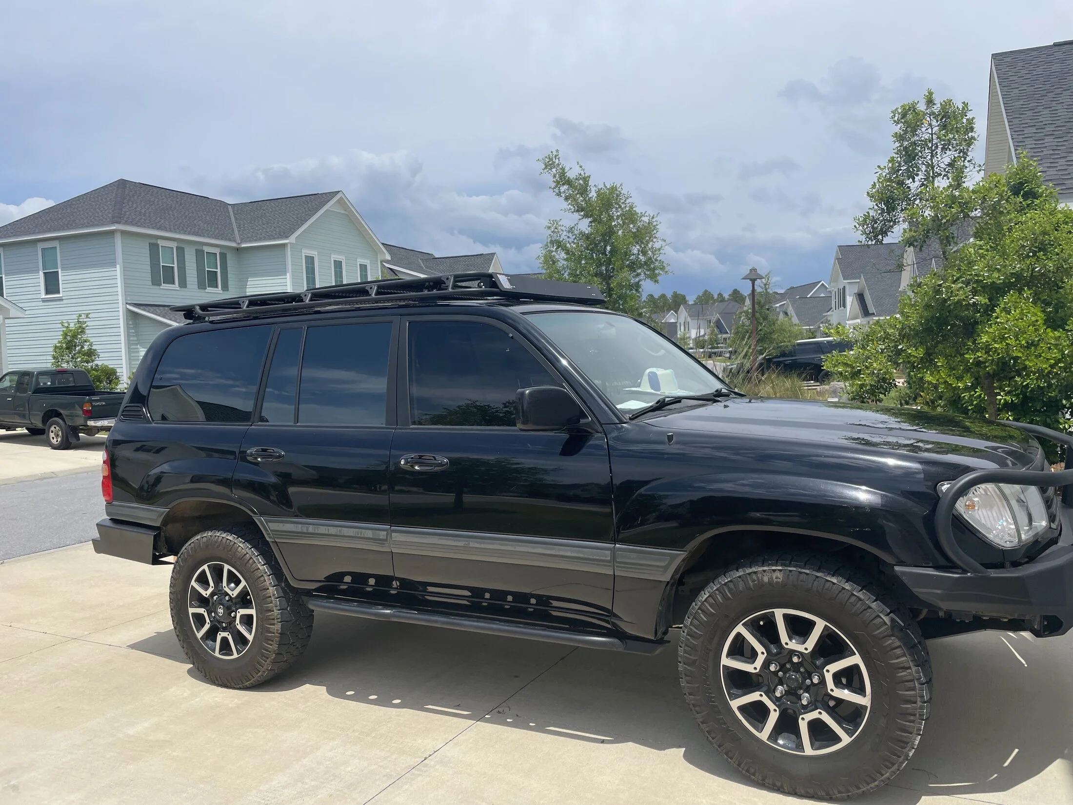

Hey @krice118 - interested in why you haven't modified the front grease caps to fit the Tundra wheel caps?
I recently purchased a set of the same Tundra wheels and after getting a nail in the west desert last weekend in my 8 year old KO2s, it's time to find some new tires and put the new wheels on.
My mechanic painted the hubs black- twas good enough for me 🤣

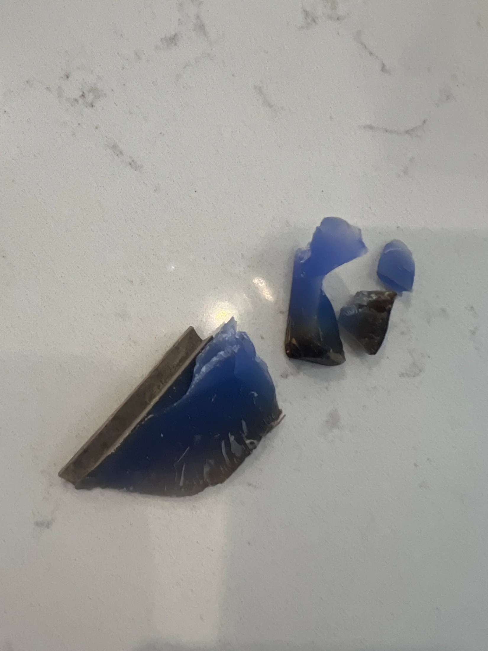

Been designated as our beach cruiser. My ironman cook slapacers have deteriorated- we are finding blue chunks falling off after 9 years / 90k miles. Quite a bit of wheeling

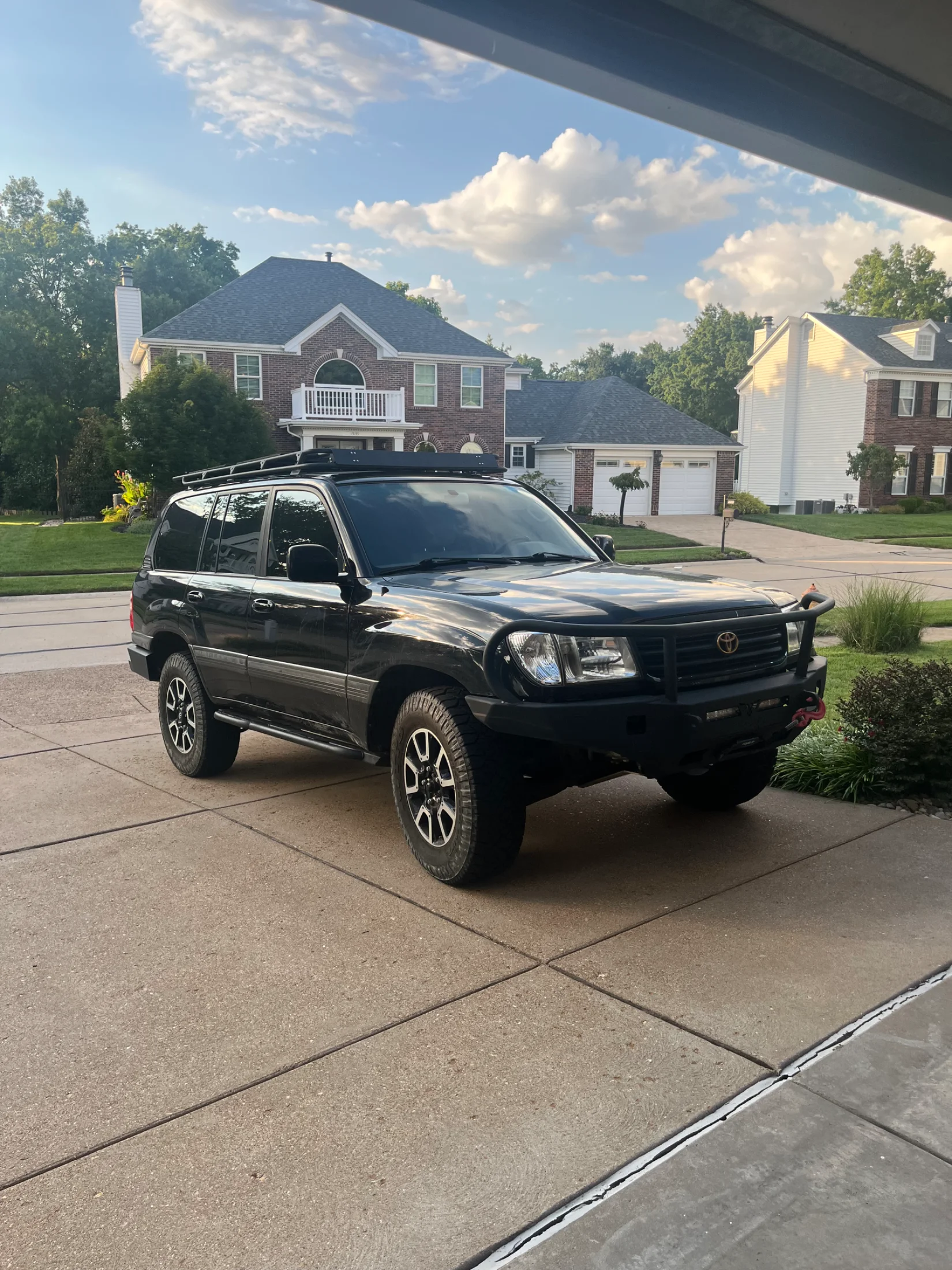

I have ASFIt skids, sliders, roof rack front and rear bumpers no swing outs. One day I’ll have a 40 gallon LRA main fuel tank.
Currently running tough dog adjustable rear shocks with OME 865 coils and the now decrepit coil spacers.
Bringing this back up from the beach for Daily driver duty.
Swapping 863s in the rear, 40 gallon replacement tank and some misc TLC.
