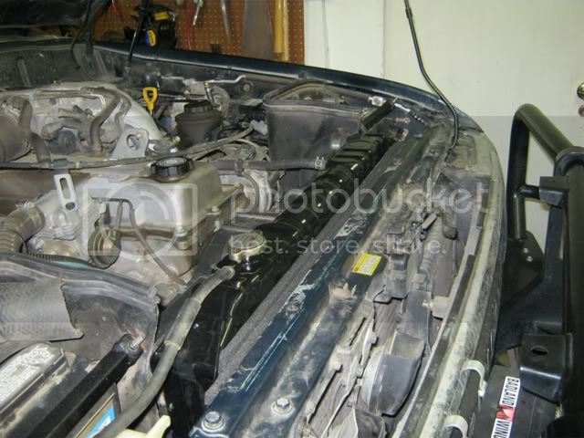

Radiator is in. Sweet!

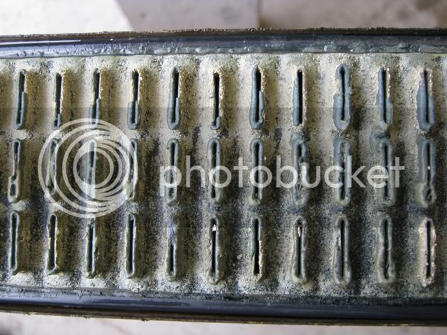

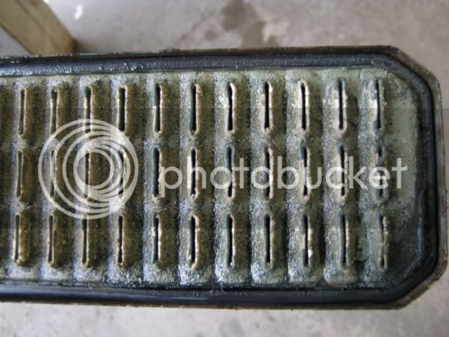

Noticed a change already in the temp gauge - it's running cooler. Still working out the air bubbles (nose uphill helps). Out of curiosity I opened up the original radiator:
My rig has 238K on it and I've kept good records on the maintenance. When I got it the mileage was 129K. There was a period when I didn't change the coolant regular :o, about 6 years. Who knows how often it was changed before I had it. Moral: Change & flush regular, every 2 yrs at most.
