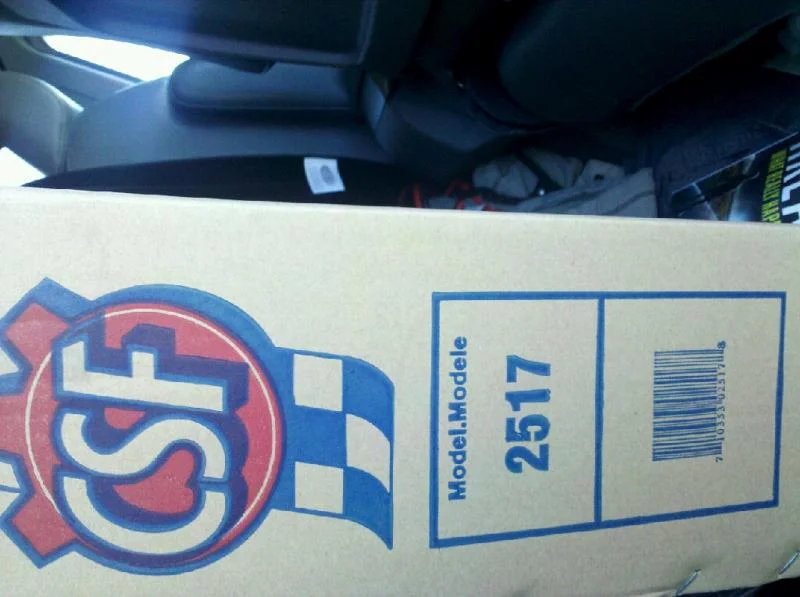

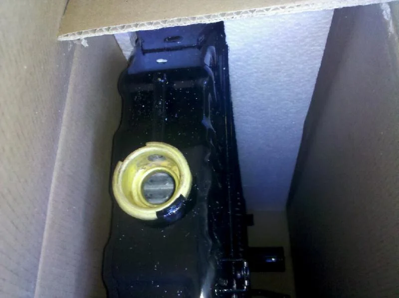

I took some quick pics with my Cell, the RAD is still in my truck, so I ran out real quick and took some pics.
Anyway, the partnumber on the box, which is probably what CSF goes by is 2517, but my invoice says 1917CS
Also I took a GOOD look into the radiator, it appears to be 3 row, I tried to take a pic of the inside as good as a droid would let me, but you know how that goes. But then I decided to look at the CSF website and look, here it is CSF Inc. - Illustration And Specifications. That states 3 rows as well.
I will take some more pics later today with my SLR camera.
So please let me know if you guys need more information.

Doesnt look like aluminum to me :hhmm:
