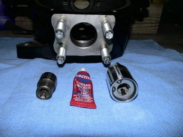

FWIW: I did my front axle service one year ago using the info from this thread. I chased the threads in the knuckles and then cleaned them with tons of brake cleaner and let it dry. Then used blue Loctite on new style studs and tightened them until they were snug using a small ratchet and female torx socket. It was a combination of feeling like I couldn't safely go any tighter while watching the threads disappear into the hole and seeing the unthreaded portion of the stud about butting up against the rim of the hole, that's when I stopped tightening.

What Tools said: I should have been more clear; I installed my new studs with everything apart and with the clean degreased steering knuckles sitting on a table. Edit: The socket on the right is a stud removal tool, worked great.
Do you have the part numbers ? I think I will do this when I re do the front knuckles.
