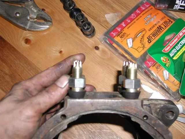

Got the new studs in the knuckle.....these are purr-tee indeed.
I did not use locktite and I torqued them down real nice and tight. I am keeping the old ones in a baggie with the nuts and cone washers as trail spares just in case.
Nice upgrade IMO.

beno, why did you choose not to loc-tite the studs? Just curious? Also, what did you torque them to? I'm about to do this job, and I ordered the new style studs (along with everything else) from CDan, so I am just trying to gain any insight that I can beforehand.

Re: ~Locktite: just don't want another thing to worry about when I break the truck on the trail. Quick on and quick off with the studs if need be. No worrying about torches, etc.
FSM calls for 71 ft. pds on the nuts/washer/cone washer, so I figure at least 50 ft. pds. on the studs. I did 50 and went a "bit more"--probably close to 70 ft. pds.
