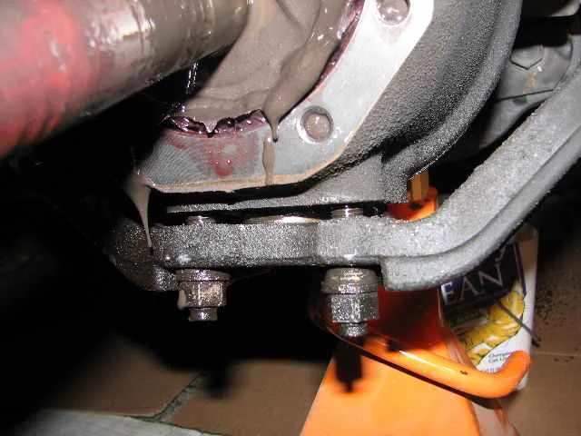

Well, looks like I joined the broken/missing knuckle arm stud club. Hopped in the LC after work to take the wife to the doctor and immediately noticed a lack of steering. Went about three blocks to a parking lot and had a look. One stud missing, one stud broken and two hanging by less than a full turn. I actually found the broken stud in the driveway.
The scary part was the wife has been driving the truck this way. From talking to her, I think it may have broken loose last night when she was just a few blocks from home. Then she drove it today to take the boy to school, go to the park, and then pick the boy up - probably about 15 miles total. We had a little talk about what to do if she notices anything out of the ordinary when driving.
I tore it all down tonight and got everything cleaned up and ready to go. The lower knuckle bearing was shot and of course the studs but everything else looked OK. I plan to replace all four studs, washers, cones, nuts and both the knuckle bearings.

Hope that top pic is not of your knuckle after only 20K...serious soup going on there. :eek:
Most likely caused by the loose steering arm. That side will need to be completelty re-done.
With the bolts in the condition they are in, there is a little extra movement in the axle shaft, which took out the axle seal and of course made birf soup. For the most part, it was just grease in the knuckle. Only a little oil made it in.

Well, I got it all wrapped up. I found all the parts at a dealer in Tacoma - about 40 miles south from me. Same dealer I bought my Tacoma from. They had everything except the nuts for the knuckle studs and the clip that holds the axle shaft to the birfield (said the closest place for the clips was some place in New Mexico :rolleyes: ). I reused the three nuts I had and purchased a fourth from the local fastener store. I'll probably swap them all out soon. The birf/axle shaft I just cleaned without disassembly. I also used a little Locktite on the new studs just for good measures.
The parts guy was great. He was short all the gaskets associated with the spindle so he opened up the kit he had and borrowed the gaskets from there. He gave me a real good price on everything too (always at least ask if they offer any discounts - usually they'll give 10% just for asking). As I was talking with him, I found out he is Landpimps part guy. I can see why Pimp is happy with the service he is getting locally.
While I was standing there, I was talking with another one of the parts guys. He said they just sold a set of studs last week and was surprised to see another set going out. Then, not five minutes later, he got a call from someone looking for a set.
During reassembly, I notice a little more damage. Apparently the birf was moving around enough to grind a little of the axle housing right next to the upper trunion bearing. The bearing race seated fine and there wasn't much chance of me replacing the axle so I just went with it. Don't really think it will cause any problems.
Everything else went really smooth. The birf job really is quite easy.

WOW, that upper trunion bearing area looks like hell! Are ya sure the race will hold?
No - I'm not sure but I think it is OK. The old race was still in solid when I beat it out and to new one went in nice and tight so.... I think the picture actually makes it look worse than it really is.
Looks okay to me, little material missing :)
