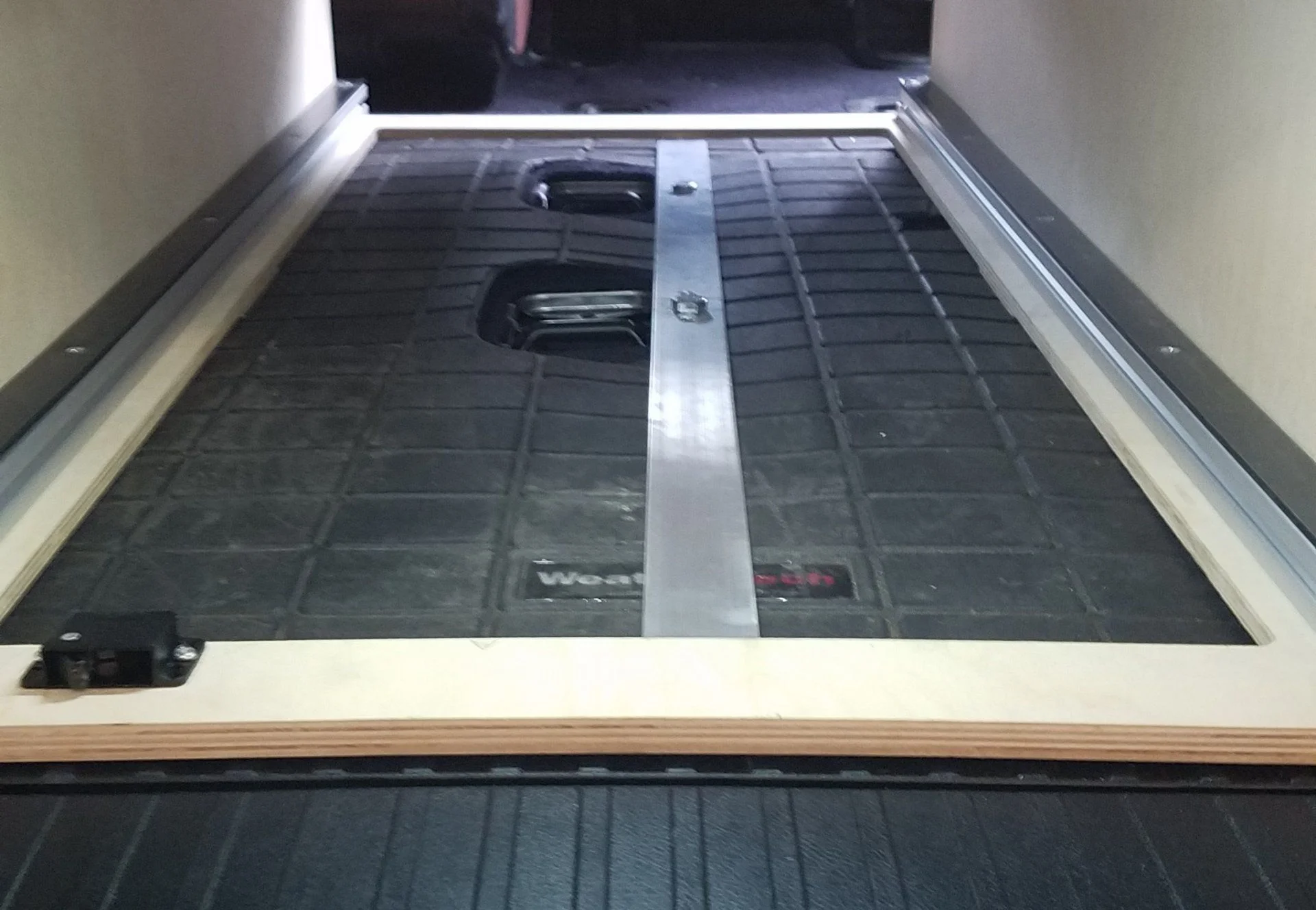

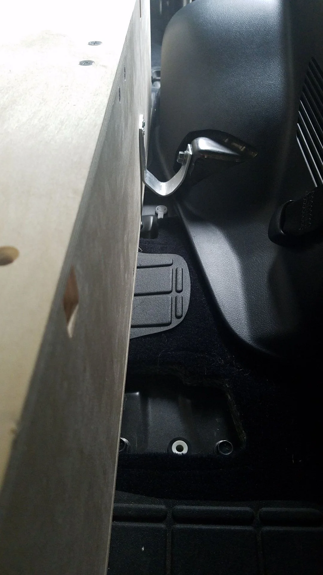

Installed first drawer, working on wing now but after fabing main anchor, I fabricated an anchor from remaining aluminum to the side 3rd row seat mount. Gives it more lateral stability.

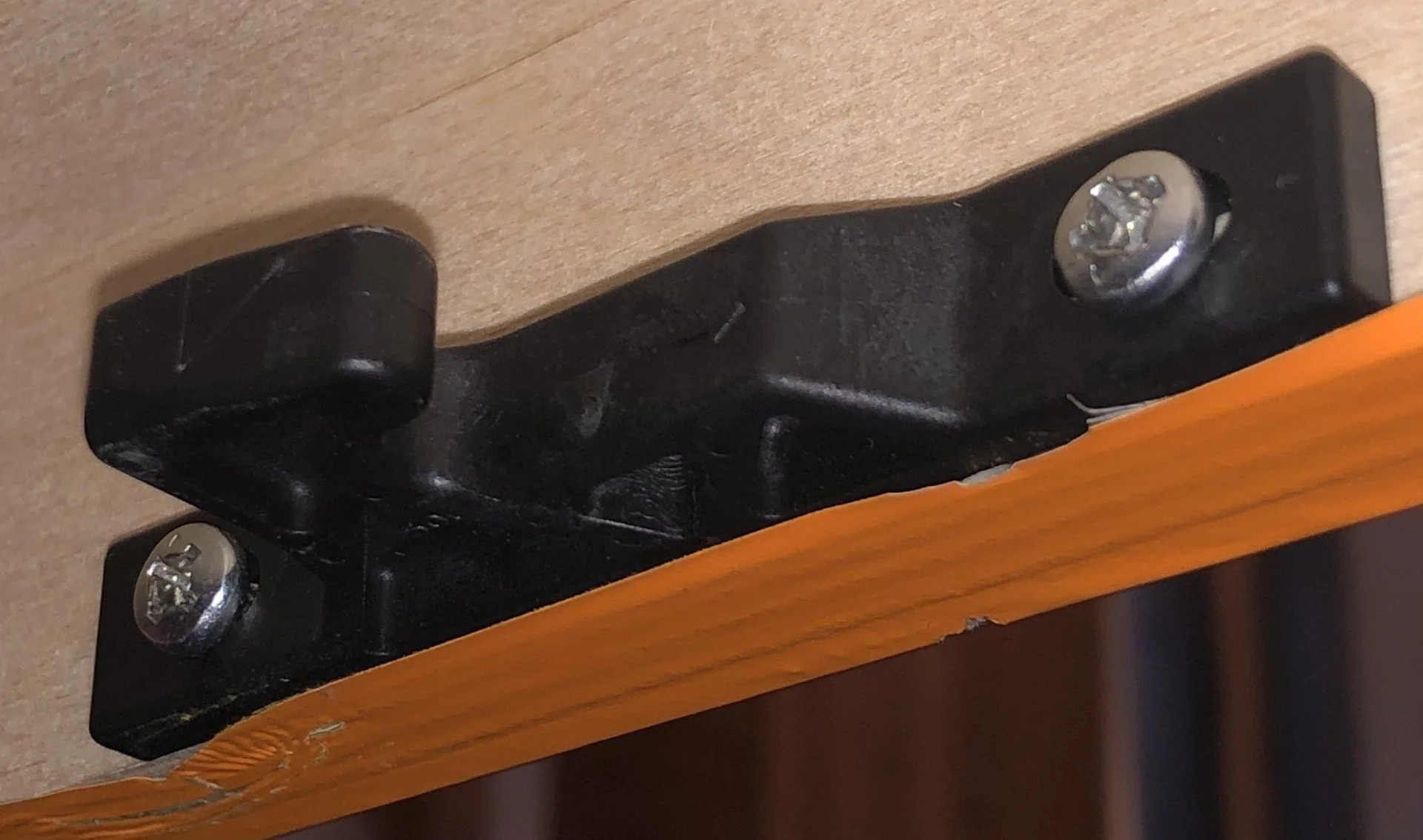

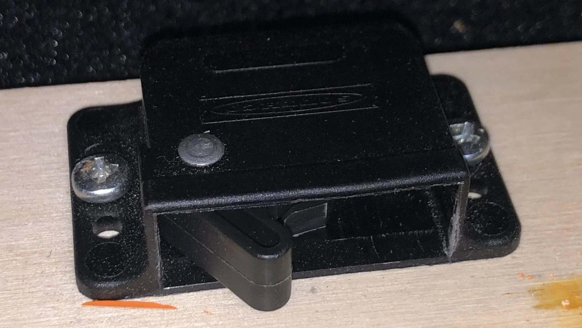

For those using the standard drawer face of the recessed face with a fire extinguisher, how do the drawers stay closed? Is there some sort of hold-down mechanism inside that I can't see in the photos, or do they just not slide without manual effort?

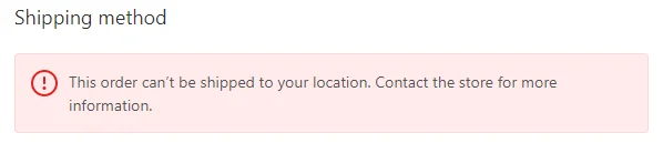

Also, anyone else ordered recently? I tried to place a single-drawer order (I wasn't 100% sure yet, but it's the only way to get the shipping cost) but the website says this can't be shipped to me. I PM'ed @cruzerDave but no response so far... guessing he's backed up from the holidays
There is a latch on the bottom backside of the drawer face and the inside of the cabinet carcase that helps it latch. It isn't like a lock or anything, just some additional resistance to opening.
i had the same issue when trying to purchase today.
Thanks. Good to know I'm not alone. I hadn't seen a reply to my PM to @CruzrDave so I'm guessing they are backed up from the holidays and must have disabled purchasing. Hopefully he's doing ok. I'll order whenever it's available again... likely not going to install it until April anyway since my garage isn't heated and it's too cold here in Chicago to be working in it for any length of time.
When I bought mine there was no stock. I signed up for the text message prompter, and when I got the text ordered immediately. Items stocked out around 2 hours later . . .
Hey guys, apologies but I've been slow crawling back out of my holiday shell. Well, that and this is just too much for one guy anymore and I lost my part-time help and am in process of training up a new one. While moving drawers for GX, Forerunner, Land Rovers etc into production. And more SharkNet models. Anyone want to buy in to a booming business to help it grow faster? ;)
I am revamping, yet again, the ordering process because of problems that just keep cropping up. I think I can finally get to stocking product with my new helper, and if not well we are looking at the old notify-me system (but I don't think it will be needed much). Existing pre-orders will be fulfilled in February, invoices going out soon.

Might be a dumb question, but are you guys removing any floormat in the cargo area before installing the drawers? I was thinking of ordering a heritage edition cargo mat, but wouldn't I need to cut holes in the mat to use the reef anchor kit? And I wasn't sure if there was even a need for the mat under the drawers in the first place.
Have a weather tech mat and cut holes to anchor drawers down. Mat can't be seen and not really necessary but I had it so I used it.
