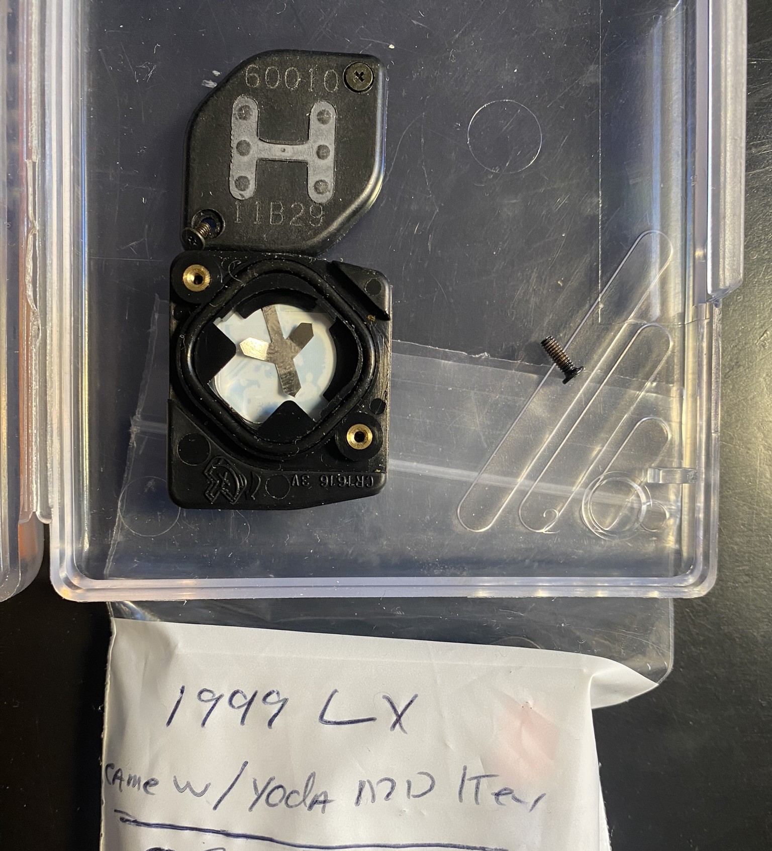

I buy used OEM master & OEM FOBs, from ebay or anywhere I find them.
Make sure to check part numbers, for LX and LC FOBs for your year. If you want both the FOB (doors) and immobilizer chip to work. I'm 98% sure 98-02 LX is same as LC. This one should work, but do your homework.
