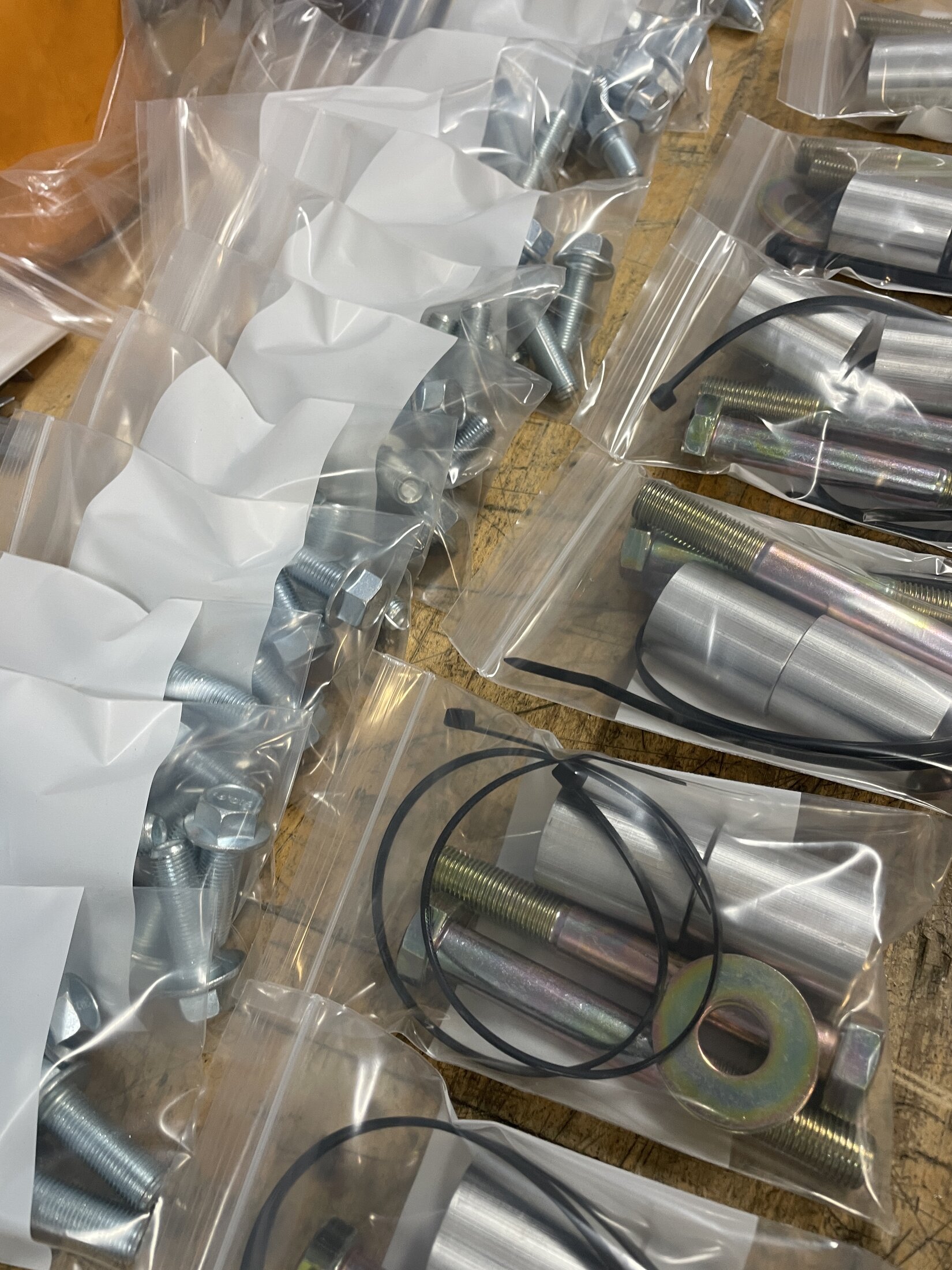

Just finalizing the Hardware kits... Instructions will be a 1st draft, as I need to get time to take my truck apart to take install pictures but it's pretty self explanatory..
I made some running changes on the LCA skid to allow for more "wiggle room" when you line up the End link -> Spacer -> LCA threads.. Feedback is always welcome..
You will need to loosen your KDSS valves... so always good to check those out before you need to loosen them 3 turns..
Shipping 1/14/25 — this Monday
everything packed and will be in the mail tomorrow, notifications sent.

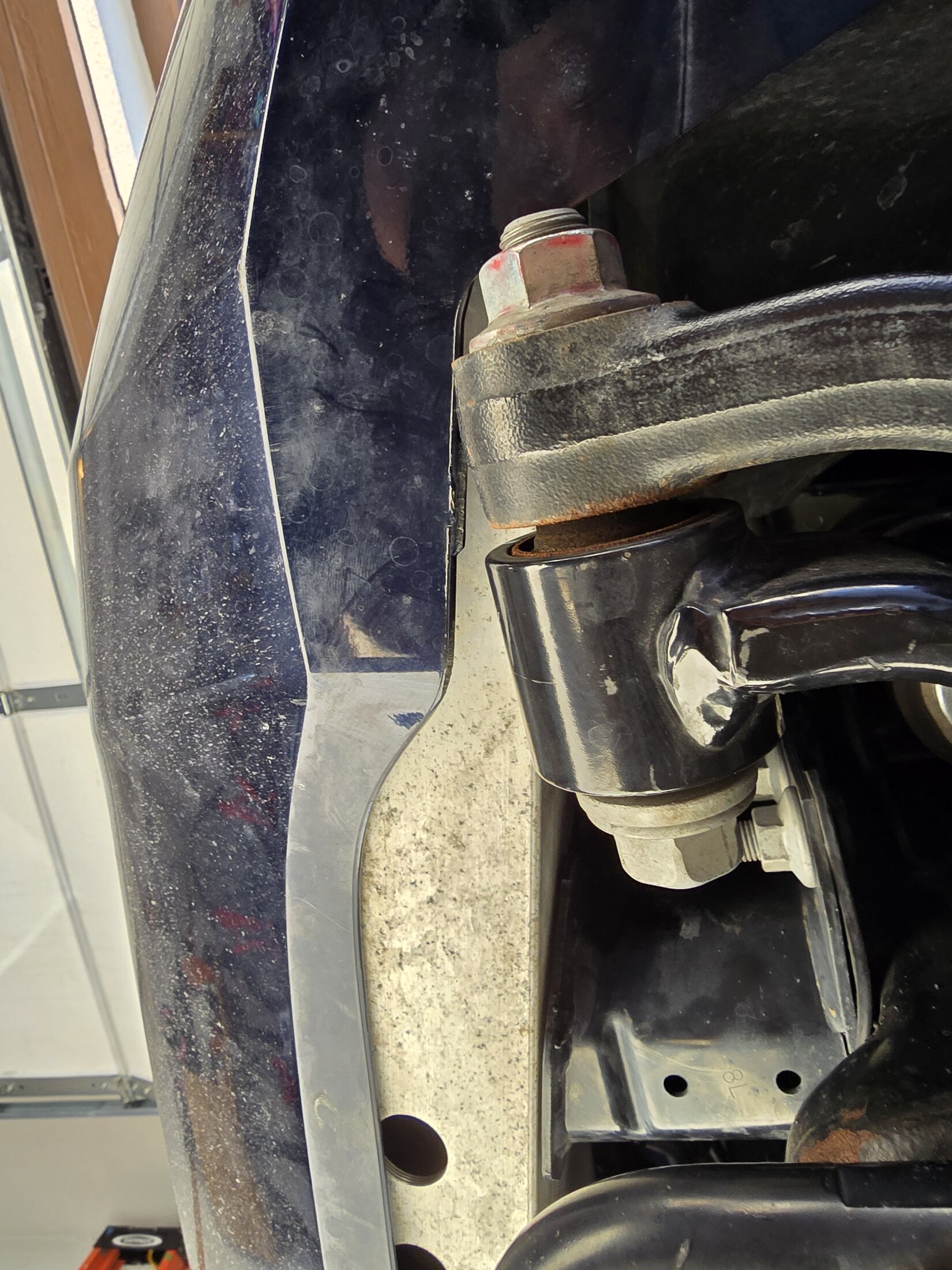

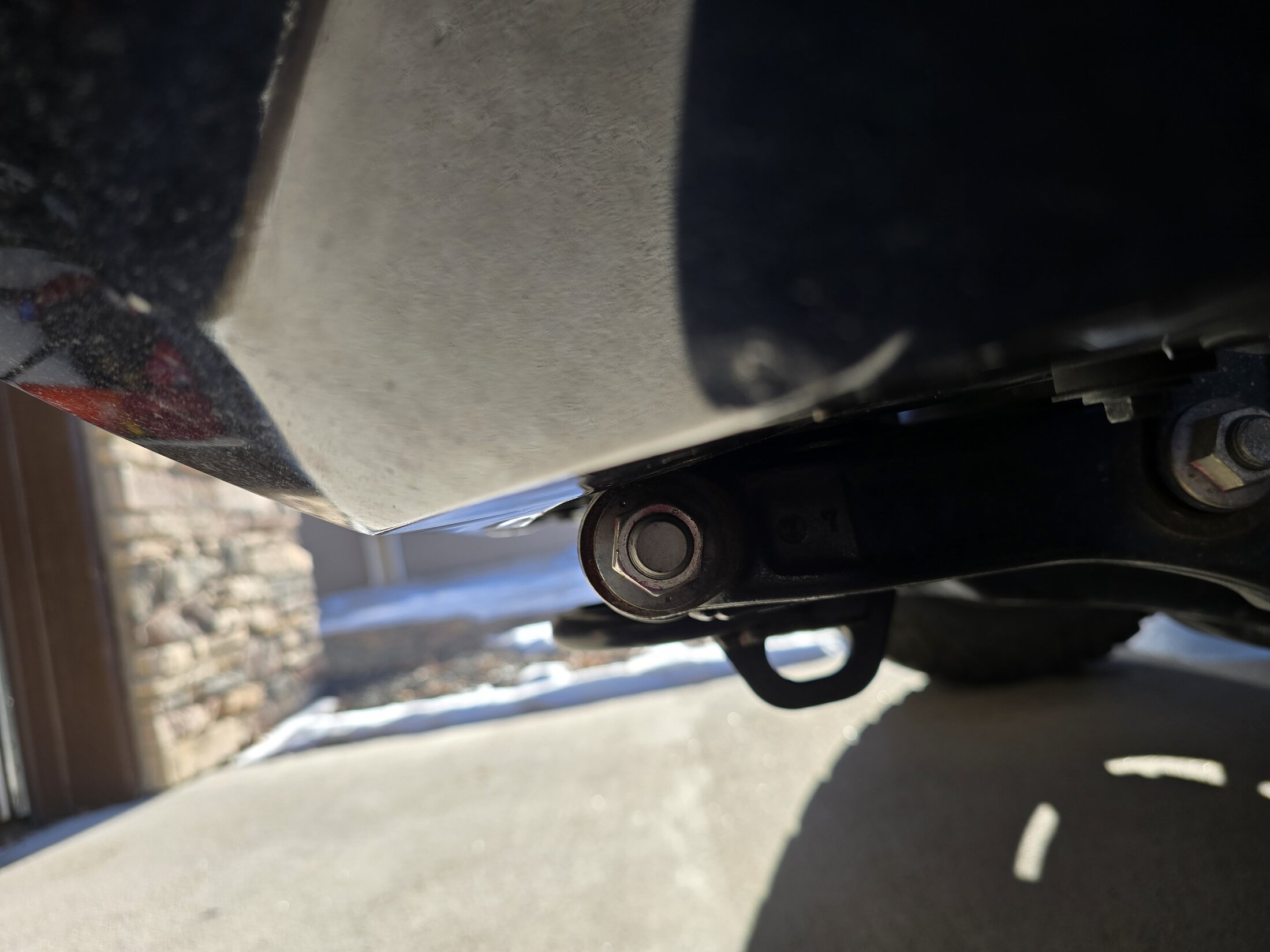

Question: how much does the KDSS move in regular operation? I'm running the stock bumper currently and the driver's side end of the KDSS bar is dangerously close to the bumper and crash bar. Do I need to worry about this?
do you have a picture?
I just went and snapped this of the area I think you are talking about. This is with a CBI bumper which attaches to the crash bar mounting mounts. It will move on the vertical plane but there should be no lateral movement..
It will move vertically for sure, and looks like it will hit given that is a totally stock bumper setup vs a high clearance aftermarket bumper (ARB, Dissent, Slee, etc).
Were you going to do a front bumper, or planning to cut?
shoot me an email & we can figure it out...
Same here. I was going to install this weekend but I’ll probably wait to see how this shakes out…
Will definitely check back in once I've made the necessary clearance mods. At a minimum it looks like I'm going to need to trim the bumper cover as well as take some material off the crash bar. Hopefully will have that done today.
Something to keep in mind: I have a 1" body lift installed and as part of that effort I had to shift the crash bar up 1" so that everything would go back together. Without that extra inch I would almost certainly be hitting the crash bar, and I'm not sure I would have been able to complete the install without clearancing. As it stands now I have about .25-.5" of vertical clearance on level terrain with all four wheels on the ground.
Preliminary recommendation would be anyone running the stock bumper to plan on making clearance mods. I would probably recommend removing your bumper shell and crash bar prior to installing the KDSS relocation kit, that way everything is already off the truck and you can make your clearance mods after getting the KDSS in its final location. Otherwise, I'm not sure you'll be able to get everything buttoned up.

Alrighty, so here's the deal: for stock applications (factory tupperware, and no other mods) I definitely recommend removing the bumper cover and crash bar before installing the relocation kit. This is due to the fact that it shifts the bar so far forward that it will interfere with the crash bar. Having the bumper and crash bar removed will allow you to fit the KDSS kit and then cut material from the crash bar to give the KDSS enough clearance. The bumper cover will also require some trimming.
Do I like that I had to mod the crash bar? No. Do I think it's likely still rigid enough to protect in a collision? Probably. There is a ton of bracing and structure to the crash bar, even with the material I removed. But it's one of those "proceed at your own risk" types of things. It's worth it to me to be able to retain the stock bumper for a while longer while I investigate aftermarket bumpers.
I will provide a full review of this kit once I have everything back together. In the meantime, here are a couple photos of the cuts I made.
Oh, and make sure to wear proper PPE and check the dates on your cut-off wheels! =D
Thanks for the follow up, It seems that I need to make a version that does not push it so far forward for a stock bumper truck. which would basically loose the extra 1/2" forward.
That was not originally envisioned since fitting bigger tires with a stock bumper becomes much, much harder in general vs a high clearance bumper.
I would say that modification to the crash bar is going to be needed for stock bumper trucks.
