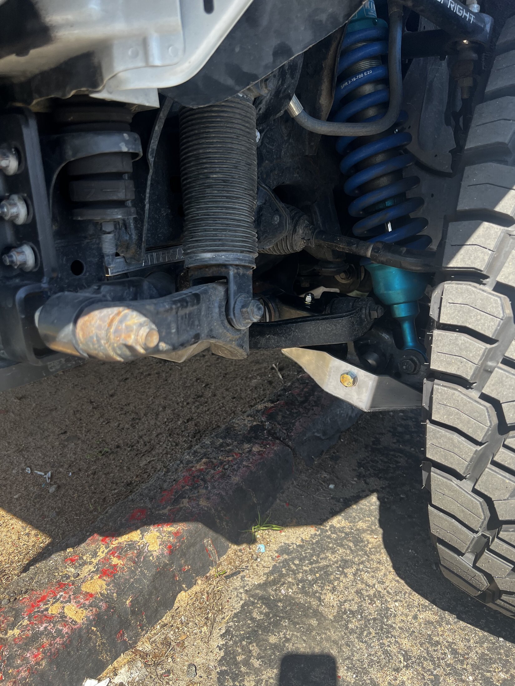

FYI... The large M14 (9/16th) hardened washer on the Sway bar endlink connection to the skid plate is missing in that picture. It Provides redundancy for end link retention. There are 2 in every kit.. I do not supply other washers with the kit that would fit, so not sure where that washer came from.

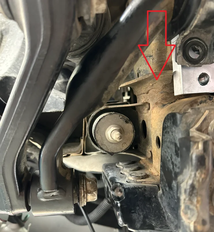

Hey folks. Right in the middle of the install and down to the last steps of trying to get the sway bar and links into position. Problem I'm having is getting the driver's side bracket lined up, and it would seem that it's because the top of the KDSS piston just doesn't want to move that way (forward). I saw someone suggest a ratchet strap but I couldn't even get the sway bar brackets lined up with that. Any suggestions?
Sammy, is everything loose I.e. the end links should just be on with a few threads, the skid plate basically the same as well as the LCA end link longer bolt. That normally gives you the room then you can get it in.
I usually start with the frame brackets, bolt those to the frame then a couple of threads for the sway bar to the Anderson bracket, the move backwards to the endlinks and skid plate.

Thanks for messaging so quick. Yep everything is loose. In fact, I went as far as to completely unhook the end links from the sway bar and still not able to get it right. I initially tried to do the sway bar brackets first (with the sway bar disconnected from the KDSS bar) but then I couldn't get the KDSS bar back on the sway bar. It seemed to me like the top mount of the KDSS ram just won't pivot forward like it needs to. Didn't want to put any more force into it until I checked if I was missing something.
Is this a stock bumper or a bull bar?
If you need I d be happy to swap out the max frame brackets for the standard one.
The difference is 1/2” but since the pivot moves in an arc it’s more at the pivot which could give you the clearance.

Its the ARB bumper.
Yeah maybe the standard ones are the ticket for me. I'm only making room for 34's. Let me know how you'd like me to work that with you. Thank you.
No worries, I can send them out to you Monday, just pm me the name they were ordered under.
You can just drop the max brackets in the mail back to me after you get everything installed.

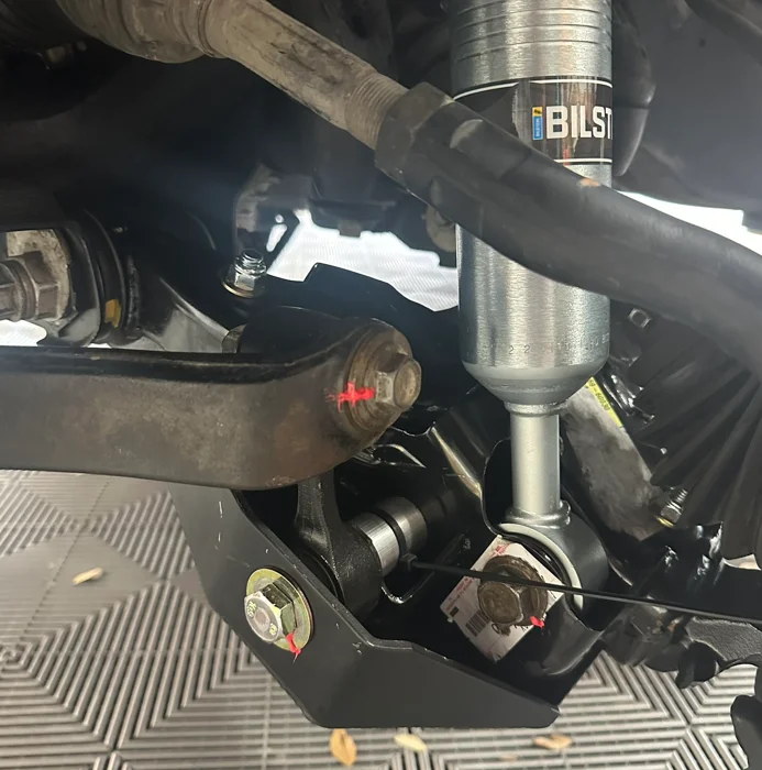

Thank you @rlynch356 for sending me those! Installation was then a breeze and it was exactly what I needed. I'll get the max brackets sent back to you this week. The only mod I had to make was to clearance the ARB mounting plate a little bit.
Also had the LCA skid plates black anodized. Really happy with how it all turned out.

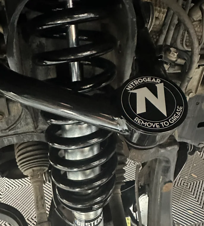

At the same time I put on new LCA's, UCA's, links, bushings and the bilstein coilovers. When I got my alignment today I had them push the caster up to around 3.7 and that gave me clearance from the fender in the back, and this gave me plenty of clearance to the KDSS. Running 34" tires. Angles of the end links look great too. Sweet kit.
