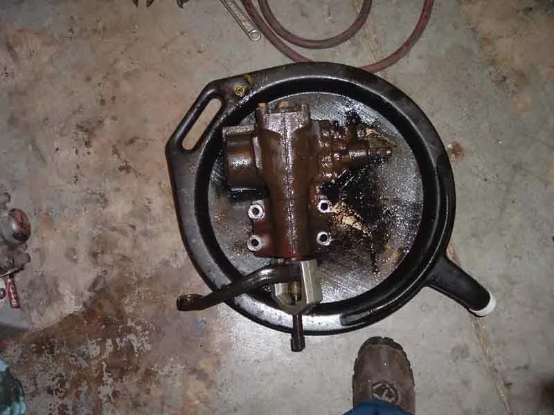

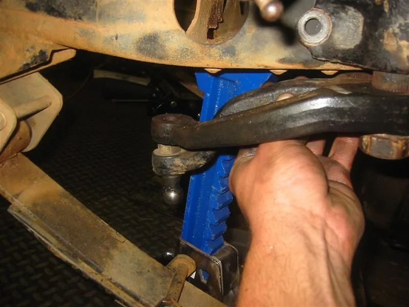

The pitman arm will keep me from stuffing too far. I've debated notching the frame for a flat pitman arm. Oh, that and trimming the fenders back.
If you get a near flat pitman arm, get an fj80 one, it will fit perfectly and they are beeeeefy. I mean twice the thickness of any 60 series....
I think Sky makes a zero drop arm, but that would req frame notch(see below).
However...
I've never seen an 80 arm before. That just may be the ticket! I'm going to try and find an 80 arm local to see if it works. Anyone want a brand new Marlin pitman arm?
Marlin arm (included in their hi-steer kit)
80 box/arm
attachment.php
60 and 80 arm comparison
attachment.php
Sky and stock

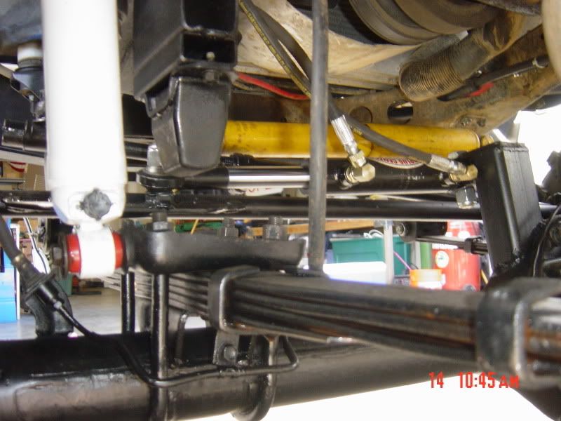

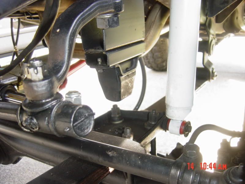

I did a shackle reversal. My modified front and rear hangers put the leaf springs much higher/closer to the frame than stock hangers. When the drivers side leaf spring is compressed into negative arch, it will hit the pitman arm/tie rod end. I can drop my bump stops to prevent this, or move the tie rod up via a pitman arm with less drop.
I am still experimenting with the final set up. I have not gotten the truck on a tall enough ramp to really flex it out. It remains to be seen how far the 37 will tuck into the wheel well. The tire may bottom out on the inner fender before the spring touches the tie rod end. I'm just considering every option to maximize up/down travel of the suspension.
A 2wd toyota truck with power steering has a fairly flat pitman arm as well.....
