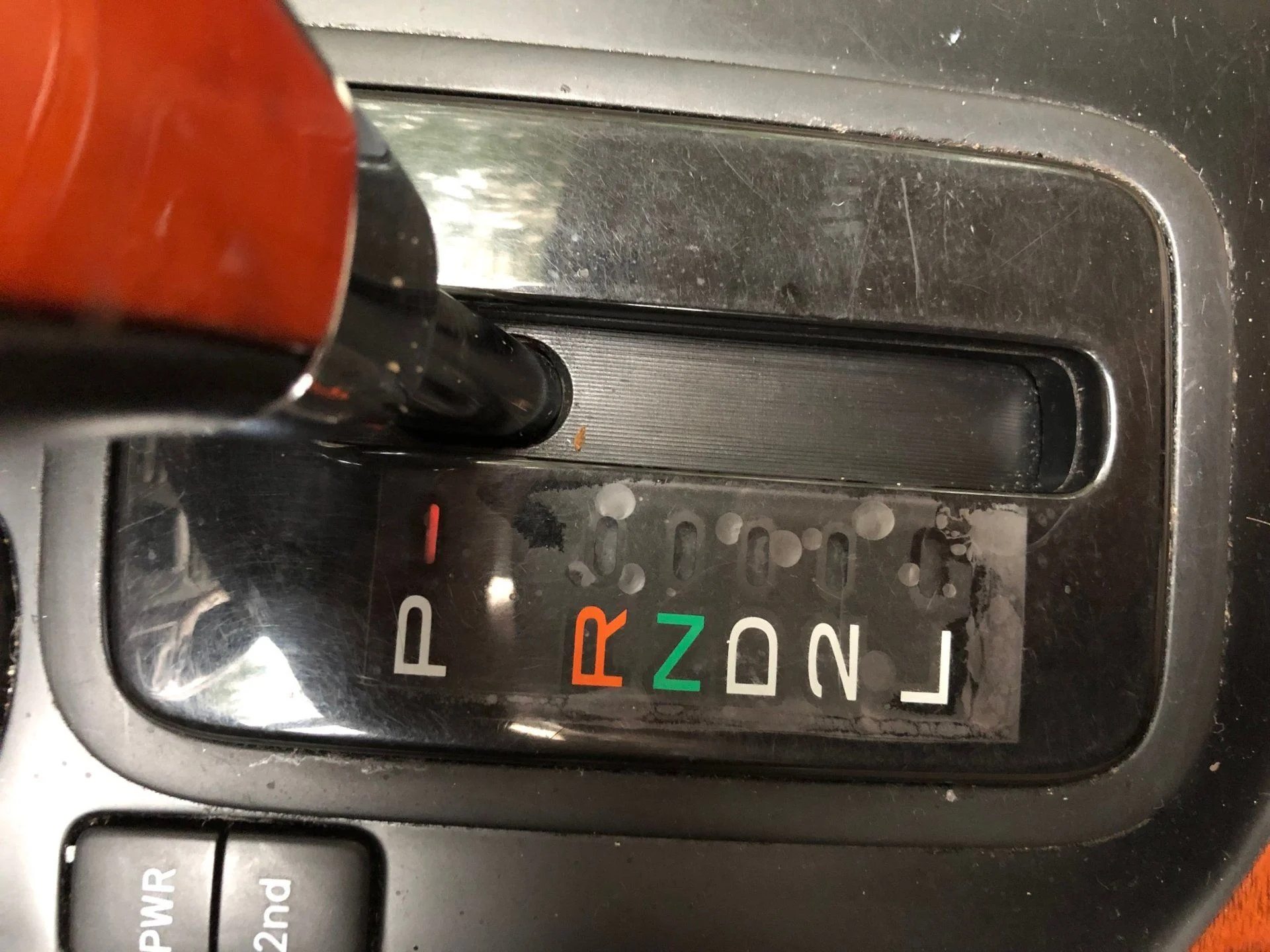

Is this piece PRND2L replaceable? For some reason those bubbled drive me crazy :)

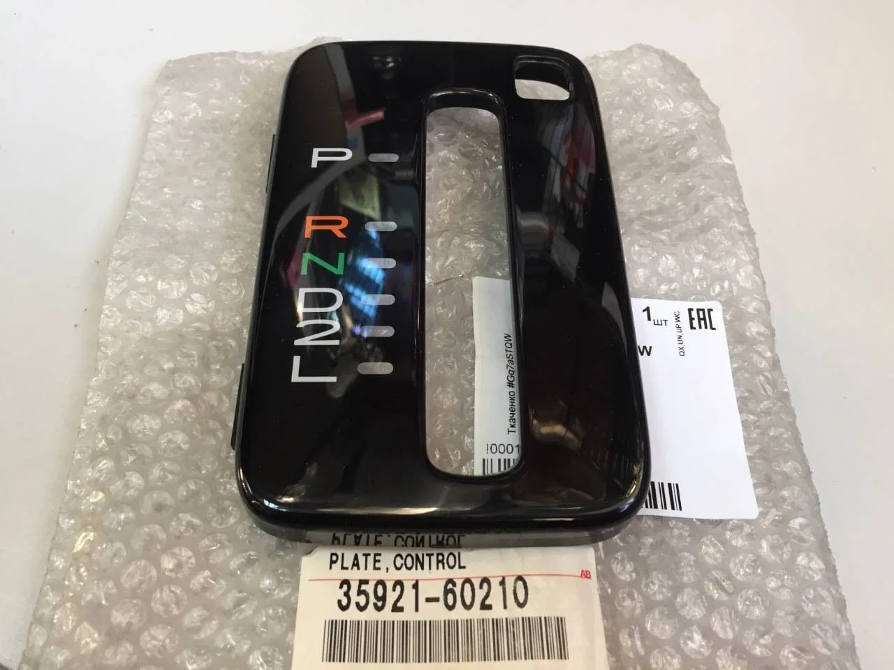

Take a look at these two assemblies on partsouq: center console and shift lever. Double check my work, but it looks like you would want to get:
58843-60010 - BEZEL, SHIFTING HOLE - $5.06
35975-60100 - COVER, SLIDE (FOR POSITION INDICATOR) - $4.39
35921-60210 - PLATE, CONTROL POSITION INDICATOR - $66.36
Edit: on further googling, the relevant part is definitely that control position indicator, but you should maybe try disassembling yours and pressing the bubbles out
Thank you! I doubt pressing it will do much. Currently it's one of the pieces that sticking out in interior. To get interior to my liking I need:

5. This control surround
Ordered #5, also found #1 in forums, here is summary of order. Not sure where is my $0.90 after I paid almost $70 for piece of cloth...
