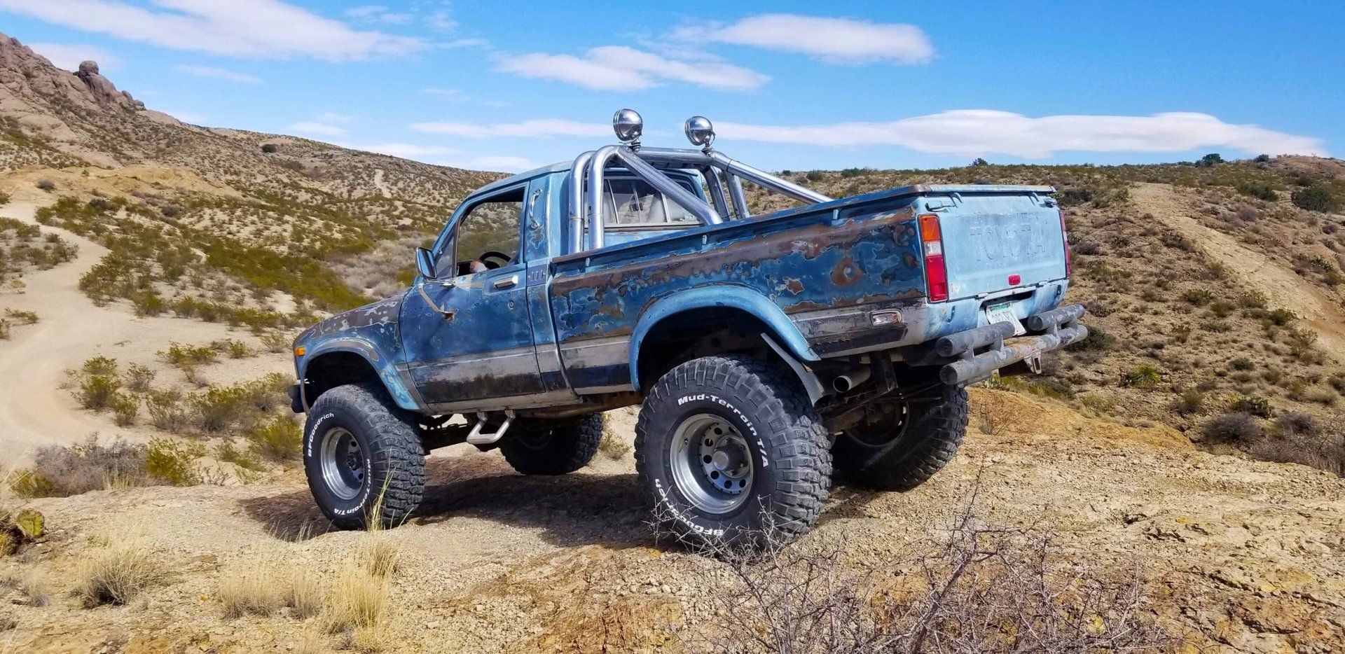

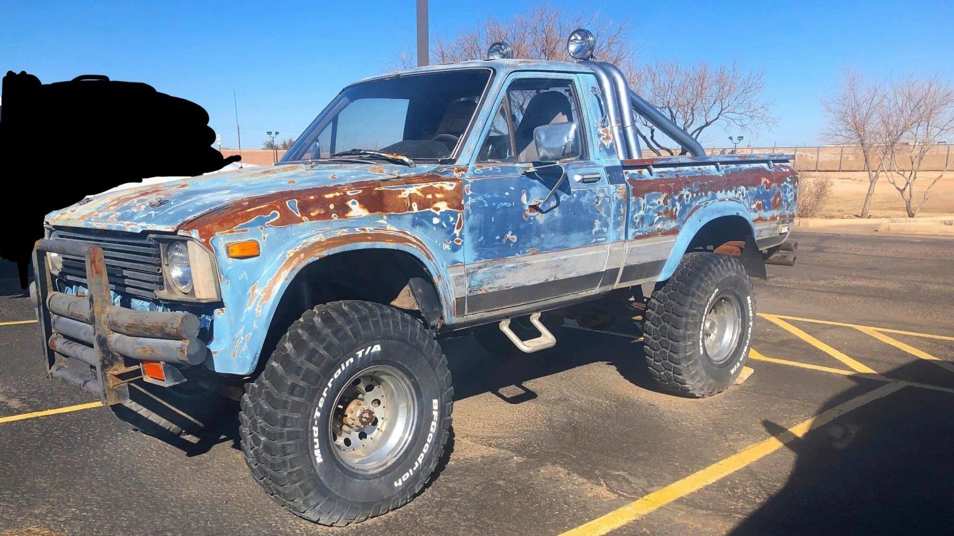

I just picked up this 1979 pickup. I’ve been wanting one for awhile and this deal just fell into my lap. The previous owner got it as a payment for some work he had done. He told me he had no use for it and it was sitting there for over 5 years. It has an older GM 3.8l 231 with a turbo 350 transmission. Not sure what lift it has but it’s sitting on 35’s.
1911543

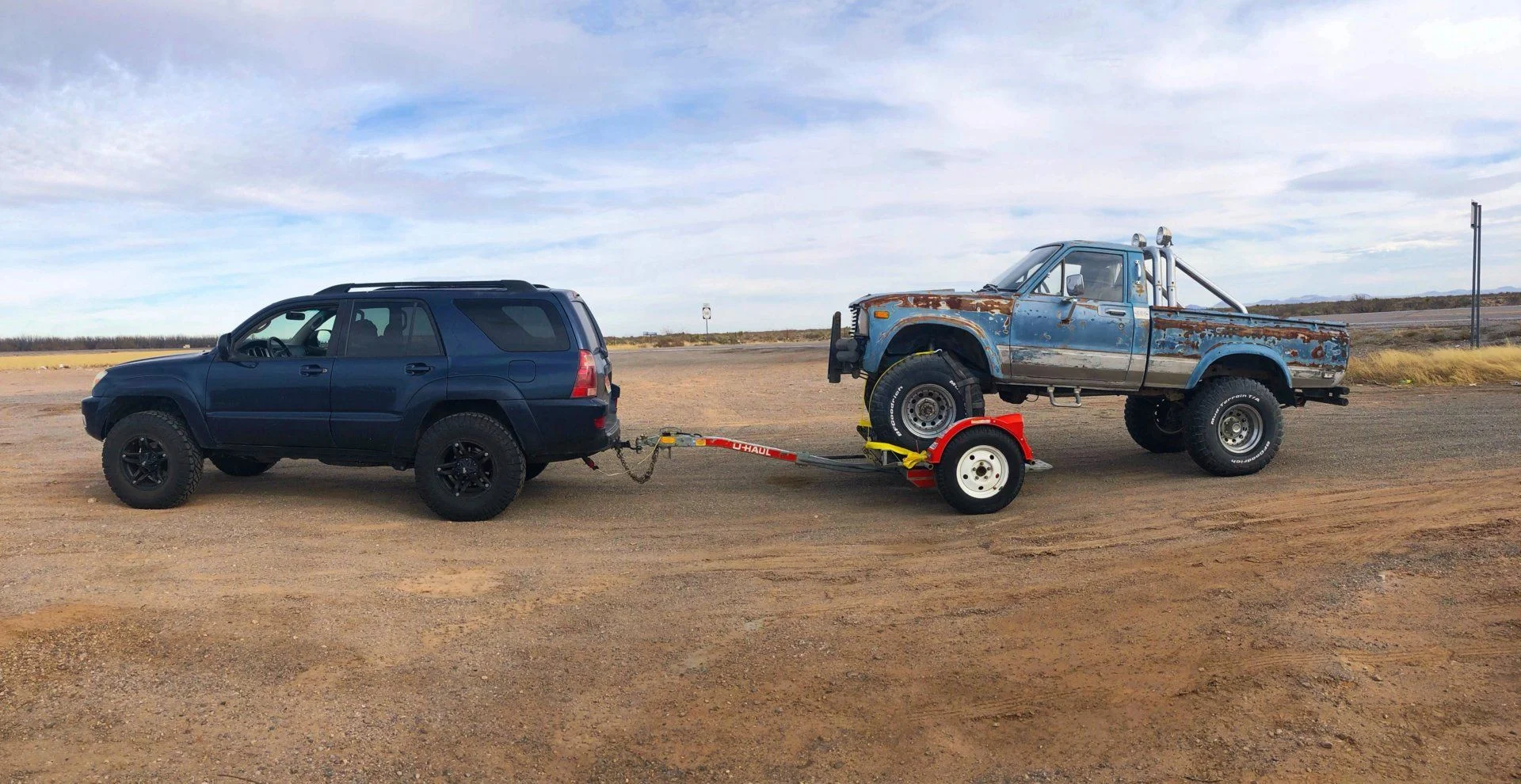

Not taking any chances I towed it home so I could inspect it.

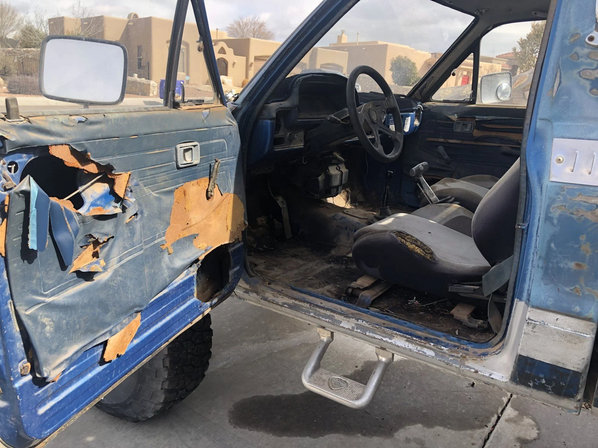

It ran good and it amazed me. The only problem it has is that it starts to cut out when going down steep grades. I’ll pull apart the carb and check the floats. The inside definitely needs some attention so I’ll start fixing that part up.
1911550
I’m thinking of stripping it down and raptor lining it and just putting some good floor mats. I need to redo the door panels and dash.
Well I hope you guys enjoy and I will keep you posted as I go. I’d appreciate any insight and opinions on what to do. Thank you.

So you wouldn’t line the interior? On the outside I’m still up in the air on what I want to do. I’m definitely going to take off the tube bumpers and that step. I’ll probably put on some sliders to make it easier to get in and out
I would liner the floors maybe, and the inside of the bed, but I wouldn’t do the exterior. I know it won’t be easy to find interior parts like door cards etc, but you should be able to make some reasonable ones. I just think those trucks are classics now, and even though yours is a bit “rustic”, it at least has the potential to be kept fairly original looking on the outside.
If it were mine, I’d get it running right and do the best I could with the interior. You might be able to get carpet from Stock Interiors, but I’m not sure if they will have kits for that vintage. If they do, their stuff is way cheaper than you’d think.
Carpet and dash caps are available on eBay.
Door cards are not!

Stock Interiors does not have carpet. (They do have it for 84 and up). Door cards are a simple 1/4” mdf and some vinyl project. A little contact cement and a couple of hours and you’re looking good!

The passenger door card has a decent shape to it. I can pull it and trace from it. I already have some lightweight board from a project I was doing months ago. It is some dry erase board I had picked up from Home Depot. Very similar material to the stock, but better sealed and made. I was already scoping out some vinyl and some padding at hobby lobby the other day. I have limited time to work on it because my hours for my job. So basically I’ll work on it 1 day a week.

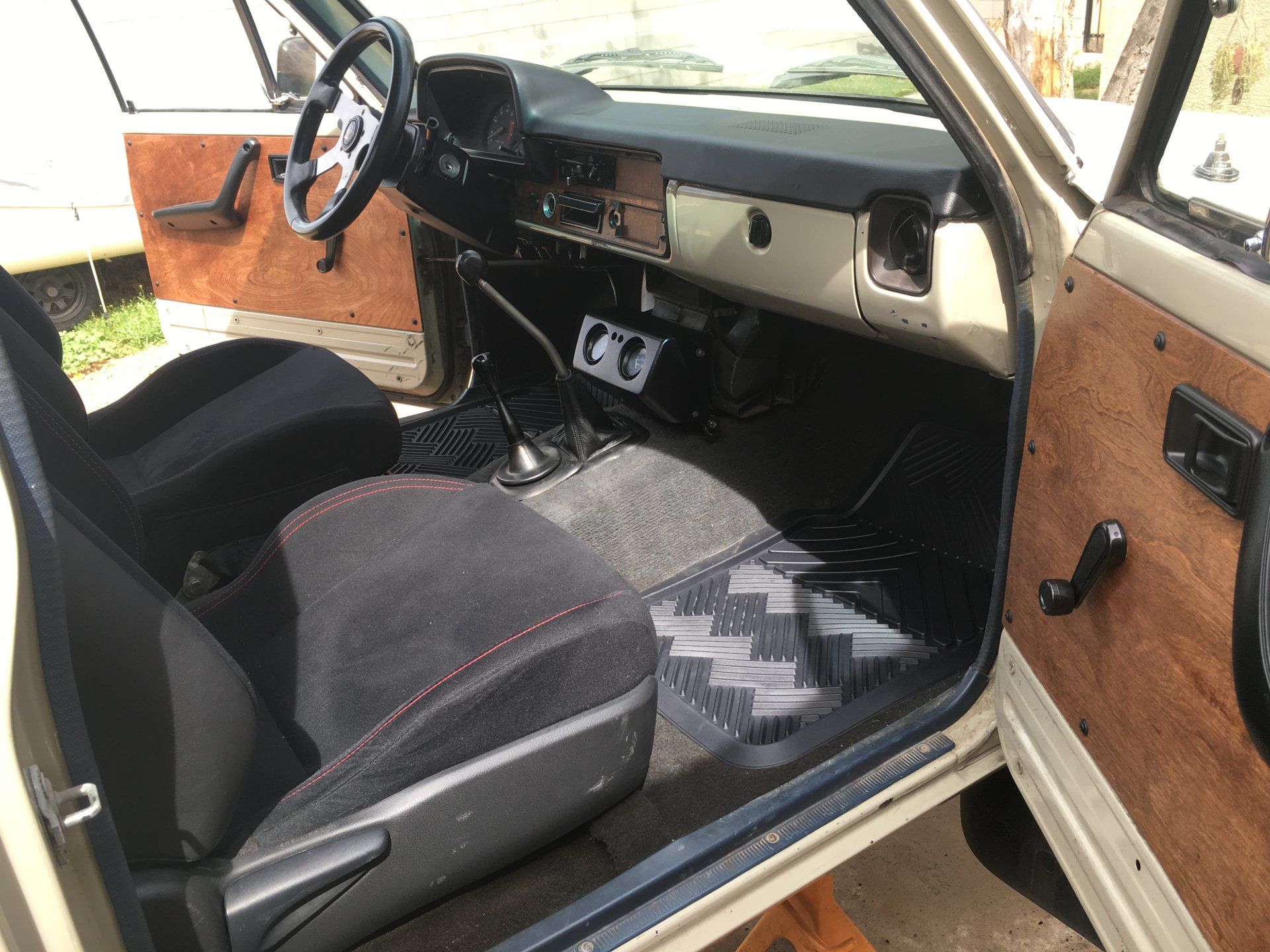

I made wooden door panels for mine.
1911815

I made wooden door panels for mine. View attachment 1911815

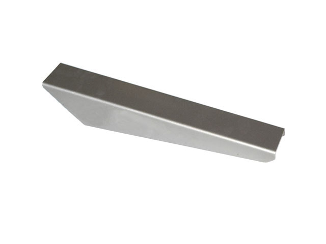

Marlin has a weld on gusset kit for the front end. As for power, carry a couple of spare U-joints, they take a real beating. Drive shaft bolts are the small kind, carry a couple of spares.

Thanks for the info, I’ll have to modify my steering at it sits in the way to put on that gusset. Any suggestions on that?

A common modification to do is to replace the push-pull steering box with one from an IFS truck (86-95). A quick google search should help you get started on that and some fab skills are required. A hi-steer kit would also be a worthy investment if one isn’t already installed.

Good call on the marlin gusset ferg! 79-80 front axles are missing the gusset on the bottom, 81-83 have the half gusset on the bottom and 84-85 have a full gusset. Those are the ones to get!
