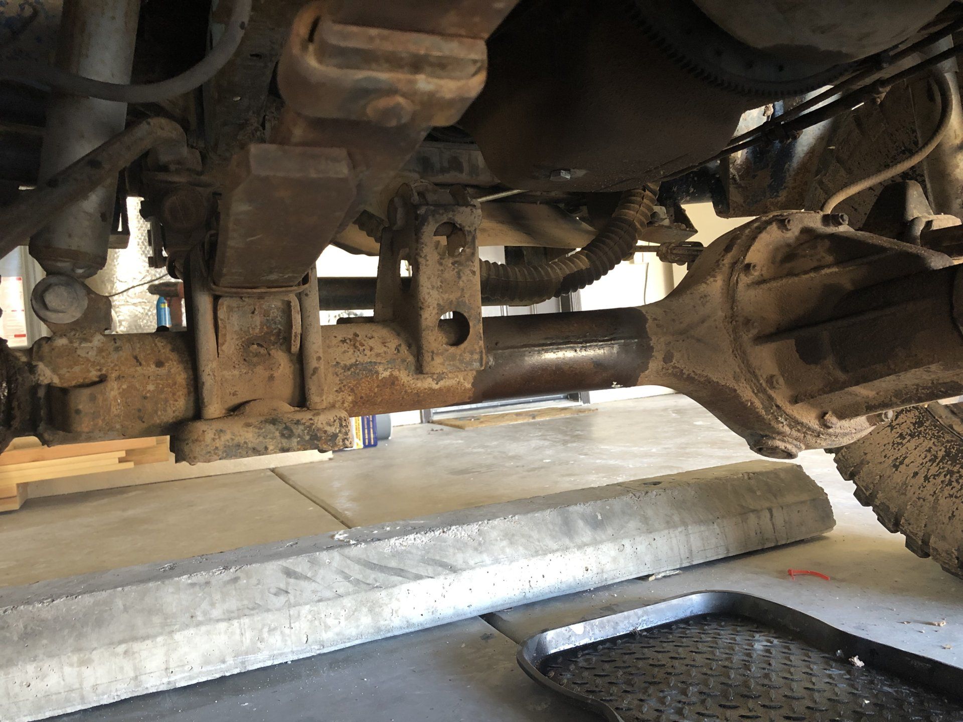

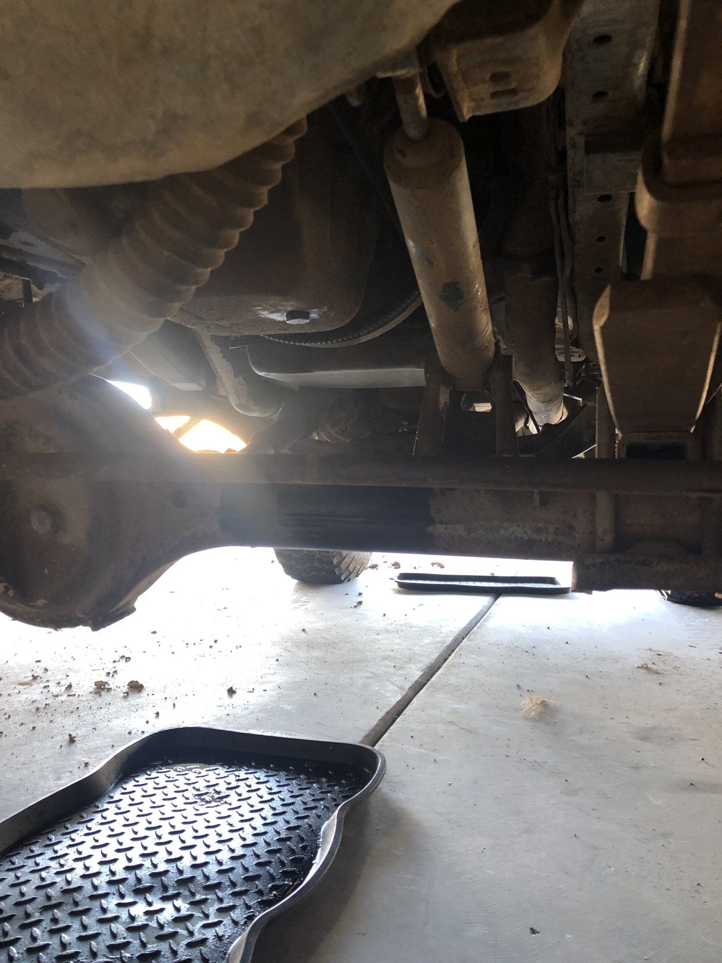

As for your steering interfering with the gusset, show me how with pics. Gusset from Marlin goes on the top of the housing and there should be no problems. Only issue I can think of would be the torque rod tower. You're going to ditch that anyways. '79 was the only year w/out the factory gusset. Started the factory reinforcement in very early 80 trucks. My 80 come with it.

Here is a front

And back picture of what the long side looks like.

Remove that shock and the mounts on both ends. The shock mounted there is useless. Clean up the engine compartment frame by removing the upper mount and the axle by removing that mount as well. And do something about that lower radiator hose before nature fixes it for you.
If those are trans cooler lines on the right side of the trans, get those secured soon too.

Here is a frontView attachment 1912627
Yeah you just cut that mount right off and weld the gusset over where it used to be. I agree with ferg it is useless.

Cool I’m going to chop it off and weld that brace on. Nice Crawler, what did you do with it? That picture looks a lot like where I’m originally from, but then again it could be anywhere in the SW high desert. I want to make this a decently capable ride, nothing too extreme. I have this 84 4Runner who does all the dirty work when I play hard
