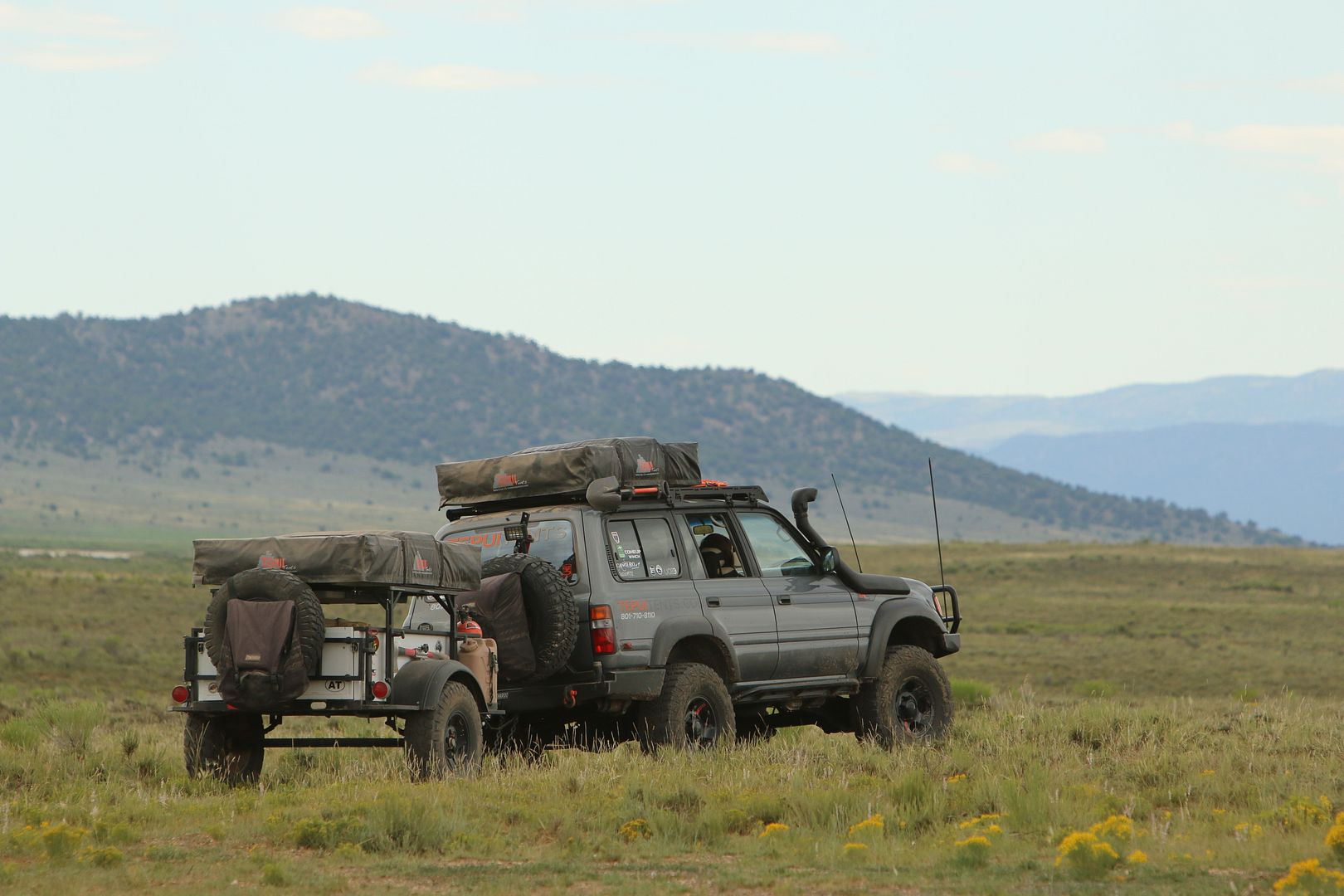

Just built my Prinsu Designs Rack
I went with electric drill to do the work, hand tighten all the screws would of taken forever and chapo tunnel.

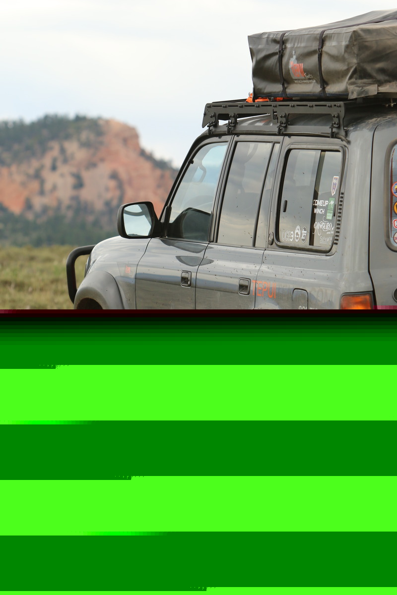

Wow.. stout looking rack... Rail that runs the length of the Rain gutter.. awesome. How is the fit?
How tall is the front edge and the rear edge?

You do have to remove the factory rack but the ribs can remain. The cross bars are 1" tall and sit about 1/2" above the ribs and the side rails extend 1/4" above the cross bars so overall the rack is 1-3/4" taller than the ribs which were the tallest point after removing the factory rack.
@Dissent Very good write up.. thanks for sharing. What is the height from rain gutter to top side of Rack? Thanks again
Thank you. At the front and rear, where the gutter slopes downward, it's 6" tall measured from the top of the gutter moulding. In the middle, above the rear door, it's 5-5/8" from the top of the moulding to the top of the side rail.
