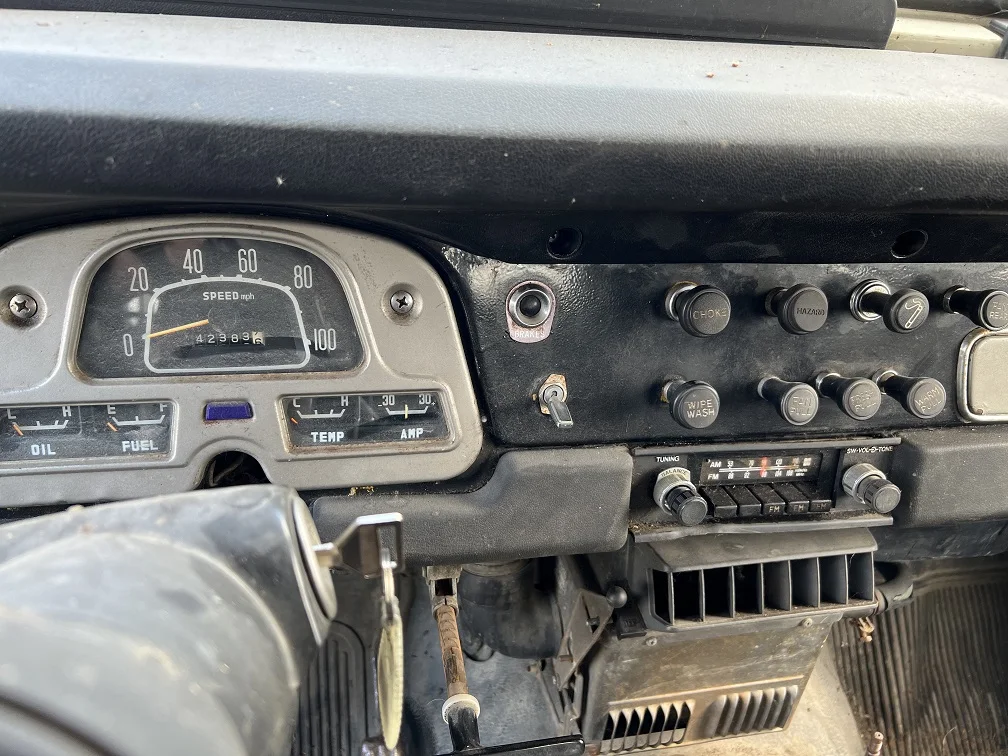

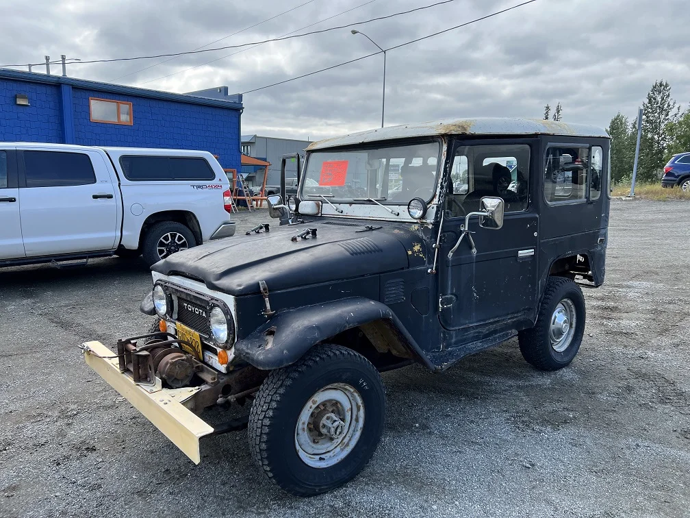

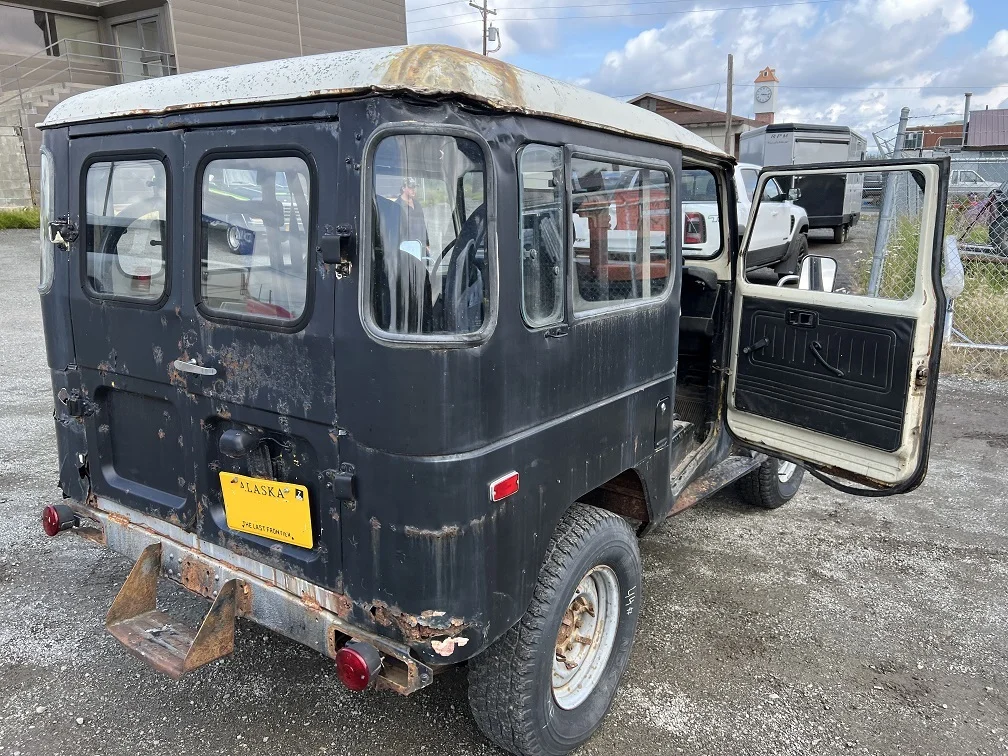

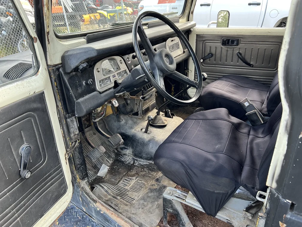

(edited 1/18) Recent barn find. It started easily, idled, accelerated, turned, stopped… appeared to be in great shape, but was told it was parked far more often than driven for at least 10 years. What’s not original: front bezel is from late 60's, hardtop is off a more recent model, bumper is angle iron, and the tail lights are not the correct year. Fair amount of rust in the usual places but the frame is solid. Seats are original and in good/decent condition, door panels are in really good shape and still has the factory floor liner front and rear so I think the odo is correct at 42,000 miles.

the hardtop is off a later year...75s dont have the vents.
