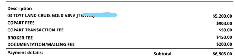

3 price, at those time, used car price are insane.
there are so many fees add on the auction price.
for example, I bid this LC for $5200, but at last I paid $6500

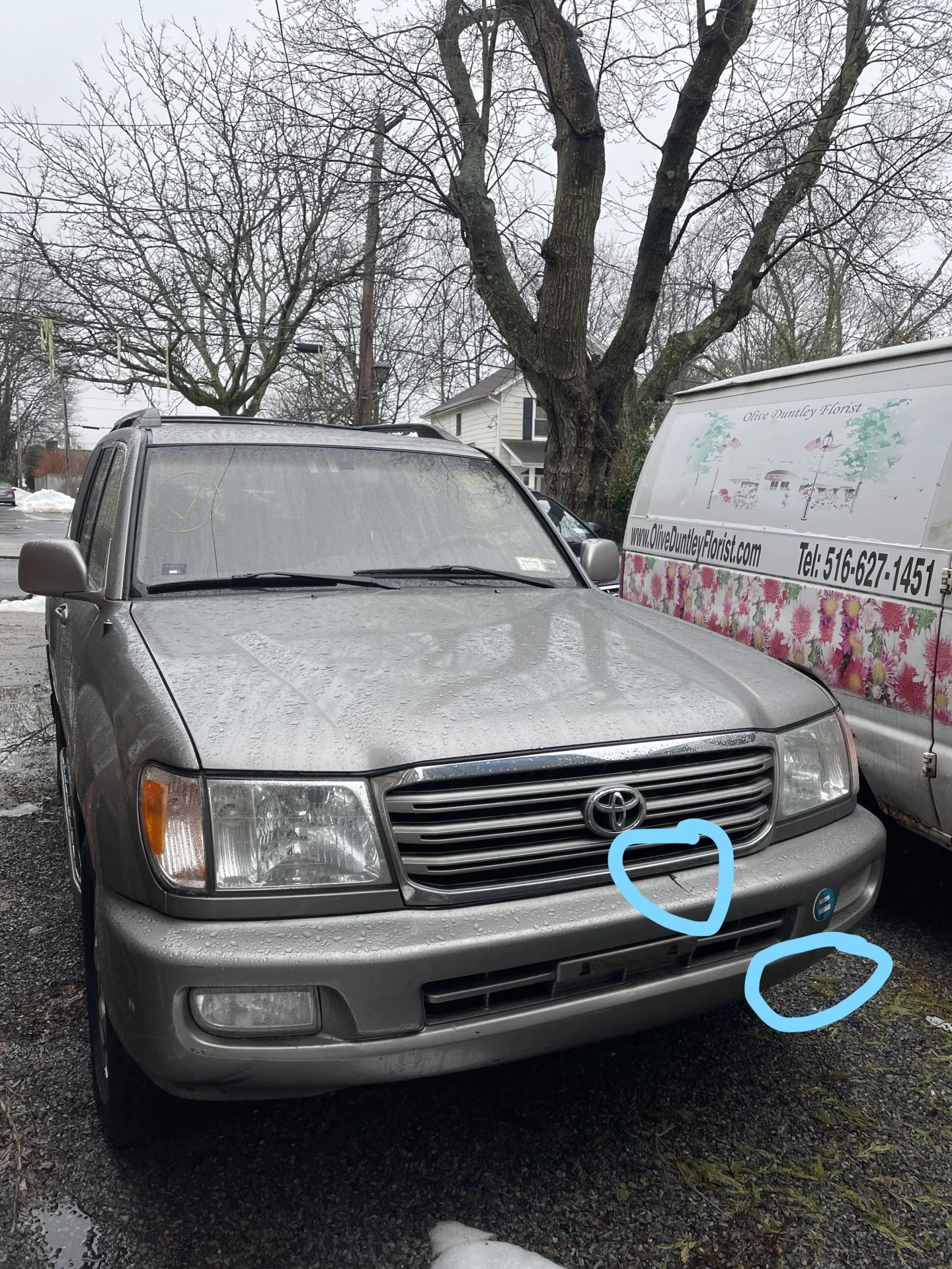

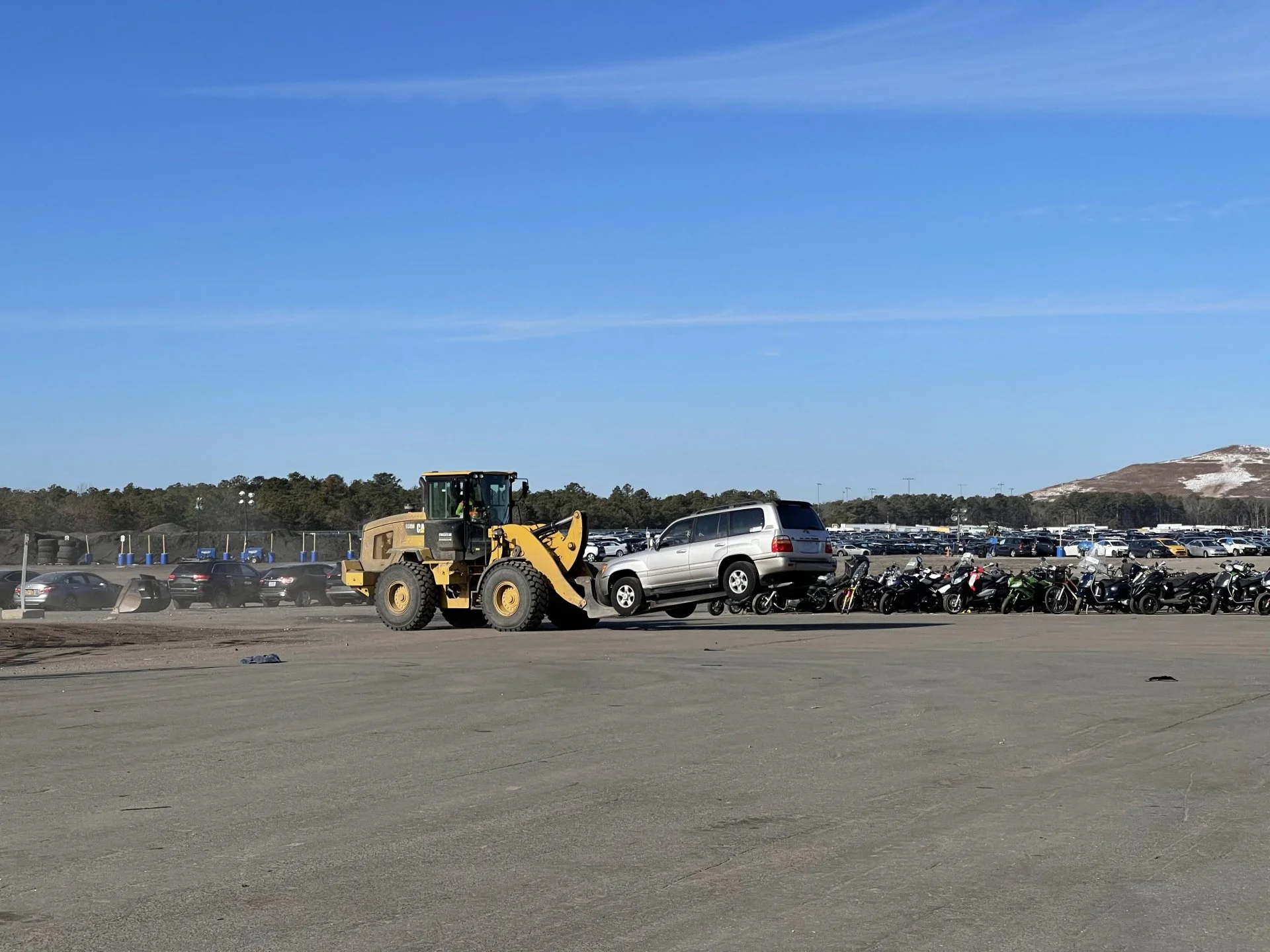

besides, they use fork car to move the car, if there are 5 people preview the car, which was moved 5 times, and it very easy to damage the bumper and frame, my bumper was damaged.

Any reason why they decided to just like scoop it up with a giant machine. Hope they didn't bang anything up on the underside. Otherwise, good looking rig hope to see more soon.

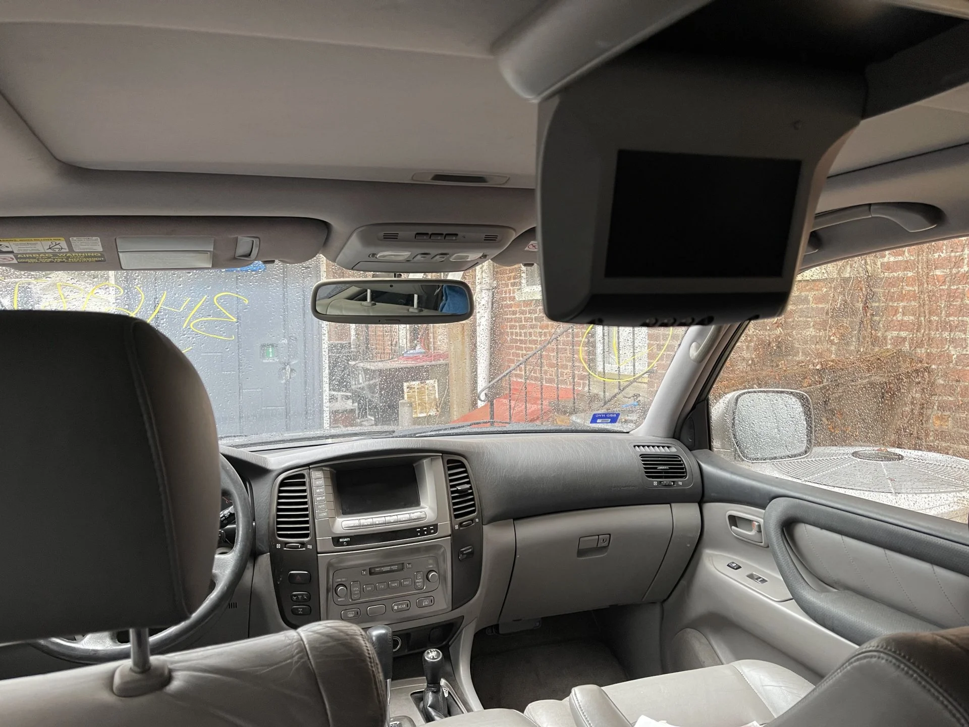

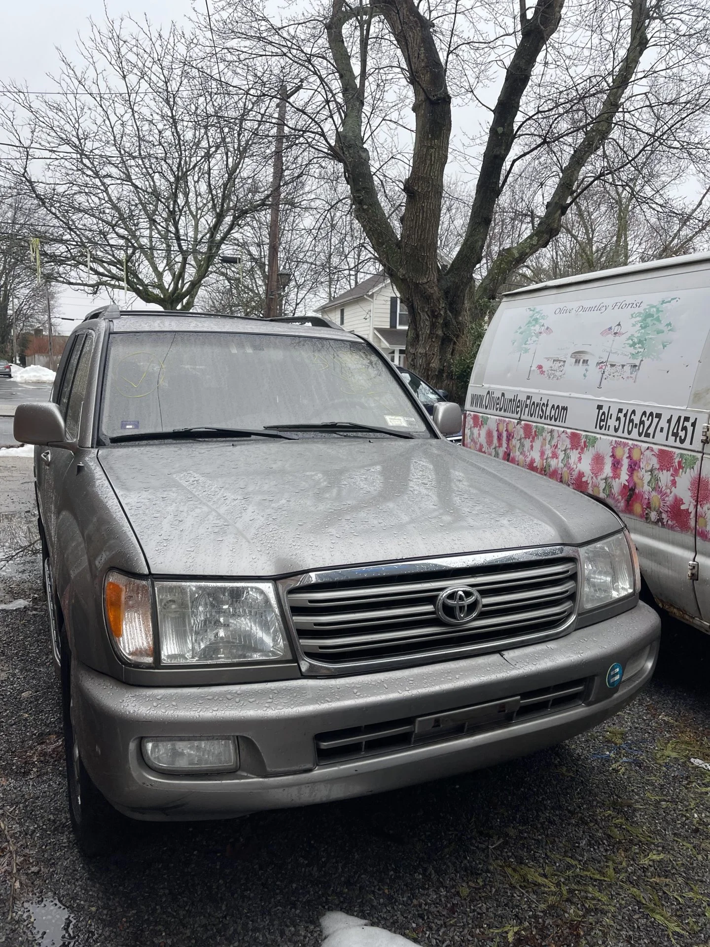

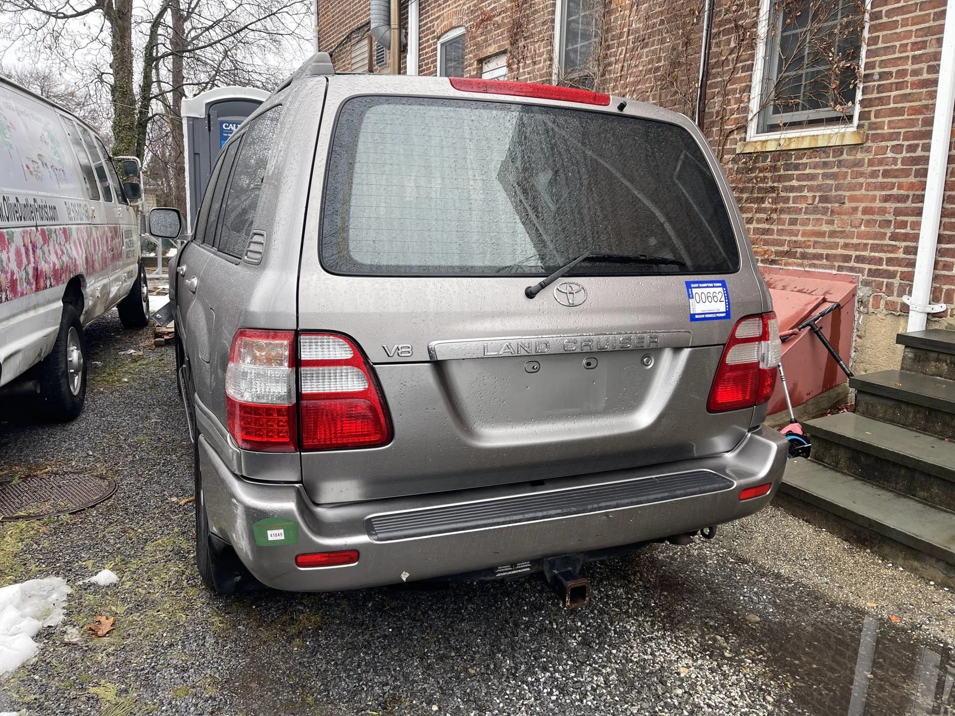

$6500 for an '03 is dirt cheap. How many miles on it? Bodywork and interior looks clean. The outer tail lights are aftermarket and not for an '03 (looks like '98-'02 LX). They should match the inner tail light like below. Post some pics of the undercarriage.
If it's a decent moderate levels of rust underneath, that's a pretty good deal in my books.
yes, always been wondering about the fork lift bit. In a junkyard, sure, but for cars that are planned to be used? There is a lot of stuff dangling down there that can be crushed or bent....
The giant forklift is how IAA brought me my practically new Jeep Rubicon that had two rods through the oil pan back in 2003. This one was a "flood" car. I don't recall paying many fees, but I did use a friends dealership account to place and win the bid. I still have this Jeep and could probably sell it today for more than I paid for it in 2003.

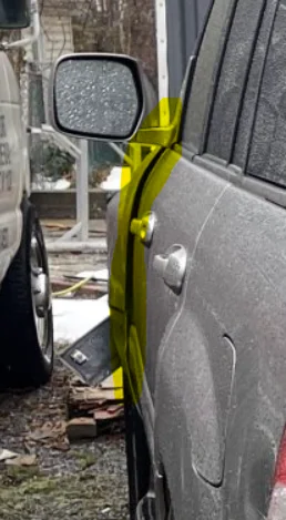

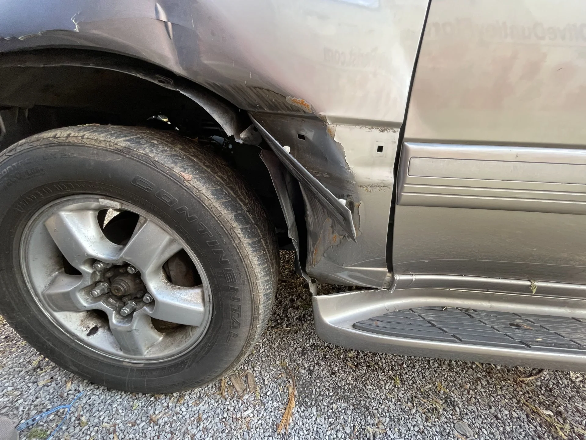

Also, am I just seeing things or is the fender not lined up right?
All these insurance auto auctions use forklifts to move the cars around. I used to transport cars and picked up from the auctions all the time, it's sad to see them obviously damage the car as they load/unload them from the forks.

I would be seriously bummed if I inspected a car, won it, and it got damaged later on on loading...

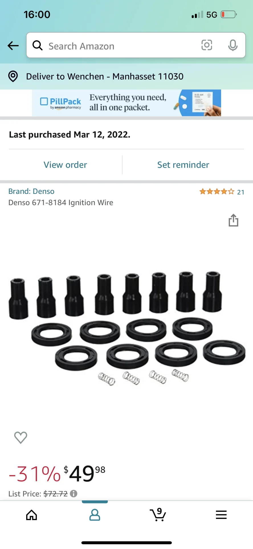

Update 1 Problem found
the fender was damaged, like @shtbrwn86 mentioned, that is why it was totalled.

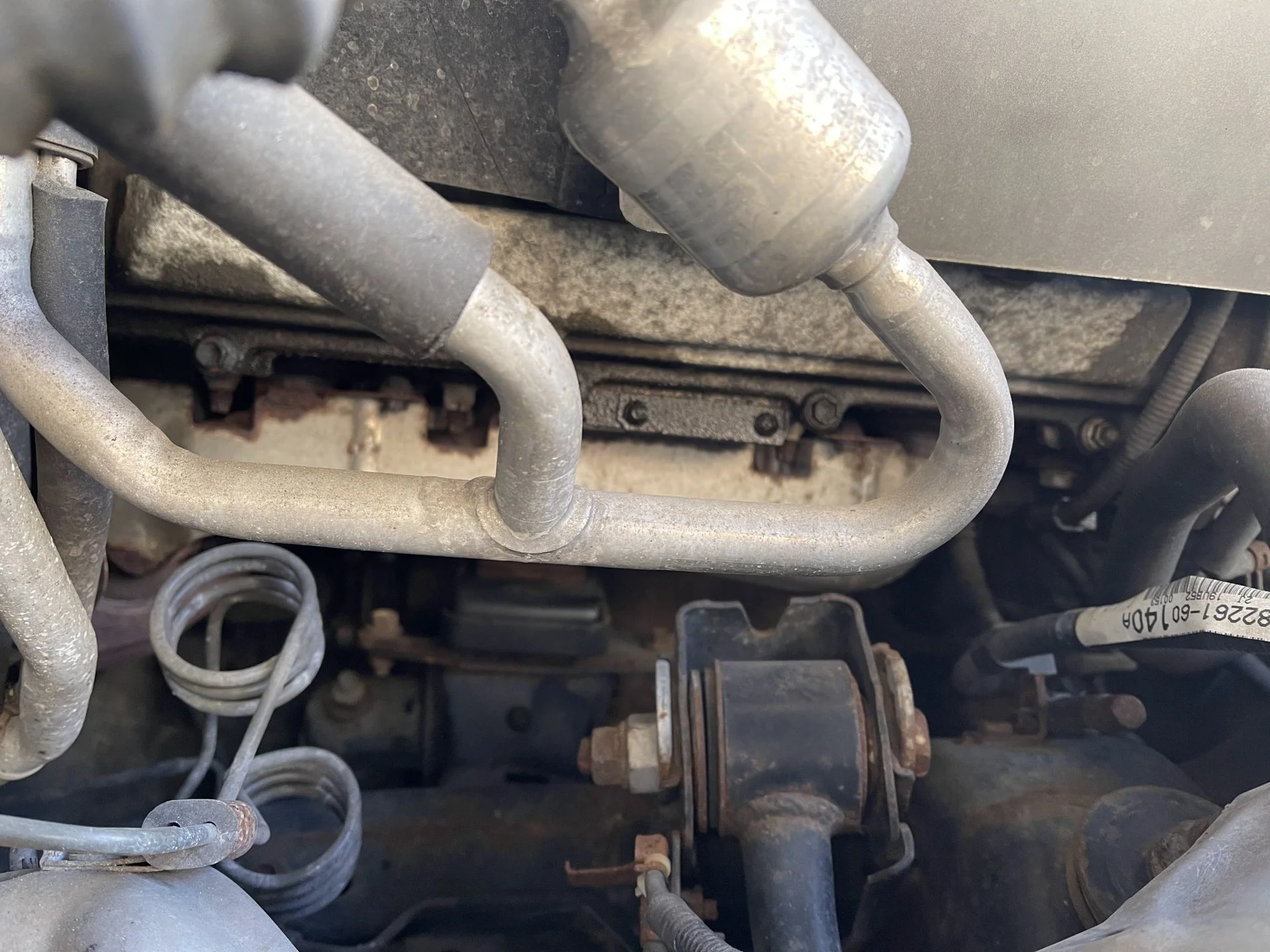

second
the valve head gasket is leaking

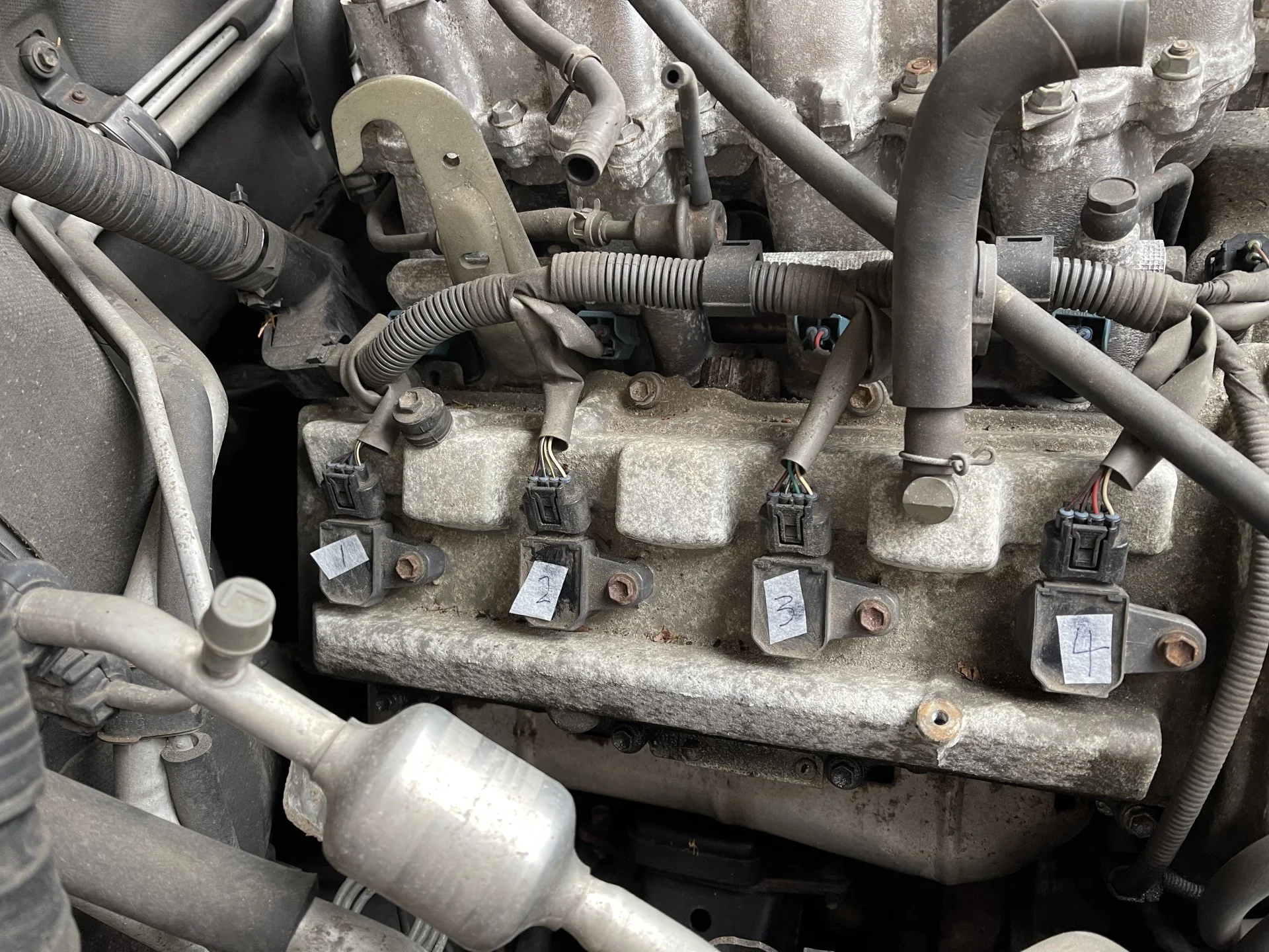

third
one of the ignition coil seal was lost, the toyota dealer replaced the spark in 2019, it must have been lost by them
Where can I find the part, mcgeorge or partsouq only have the whole igniton coil.
and of course , copart fork lift damaged the from bumper.

was it totaled? salvage title?
fender and inner fender don't seem like enough damage to warrant it being totaled
any other damage?

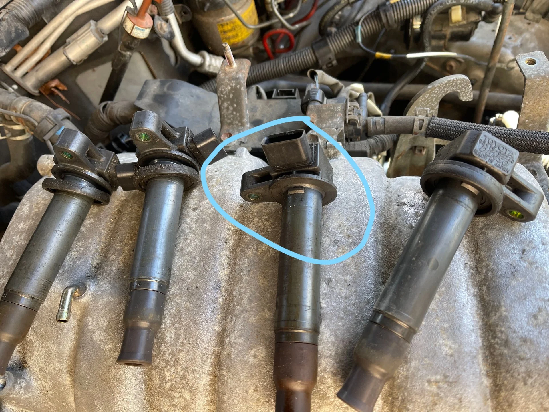

third
You can buy a Denso boot kit from Rockauto for $30. It has all the rubber parts for all 8 coils.

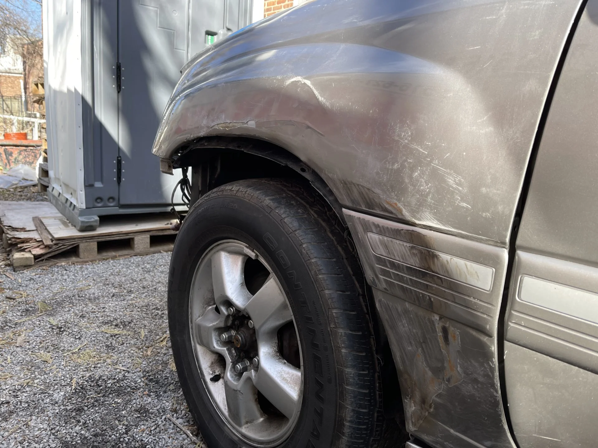

Update 2
Valve cover gasket replacement and fender repair.
I am trying to fix the fender instead of replace it.
Thanks @Bisho , I bought one from Amazon
