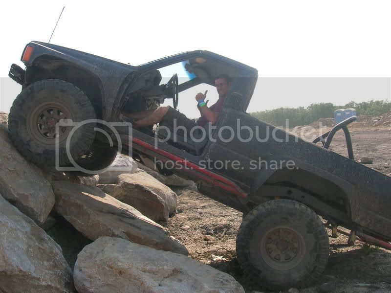

Well we had the NE TTORA Takeover event at Rausch this past weekend, had a blast. We ran Camel Back, the first portion of Snake Bite, one of the guys wanted to back out due to his clutch :( and Yellow Jacket, along with others that I didn't catch the name of, but mainly a bunch of Blue-blacks and blacks. It was amazing how much I really flogged this truck this weekend, several full throttle assults at some ledges, sometimes the front end would actually bounce about 2 feet in the air. yellow Jacket was by far my favorite, never been over on that side of the park. We did the black line and had a blast, gave a little show for some Jeepers that were there watching. I didn't walk it, but had a blast beating the truck into the rocks. If I had at least some articulation, it may have went better, but with stock IFS travel up front and the rear bump stopped out to minimal uptravel, it was more technical.

Before we left, I swapped out the intake manifold on the engine. I have Seans old engine and it would surge alittel and seemed under powered, Sean thought so as well. So I put the original intake on from the Runner and now it doesn't surge and has way more power, as much as the little I-4 can do I guess, and it idles a bit lower now too, which helps with going slower. It is almost like a totally different engine now, very nice, even got to use 5th gear for the first time on the highway with it.
