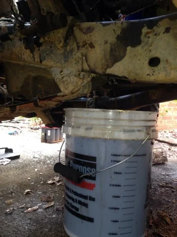

We were trying to get john vee's 40 running today. It needed and oil change but we did not have enough oil to match what came out. Just about 6 gal of gas from the oil plug.
The good thing is that inside the engine is very clean. The bad thing is that the inside the engine is very clean.
So here's the thing - carb was leaking from baseplate gaskets in December. Ran fine until then. It sat with about 2-3 gallons of gas until 3 weeks ago when the rebuilt carb went on. Still leaked and I never even idled it for over 5 seconds. Left it alone and bought parts.
Jump to this past weekend. Pulled carb and repaired. Got it running leak free Saturday afternoon. Idled fine for less than a minute. Didnt get to the point of adjusting floats. Ran out of gas. Put approx 2-2.5g of gas in. Dead battery. Charged overnight while removed from vehicle. Tried again Sunday morning. Hydro locked. Pulled spark plugs and drained fuel from 4 cylinders. Removed fuel feed line from carb. Unhooked battery and left it alone. Meant to change oil and forgot.
Jump to today. Fresh battery. Pulled plugs and drained fuel. Cranked engine with electric unhooked and cleared more fuel. Reinstalled electric. Wouldn't start. Rewired fuel pump to on off switch and filled carb. Adjusted floats. Wouldn't start. Battery weak so jumped it. Starts. Giant cloud of white smoke. RPM at 1k to idle. Some Venezuelan guy pulls PCV valve and dodges a spray of rather flammable liquid. Shut off engine. Remembered to drain oil. Luckily, my drain pan is missing so I use a large bucket with a 24+ quart capacity. Lucky because over 6 gallons of fluid came out. That means about 4.5 gallons of gas.
Not sure when, where and how that amount of fuel got there. The numbers are admittedly estimates, except for what's clearly in the bucket now.
Now that I've typed all that on my phone I think I'm seeing it, IF my pump is bad.
The plan is to keep the drain open overnight and then fill with oil tomorrow. Get it running and warm it for a while and drive. Change oil again. Hope for the best. Might as well replace the pump and finally wire in a relay. And hope that I don't explode.
So. You do have a pump on side of block then ? If do it is bad from the sounds of it or if you have an electric pump it is pumping all the time even when off. It is pouring it thru the carb. It is easy to figure out either way.
