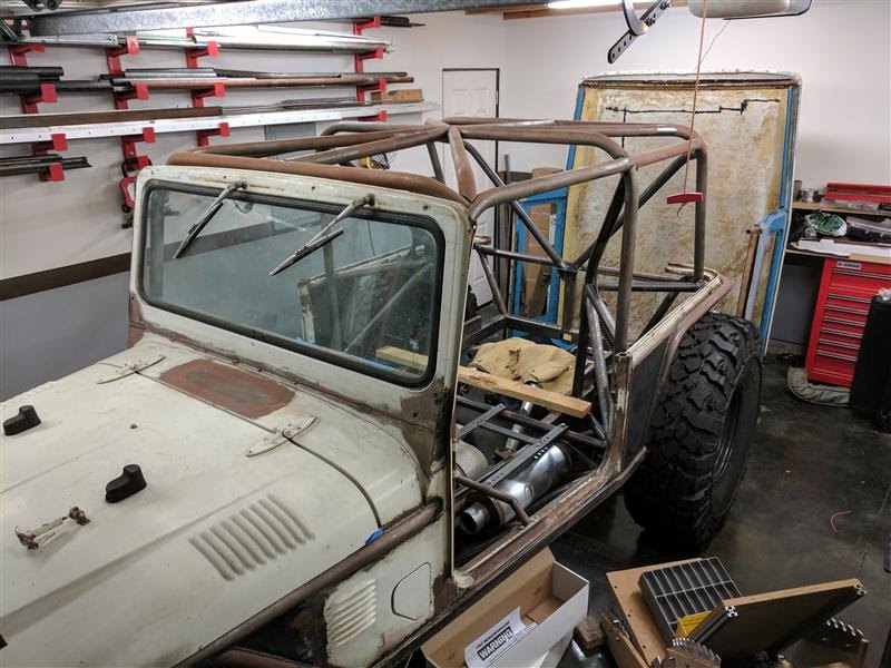

Yanked the hatch first. No reason to lift more than I needed to.
Coerced a buddy into helping me heave ho... Not too bad!

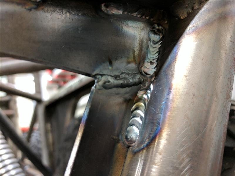

That 8 way roof node is damn cool looking. Some serious wire wheeling needed before welding.
That's better. A few multi pass welds up here to avoid undercuts, but it's solid.
Looks so weird with the top off. Kinda makes me wonder if I'd miss the blue if I don't go colorful in some regard.
This is as good a chance as any to ask how folks are best breaking up mill scale. Wire wheels seem to work well but they're still pretty time consuming.
I'm not good enough to get consistent welds with the scale still on it and I do have a great of tabs and brackets coming up in my future fairly soon.

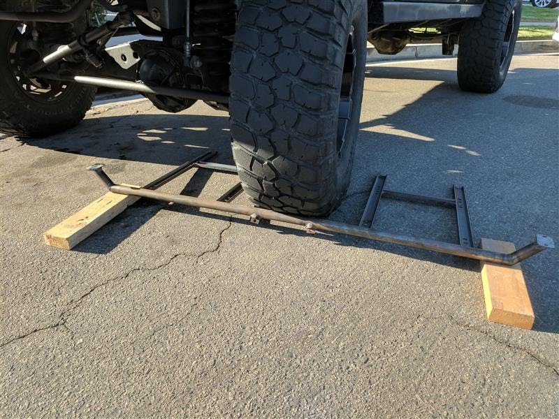

Structure is getting close but some things just take time. Case in point: my front shock towers. I was worried about cracking through the narrow cross section at the front of the mount point. It has a nasty stress riser that was just begging to break here. Check this one!
So I welded on it a bit.

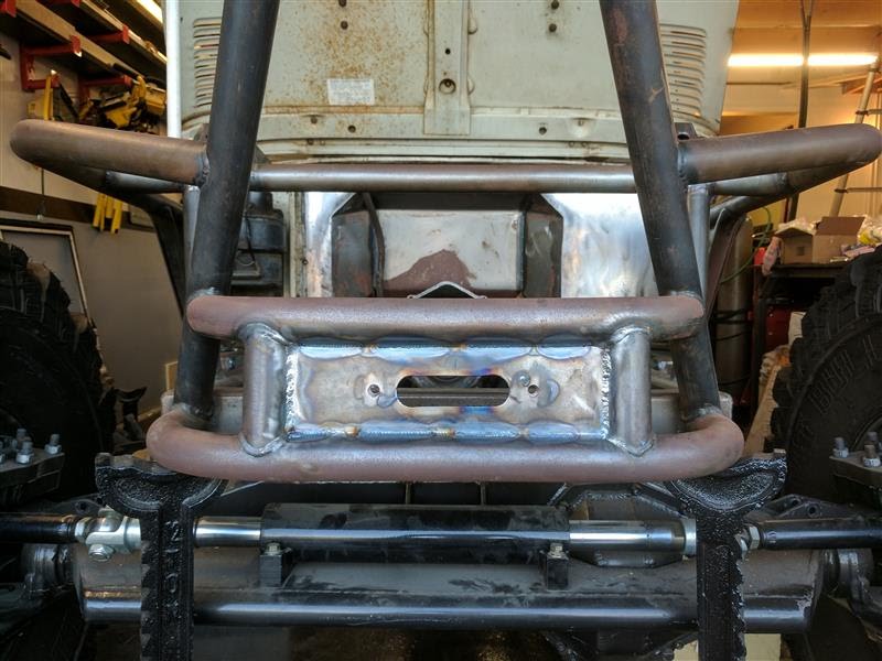

I also whipped out a quick plate to support my winch fairlead. I was sorely tempted to make this out of carbon, but since I'd still need brackets and bolts to mount a carbon panel, simple functionality won out. I suppose I could still skin it in carbon if I want to, but it feels kinda half-assed to add pure decoration without purpose. This is only 0.060 or so it's not that heavy.
We got that burned in too.

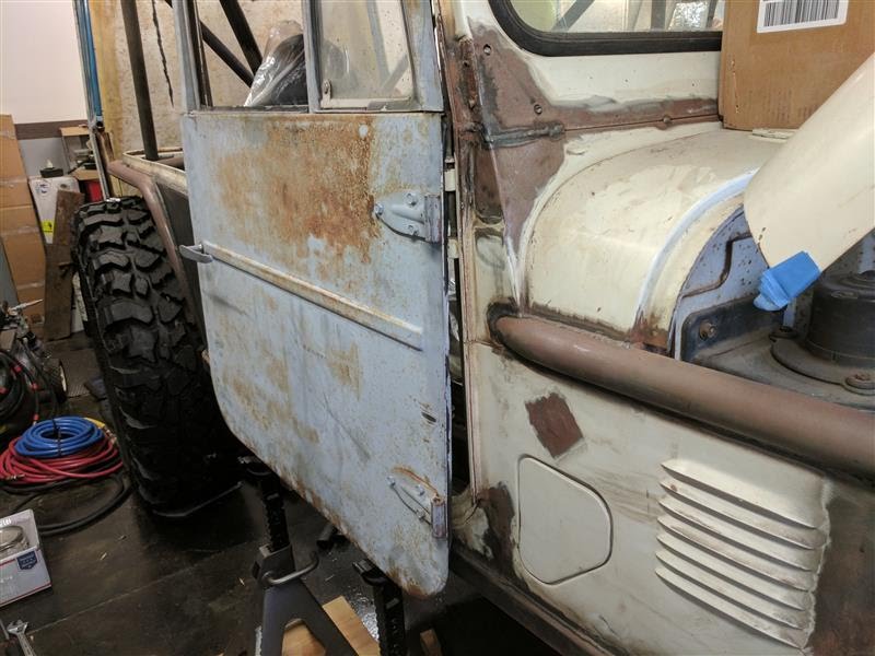

I had formed up some door bars a while back but wanted to check fit vs doors to be sure I wasn't blocking hardware or anything before I welded them in. Did the check. What do you know I'm blocking hardware, specifically the door latch and handle. *sigh*
I can't get an exact fitment because I still need to cut down my doors. The body has been shortened by 3" which does wonders for the overall proportions of the rig, but does come with a great deal of extra work. I just mocked it in place based on the upper hinge.
I literally couldn't have hit this any worse. The handle pretty much lines up with the bar perfectly.
After starring at it for a while. Trying to see what it would take to bias the bar up or down I just wasn't happy. I could add a bend but that's a PITA since I don't have easy access to bender anymore. Plus I like straight lines direct to nodes... Eventually I decide F--- it. I'm putting the bar where I want it (albeit biased as far to the inside as I can manage) and I'll rework the door handle as needed.
It still took some creative welding to get down around the junction at the rocker. Not perfect coverage when using stupid electrode stick-out (gas lens can only do so much) but it's not going anywhere.
But this next picture makes it so worthwhile... Now that's some proper triangulation! Note the added rear shock bars down the bumper/frame junction as well.

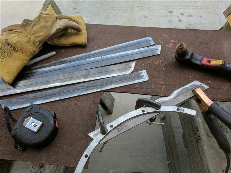

I built some perimeter flanges to give my panel something to bolt to and carry shear.
I may not skin the inside so I thought the flanges looked kind boring and were heavier than needed (wanted some strength for shear but areas between bolts weren't doing much)
So I got a little creative with the plasma cutter and scalloped them all.
Smooth it out on the belt sander (seriously, buy yourself a big combo belt/disc sander, I use this constantly). Fun fact: slag from plasma cutting throws way more sparks than the base metal does. It's kinda weird.
Pro tip regarding stitch welding (segmented welding if you prefer the proper term): Sharpie your pattern in place. Tack whatever you're welding at the end of each stitch, then you start on the opposite end and weld until you hit the tack. Steve's either a damn clever dude or has just been doing this a while. Can't believe I never thought of that. Also FYI if you ever see a segmented weld on a drawing they should be called out as length of each weld followed by spacing of the weld centerlines. So a 1-2 weld is one on, one off (not one on, two off).
Turned out pretty nice and saved about 1/2 a lb.

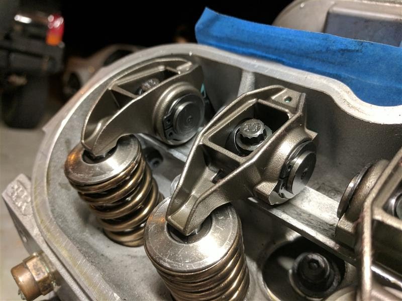

Biggest change needed was swapping out the cam. What the engine came with was too big for off road use (at least assuming I wanted to crawl as well as throw sand). I also wanted to inspect what I could and make sure things were healthy inside.
Started by pulling valley covers. No surprised here. The valve train install appears to be fresh (note the grease on the tips).
ARP head studs peaking out. Thus far the engine has had everything it was supposed to.

One oddity I ran across. I had a moment of panic cleaning out the intake ports and I found that the port had broken through the casting wall. WTF? You can just see it peaking out around the corner.
Pulled the valve covers back off to try to figure out where and figured out it’s the void beyond the tip of the rocker bolt.
I debated trying to smooth or plug this somehow (JB weld maybe?), but I didn’t want to run the risk of it coming loose and getting a slug of hard epoxy down the intake.
After a bit of looking online, I finally figured out that almost all LS3 head ports do this. There’s apparently a bump intended to keep the hole blind that protrudes into the intake port. If you want to smooth out the passage this bump gets carved off. More details in this thread…
Heads ported, is it ok that they went into the rocker arm bolt area??? - LS1TECH - Camaro and Firebird Forum Discussion
So what folks really do it put some thread sealer on the rocker bolt to be sure it can’t be a leak path or a means of oil consumption. Given there’s not much discussion on what type of thread sealer I ended up using Teflon paste (aka plumber’s pipe dope).
