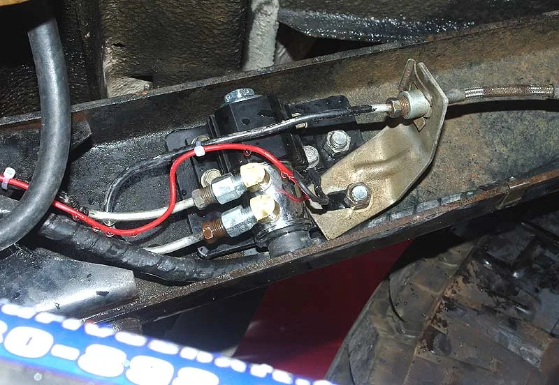

It's a line lock, made for drag racers, in this case will be used as a hill holder. Mounted the valve at the end of the hard brake line, near the rear axle and put a switch on the shifter. To use, push the brakes as hard as needed, depress the button, release the brake pedal, the rear brakes will stay on until the button is released. Works great in the parking lot, will see how it works on the trail?

I wonder if a mechanically activated line lock would be be more dependable than an electric activated one?
I can see where they would be useful to temporarily supplement the E-Brake in moments of indecision :hillbilly: - but they would have to be 100% dependable.
The electric valves are reported to be reliable. Mechanical could be more reliable, but would have "use" issues? The simple one is just a pressure rated valve, solid reliability. The other is a mechanical line lock, to lock, press the brake, push the lock, they release by hitting the brake pedal again or pulling the knob. The "packaging" issue is common to both, running brake lines up the shifter would be cumbersome? So, are limited for convenient/handy mounting locations? The electric is much more open to "packaging".
In my experience and reports indicate that the mechanical line locks have more reliability issues than the electric. They are more prone to sticking, leaking, etc.
Thanks - I might look into getting one - as a second emergency brake when parked temporarily with engine running.
The ones I see on the Web are for locking front or rear brakes, can they lock all brakes - or a different unit for all 4?
You could get two units, (one front and one rear) but don't see the point? If you are in 4wd, it will affect both axles.

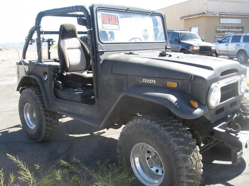

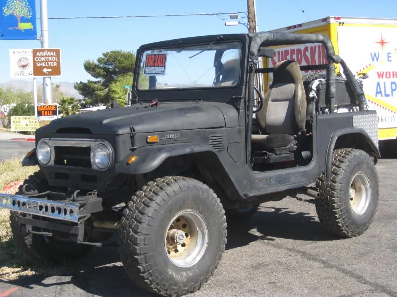

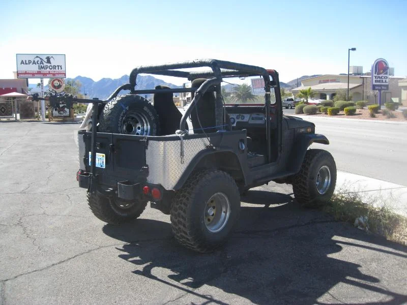

I saw this 40 for sale in Boulder on the way back from Vegas. You are right, not too far away :)
I haven't driven up to Las Vegas in years but remember a FJ40 for sale on the main road thru Boulder. It couldn't be the same one? I didn't take a look since it didn't look that nice and already have a few:rolleyes:. One of which is a 73 FST not a 73 hard top minus the top.:meh:
