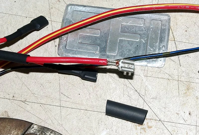

How I do spade connectors, not the only way or maybe the best way, but the best way that I have found. For critical connections, I don't like the plastic sleeves on the connectors, can't see to make a solid, quality crimp with them in the way. So, either buy them without or remove and discard.
Need the connector and two pieces of shrink wrap, sized for the wire and connector. Slide the small piece of shrink wrap over the wire, then crimp the connector, I crunch it with the "spiked" part of the tool, then fold it together with the rounded part.
Slide the smaller shrink wrap up to the neck of the connector and shrink, slide the larger piece on till even with the end of the connector and shrink.
This does two things: Provides insulation, more importantly acts as a strain relief, moves most of the flex down the wire, away from the crimp. Allowing the wire flex to happen at the strip/crimp point is a leading cause of failure.

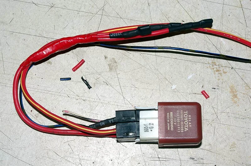

This is how the factory "in harness" splice connections are done, wrapped with tape. This one was one wire in and five out, I only used three outputs.
The reason for this little harness: The early rigs only had a single ignition on switch contact, they only ran a relatively small number of loads, ignition coil, carb idle cut, etc. The later rigs have a double switch to deal with higher loads, like injectors, fuel pump, etc. So this relay circuit is to take the load off of the switch. There are actually two relays, mounted side by side, the other one runs the ign, EFI, etc, this one is for key on accessories, heated seats, ARB control, etc.
Anyway, the relay is a factory headlight unit, pretty stout, ~40A. The plug is cut from the relay panel. The W/BK (ground) wire connects to the wire left hanging out of the relay next to it, the BK/BU connects the ign on from the key switch, these close the relay switch. The R/Y connects to the main battery input, supplies power, the Red wire sends power, split to three fuses. So when the key is off, the fuses are dead, when the key is on, they have power, with very little draw from the key switch.
