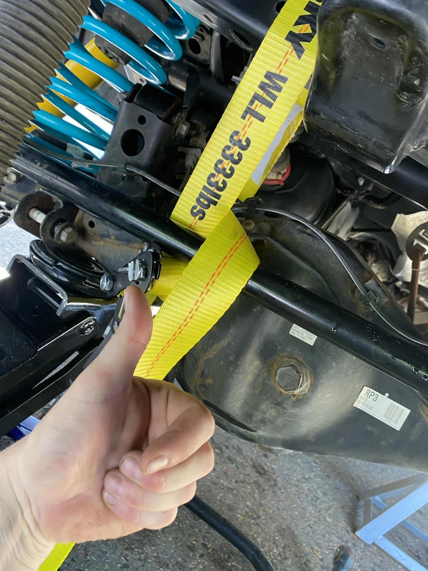

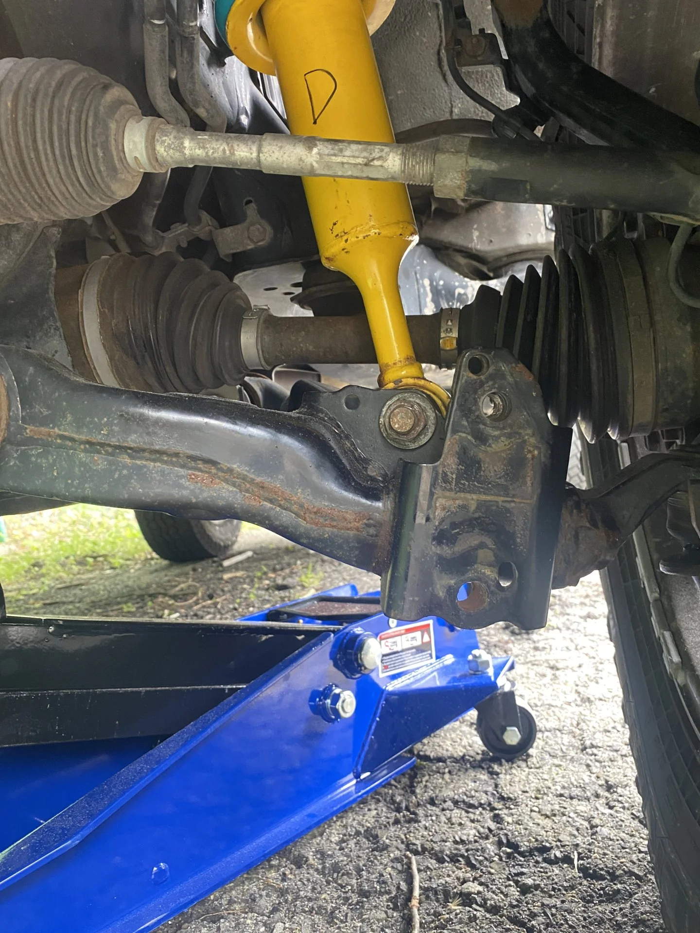

Some images of the suspension install. what I learned: to get the front coil over out, just pop the two bolts holding the ball joint to the hub, then there is no need to remove the UCA ball joint to slide them out, this will also allow one to drop the LCA low enough to get the new coil in easier. For the rear, DO NOT remove the upper links, super hard to get them back in. I had to use a spring compressor and or a ratchet strap to compress the coils to fit them in. (Probably the hardest part)
Using a strap to suck the axle up enough to attach the upper links back in.

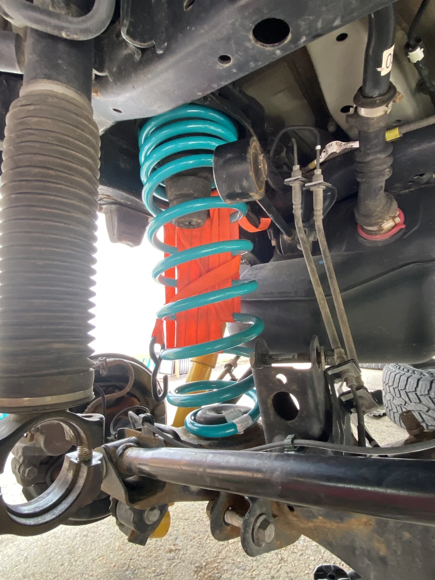

Ratchet strap to get the coils in, worked maybe better than the actual spring compressor, which gets in the way.

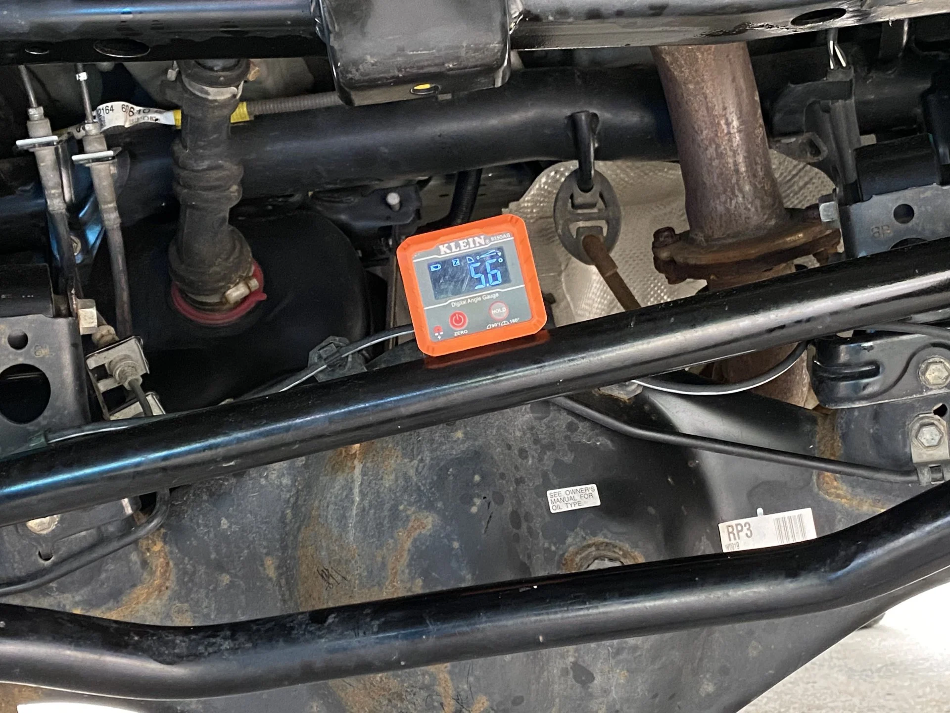

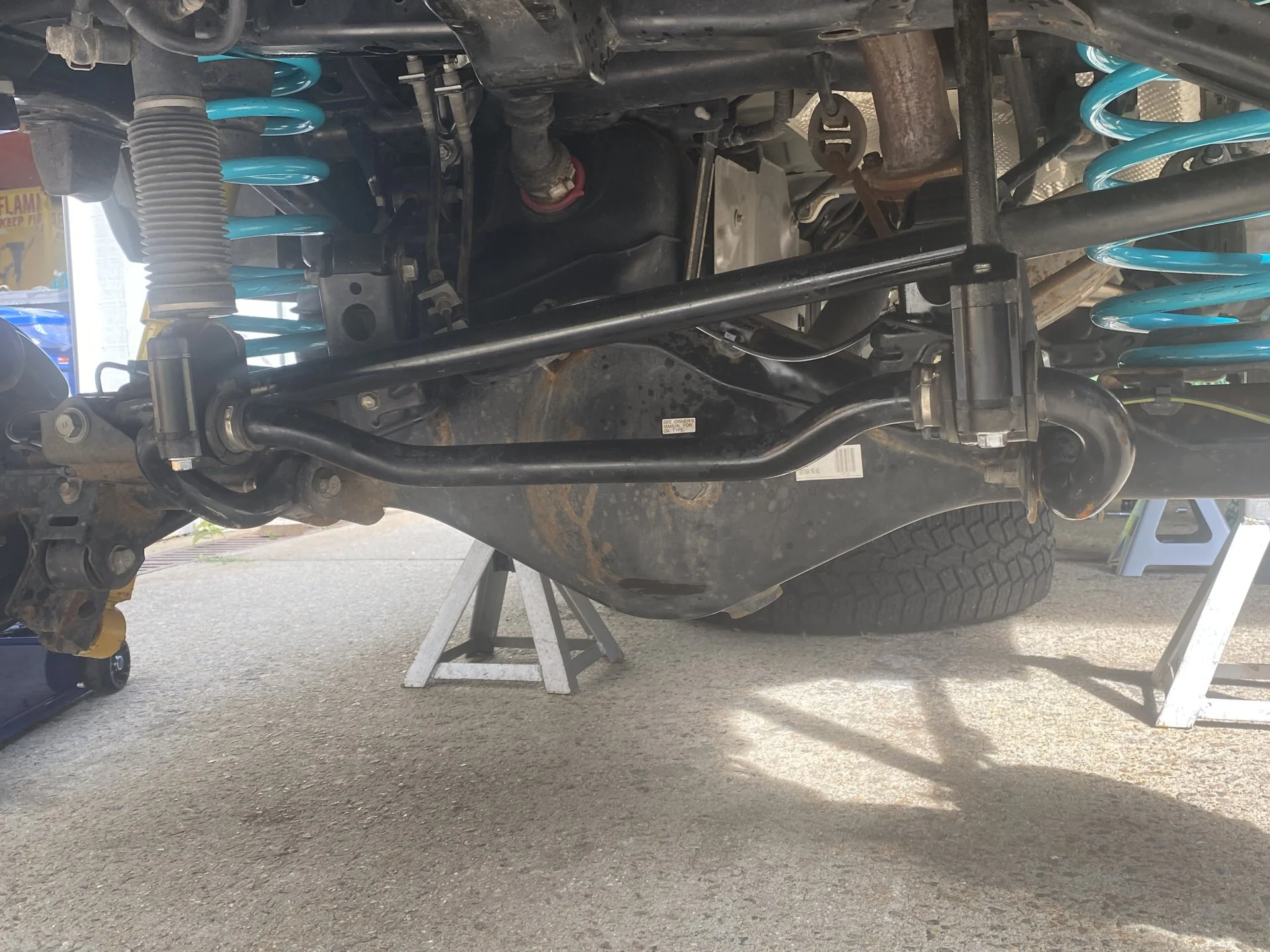

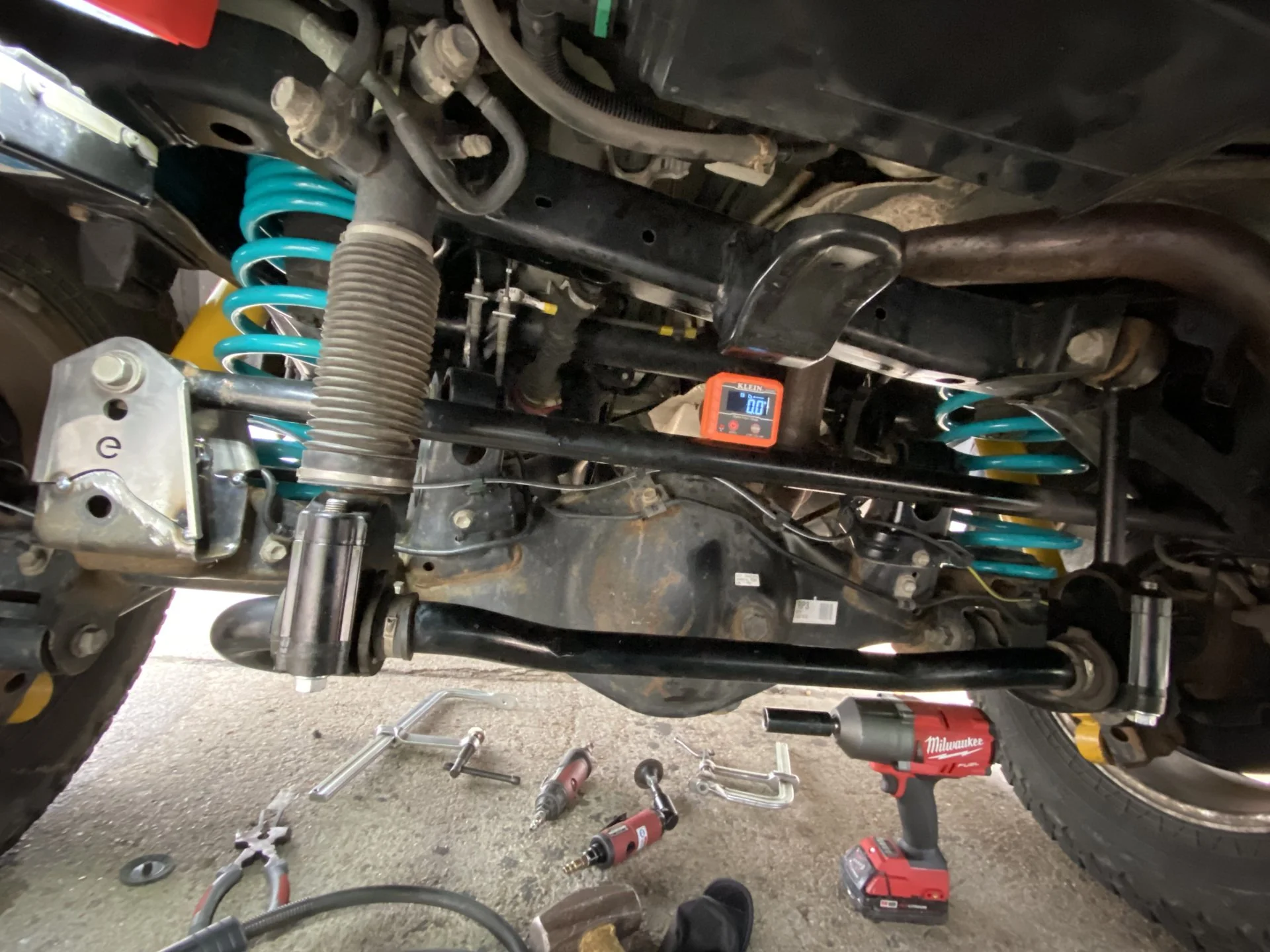

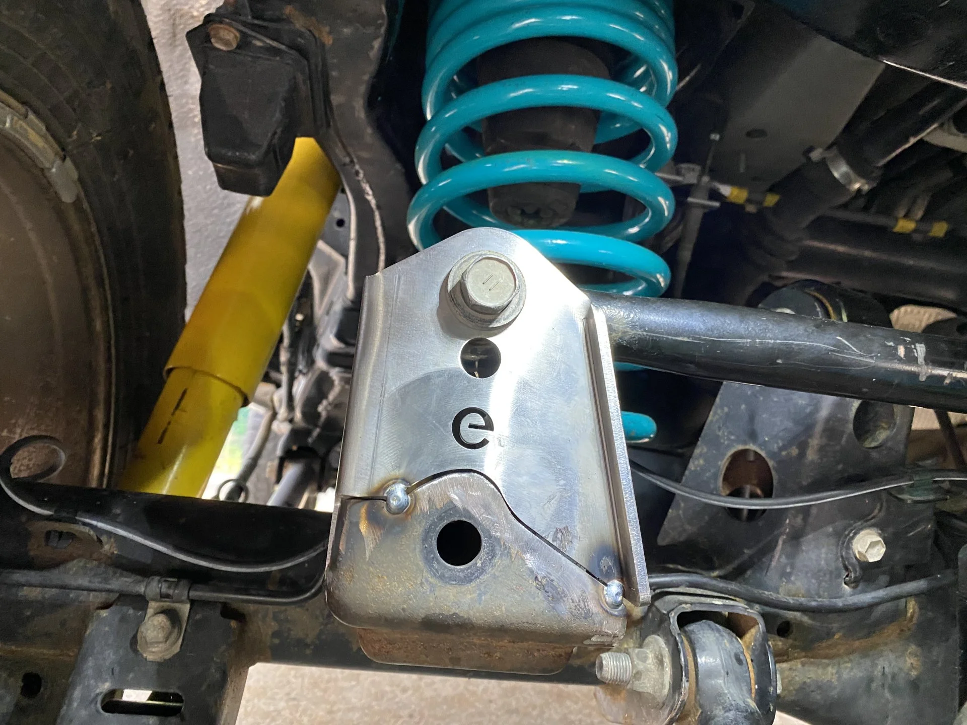

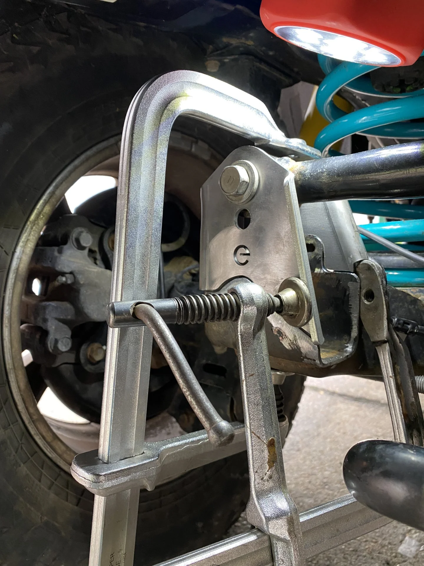

The PCK went fairly easy, had to trim the mount and location a bit to get it to fit right. I read from other’s installs that it’s hard to get the rod back in the mount after installing. I can understand, the bar travels on an arc, so when it moves up it also moves over.. so to fix this, I fitted the mount in with the panhard rod attached, then tacked it in place.
After the new springs the pan hard bar was at 5.6 degrees off level, now its exactly at zero! I’d say this mod does exactly what it’s suppose to.
Before:
After:

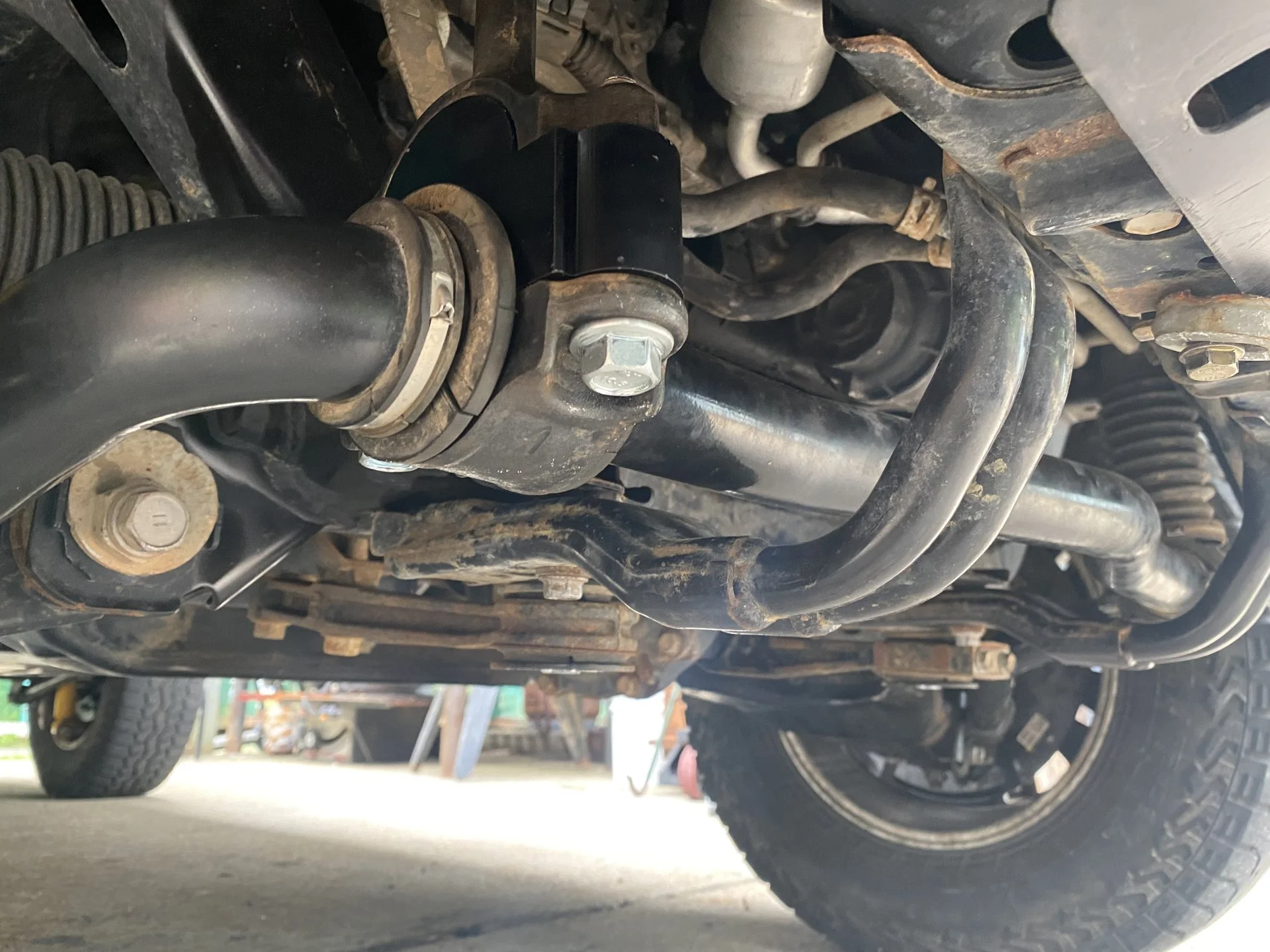

KDSS spacers:
Should be strait forward but stupidly I removed the sway bar from the LCA.. bad move, it’s really hard to get it back in place, and involves removing the whole bar, starting at the LCA then getting it back on the pistons. Instead just remove the sway bar from the two clamshells. (Pistons)
But the spacers are easy to install, especially in the rear. For the front you need to drop the guard that hangs below the sway bar to get the bar low enough to fit the spacer in.
My sway bars are now level. Don’t have a before and after shot, as I did them before dropping the rig back on its wheels.

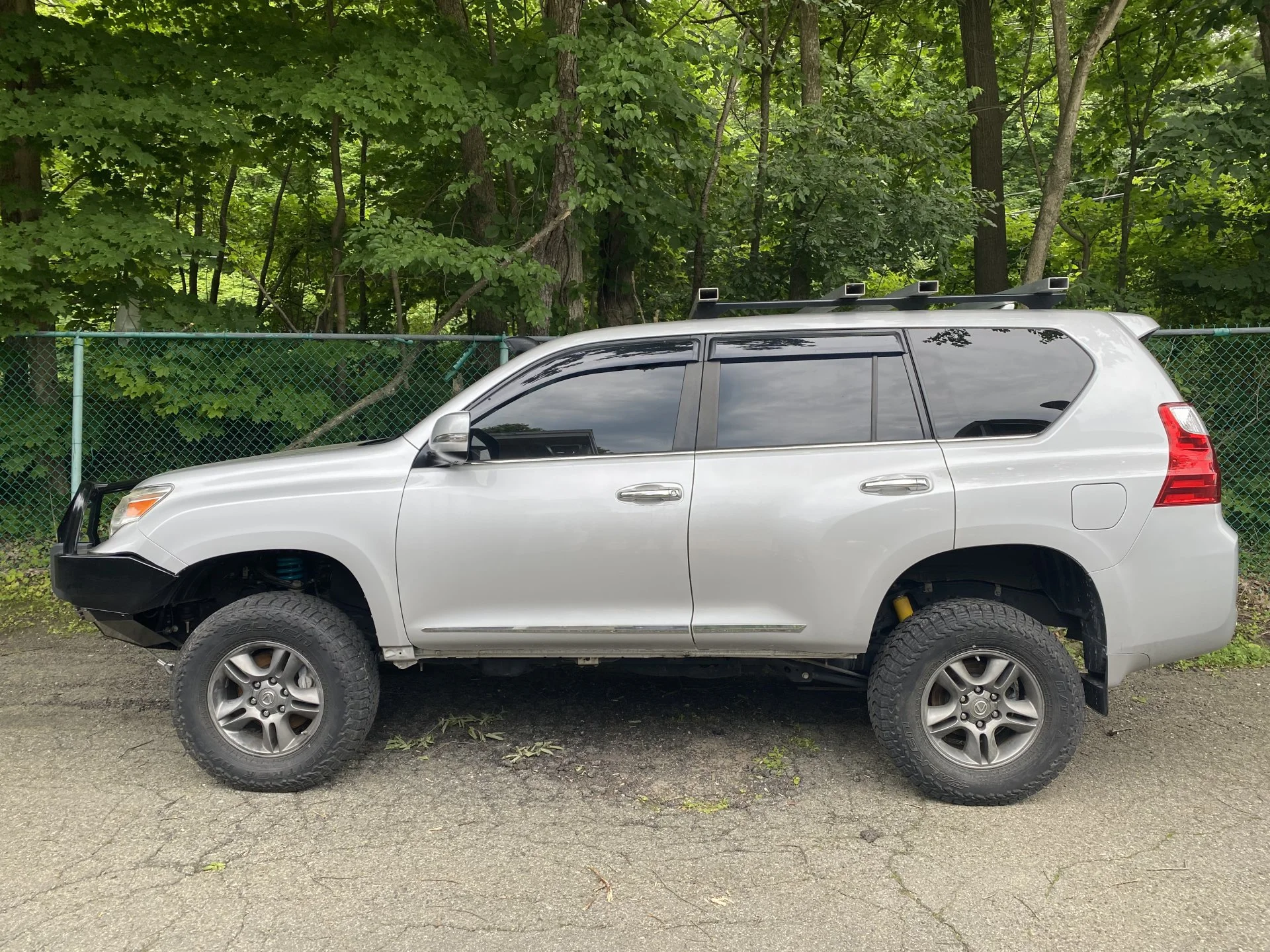

4” lift? Go big or go home! Love it. LOL
What a heck of a lift. So much for a nice daily driver!! LOL Looks like John Bull, Gold Hill, White Mountain, and Camp Rock are waiting!!
Hoping it settles a bit, and it’s definitly not a daily driver for me. I got a s*** box Honda hybrid for that. Also just acquired a beater truck for around town, so now the GX will be a dedicated offroad/road trip rig. Very excited for that.
And that 4” is with that front bumper… keep an eye on those rear brake lines
Even at full droop they looked ok, but I’m scheming on a stainless upgrade, and I’ll definitly add a little length when I do that. I will be adding a rear bumper, and puting my sliders/skids back on.

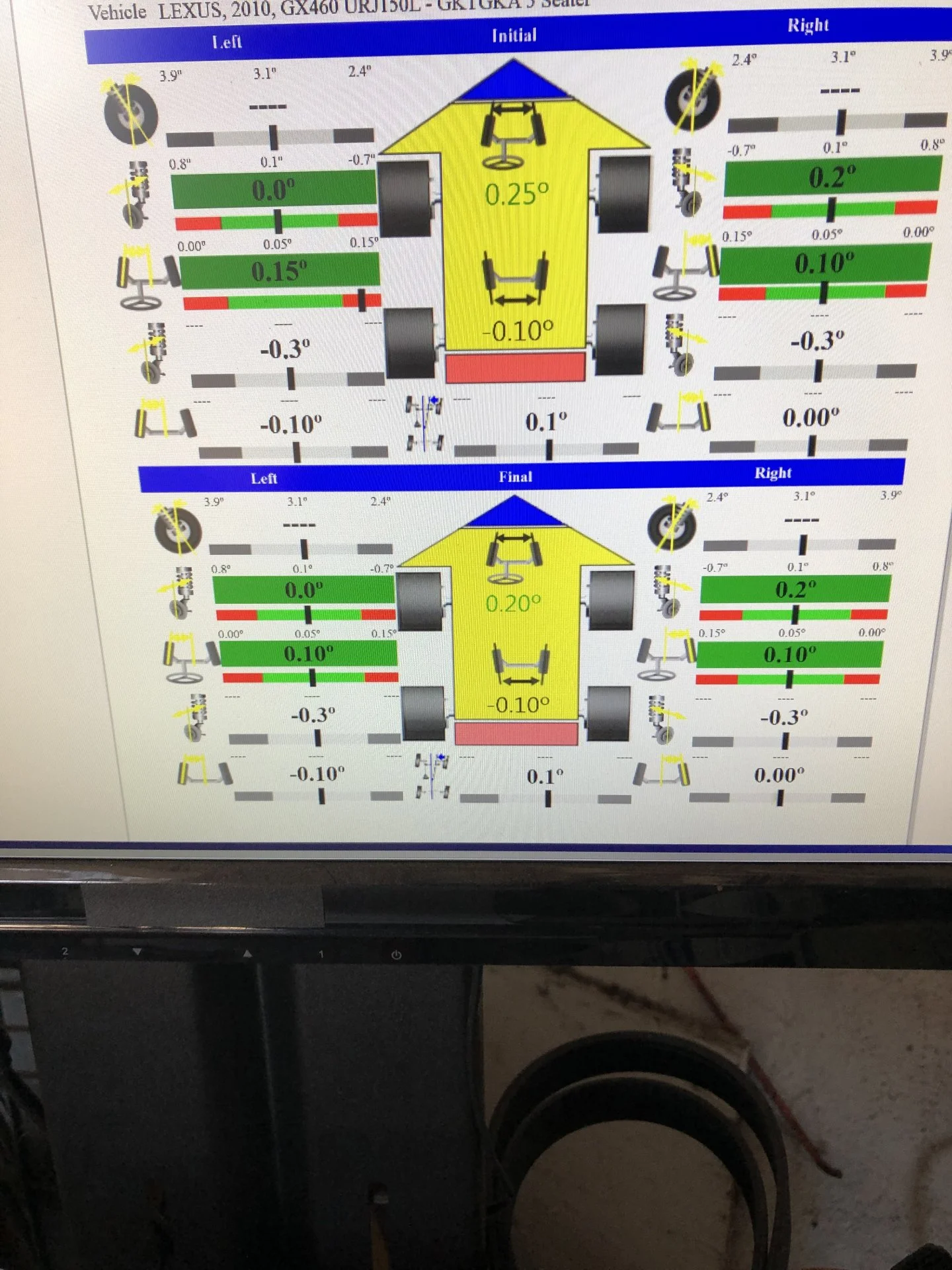

Alignment specs from today. Finally got to open er up on the highway, feels great. I do notice the slight increase in center of gravity, but maybe it’s just that I haven’t drove it in a while.
Had a good conversation with my alignment guy, prepping him for what’s to come.
