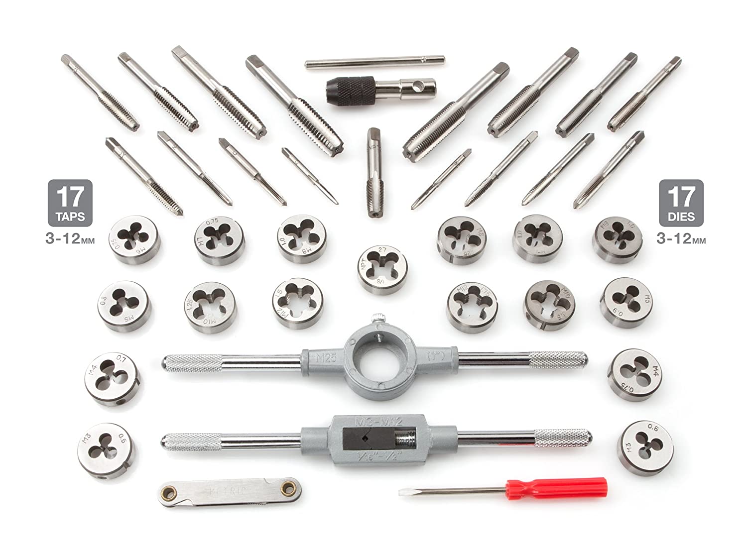

By the way, running 5 nuts on driver rear wheel, got a stripped bolt. More crap to fix. Ordered this from Amazon, had good luck with Tekton tools. Will use the die to clean up all the studs and the tap for the nuts. Its crazy how difficult to remove some of them are and I don't want to strip another one. Anyone welcome to borrow if you are having the same problem.
Got the tap and die kit, and it made the wheel work a lot easier. Difficult to use the die with the bolt in place, but it was good enough to secure with aftermarket nut. Will replace that stud later when I decide to screw up the non-functioning parking brakes. Cleaned all the nuts for the same wheel, and the bolts, and now it all spins in and out like new. I got to do the rest of the wheels to avoid any further cross threading. Wondering if it is just galvanic corrosion that needs to be cleaned...

Tapped all the wheel nuts, plenty of machine oil to remove the accumulated crud (scientific term) from them, then good brake cleaner to clean them up. Some more difficult than others, but now the nuts spin in easily. Still need to replace one bolt on rear....
